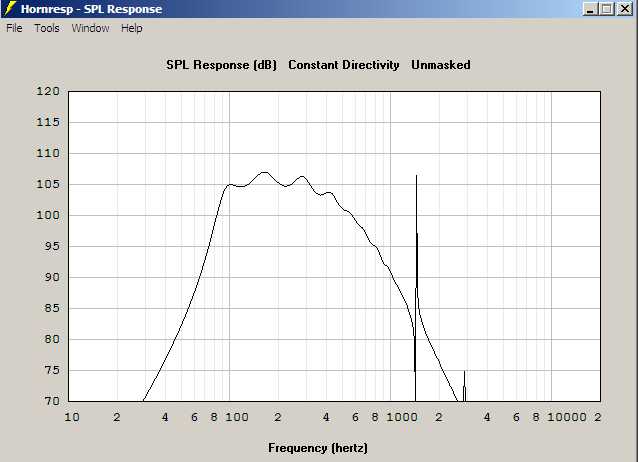

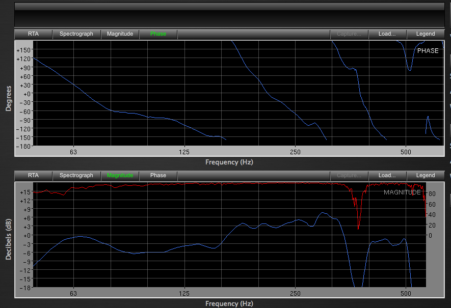

I have built single and double TH using Eminence Kappa 10" speakers.
Below is the response curve for the single, which is only 15" x 15" x 26.5".
It weighs 72 pounds using 3/4" birch plywood.
The dual 10 version was 15" deep by 22.5" tall, 26.5" wide. For PA mid bass use, the exit could be shifted so the cabinet would be 22.5" deep and only 15" tall.

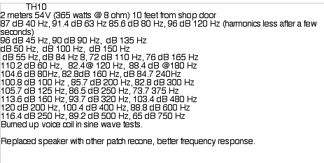

I did some distortion tests on the single, unfortunately burning a portion of the voice coil which was rubbing due to a cobby cone repair Frankensteined together that resulted in uneven voice coil alignment. Also, the test was done in 100 degree temperature with the magnet structure directly exposed to the desert sun, it was too hot to touch when it burned out. Normally I only expose the speaker to high power sine wave for about 2-3 seconds, then wait 10 seconds before advancing to the next tone. In this case, I was (slowly) typing levels, then shifting to the next frequency rather than doing screen shots and extracting info later. I think the driver easily would have easily survived the test if I would have used shorter duration sine wave tones and the driver was shaded.
The upper output is impressive for a box that size, 126 dB using 54V (365 watts @ 8 ohm) one meter with less than 10% distortion. Distortion would probably have been less with a stock Kappa 10", the box works quite well as a drum fill, crossing a pair of 4" above it at around 200 Hz. The picture shows the little 2 x4" with an EV tweeter bolted on to it, used it for side coverage on a recent show.

P.S. The 45 Hz sine wave test was first, it is well below what the cabinet does well. Next test was 60 Hz, where the TH has good kick, then on up to 250 Hz.
I then typed in the frequencies for a 45 Hz and 50 Hz test, but burned up the speaker before finishing typing in the 50 Hz fundamental level, the 45 Hz test was not done.

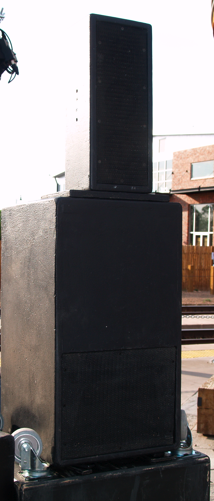

Btw not sure if anyone has seen (heard) the 3 way Void horn tops, but I have seen them at the last few parties I've been to. The setups were crossed right to double 18's and lacked some midbass IMO. With the addition of a midbass tapped horn the setup would have been killer!
||| Void Acoustics ||| Changing the way you look at music ||||||||||||||||||||||||||
Yeah, Monarch in SF has those tops. Not saying the system sounded complete, but the tops sounded better than most other systems I've heard. Not ear piercing and very neutral sounding.

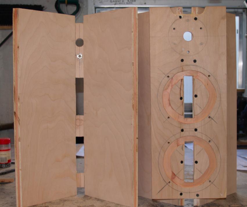

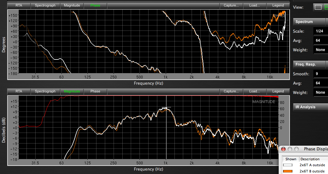

I don't recall the 3x6" design, but I built a pair of small FLH/BR 2 x 6" using Eminence Alpha 6" and an APT HF driver.Art, in another thread a while back, you brought up the idea of designing a top with (3) 6" drivers, IIRC. At what freq would you cross them over down low? What style cab did you see this working in? I'm very interested in designing/building multi-driver tops (synergy horns included).
I had toyed with the idea of making a Synergy type horn, but didn't as the depth would not work for the application.
The raw response of the 2x6T is not very smooth, but once equalized the cabinets sound quite good and get LOUD and clean for their size (26.5 x 15 x11.25) and weight (40 pounds).
I have been crossing them at 100 Hz.

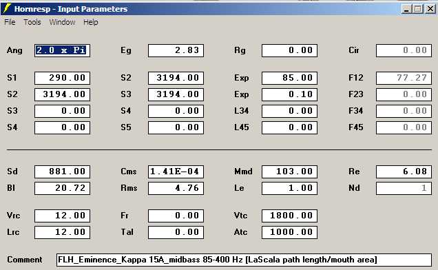

The 80-300Hz frequency range is such a critical range that I would suggest a FLH, and when I try to simulate it I always end up with something like the LaScala. Sure would be nice to see a tapped horn, that can outperform this. I'll attach a Hornresp Input screen (more like 90-400Hz).

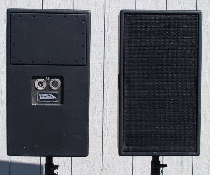

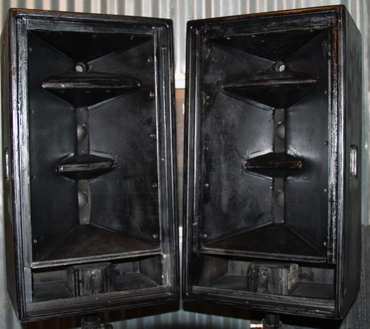

Not much documentation, but the pictures are about all you need. The HF horn angle and center are 20 degree angles, the HF horn entrance is rounded.Awesome, that's very close to what I'm looking to build from that other thread....any pics or design notes? Thanks!
The grill is also angled on the top and sides to duplicate the extra flair as seen on the lower part of the HF horn.
Exterior cabinet dimensions are 26.5 x 15 x 11.25 , exterior is 3/4", horn parts are 1/2".
Drivers are Eminence Alpha 6A and APT with the thread to 1" adapter.
A single cabinet can hit around 125 dB in the voice range.
Art Welter
