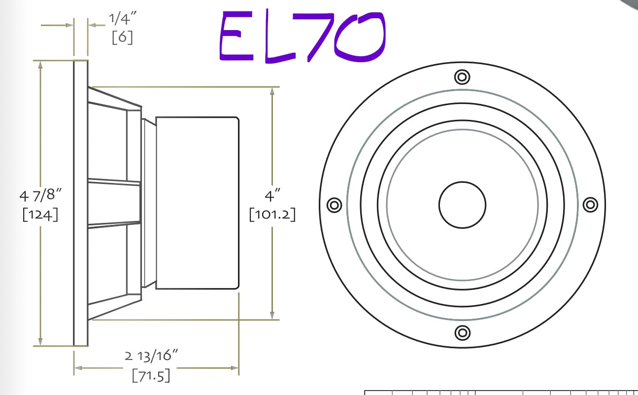

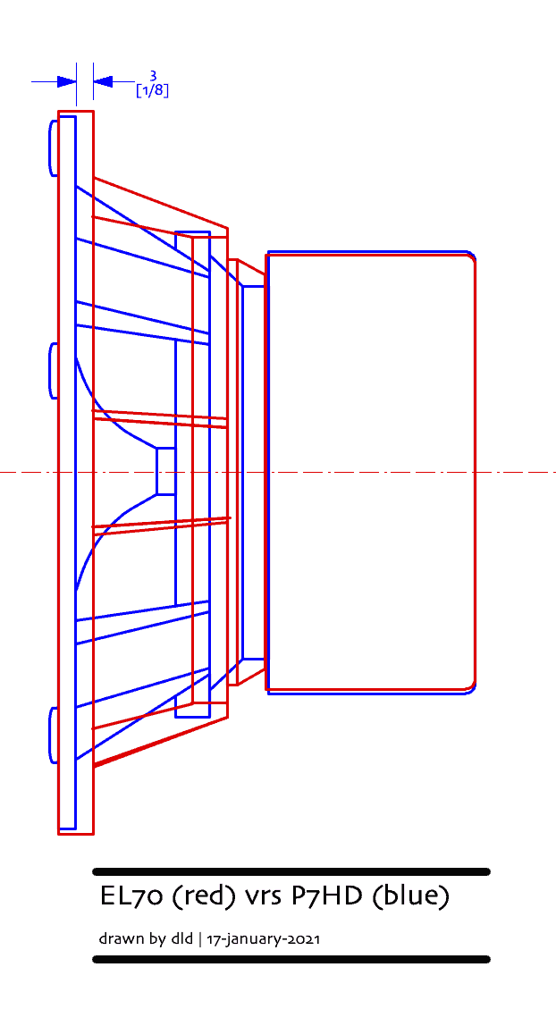

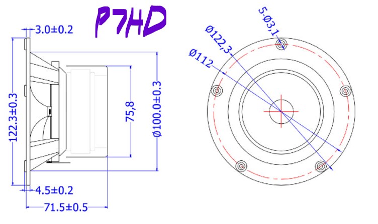

When comparing the technical drawings for both drivers, it looks like you were right with the 3mm estimate of the P7HD sitting proud of the baffle.
I did some cursory research for gaskets to fit, and am convinced I'll do the same as you with cardboard and the existing gaskets.

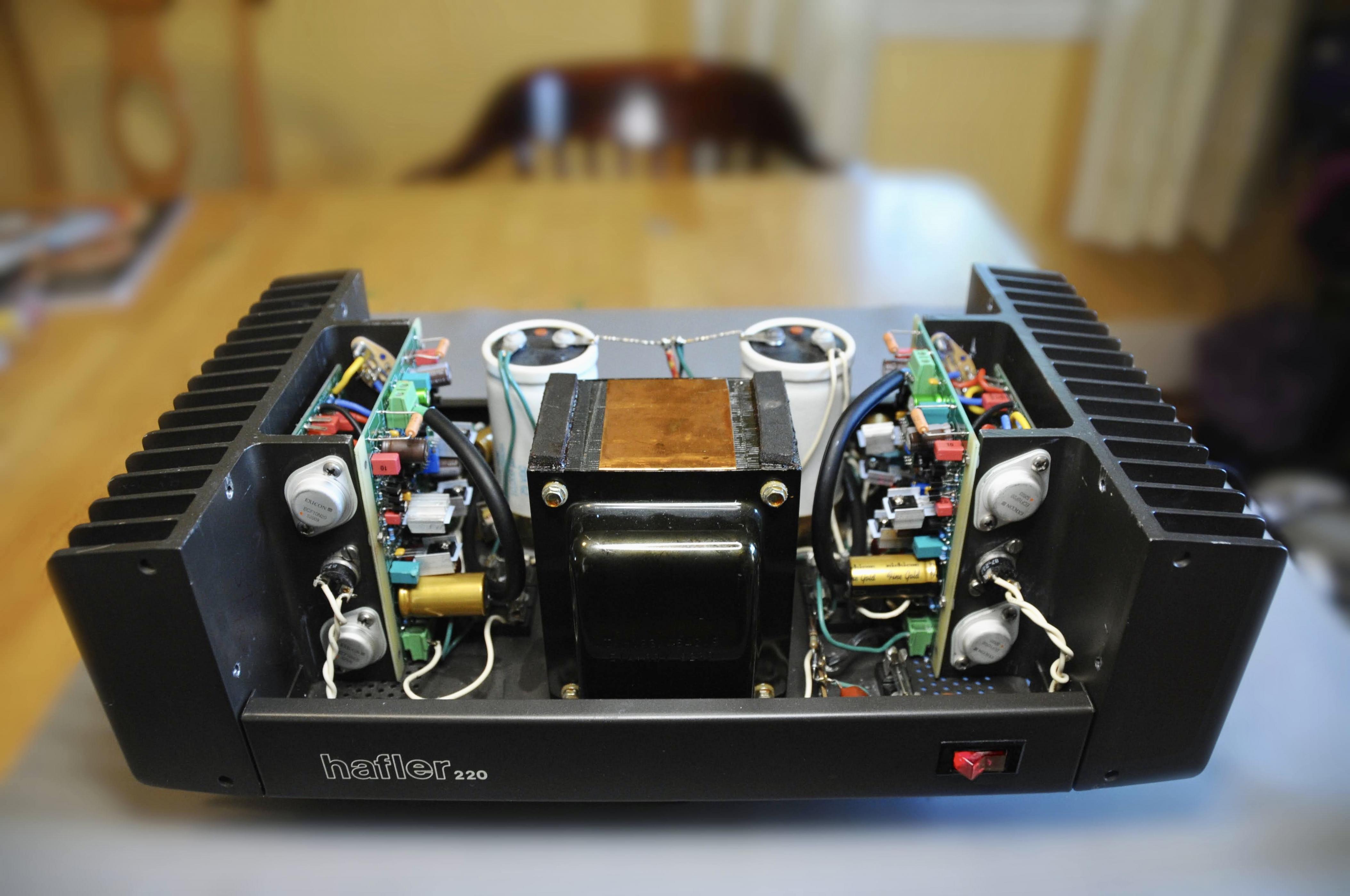

The change from 8 ohm to 12 ohm will be no problem for your ss amp. In fact the higher impedance will be easier on the amp. Higher impedance will equal less current flowing. The dh200 is a great amp... I can only imagine the one you’ve modified will be even better.
Cheers, Evan, thanks. I am excited to liven up my microTowers with new drivers. The cabinets you built all those years ago still look fabulous.
As it came in the day it was competitive but it by today’s standards, is not a great amp. Modified it could well be.
dave
I’m glad the cabinets are holding up well
The hafler amp is simple and well made. Attested to by the fact that it’s around 45 years old and still works well. I can’t remember absolute numbers but I did look at the fft of this unit a couple years ago and was surprised to see mainly second order distortion at up to quite a few watts.

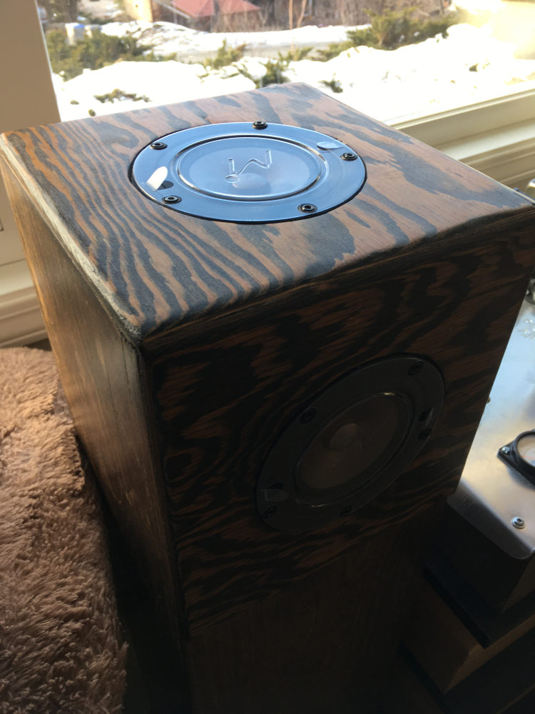

Hey von Ah, here's a tip you might find useful (although I am sure it may have occurred to you anyway).
Save the plastic protective covers that are shipped on the P7.2HD drivers and use them to cover the drivers when not in use.
The only real peeve I have about the microTowers in the "Castle" configuration is how much dust and grime the top drivers collect over time. I often thought about making grilles with acoustic fabric but never got around to it.
This is a pretty simple solution and has already proven itself. Also reduces risk of accidental damage due to pets, careless vacuuming practices, thrown objects, etc. etc. 🙂 I cover all 4 drivers, because - why not?
Joined 2009
I’d suggest using a router to create a small rebate / ditch in a square shape, set back from the edges and fashion a grill cloth to sit on top with the cloth fixed to a square frame that simply drops into the routed slot.
