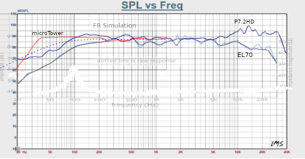

Here is a visual representation of what this upgrade does. I have fairly accurately scaled and then overlaid the published response graphs of the EL70 and the P7.2HD, and threw in the microTower box for good measure.
Navy blue is P7.2HD, grey + dotted blue is EL70, red is microTower. The fork in the road at 5k says it all. The 12 to 20 decibel advantage from 10k up is both obvious and very welcome indeed.
Looking at it this way, it is pretty easy to see why I am hearing (to my surprise) slightly better bass from the new drivers than the EL70. All I was hoping for was that it be reasonably close.
It will likely become even more apparent when I start to put some power to them. Although something tells me that they will not take as much abuse as I have thrown at the EL70s over the years. That's okay. I'm mellowing out as I age. 🙄

Nice work combining the graphs. Thanks for the output filter idea, too.
