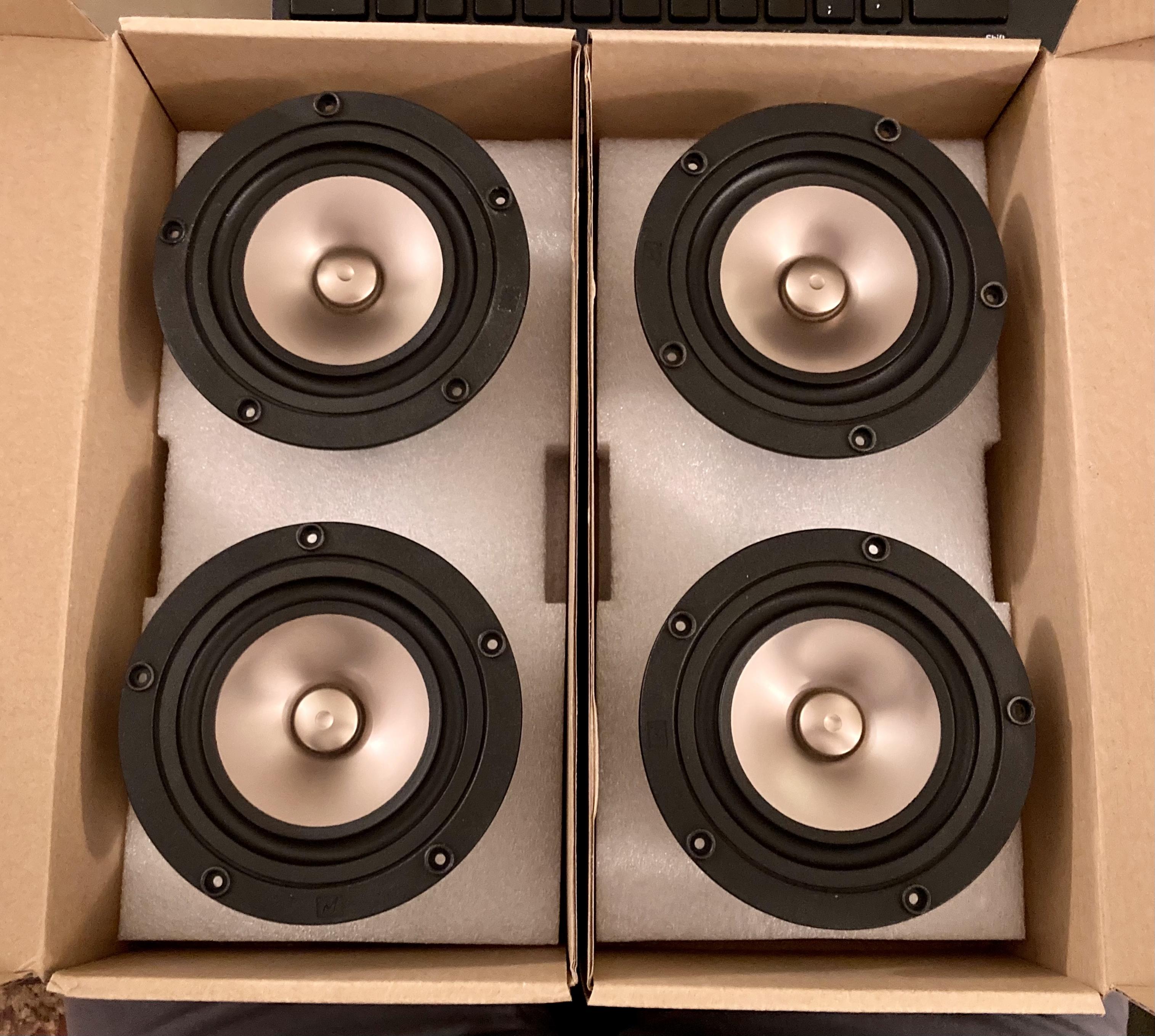

Thanks! They really do look good. An ancillary bonus.
As for how they sound, my first impression is VERY positive. Thankfully I typically listen at lower levels, so they will be safety broken in. So far I really like what I’m hearing.
I’ll need to get some new screws to better fit, as the P7HD holes are just slightly smaller than those on the EL70s.
I think I got the gasket spacing correct because the bass is presumably close to the EL70s. I made cardboard rings like you described, cogitech. The P7HD box tops were the right thickness and I don’t think I have any air leaks.
It’s going to be a great weekend of getting to know these new speakers!

The new screws are jammed into the side of the foam base the drivers were shipped in. Pull the foam out of the box and you'll find them.
Hopefully you didn't drill the new holes to fit the old EL70 screws, because the new screws are a smaller size and they won't want to stay in the larger holes very well.
If this is the case, you can always rotate the drivers 180 degrees and drill new holes. The drivers will end up "upside down" but nobody will notice or care. Mine are upside down because it was the only choice I had - long story.

Those drivers look very nice. It’ll be interesting to hear your review. The bar is set high... the el70s sounded fantastic in those cabinets. Do be careful to drill a large enough hole for the self tapping wood screws. The sepele is fairly dense... don’t want to break any screws off.
Thanks, Evan. Yes, the bar is set very high, but I am already pretty convinced these are even better now.
Just a few hours in and they seem to be improving. They sound absolutely amazing near-field. Hoping that with break-in, the top-to-bottom resolution will extend farther away.
I was successful in drilling 4 new holes per driver. Reused the 12 o’clock holes as a starting point and also for sizing the right drill bit. I am hopeful I can switch out the EL70 screws for those with slightly smaller socket caps. I don’t want to press my luck with drilling into these cabinets any more. And who doesn’t love an excuse to shop at McMaster Carr?

Based on my experience, you will get what you are hoping for.
Mine started out treble-heavy with tight (but good) bass. I was hyper-focused on the treble because that was mostly the point of me upgrading from the EL70s. After the full break-in period I can honestly report that the complete range from top to bottom is fantastic, even from 25 feet away. Very balanced, fluid and detailed.
Give them 10 hours of gentle break-in and then start to stretch them out progressively. You'll see.
