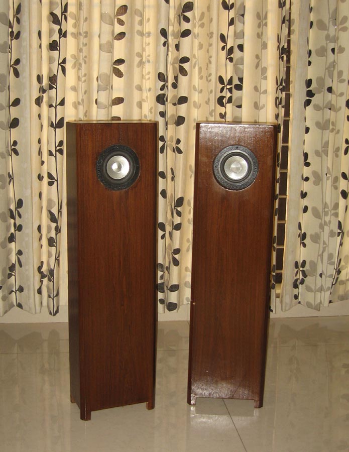

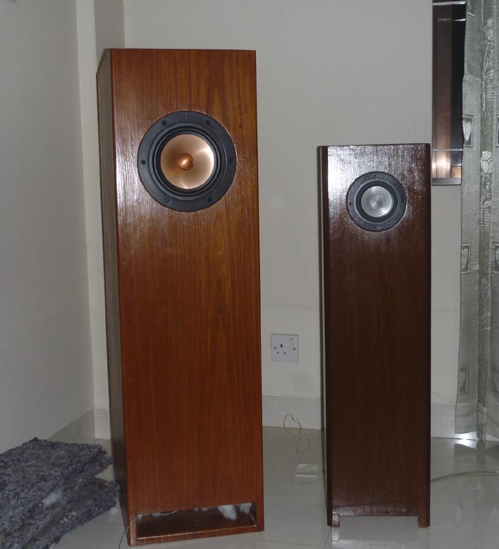

Just finished building a pair of Half Towers with CHR70.2.
Running them with a Dayton DTA-100 amp. Throwing music at it as I type... the speakers are doing their job. Imaging and resolution are very good, nice bass too. Have lined the top, back, and one side with recycled denim; no extra stuffing in yet. Have set them 8-10 inches in front of the back wall. A pic below beside my unfinished Super Pensil 12.
Sounds like another winner from Planet10 and Scott. 🙂
-Zia

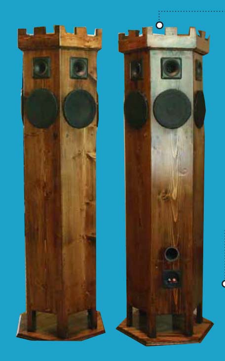

Real "Castle" Micro Towers? Wonder if the king still has his crown in tact...
From the latest aXp. WAF?
Hey, for every decor, there is a speaker design. I'm sure the owner of this home would love them...
Unique Classic House Interior with Gothic Castle Themed | Totally Home Decor

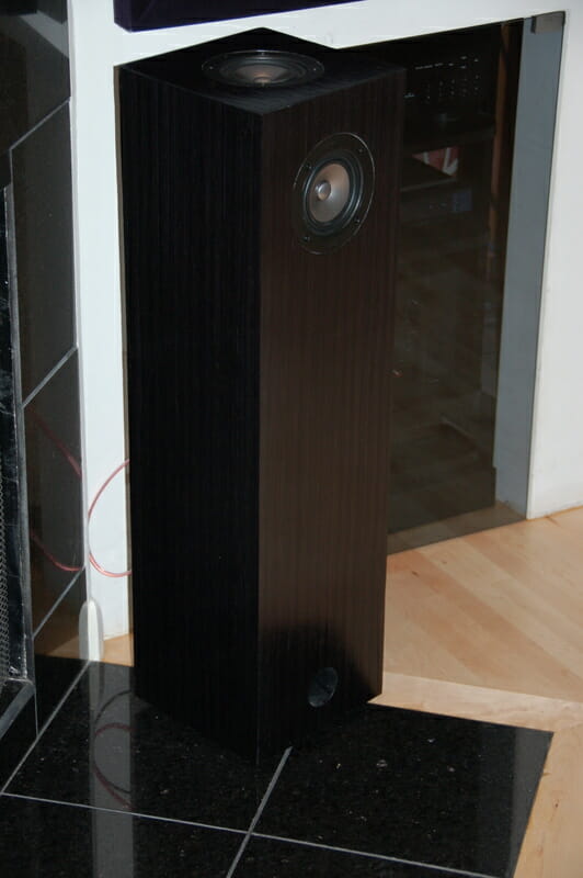

Well, I completed my build of the tower bipoles using Alpair-7's and I must say that I am very pleased with the results. I have an awful room that is acoustically horrible and these sound better than about anything I have put in there. The wife loves them as well. The detail from the Alpair-7's is just amazing, and I really like the way the bipoles fill even a fairly large room with sound. This is my first TL design, and I am just amazed at the bass from this thing. If I close my eyes and listen, then open them and see that one little tiny driver pointing at me from each speaker, well, it is a real disconnect.
Right now the lower end is a bit too boomy on certain music. I don't know if that is due to my putting the port front-firing (I did this hoping it would make speaker placement less sensitive) or just the stuffing. I only stuffed the top 1/3 so I will go back in (the backs are removable) and stuff further down the speaker to see if we can tune it a bit.
The only shortcoming of this speaker is that in a large room they are not quite loud enough on some metal music I want to crank up. Jazz, classical, vocals are all fine. If I continue to love these, I might try designing a larger box for something like an Alpair 10 to try to get a bit more volume.
By the way, I broke the drivers in on the benchtop for over 200 hours, starting with very soft classical and working up from there. The last 100 were just a random mix from my iPod. Had a couple of small 20 watt Lepai class D amps that were cheap at Amazon for the break-in work. I had not thought of it before, but this is an added undiscussed virtue of full range drivers -- the ability to just hook them up to an amp and run them in on a benchtop without any sort of crossover to protect them.
Thanks to all you folks, and particularly the guys at Planet 10, for the help and design
