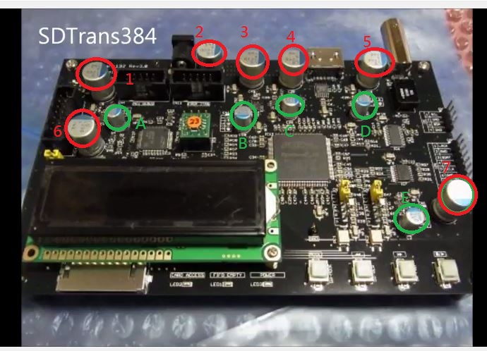

Dear Rick,
you mean the 1st row of E caps are from 1 to 7 refer to attached photo? if powered by battery (only the main power barrel plug - 5V) those caps can be removed?

comickit,
When using good battery power for the input for ALL rails I removed:
1, 2, 3, 4, 5, 7 - all of the caps that are between input power and the onboard regulators.
When I separately powered the 3.3 volts rails I removed:
a, d, and e
b and c are after the onboard regulators for the 2 FPGA rails which are being powered by the main power input on my board. I figure those caps are needed for those regulators.
Cap 6, I presume, has something to do with the display, and not knowing anything about displays I left this one in.
Since I am using only REDBOOK files I removed the junper for the right most clock since it is not needed. Figure there is no need for it to be buzzing away.
I have got used to no display, removed that jumper. I will eventually install a switch to be able to turn it on and off.

Removing capacitors of any type, but especially electrolytic and ceramic capacitors improves the sound by getting out of the way of the A123 26650 battery. I am being battery specific here - this is my experience which has been shared by those who have tried it.
I am not recommending this be done with any other battery. I have no idea how well it would work with other batteries. Of course, I am not recommending the use of anything BUT this battery
The caps are there to fill in the blanks that the regulators cannot fill because of their infinite feedback which gives them the pretend low ESR (measured for very specific conditions which have little to do with what is happening when music is playing) but makes them slow and requires the capacitor to keep the current flowing.
The battery has no such limitations so the caps make what is a dynamically capable power supply, as nige2000 likens it: "spongey". No electrolytic can let go of its charge as fast as one of these batteries so you have the conceptual equivalent of tuned port loudspeaker's huffing and puffing trying to simulate real bass. I know that is not a proper analogy but it is similar in audible effect.
The caps become a very unreliable gatekeeper where none is needed or wanted.
I would suggest looking up what decoupling capacitor do especially where digital is concerned. It not just the speed of the supply but the distance a supply is from devices and the parasitic inductance of the power delivery system. There is plenty out there on power delivery system integrity, removing decoupling and the larger reservoir caps is NOT recommended.
The digital also requires a stable supply, batteries without a regulator are not really going to supply this...
Only in audio!
In what way are the capacitors "in the way"? They are not in series, but in parallel with the battery.
The regulators do not have "infinite feedback". In what way is the ESR "pretend"?
So you are saying that a less stable power supply makes for better bass?
And what, in your analogy, is the gate? And who is trying to get through?
