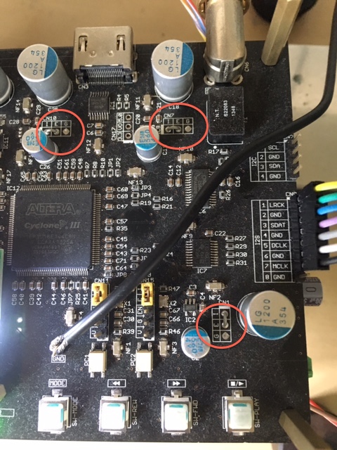

Dear Bunpei,
I have bought the sdtrans384 after group buy, I would like to upgrade the power supply from batteries to the following external DC power supplies are available.
CN1 3.30V 2.97V~3.63V 50mA for NDK clock osillators (1nos of 3.30V rechargable 16650 size battery)
CN5 3.30V 3.00V~3.45V 150mA for MCU, Memory card (1nos of 3.30V rechargable 16650 size battery)
CN7 3.30V 3.14V~3.45V 150mA S/PDIF, I2S interfaces (1nos of 3.30V rechargable 16650 size battery)
CN10 2.50V 2.375V~2.625V 50mA FPGA (2nos of 1.2V rechargable battery in series)
CN13 1.20V 1.15V~1.25V 100mA FPGA (1nos of 1.20V rechargable battery)
but I found there is a wire through the pin with marks [E] and ! So I simply disconnect the wire and connect positive to and negative to [E] of battery power supply?!
bwt, I lost the manual from the package (Can you show me the donwload path for the softcopy) and would like to know which pin hole should connect to for power on&off button installation?
by the way, anyone try the batteries power supply and what is the sonic performance, it will be nice if share your experience!!!!

I sent you a note and can send you a copy of the manual.
You remove the pin entirely. The pin connects the output of the onboard regulator to the "part". You need to use the middle point as the input from the output of your regulator and the third place, the ground, will be connected to your regulator.
I think using off board regs for the FPGA stuff is probably not advantageous.
I will be using the 5 volts battery I am using to power the entire board (for the moment) to power those FPGA rails.
I will be using 3 - 3.3 volts A123 26650s for the three remaining rails. All require relays on their outputs since all rails should turn on simultaneously.
I am using a LARGE LiFePo pack at the moment to power the board. I will go to a pair of A123 26650s when I do the three battery mod.
I have removed the rows of electrolytic caps - the LiFePo batteries are not impressed with electroytic caps in their way!
I would stick with the A123s for the e.e volts rails. "Float charge" with a good regulator - best arrangement for digital audio I have found. Thanks to jkeny and nige2000 for this scheme!
I have found using a completely separate power supply for the IIS rail is worthwhile.
I had used the same raw supply for all of the 3.3 volts rails - each battery has its own regulator but shares the raw supply. I am powering the FPGA rails with a supply connected to the standard power input which also has its own raw supply.
Has anyone gone beyond this using completely separate supplies for each 3.3 volts rail?

If you will send me a text message with your email address I will send you a copy of the manual if you have did not get the CD.
In my unhumble opinion I doubt there is much to be gained from doing anything with the LPGA rails. The action is with the 3.3 volts rails and I disagree with Greg (and he knew I would) that you should consider, no matter what regulator you choose to use, using an A123 26650 battery as an output capacitor on the reg.
I chose to use BELLESONs since they are small and I can place them across the individual batteries for a compact installation.
I had initially used one raw supply for the 3 3.3 volts regs but found, without intending to, that a separate raw supply for the IIS rail is worth the trouble.
I should try separate raw supplies for the remaining two rails and will eventually.
The FPGA rails are powered using the stock power input. I am using a pair of the above mentioned batteries in series for this.
You will need some kind of switch at the output of the batteries so you can turn all of the rails on simultaneously. I used relays since using a switch would have required lots of added wire.
There is something about these batteries and digital circuits - an affinity for lack of a better word. Thanks to jkeny and nige2000 for their excellent ideas.
