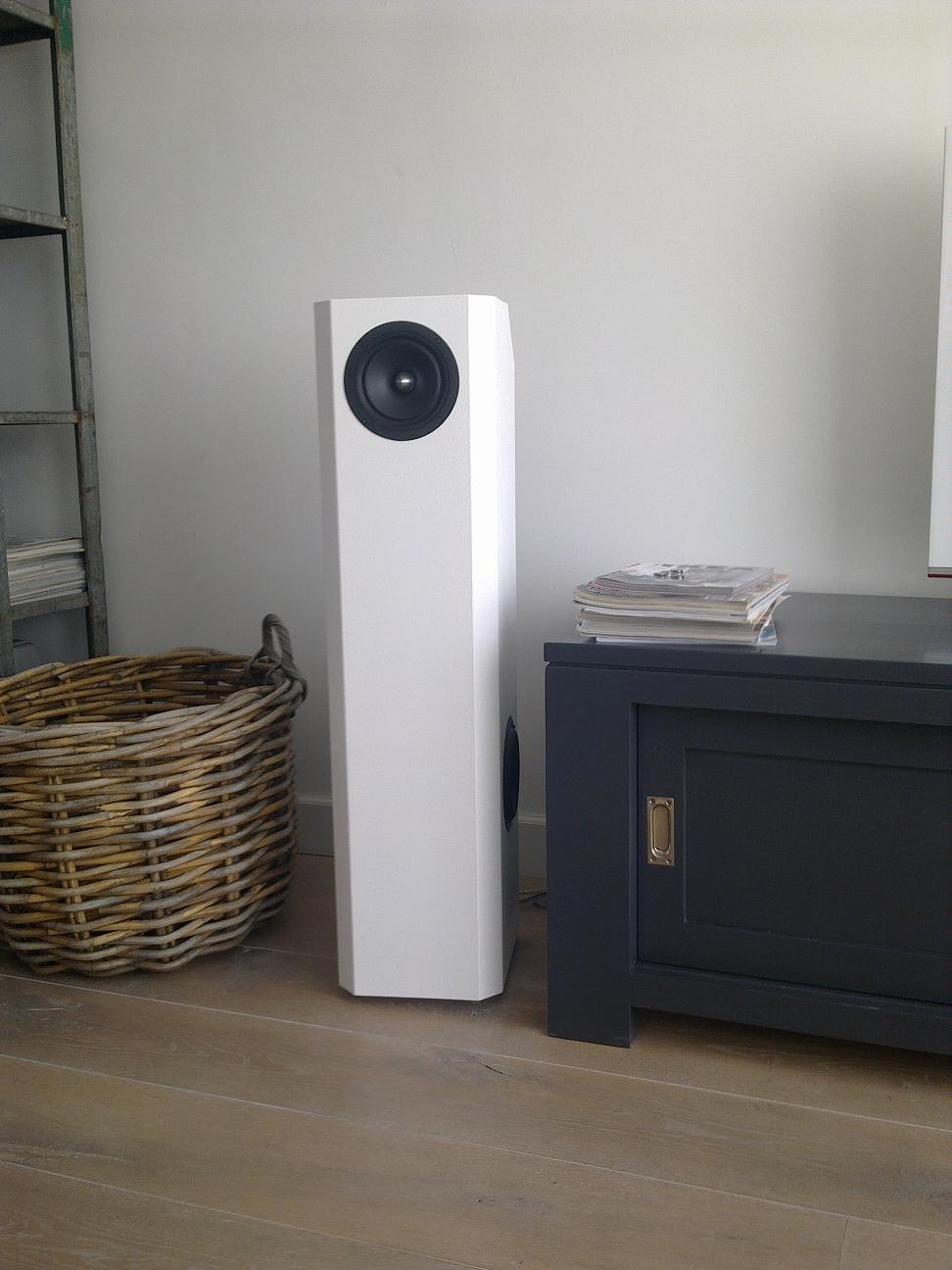

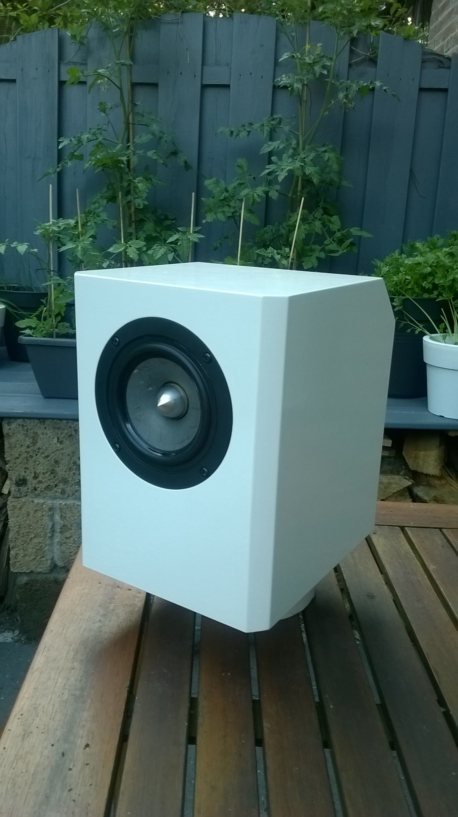

I did use them as "full-range-mids" in these floorstanders. Below 120hz the W6-1139 takes over and on the back I installed an ambient tweeter that improves off-axis response. This works incredibly well, the soundfield is more airy then most normal two,- or three-way systems. The measurements show the response 20degrees off-axis.
Btw. the W6-1139 is one little beast! I tuned the sub-woofer to 28hz and it really goes lowwwwww, I used a plate-amp to drive the two W6-1139's.

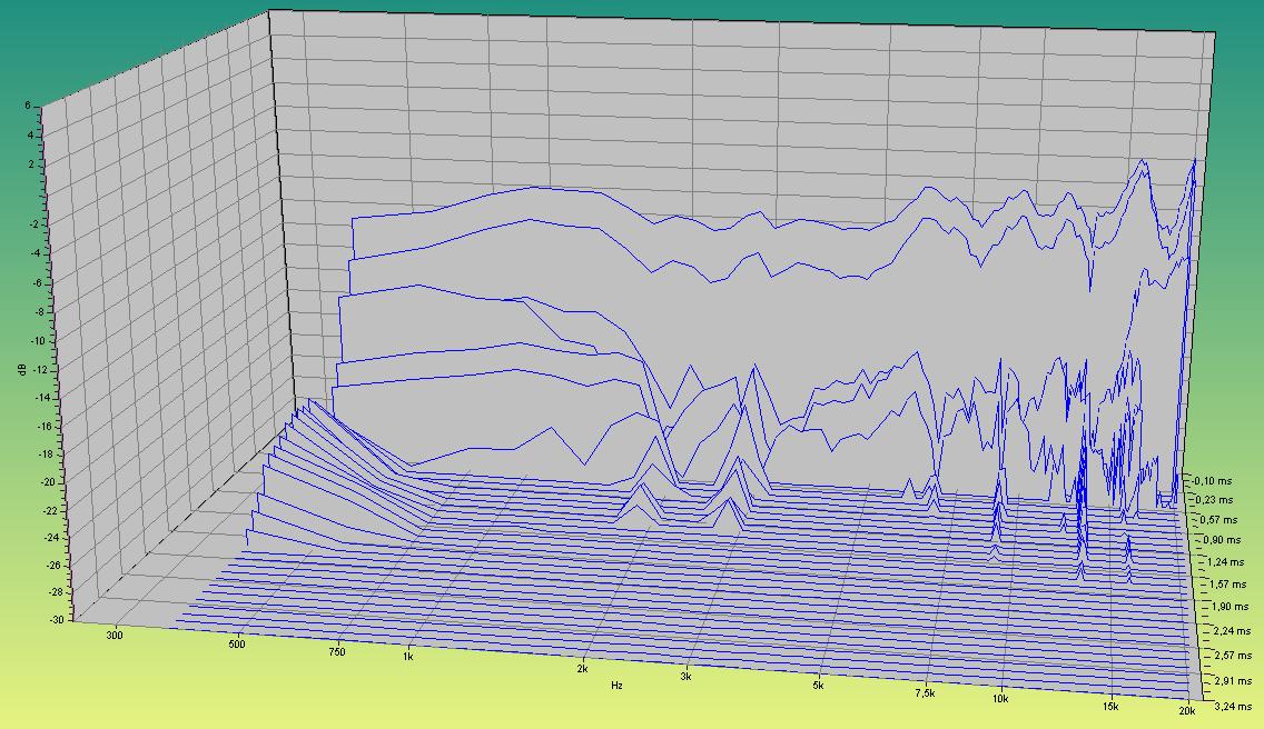

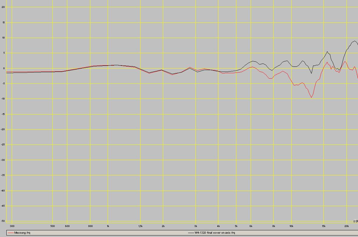

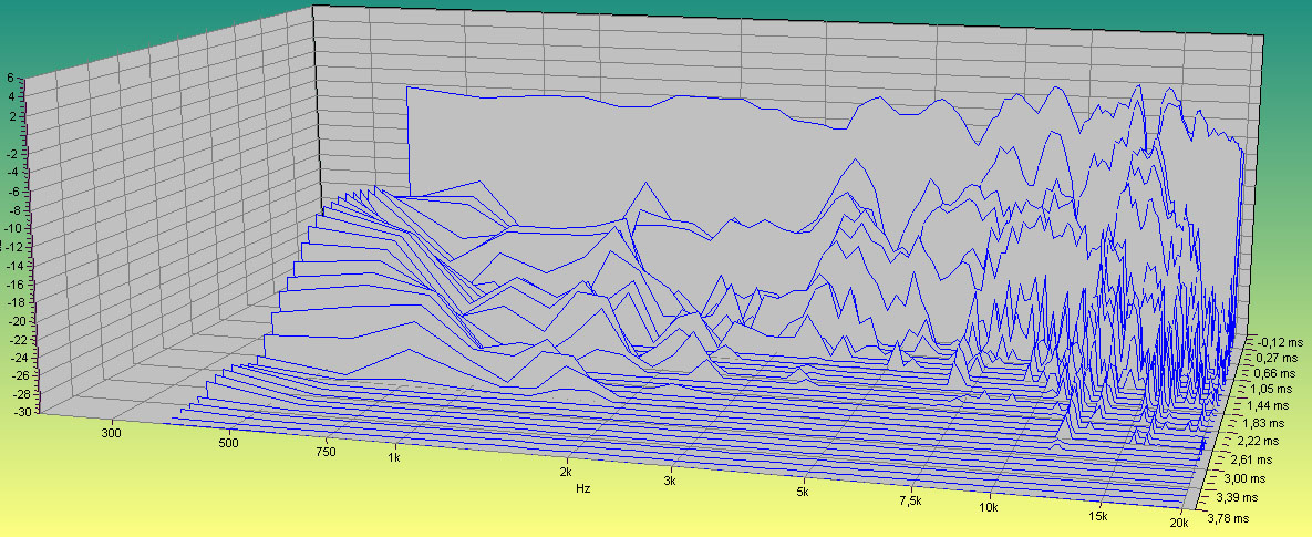

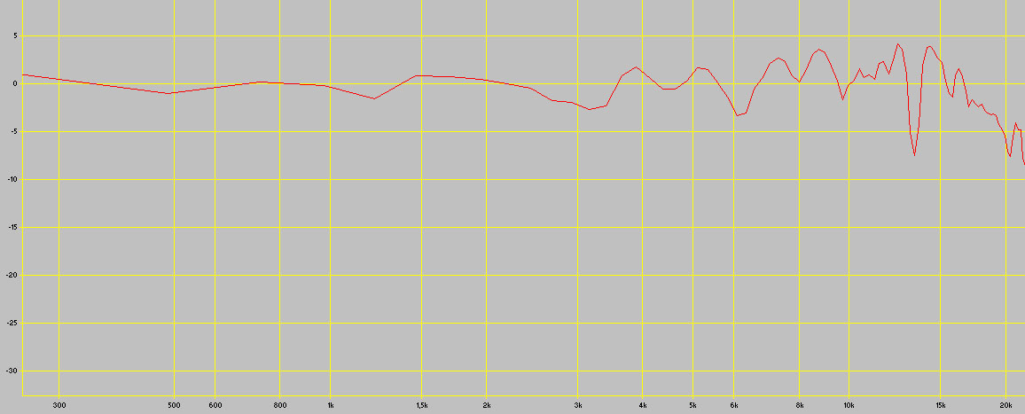

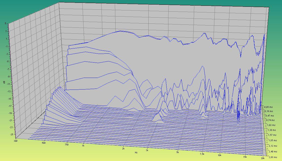

Here some pics with the drivers installed and the first measurements without crossover and without ambient tweeter. You an clearly see the bafflestep around 1.2khz and the peak at 6khz. The decay diagram is excellent, also at 6khz.

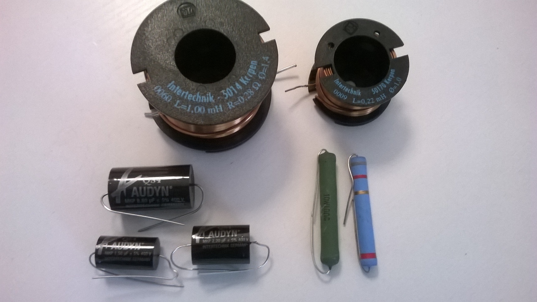

There are going to be at least two notches, one for the bafflestep and one for the 6khz peak. I might want to use three notches, one extra centred around 3khz so i can fine-tune the response with the resistors of each notch.
It might sound like overkill but I want to get the most out of these monitors 😉

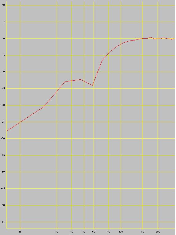

Nice response measurement. As you do not show response below 200 Hz, what so you expect the bass extension to be with the passive radiator employed? Also can you show the HD plots?

The cabinet looks very nice by the way.

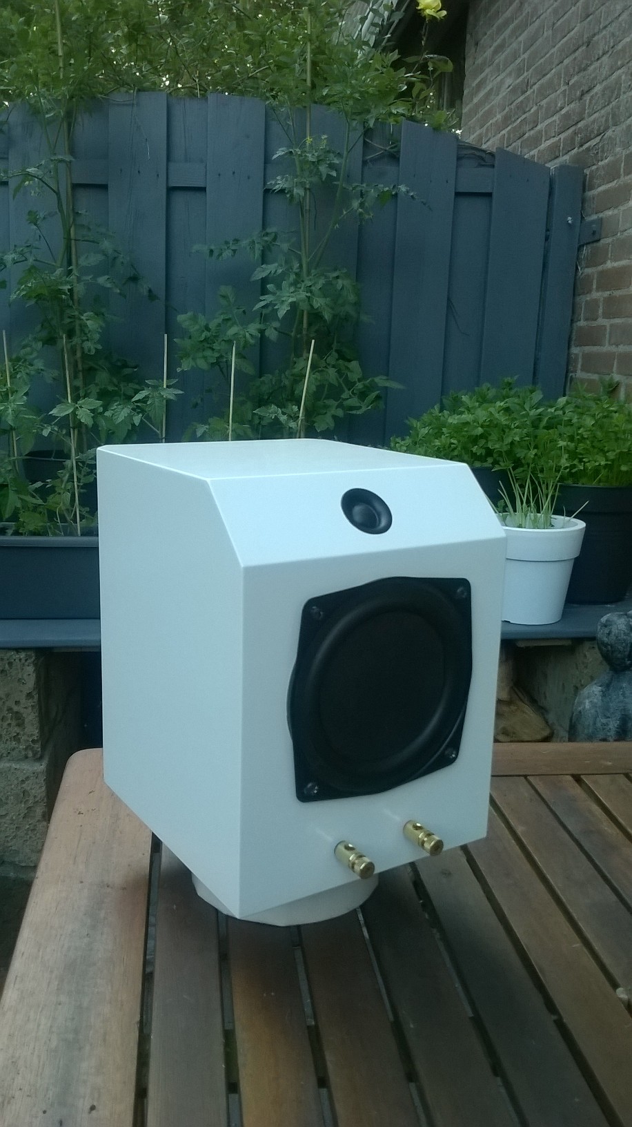

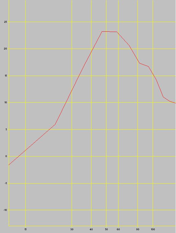

I did do some close-mic measurements of the W4 and the passive-radiator, I 'll post those later. The passive-radiator is active in the 45-65hz range.
I tried to close-mic at the side of the enclosure between W4 and the PR but it wouldn't give accurate results.
I'll try to do some HD measuremnets later.

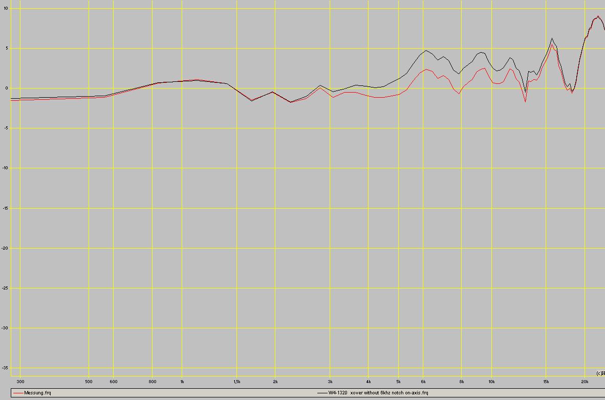

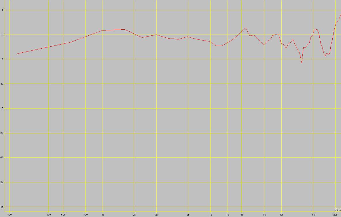

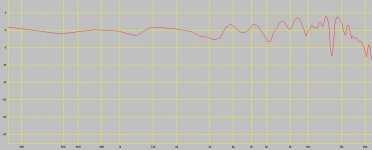

on-axis vs 20degrees off-axis, lookin' good 😉
Btw. this is the response without ambient tweeter.
Sound so far is beyond expectations, very smooth, the 2nd LCR just takes away the last hint of harshness.

Yesterday I've done some tests with the ambient tweeter.
1.5uf in series does the job nicely, the only thing is that the phase of the tweeter depends on the in-room position....maybe I need to add a switch to adjust the phase of the ambient tweeter 😎

This and tweaking the capacitor value about should dial things in nicely.
Yep, and measuring doesn't add anything here, it's really a matter of experimenting and listening what sounds "best".

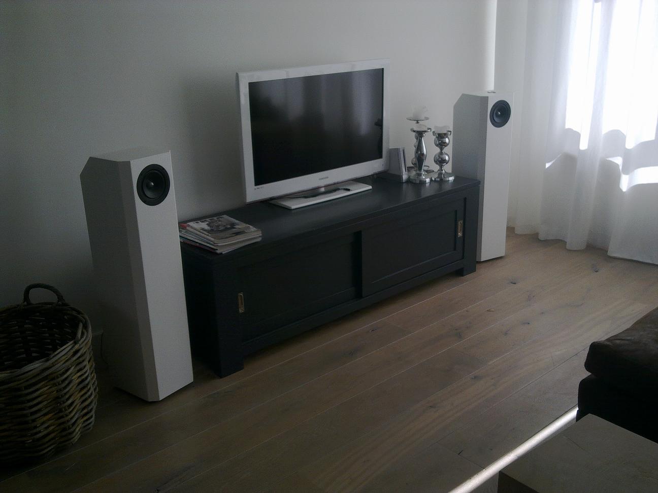

1st listening impression with one speaker.
-impressive fullrange sound, the low tuned passive radiator works great(45hz and up)
-room filling sound, the ambient tweeter does an incredible job, throughout the room the sound stays virtualy the same.
-vocals sound amazing
The speakers have impressed me(and my girlfriend 😉 ), there's no need for larger speakers in your average livingroom.

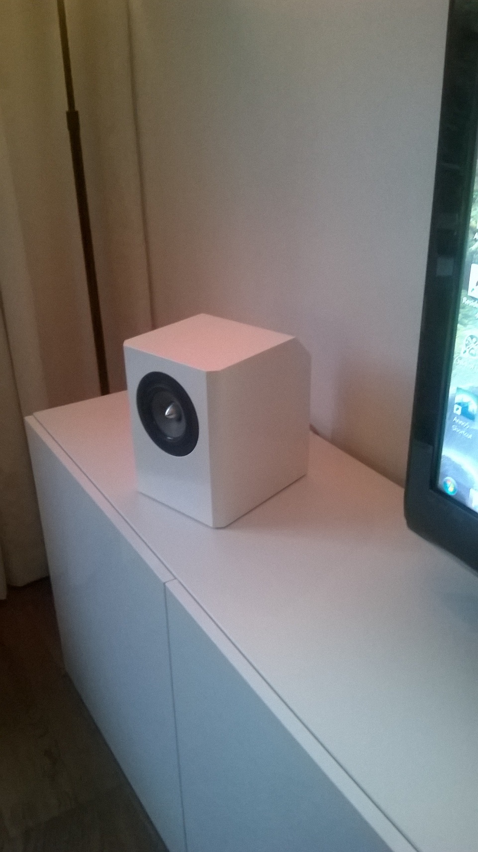

- Full Range
- Micro FAATT with W4-1320 SIF and ND16FA
