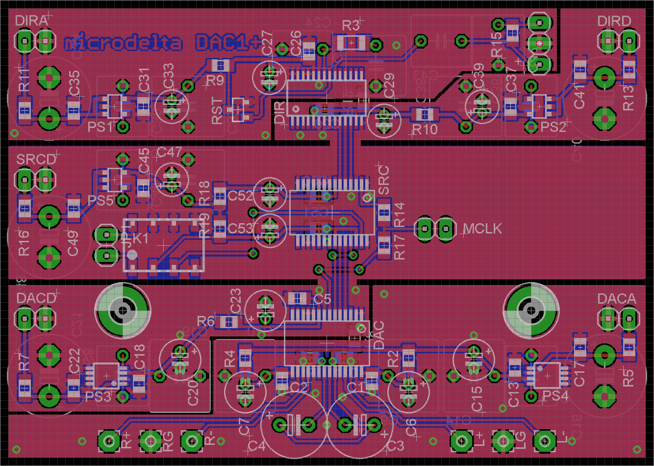

Wish I knew that, too... I'm just trying to remember some old tips from pwatts, and winging it from there. With any luck, it'll sound OK. And a Zapfilter from L C Audio takes care of the I/V for me, so I don't have to muck about with that. As long as it sounds better than my old Pioneer CDP with a hopeless powersupply feeding PSU sensitive PCM1702, I'll be almost happy. The "!#*% it" approach doesn't work too well when it takes about a month to have the boards made...

Well, you sure have the skills! Many board houses, like Olimex that I use, accept .brd files straight from Eagle. Just configure a design rule file to fit their standards (10mil minimum tracks etc.) and you're good to go. I dare say it's better for the final design, although it makes it difficult and slow to experiment.
I'm attaching a semi-finished screenshot of my DAC board with SRC. I'll make one without SRC, too, I have a feeling it won't make much difference with a good source like the Lynx AES16. The relay by the left screw switches between 96 and 192 kHz, so I can hook them all up to a simple IR board.

nice little project indeed ;-) Just two little remarks. First the PCM puts out a center current plus minus a signal current. This leads to an voltage offset over the I/V-resistors, which depends on the resistor values. Second, I also prefer the passive I/V conversion via firstclass resistors, but You might think of much smaller values than the 420Ohms in Your schematic. The DAC-outputs of the PCM1794A feature protection diodes which start conducting already slightly above 100mV. The results are quickly increasing distortion values. As long as You stay below 30Ohms the THD-values can be even slightly better than those that BB/TI claim in their Datasheet!
