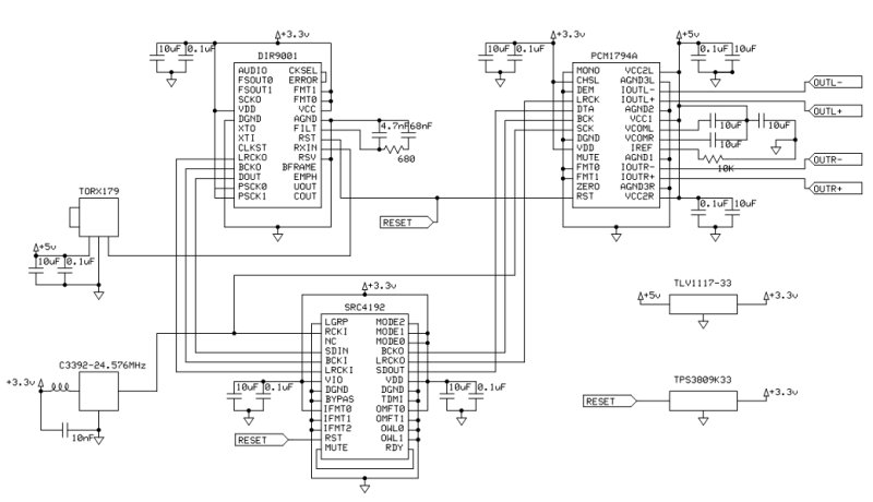

hello,
an impressive design, to say the least! i'm working on a similar design, but using a df1704+(2x)pcm1704... i'm curious, however, about certain aspects...
first, you have the DIR9001 set with PSCK[1:0]=11, meaning the output bit clock is running at 512Fs. however, the datasheet of the ASRC4192 states that its input bit clock, when running as a slave as yours is set to do, can run up to only 128Fs.
second, your 192/96 switch doesn't make sense. with the bit clock in master mode, MODE[2:0]=011 would give Fs(out)=RCKI/256=96kHz and MODE[2:0]=010 would give Fs(out)=RCKI/512=48kHz.
please correct me if i'm interpreting this information incorrectly.
thanks!

Hi Brad,
It's been a long time since I messed with this project, so I had to go back over the data sheets and schematic to refresh my memory.
I'm not an expert in this digi stuff, so please forgive me if I am just completely wrong.
About your first point, the DIR9001 is being used in PLL mode and the output is at Fs (48kHz in my case). SCKO is at 512Fs, but it's not even being used.
And your second point about the 96/192 switch is absolutely correct. I just now realized this after going over everything again. The toggle should have been set up like.....
MODE2=0
MODE1=1/0 toggle
MODE0=1
and not.....
MODE2=0
MODE1=1
MODE0=1/0 toggle

ah! ok. now i understand. for some reason i was thinking the system clock was the bit clock on the DIR9001, and you have completely cleared that up for me. thanks!
again, it looks like a great little dac. thanks for posting here about it.

Hi
I just need the SRC4192 to be at 96, is the schematic in my image are update to right way for 96 ?
There is 3 reset tag in your schematic, where do we connect them ?
Do that schematic need to be update and do it match your pcb image ?

Hi Paul,
Yes, that schematic is the one I use for 96kHz.
The 3 reset points are all connected together. It's one TPS3809K33 that controls the reset pin on the PCM1794A and the SRC4192.
