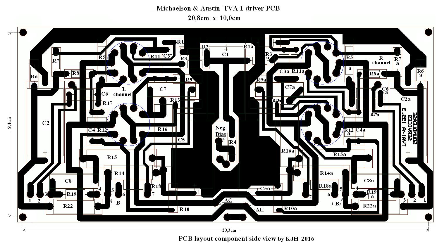

TVA-1 componentlist, wiring, driver PCB etc.

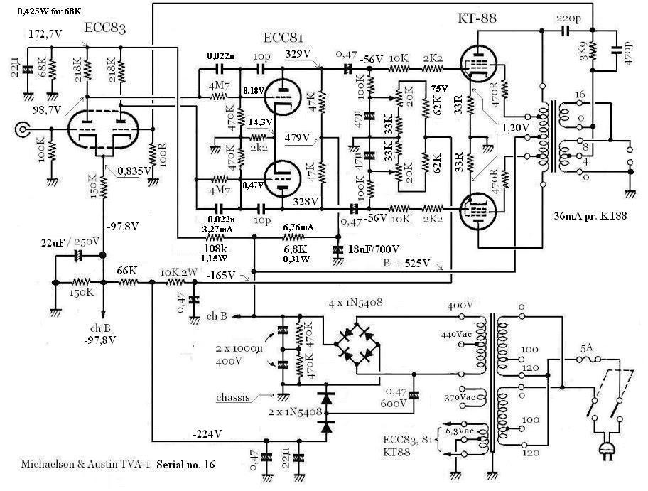

For repair and troubleshooting of the famous TVA-1 valve Amplifier from Michaelson & Austin , KJ2005 has drawn a diagram of the wiring seen from the bottom of the amplifier.
KJ2005 has been excluded from diyaudio.com by the moderator and owner, for no reason at all.

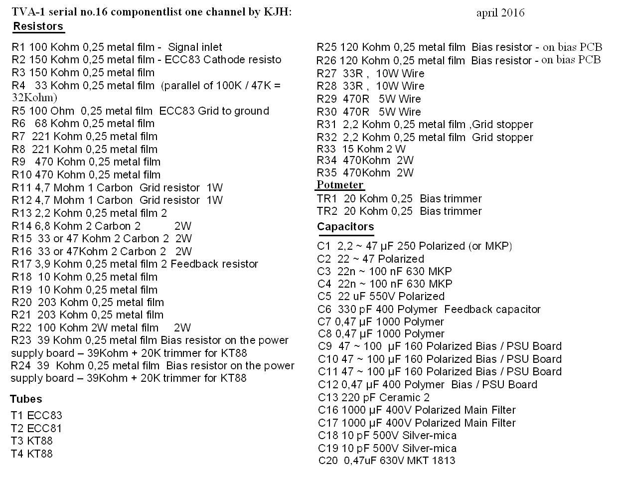

In order to help all TVA-1 owners this should be the first time that both the driver PCB, bias PCB, component list and hardwiring diagram is available for TVA-1.

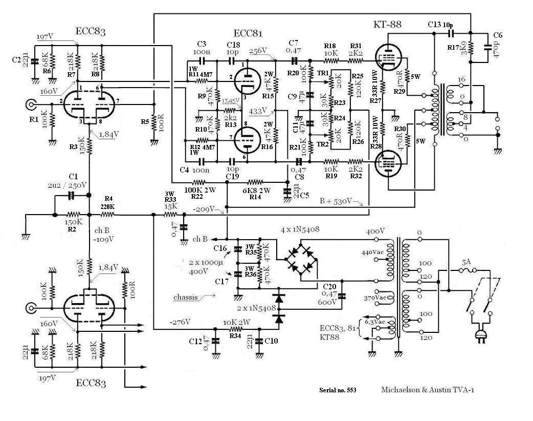

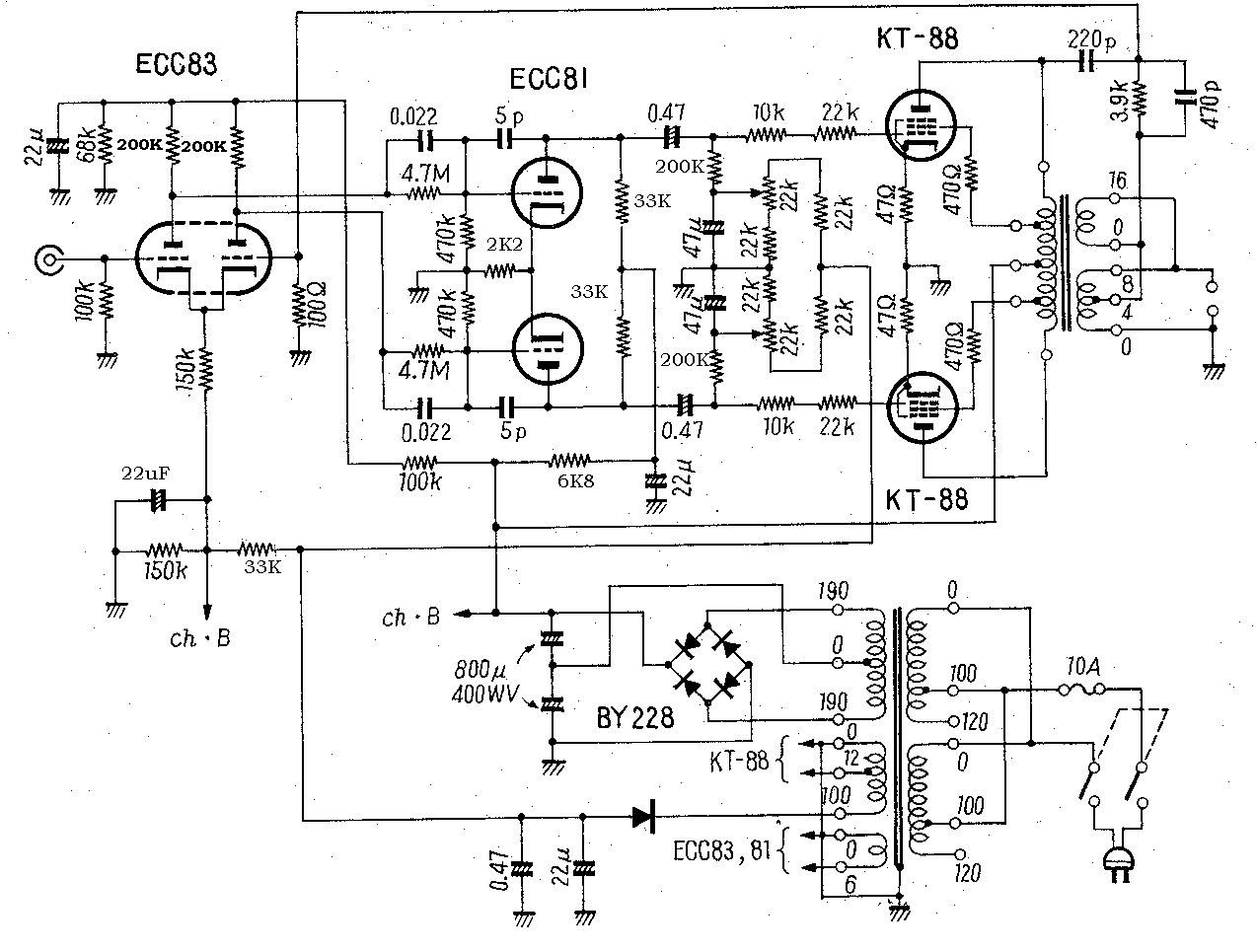

Schematic taken from TVA-1 serial no. 553
Notes:

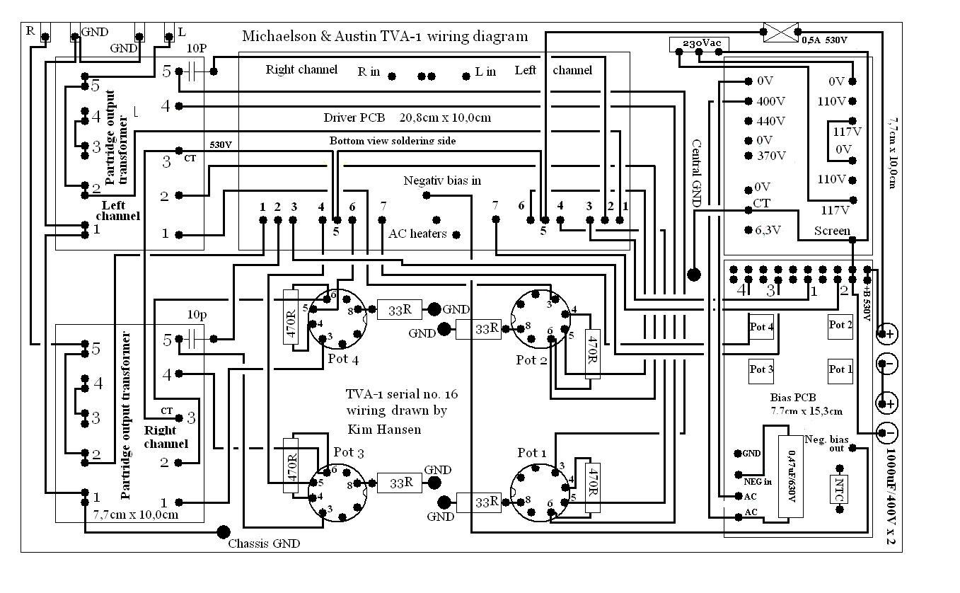

The 2016 wiring drawing is taken from Michaelson & Austin TVA-1 serial no.16 and there may be changes in component values at later amplifier versions.
Secondly : The owner of TVA-1 serial no.16 has changed the connections on the outputtransformers from 8 Ohm to 4 Ohm.
When available the original 8 Ohm wiring on the Partridge OP-transformers shall be shown in this thread.

Michaelson and austin rev. drawing 2016 incl componentlist.JPG131 KB · Views: 721

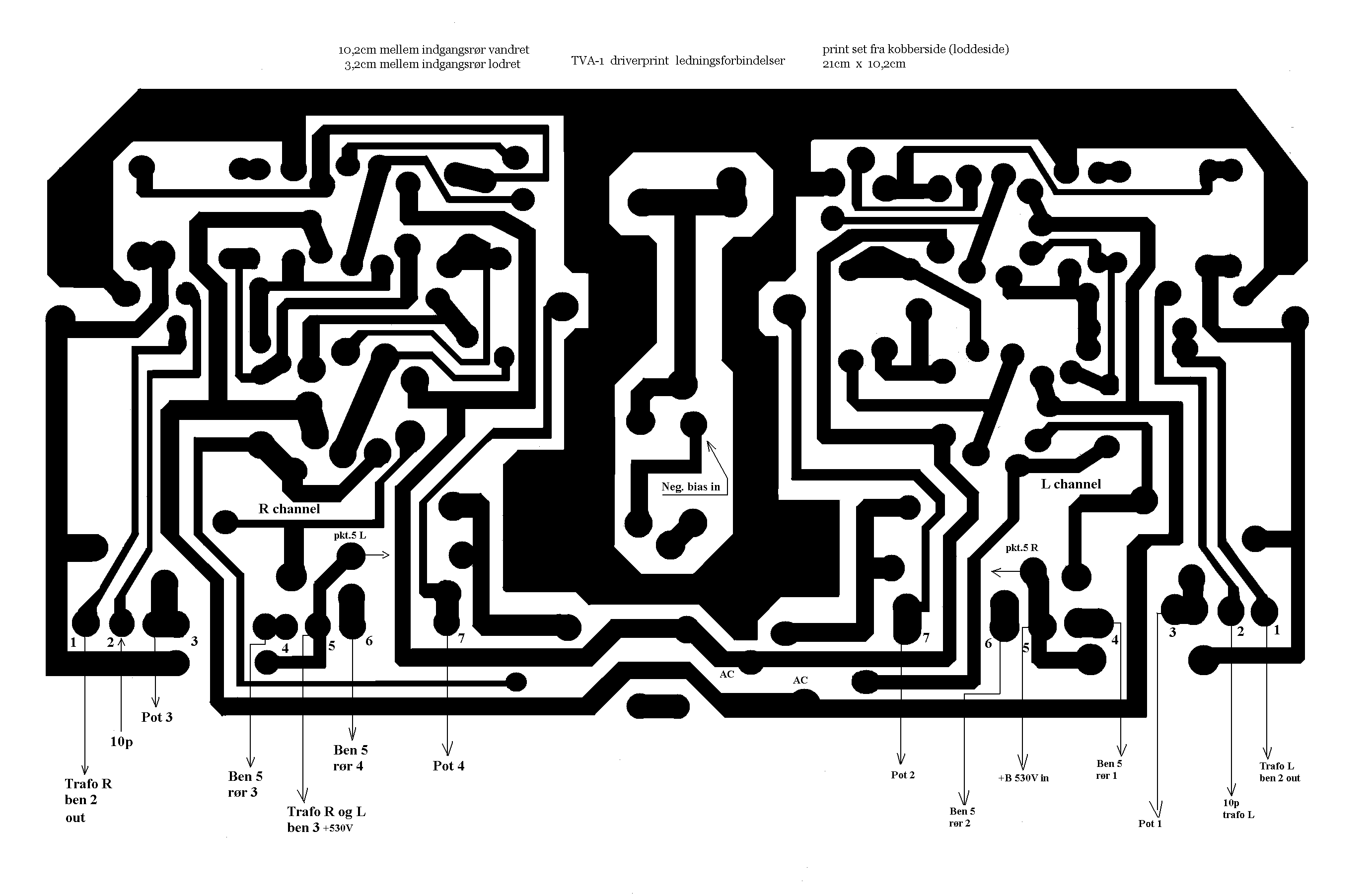

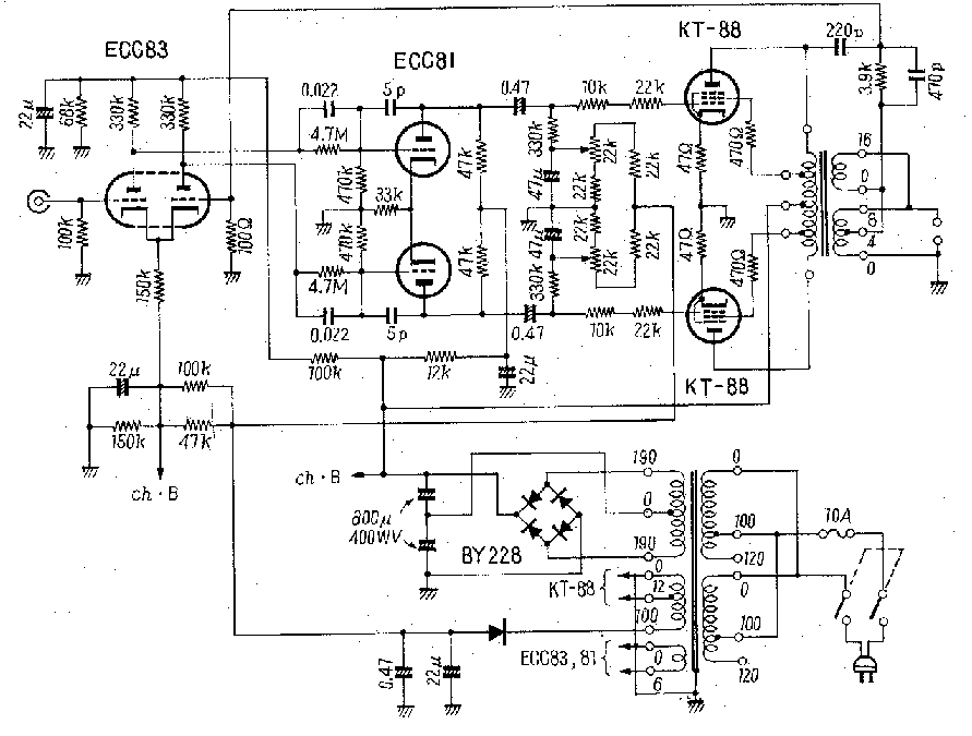

Another question is the size of the main transformer (AC). On the erly TVA-1 versions the main transformer is smaller (lower) than the outputtransformer. Up to serial no. 553 the main AC transformer is still the smaller type. At which serial number changes the size of the main transformer on TVA-1?
At the point of ( larger main transformer) the TVA-1 serial number where the heater current was increased, the secondary tapping points on the main transformer also changed.
The smaller main transformer had 0 - 400 - 440Vac on the secondary and 0V - CT - 6,3Vac for all heaters (thats it). ......minor change on serial no. 553 where 0 - 370Vac was added....
The later versions (larger size) of main transformers had 190 - 0 - 190Vac , 0 - 12 (KT88)- 100Vac(bias) and 6,3Vac for ECC81,83
Any information would be highly appreciated.

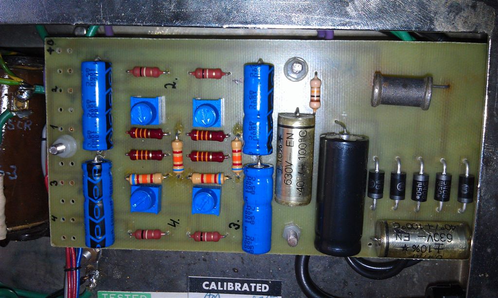

Hi Paul,
If you are still working with your TVA-1 amplifier, I should inform you from Kim, that all details concerning the circuit is now available. The special inrush 416 R ntc resistor will be hard to find these days.
The central ground on your TVA-1 was located exactly the same place on the serial no. 16.
You have been most kind...thanks for sharing your pictures from the bottom of your TVA-1.🙂

TVA-1 serial no.16
recieved from KJ2005 .......
An early TVA-1 serial no.16 from Michaelson & Austin renovated and the actual amplifier schematic circuit written down including measured voltages...
Note changes of resistor values in the bias circuit.......
Gold Lion KT88's running smoothly at 36mA by 525V........

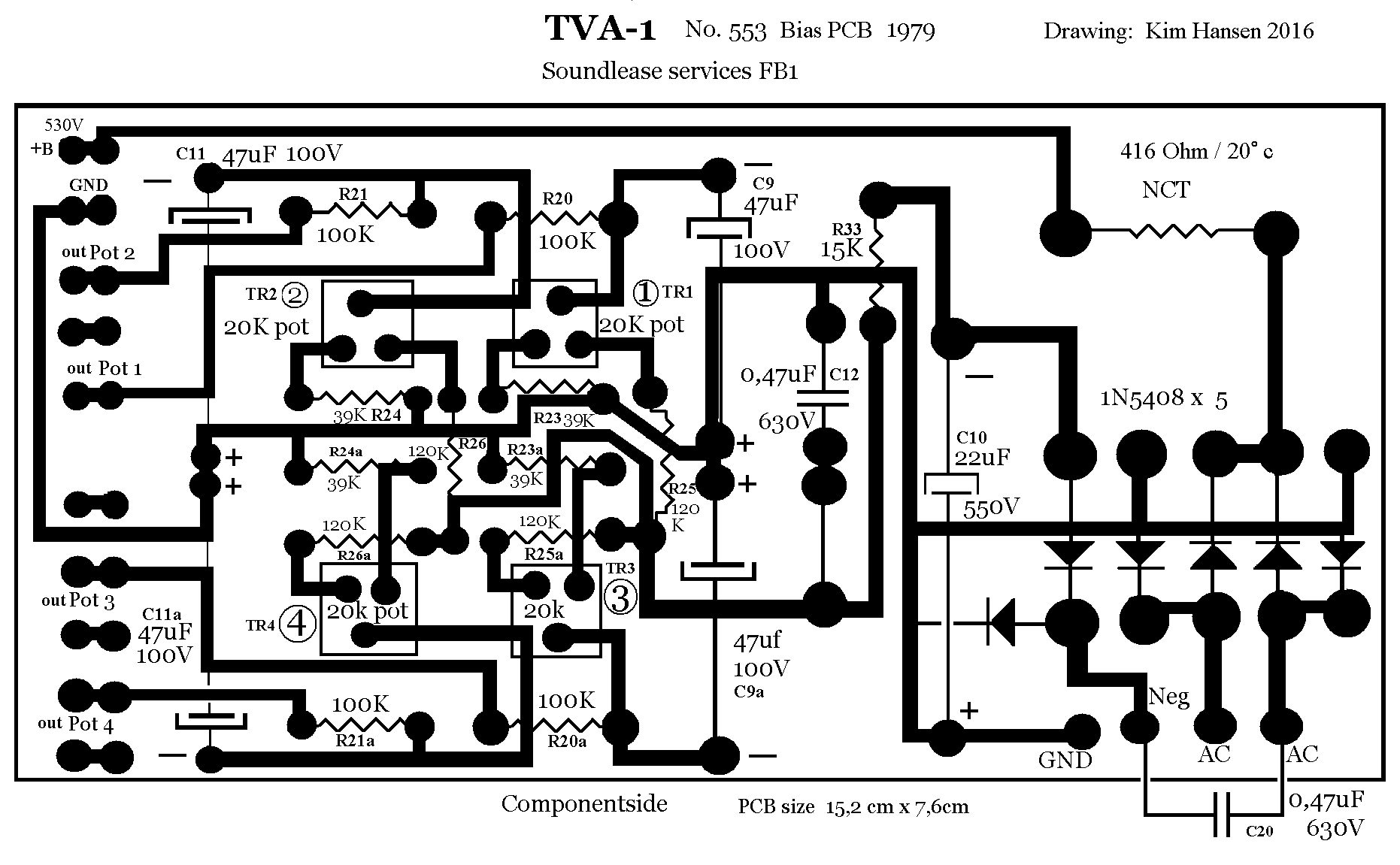

The 416 is not a resistance, it is a thermistor type. They are made by Semitec and are still available. The question remains which one? I used the largest one I could find, 16R, with the highest power rating. Seems OK so far ;-)
Does somebody know how the delay relay is supposed to work? I mean I can see that it counts up to 40.96 seconds in the 4020 and then grounds the PSU earth, but in the meantime the HT has been about +100V and the negative bias about -750V, which isn't good for anything; then when the relay kicks in the HT correctly goes to +560V, but the negative bias goes to ZERO, which causes massive plate current to flow, then sinks down to the correct level (-75V in my case) over 10-15 seconds. Which blows the T0.5A HT fuse sometimes. This cannot be right. Any clues? I've changed the bias pots and resistors around them to something like VR=22K and 39K to ground, so as to get a bias adjustment range of -75 to -48V for various valves the owner is planning on, and I put in the above-mentioned 16R NTC resistor, but no other changes.
Well I never did fgure that out, but I changed the cathode resistors to 100R, which controls the inrush to something 200mA for only a few seconds, then it sinks down to 36mA as the negative bias comes on. It results in 3.6V on the cathode when correctly biased for 36mA, so it doesn't have too much effect on the bias chain values. If I was doing it over again, which I won't, I would use 150R or even 220R, and if I was really doing it all over again I would use 1K2 and get rid of the negative fixed bias chain altogether.

Sorry to rattle an old cage, but does anybody know what the Ra-a input impedance of the TVA-1 amplifier's output transformers was ?
i know it had two separate seconday windings: 0-4-8 ohms for speaker output and 0-16 ohms used for feedback to the input/phase splitter stage.
The thing is, was the Ra-a the standard datasheet 4kΩ, 5kΩ, 6kΩ, 4.5kΩ or what ?
i personally suspect it was 4.6kΩ, having had a pair wound many years ago.

For repair consider the schematic that A. K made, first attachment :
https://www.diyaudio.com/community/threads/tva-1-export-circuit-schematic.131000/#post-2324542
A factory schematic is in post 24 here :
https://www.diyaudio.com/community/threads/michaelson-austin-tva-1-info.123806/page-2#post-2016244
I had a look at my personal service notes today :
In early schematics like that in post 1 you see the voltage for output tubes heater
is described as 12 V and in fact each channel tube filaments are wired in series. I
found this was a bad idea and added a centre string between channels at the points
where two tube filaments are connected.
I seem to remember I grounded this new centre instead of one of the transformer
wire ends. The added wire also helps to balance the filament voltage distribution.
Since in the diagram of post 1 the negative bias voltage is derived here you would
want to check any change in this respect also.
This model has useless fuses in the speaker outputs. The fuse holders are of bad quality.
I replaced them and rewired as plate fuses.
A connection of pin 8 with pin 1 (suppressor grid) on all output tube sockets is useful,
because many people use this amp with EL34 tubes.
I disconnected the ground wire of the small signal tubes heaters and made a "balanced"
wiring using the standard 100 ohms pot with wiper to ground - you have to find a suitable
place for it.
All in all these changes made the operation of model TVA-1 more reliable.
