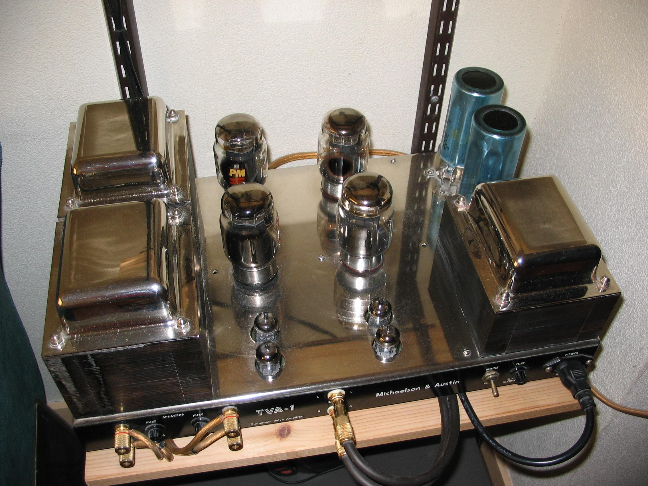

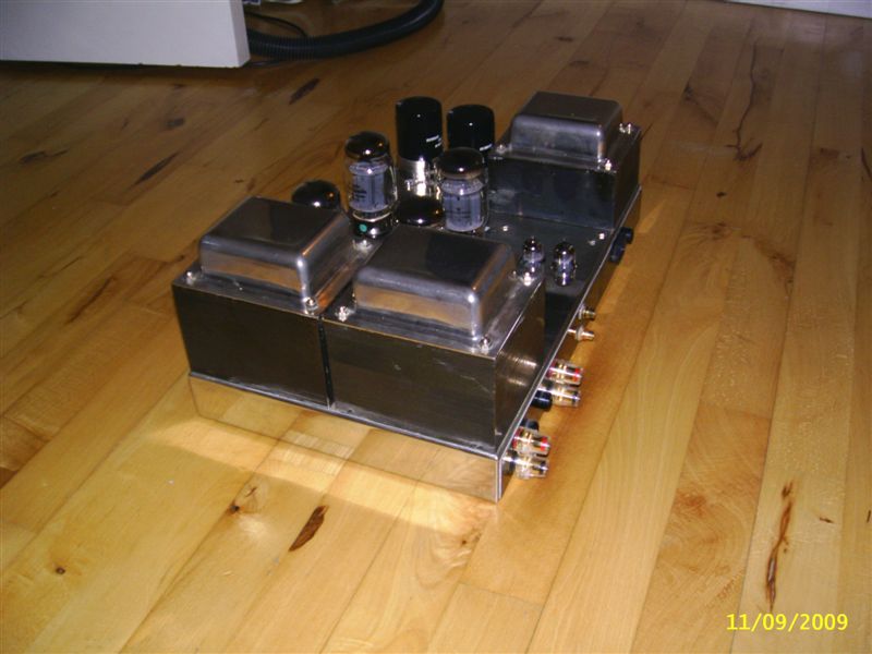

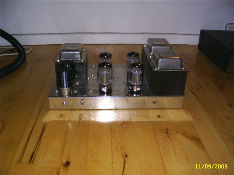

The TVA-1 from Germany just arrived. See attached picture.
Question:
Anybody who knows whether the Tungsol 6550 reissue an/or the TAD 6550C can be used as replacement tubes for the mounted KT88 EH in the TVA-1 as far as 530V is concerned? Don't we say max. 500V on the plates for 6550?
regards
Kim

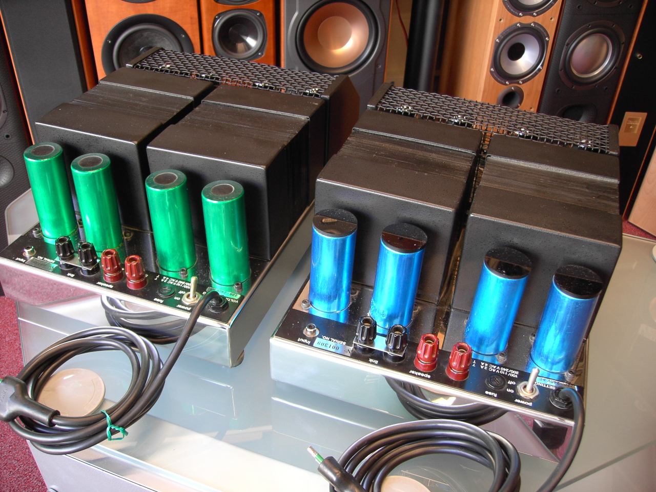

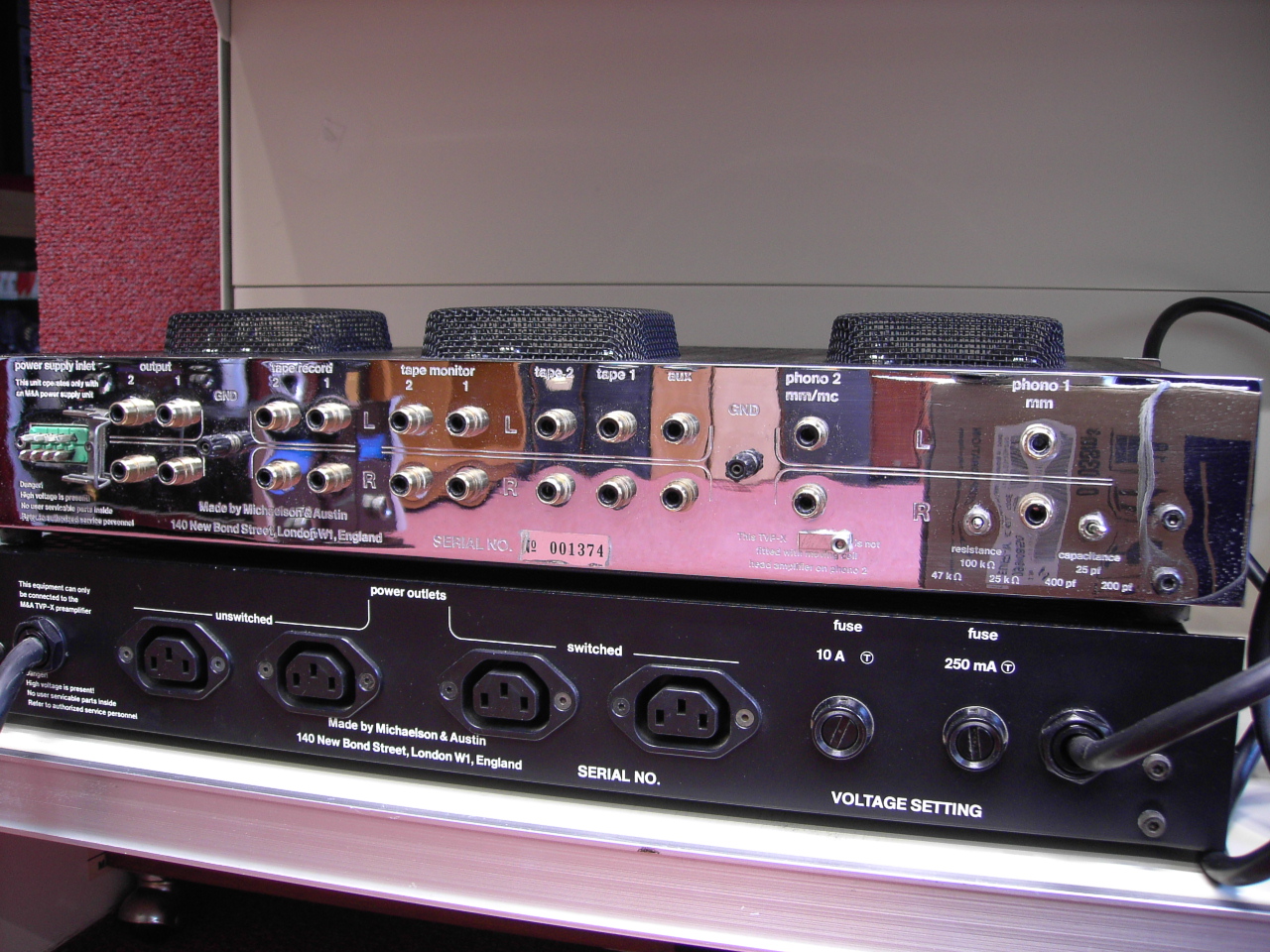

Herewith I send you some information about the tva 1. I am a collector of Michaelson & Austin.
Hi Rob,
Thank you for some beautiful pictures. I have never seen the M100 neither the TVPX 1.
Did you attach any paper documentation at this message? - if you did ! - I have not received anything by mail.
I will try to copy the TVA-1 circuit, just to check if it is possible to achieve or come close to the original M&A sound. The TVA-1 sounds just nice on AR3a!
