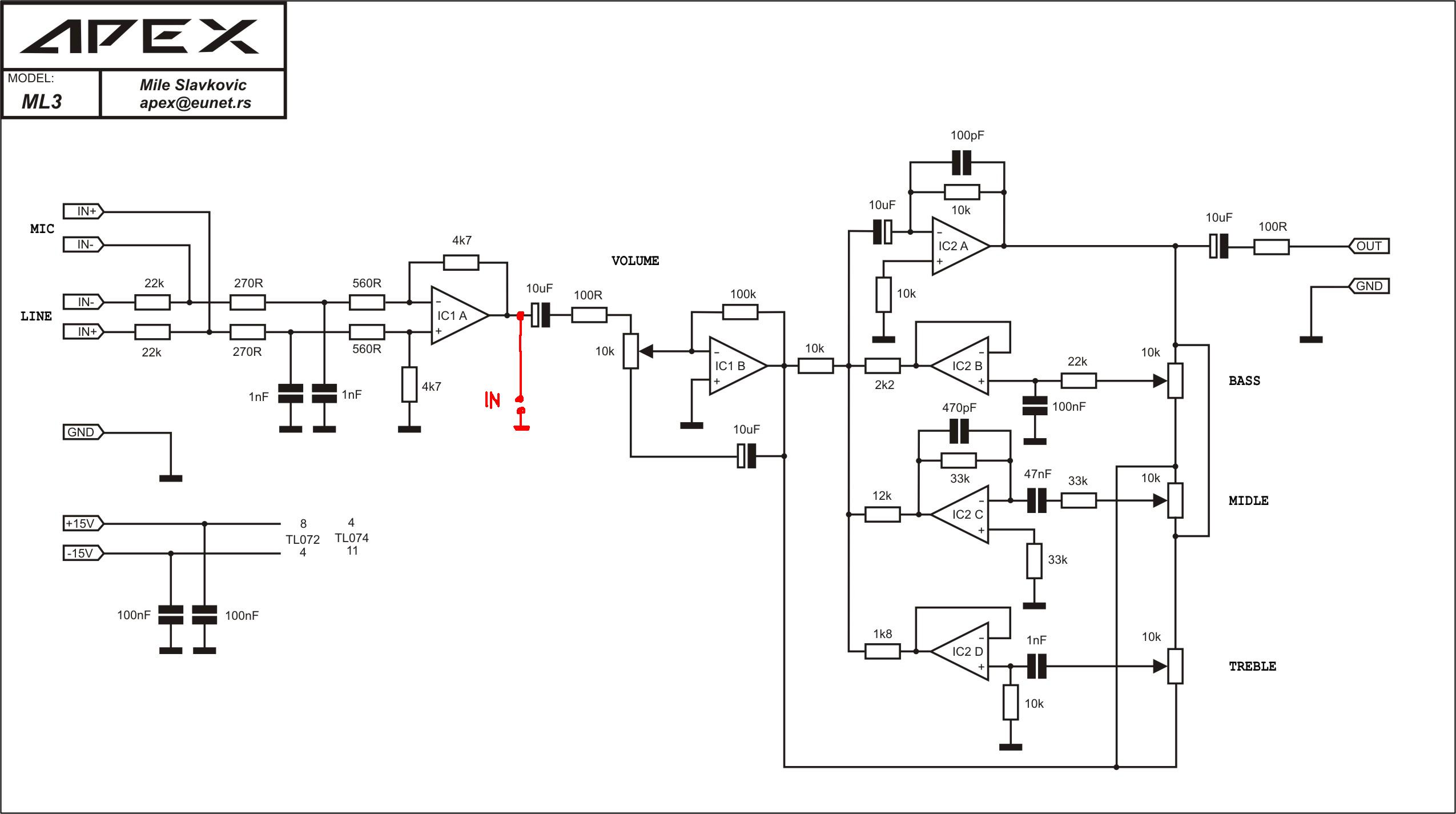

i checked crown i.t4000/8000 manual
and found that it has provided another xlr connectors the signal at these connector is paralleled with the input signal for feeding the signal to another amplifiers
can i use post #73 and add another XLR connector for feeding the signal to another amps?

Yes with balanced input/buffer (post #73) you can use any amp you want in paralel connectin,
Regards

Hi, some or even most of the pro amps this day have link out male XLR balanced out to daizy chain multiple amplifiers.
Apex had also posted a balanced input pre amp with link out XLR port, that would I think fit your requirement.
Thanks, good luck:
