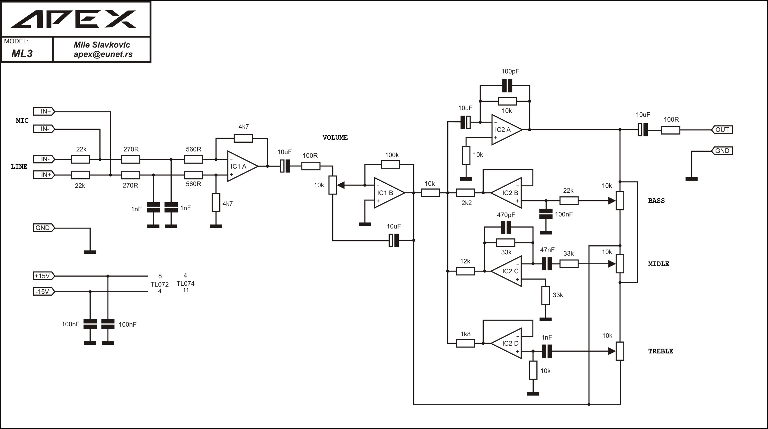

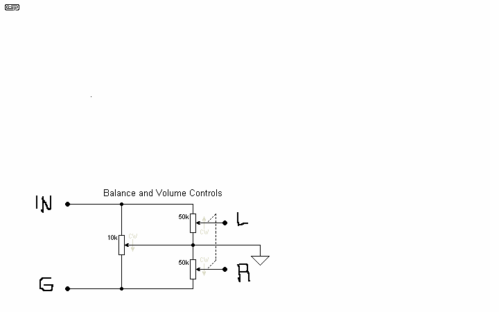

ML3 is general purpose preamp, can be used for mic, guitar, keyboard... or channel preamp for diy mixer.
apex,
when using as diy mixer
or multiple inputs how to make the main volume
suppose i will be making 10 individual pre amp(10 channels)
You must make 11 individual preamps (10 channels, 1 master) for mono mixer, or double for stereo.apex,
Yes with 'panorama' pot on channel output.apex,
can 10 channel mono input have stereo main/master
regards
No, you can mix mono and stereo channels with this circuitapex,
is this a panoramic pots?
10k balance
50k L/R master out?

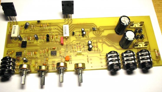

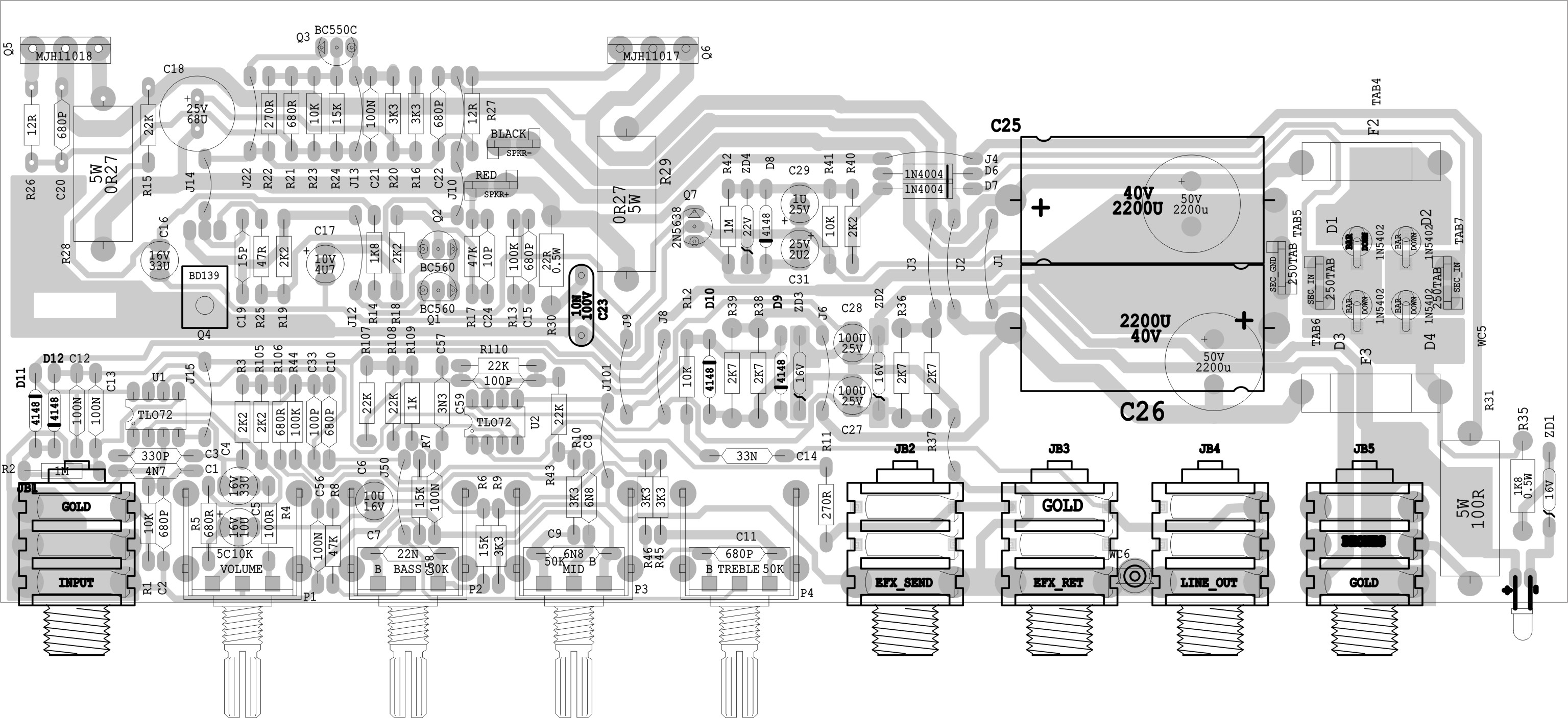

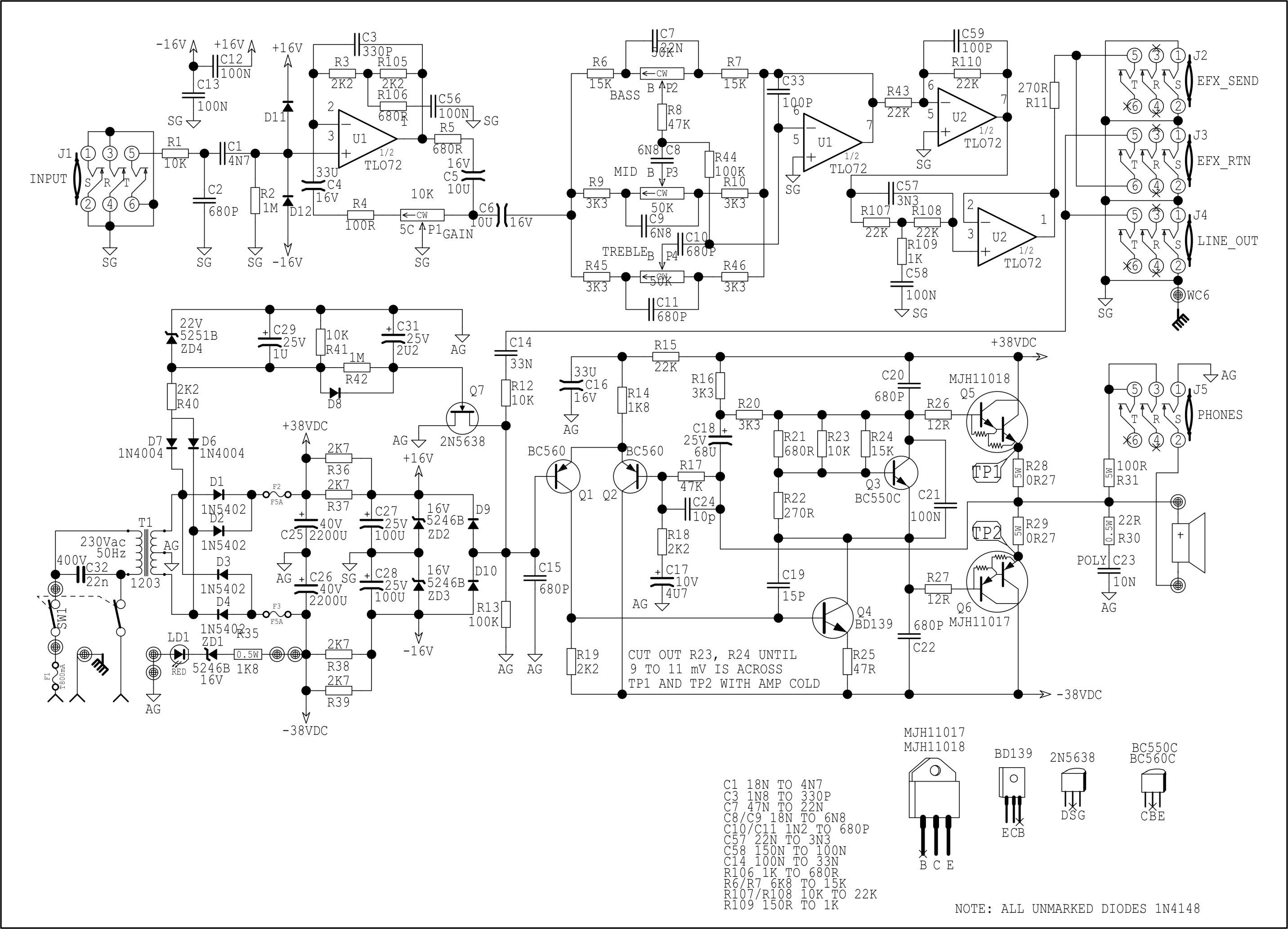

Is anybody interesting about 100w guitar amp?
Hi apex,
power amplifer is inbuild on this PCB🙄 so nice😀
vijay

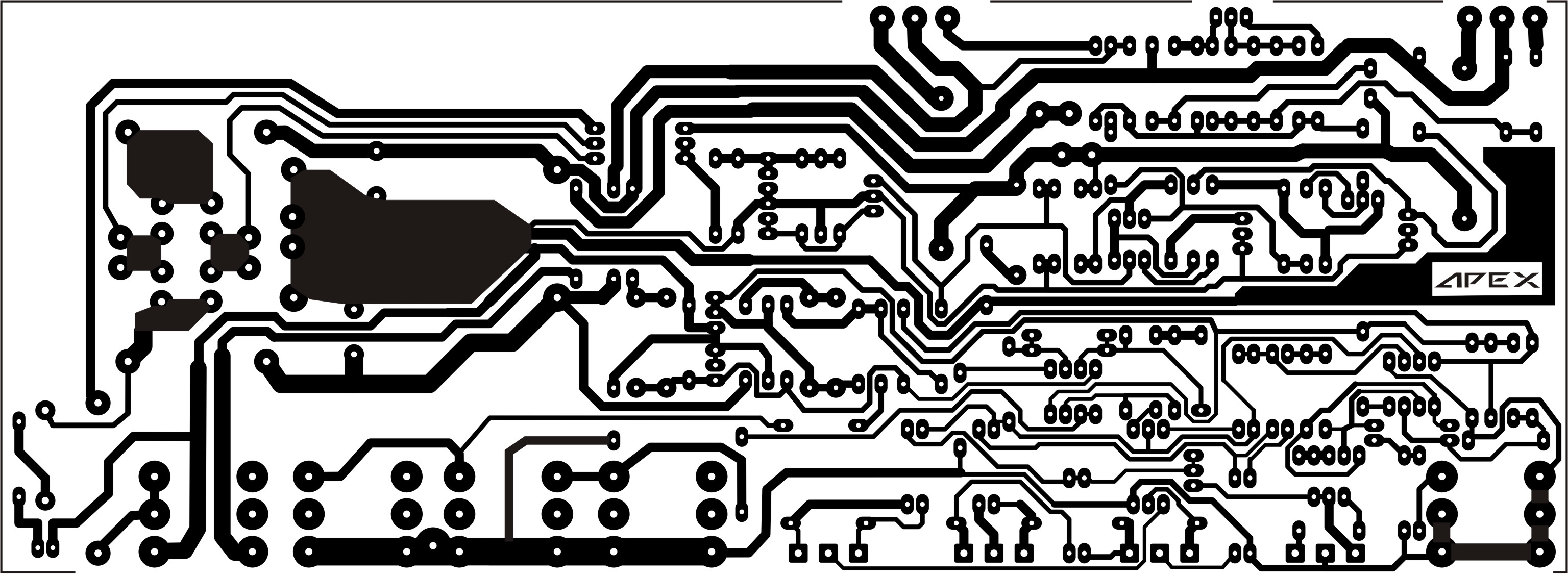

hI APEX,
What is the actual size/dimension of the pcb and by any chance the replacement part for the output transistor?
Thanks and regards
Thanks and regards
PCB size: 260x95mm, you can use any darlington pair BDW83D/BDW84D... or TO3 MJ11015/MJ11016...hI APEX,
