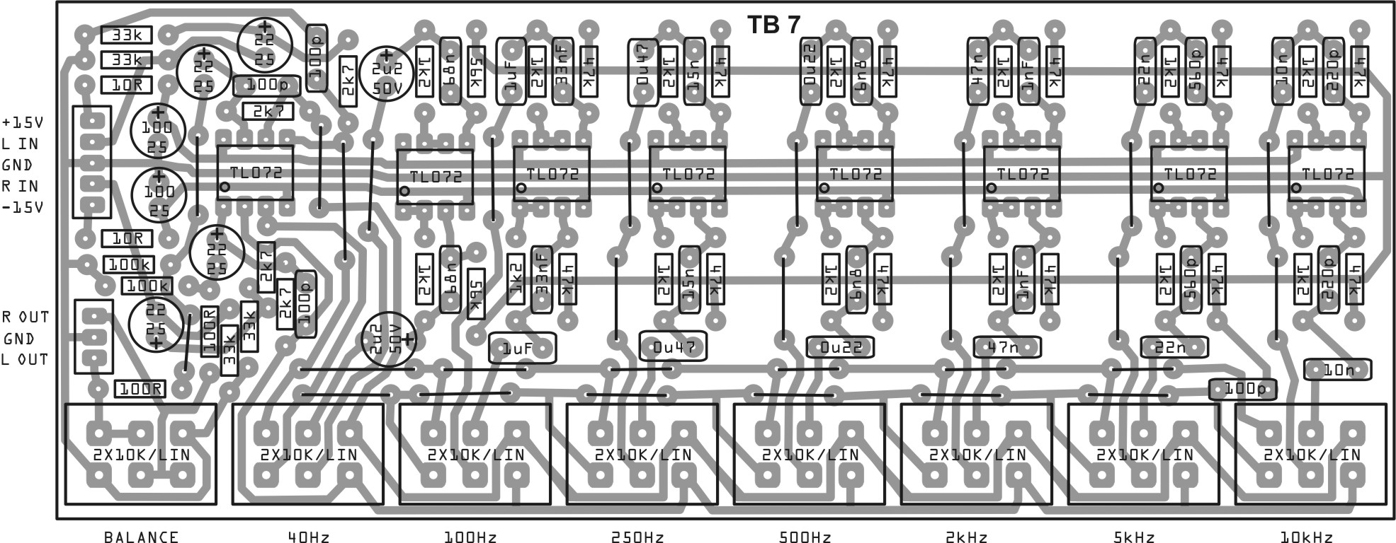

Apex Equalizer
i want to use 10k pot for this equalizer
is it posible?
how can i use it ?
EQ10
is it posible?
how can i use it ?

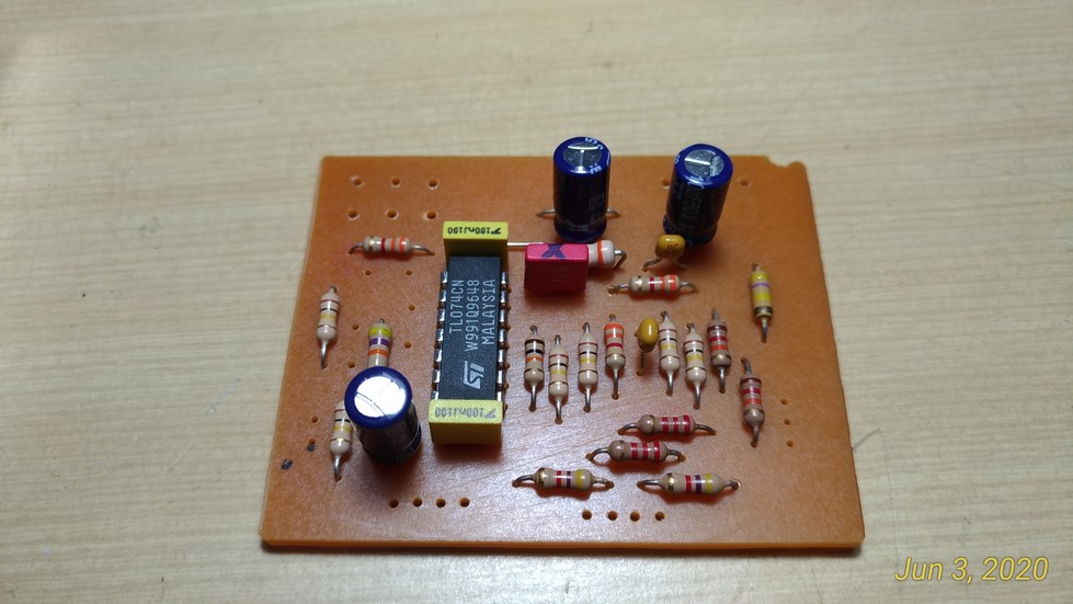

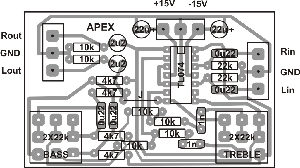

First of all, thankful for the published schemes. Is it possible to use this preamp in conjunction with this tone control? I have an old chassis with 100k potentiometers, is it possible to use them here, if possible, what changes should be made?
Thankful
Thankful
Stereo tone control with +/-10dB bass and treble adjust.
Mr.Mile,
How to modify this board for more boost +/- 20dB? Will changing the pot from 22k to 47k or 100 k improves the boost? I have been using this tine control for many years,and i should say,this is one of the best tone control circuits. It has got no midrange modification when boosting treble.Also, its perfectly neutral when pots in mid position.I have some usb mp3 modules,which needs more bass and treble boost, Can you please suggest me how to use the board for increased boost?
Thanks in advance

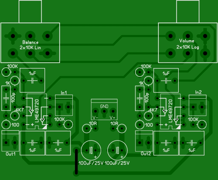

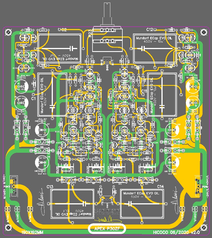

I would like to ad a Balance Pot to the P30zf. What is the best value and connections that you would suggest to follow your original design ?
Do we have also to change value of the volume pot and resistors around ?

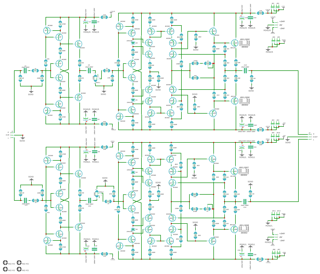

hi mr terry and mr mile,
i finish guitar amp but i read +/-17.4v at tl072. is this problem for this amp?
my rail voltage 28vac.
thank you for answer mr terry.
zd2 and zd3 16v zeners have 17vdc and at zd4 22v zener have 20vdc. and at the 0R27 5w resistors have 0,7mV
do you think it will be problem?
and speaker output red and black connectors have 4vdc 🙁((
ah i forgot i use bc547 for bc550. i cannot find bc550 the dc voltage at speaker out can be for that?
BC547 should be fine. What measurement are you getting from TP1 to TP2? Should be around 14mV.
its working. i dont connect JB3 and JB5 when i look on schematic i see signal going on that jacks. so i just short them and then amp singing. dc voltage at speaker out gone too cause of JB5 taking ground to speaker. i am soo happy for this 😀😀
but tone controll is not enough bass i think and i dont think this giving 100 watt. any one know how can i calculate it withouth scope???
