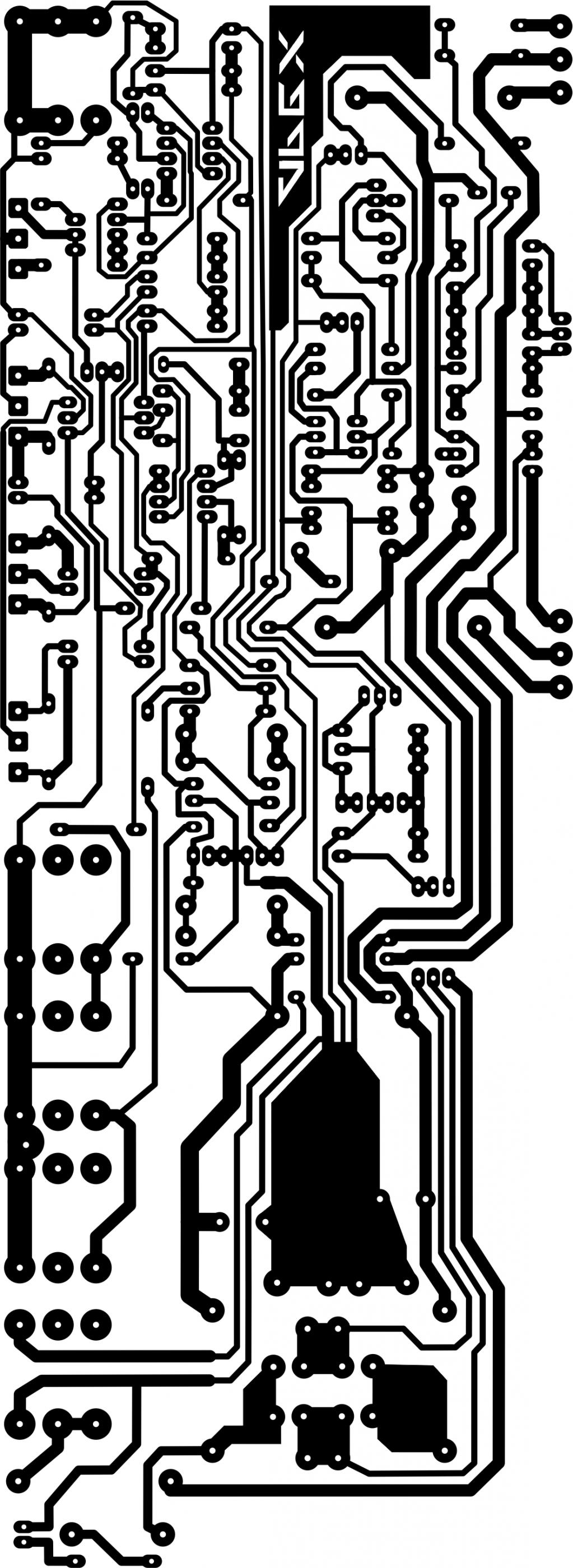

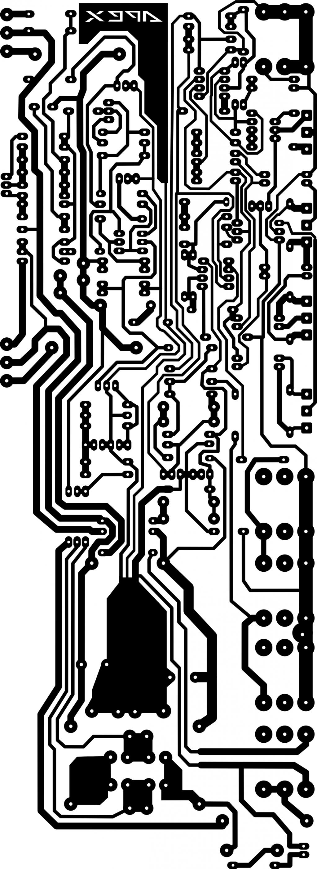

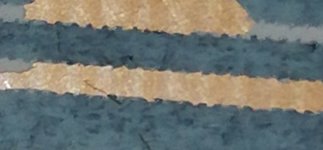

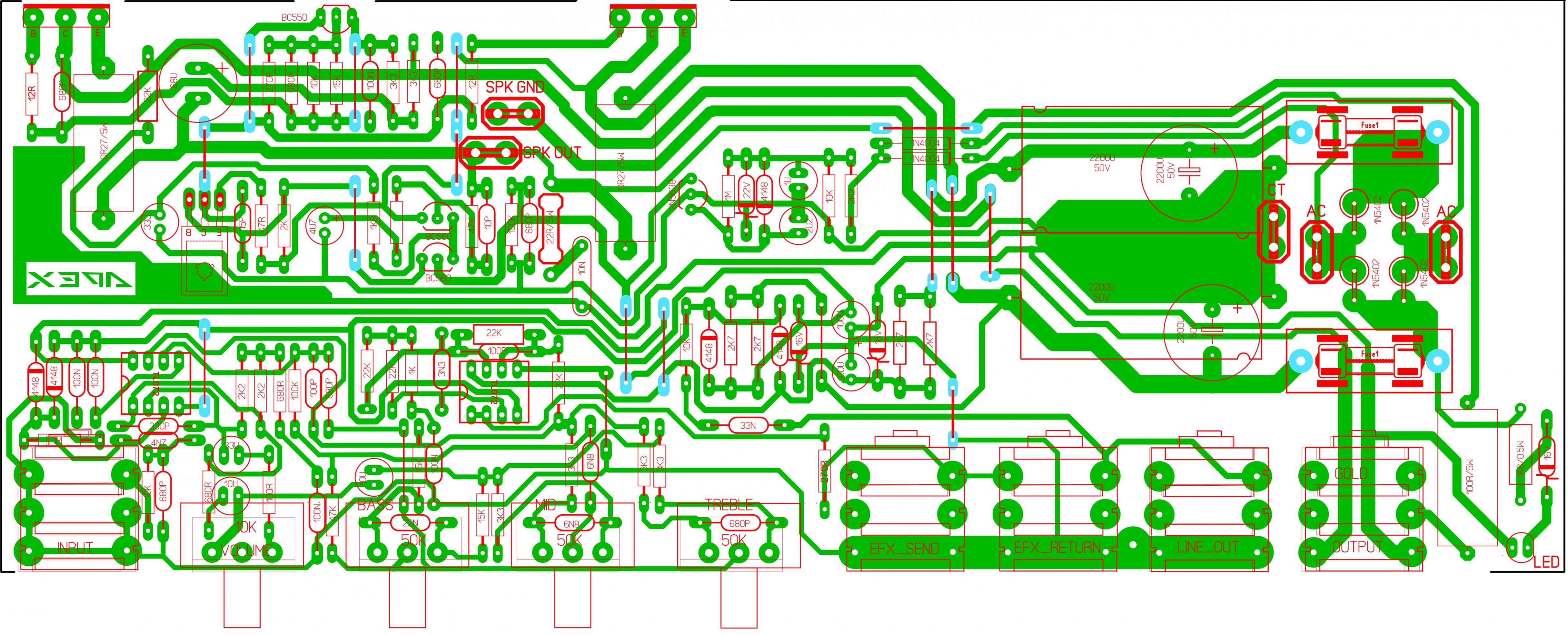

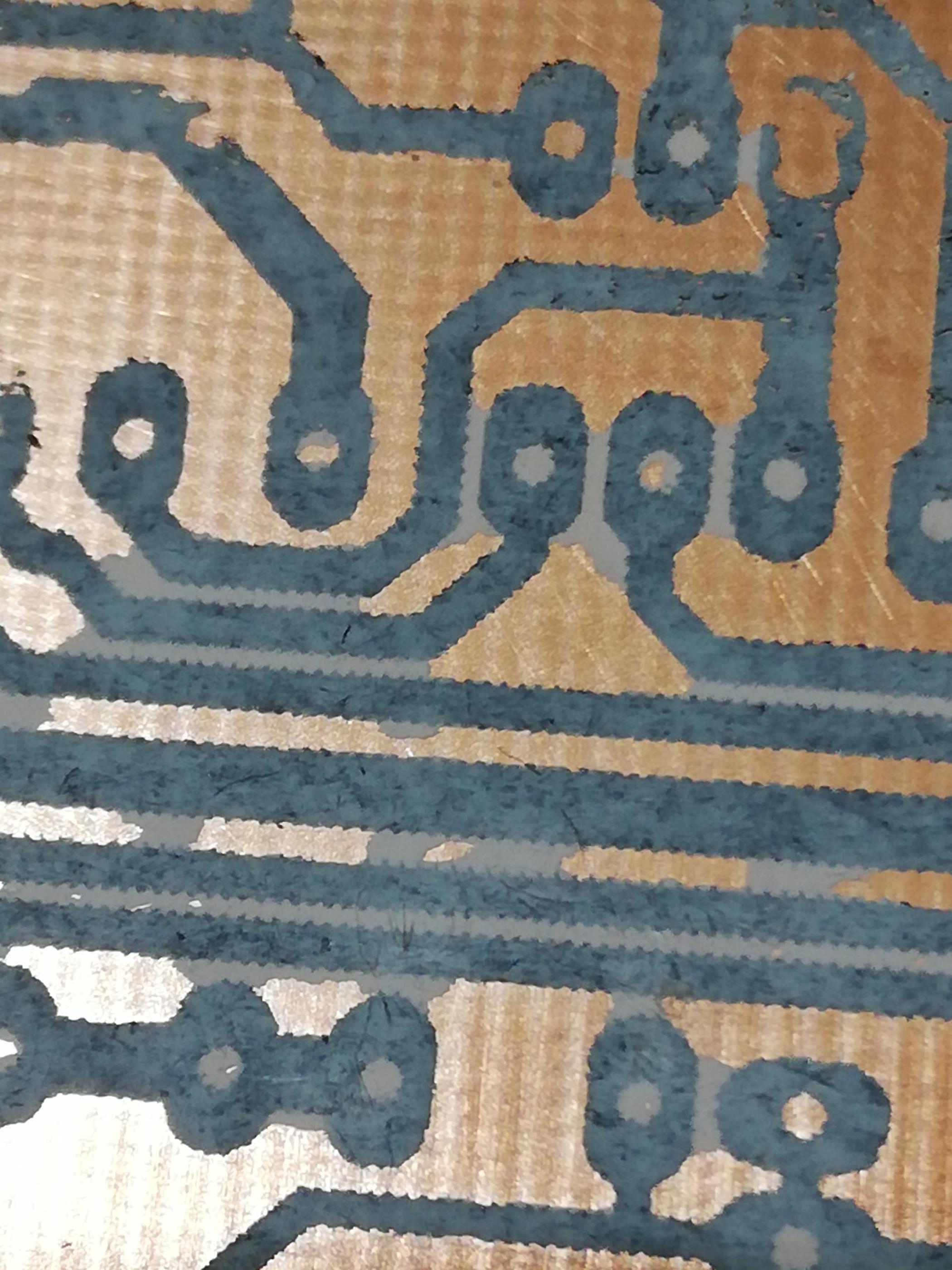

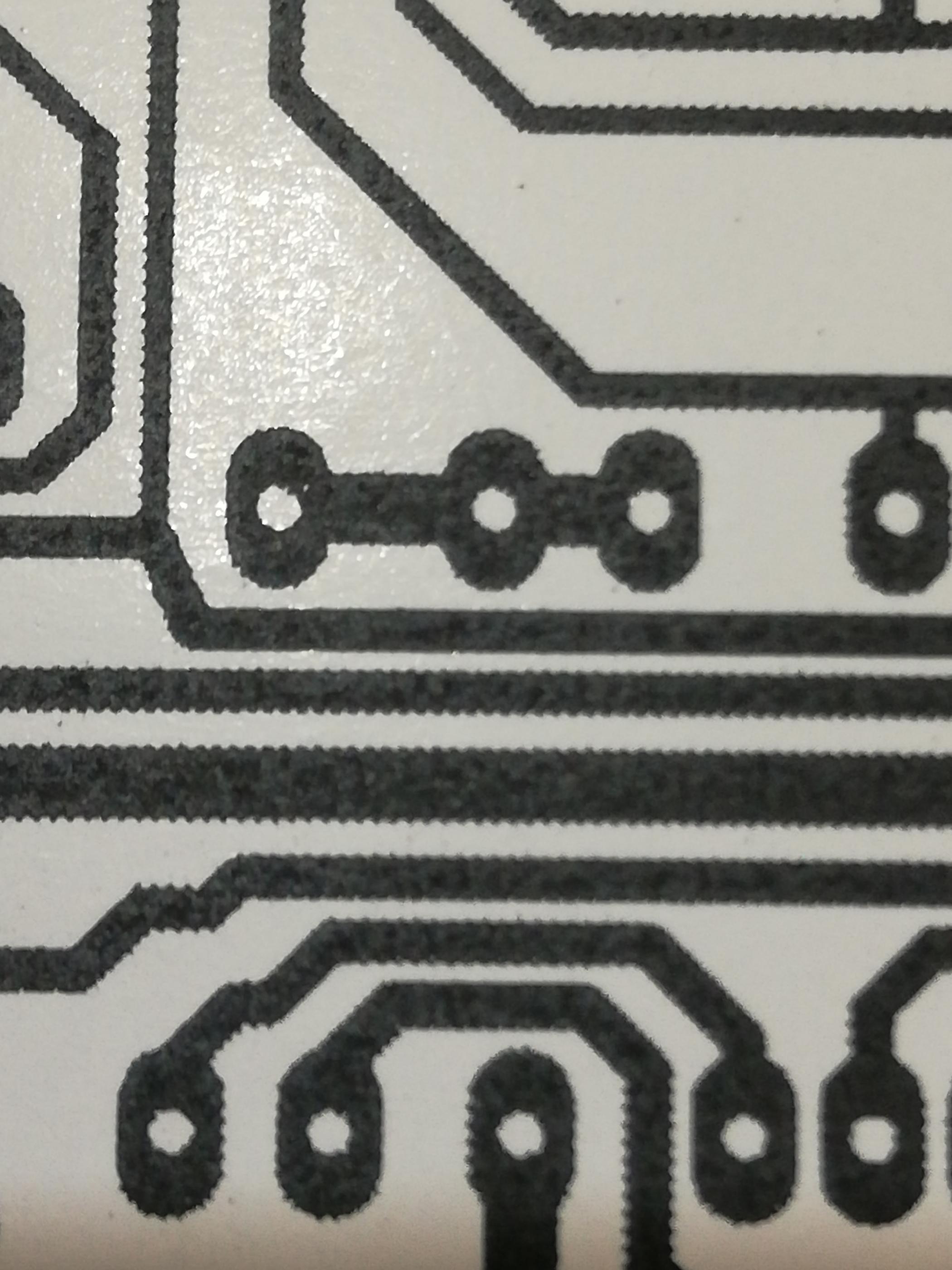

hi all,
i want to make this guitar amp but this jpeg make a problem on the board any one have pdf or some thing else more good quality? my printer cannot print it good. i try use 3 different printers from friends but same happen.
if any one have pls post here. thank you

Maybe you can try:
https://www.instructables.com/id/Heatless-cold-Toner-Transfer-for-PCB-Making/
or repair board with this:
edding 370 permanent marker
ty for answer my friend

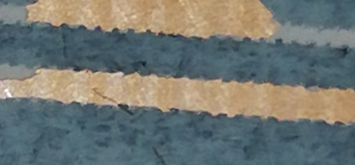

this board very short distance lines for pen working. it can be really long work. i use that pen for some times lines cannot come good so i fix it with pen but now all board is like that picture its not line it look like saw.
i start redrawing on corel but if any one do that job pls post here

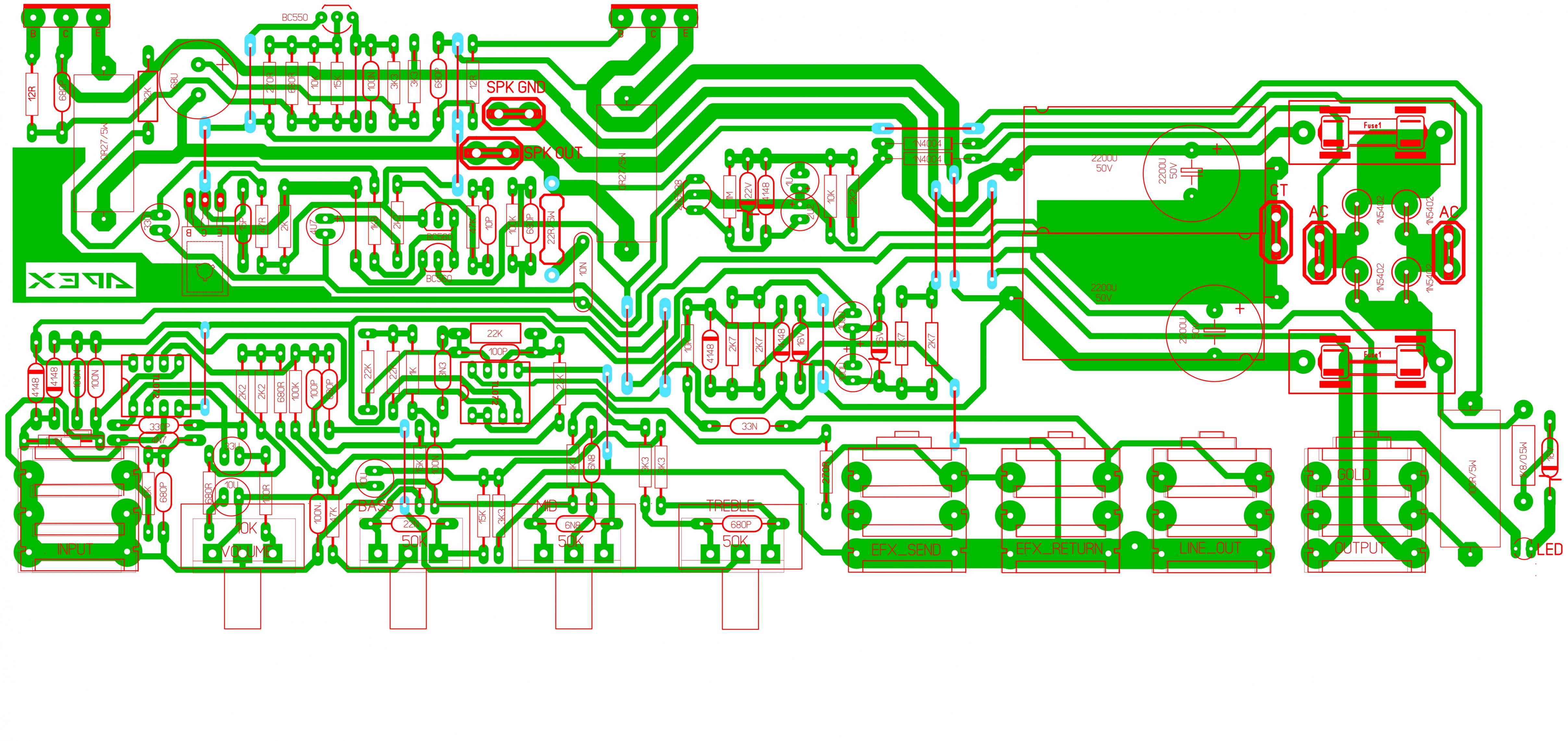

IF YOU TOOK IMAGE FROM POST #35 you must know that is Scaled 62%.
You can't print this directly.
Try to ask help from a copyshop.

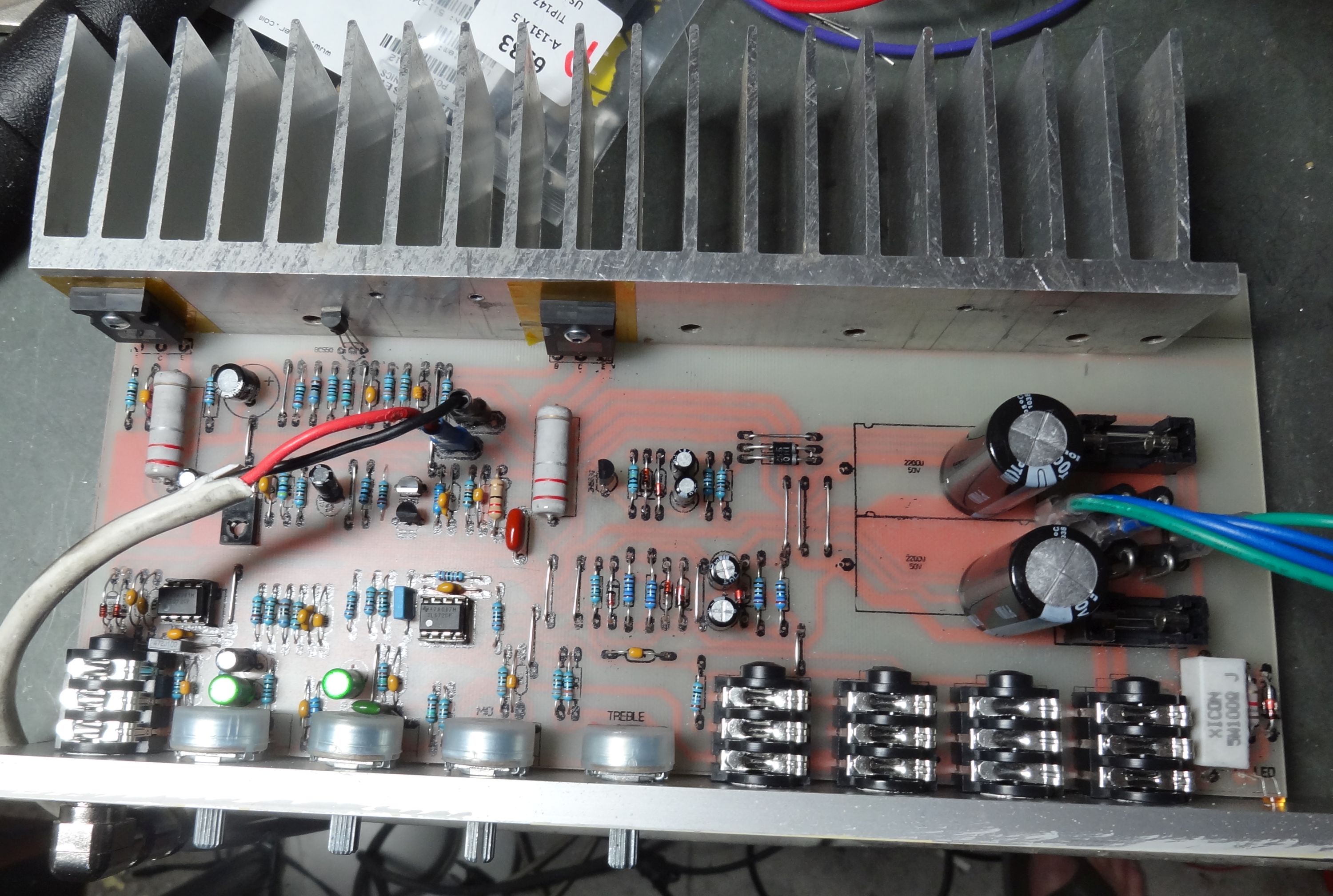

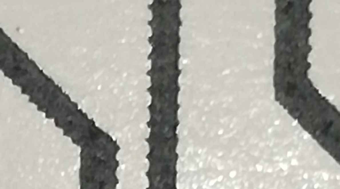

ty thimios, one of my print is from copyshop it come same but not same on picture. print coming out like that.
this is how i get picture; i open picture make it big size and download it from forum and then put in corel and i see right size. and then print.
i am doing some thing wrong?
i think i cannot teel you all what is the problem i make pictures more zoom.
the lines coming like a saw. not straight. sory my english is bad
edit: and i think we need miror the picture for print. cause i didnt check it so mine is reverse now 🙂)

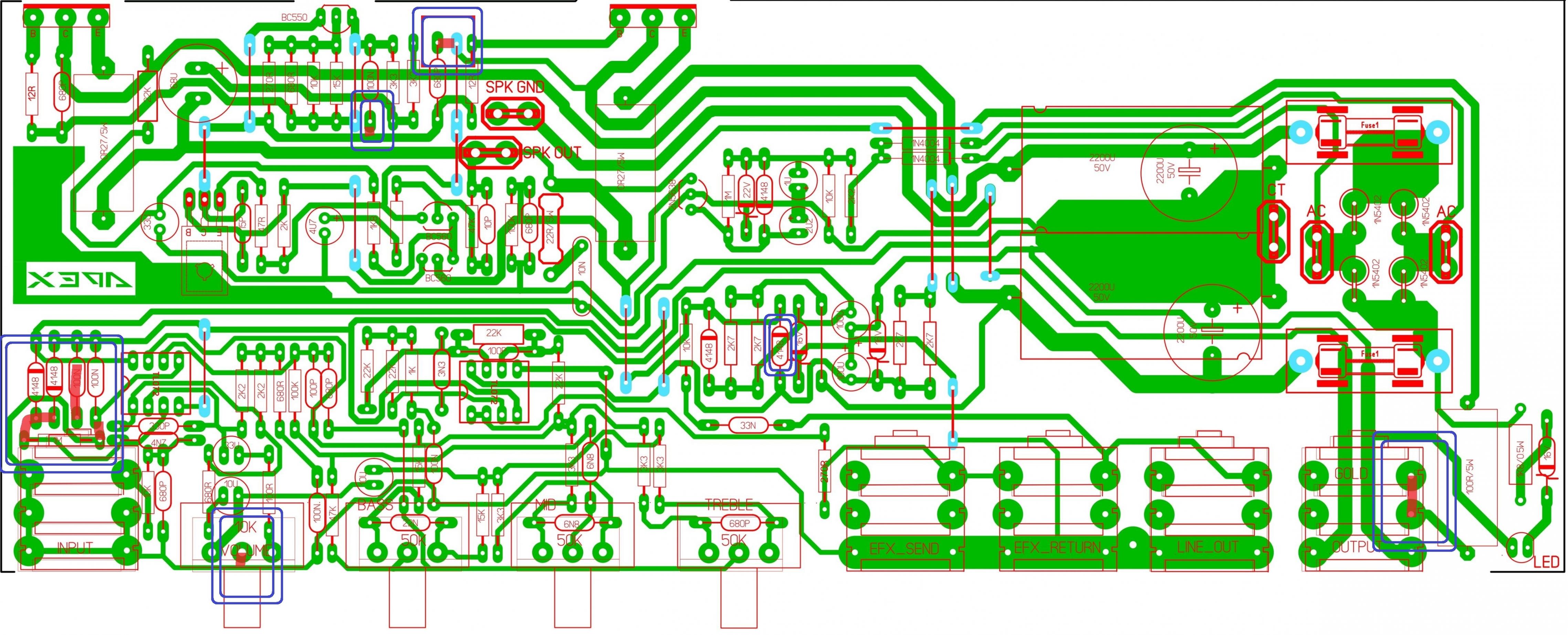

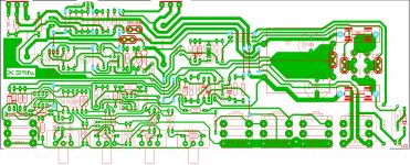

thankyou mr. Terry.
can i have pdf for print? i will make yours.
this is right i think. i want to ask another thing. if i add reverb tank where is the best place for taking signal. after u1 or u2.
thank you soo much.
