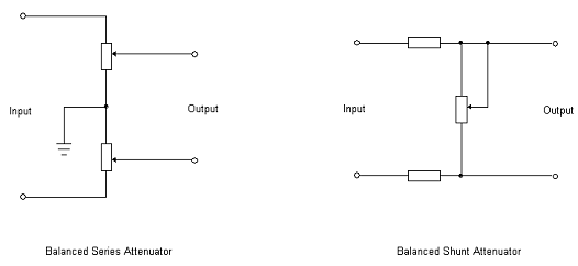

What about something like the balanced shunt attenuator the guys over at K and K Audio use for their balanced linestage? It's stated, "no change in common mode rejection as different volume settings are used..." I realize that stepped control is expensive, but is this a reasonable and "correct" way to handle balanced attenuation?

The example on the left still has the balanced resistor value problem.
The example on the right was my suggestion, but apparently is technically flawed. One of our Forum Members linked to a D.Self article that discussed why it was wrong.

So would something more like TPA's Joshua Tree attenuator be a better solution if you were to closely match all the resistors between the (4) boards?
