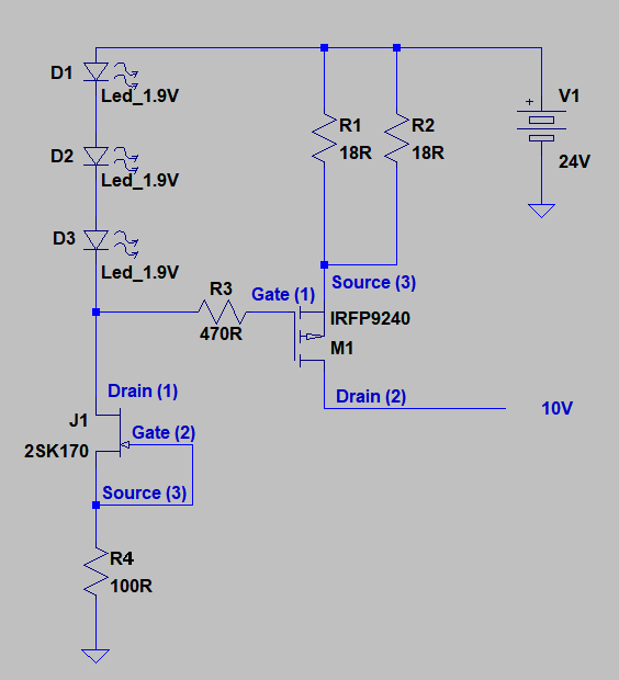

Goals are:
1. About 1.75V voltage drop across Rset resistors pins. Even 1.65V is normal
2. About +/-10V output voltage at the end of the regulators (three test pads)
3. Less than 5mV DC offset on each signal output after the regs are restored
Suspicious points:
1. BC560 in the negative reg that was giving high output voltage (replace it)
2. IRFP9240 Mosfet near Rset in the positive regulator of burned Rset (replace it)
3. Any discontinuity between components due to rework. Turn around the PCB and verify the lanes with the DMM's continuity buzzer.
When testing:
Quickly check voltages and temperatures. Voltage drops on Rset resistors first. If too high, there is over-current. Rset and Mosfet(s) should become very hot fast in this case. Shut down soon. Use a dim bulb tester for general safe power up practice if you got one.
That 1.75V on Rsets is created from the three Leds combined forward drop minus Mosfet Vgs voltage. Vgs happens between Mosfet pins 1&3. If a near Rset located Mosfet has far lower or far higher Vgs than its opposite in the non components burning reg, its probably broken. Or a pcb point is broken. Normal Vgs in this circuit's ~200mA constant current for our Mosfet types is about 4V DC.
I don't think so but just removing the Rset resistors looked like it pulled something up with it.
Should there be a contact between Rset pads and ground? Do I need to run a wire from Rset to ground?
Normally no, that would be a short. Is it zero Ohm measurement or just beeps for low? Because there are components installed the DMM maybe finds a low impedance path. DMMs beep below 50 Ohm or about, not at strictly zero.
Here's the positive polarity constant current creating subsystem. Where your combined Rset 18R//18R has burned. You can verify its not broken somewhere for interconnections as a circuit, with the DMM's continuity buzzer tracing on pins and resistor measurements.

Goals are:
Suspicious points:
When testing:
Good morning, resistors arrived yesterday and today I have some spare time.
Ive checked for discontinuity and can't find any.
No solder bridges.
I've replaced the BC560.
Fitted a 2W 10 Ohm at Rset.
Upon startup all that didn't light up were the 3 LEDS near the Rset that burnt out (irfp9420 side of the board). Before I could measure the voltage across the Rset resistor it started to burn out so I switched off.
I've replaced the leds (two weren't working) and tried again, same result although i briefly got a reading of -10.6v across Rset.
What will be the next item to check?
Check if the Leds are still working. Check if the K170 Leds driver still shows normal RDS. Replace that K170 and IRFP9240 if in doubt. Rset burns because a large voltage appears across it. Normal voltage will be about 1.7V DC if both the three Leds are lit and the Mosfet has normal Vgs.
