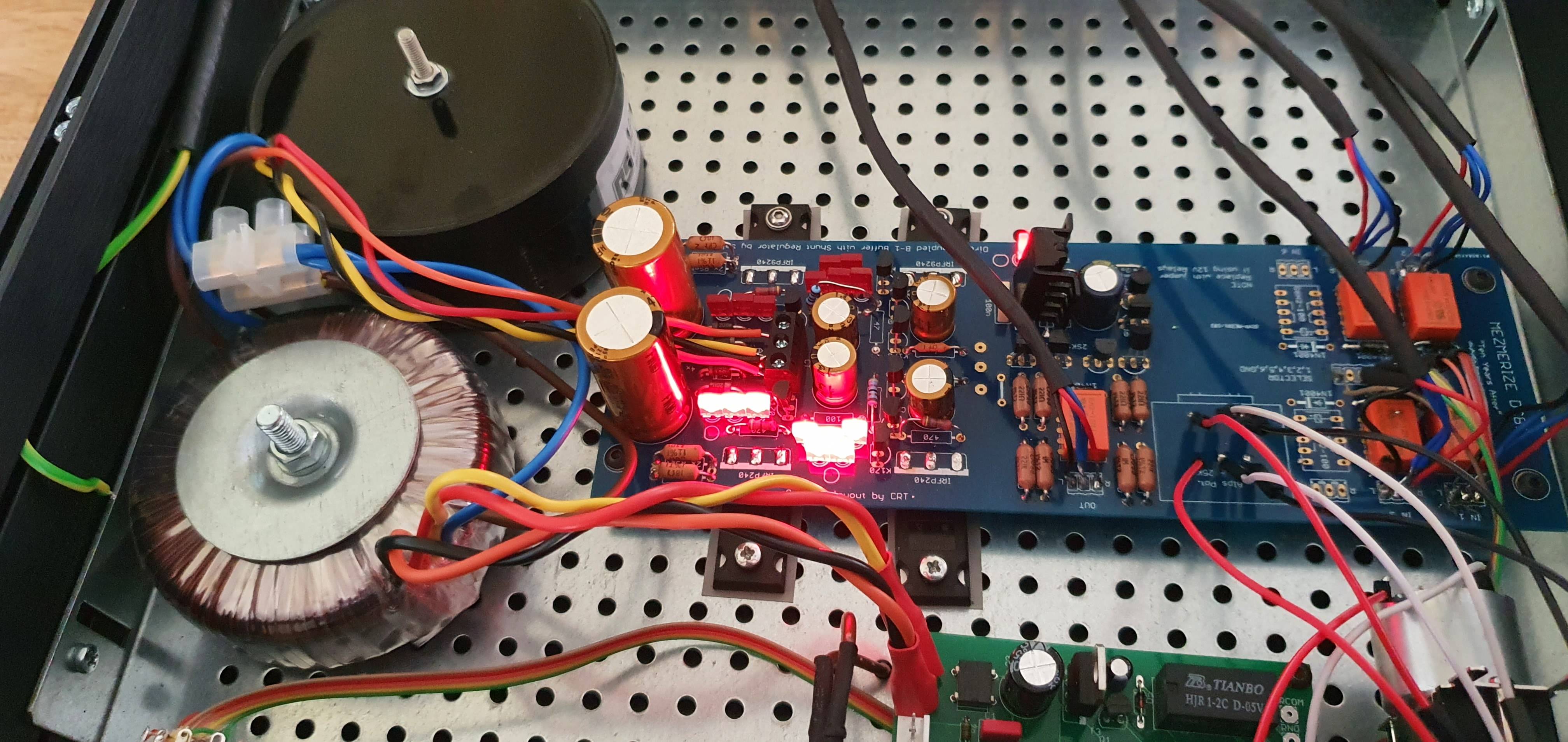

Everything built and connected but only one channel works. What steps do I need to follow to diagnose it?
Putting the multimeter on the 3 pads gives 23.65v on one channel and 1.05 on the other.
If I put probes on two of the pads for one of the IRFP9240PBF then 5 more leds light up.
Also see if your DMM in diode check mode can light up an LED. If it can you may try probing each LED in the triplet to see if its working or not. Red on anode. Else use a 9V battery and crock leads to briefly touch their pins. No need to remove them from the board but access to the soldered side is needed. Leave that for after checking the transformer connections if no resolve.
Probes on the outer screws should give 30-34VAC for a nominal 15+15VAC Tx. Between center screw and each outer should give half those ACV.
Got 36v across the outers and 18v between either outer and centre screw. I wired it as a centre tap on the transformer, 2 outer leads to outer screws and 2 centre leads joined into centre screw.
I'll try the leds tomorrow. Thanks for your help
