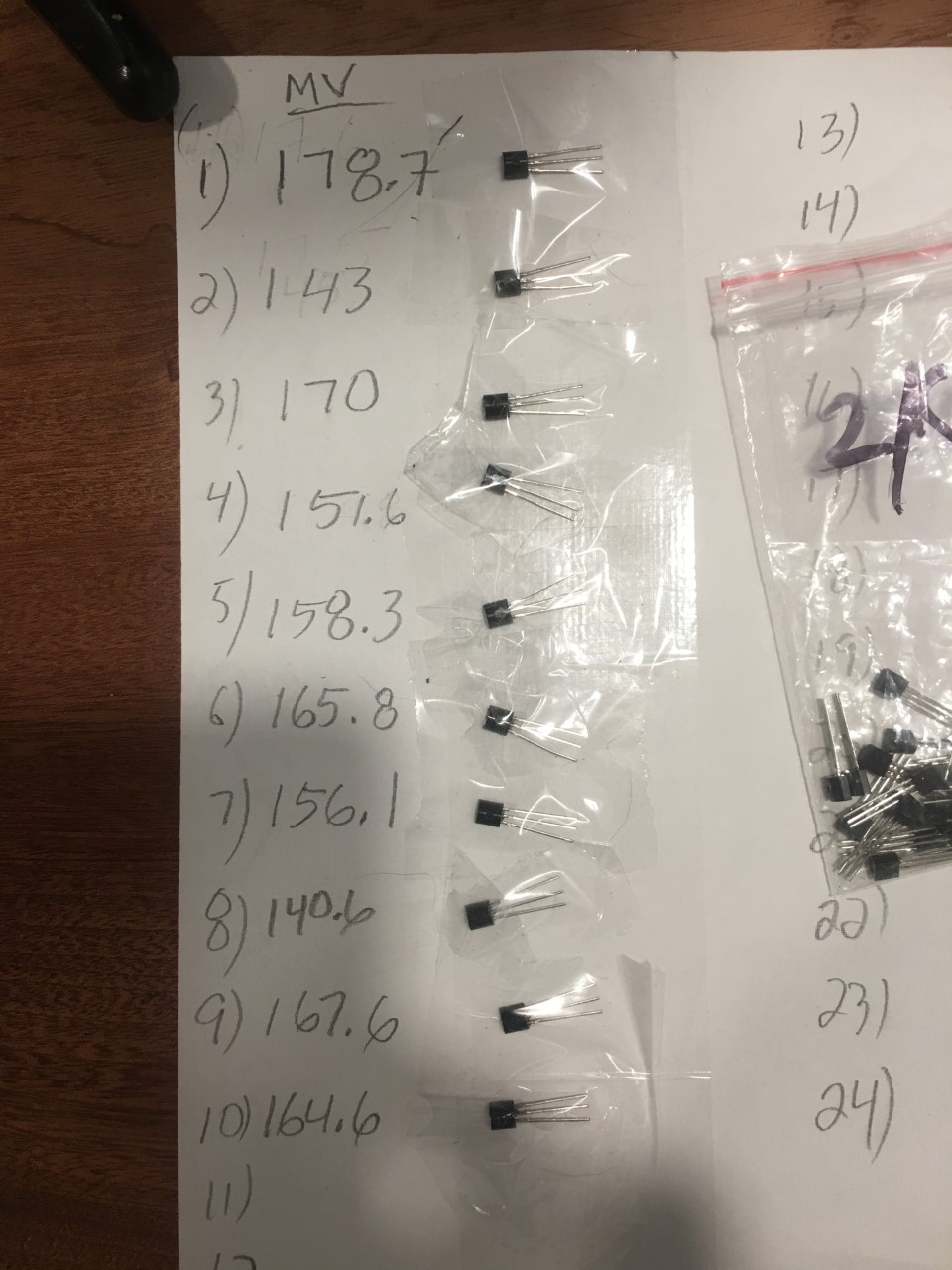

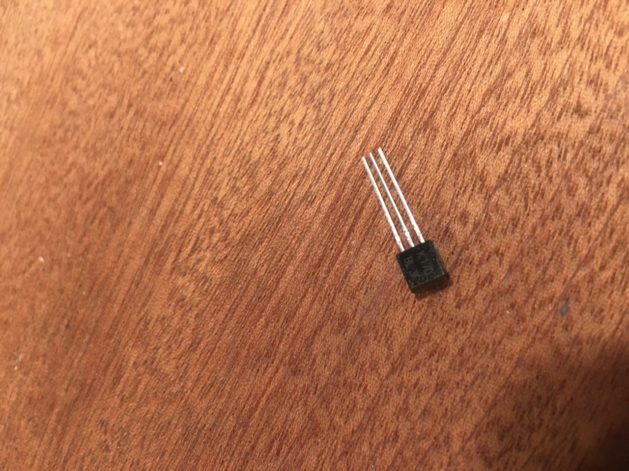

I read the Threads about fake 2SK170's but still not certain if mine are fake or not. I got these a few years ago but certain where I bought them.
I'm measuring IDSS with a 10ohm resistor on the Drain with 9v, G&S shorted.
Will measuring IDSS determine if they are real or fake? So far one piece was wildly unstable and clearly bad, the others measure well and stable.

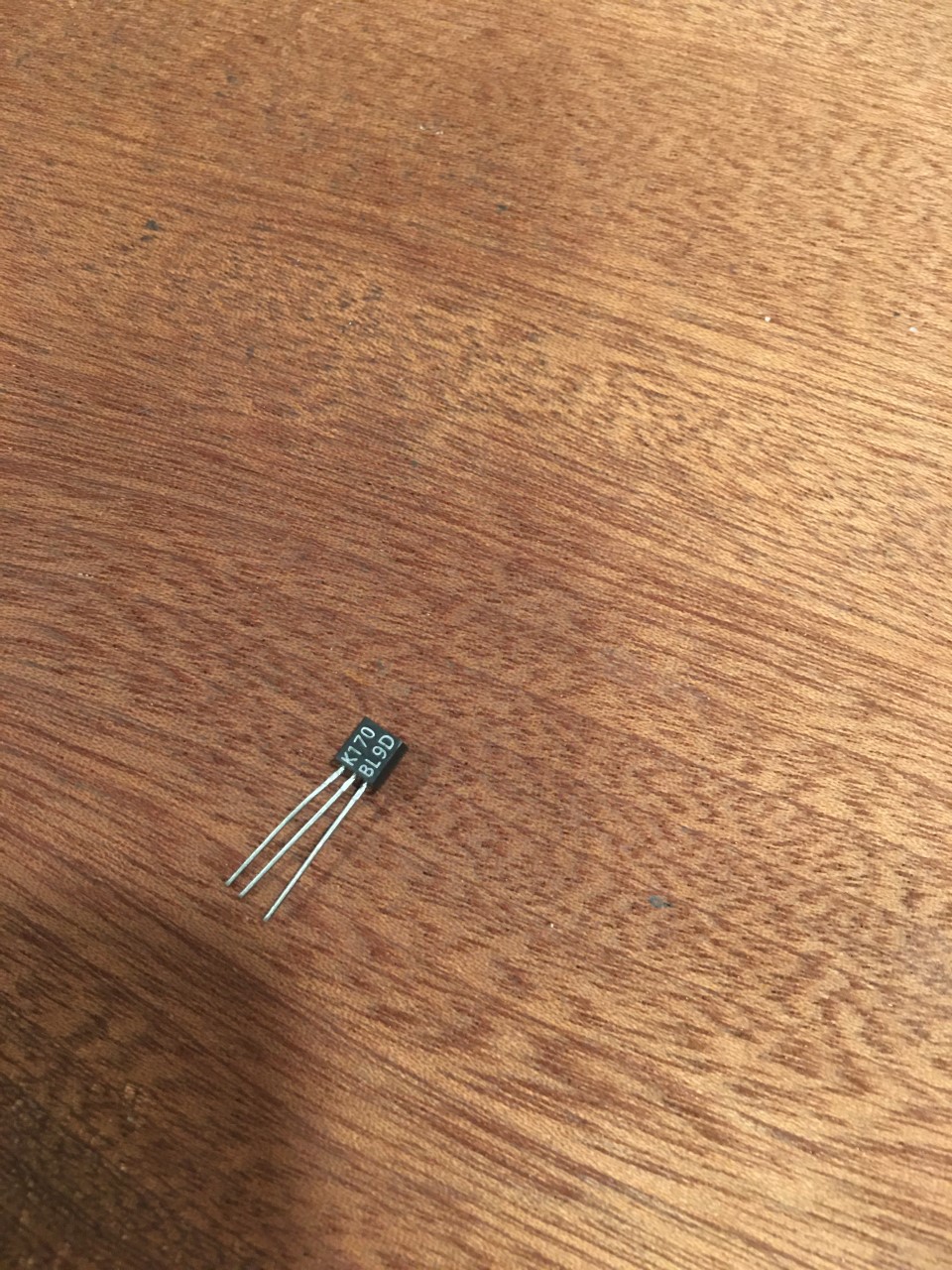

My first build I used pieces with a 9D date code as shown in the last pic. 20 pieces measured between 29 and 42 MV.
Any Ideas?

That's the same as Toshiba BL range (comes from blue, the Japanese pictured imaginary colors for IDSS hotness groups. Green, blue, violet). IDSS classification: GR: 2.6~6.5 mA, BL: 6.0~12 mA, V: 10~20 mA
Of course it isn't tight because its isn't about matched IDSS JFETs. Its about belonging to an IDSS group. For DCB1 you need 0.1mA tight matched quad you will handpick out of the BL (B) group by measurement. Those are the signal area units. For the rest of K170 positions in PSU area you may randomly pick remaining units out of their BL (Toshiba) or B (Linear Systems) groups.

While wrong looking K170s are always fake we have also had a recent occasion of right looking ones that proved fake. Ebay parts is high risk taking. Especially the sought after NOS. Unless someone we know here has tested them in a DCB1 with correct results we can't foretell. See posts #2229 & #2248.
