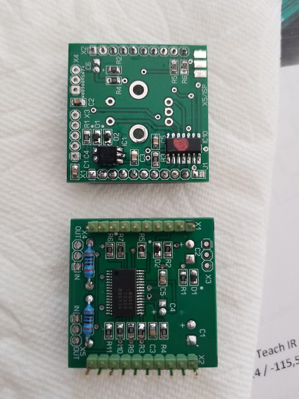

Hello again!
I just can't stop looking for reasons not to be finished with the DCB1 😀
So right now I have those muses-boards from meldano, which seem to be very good.
(how) can I draw the power from the DCB1-Board?
The muses chip / board needs to be powered (+-15V), but I haven't yet found more specifics.
Muses' thread here
Documentation here

Because there is more than 15-0-15V DC across the DCB1's reservoir capacitors we can tap from there to feed some Low Drop Out (LDO) chips regulated board for +/-15V output.

Thank you, Salas!
This was most probably already mentioned here, will search for it (now that I have the correct terms to look for [emoji2960])
I‘ll „probably“ will have to come back for further instructions, though!

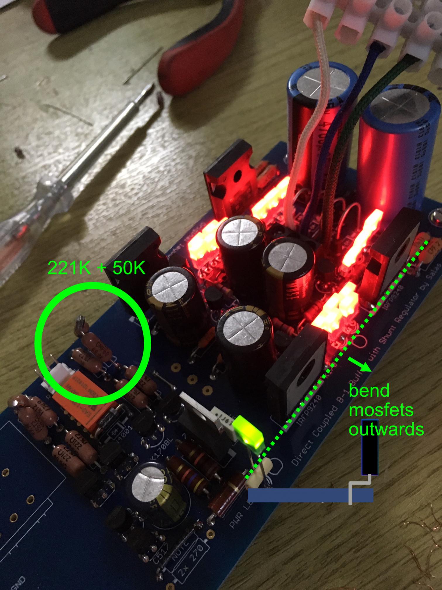

I chime in a bit late ( and I'm not very experienced in electronics but I built a DCB1 🙂 )
Chassis: I got myself a galaxy 3U 230 x 230 — it is too high, depending on your transformer (and other additional stuff), you could easily go with a 2U 230 x 230... If you'd wand to go as slim as possible, you could "kink" 90° the big capacitors, and use some heatsinks less high but with more width, and stuff it into a 1U!
Pot: As Salas told me, you may want/need to adjust the 221K resistors for the 25K Pot (270K for the 1:10 Rate... Salas gave me the hint... I soldered a second Resistor in series to get there...)
Measurements: Don't worry, it is possible. Even I could do it 🙄. (Ask again when you're there...)
Additional: If you're going the strict BOM-route with the Fischer-heatsinks, be aware that those are rather big. But you'll need them if you "hot-rod" the DCB... I'd recommend to bend the MOSFETS in a "zig-zag" to get them as close to the board's border as possible...
Also, I'd recommend to solder the connectors to/from the transformator under the board. There's not much space for wires on the upside.
Good luck, much fun!
