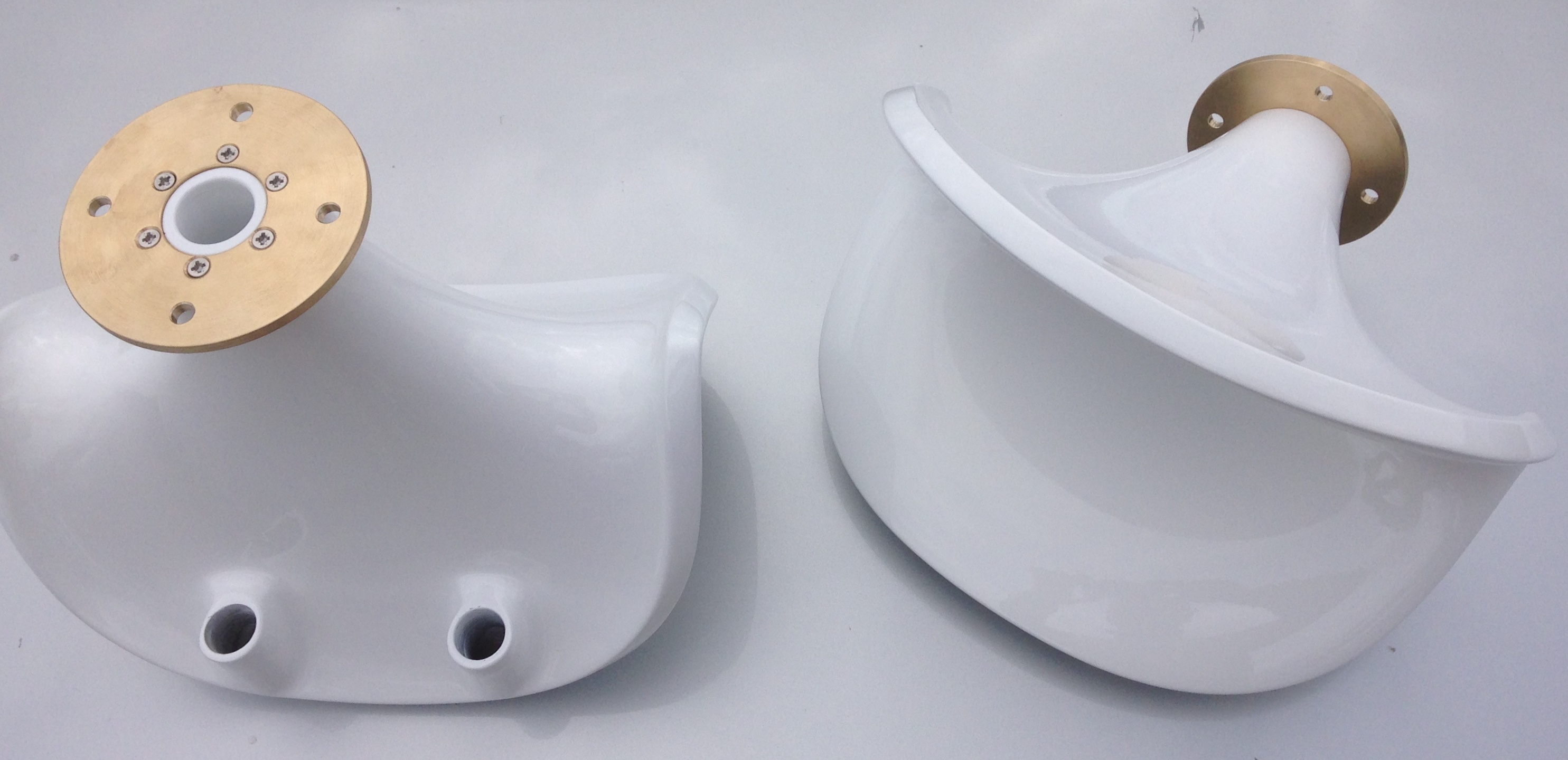

Metlako has been reliably printing in PETG but I really want to print most of them in ABS+, if possible. ABS is a nightmare to print, but the finished print just looks so much better.
Take a look on PP copolymers. Regular PP has strong shrinkage but copolymer can be good and part strong. My first printed horn, Iwata 600 in white pearl.
Next task - experiment with printed composites.
Patrick I'm starting to have good luck with ABS. No enclosure yet, and it's counter-intuitive but in areas where the print gets thin or is being supported I'm running my fan at 15%. I've settled on 245 for a print temp as well. First layer bed at 100 and ramp up to 110 after that - my Prusa has no issues with the heat. Dry filament is necessary as well with ABS. I feel your pain about getting things to fit. I'm in the modeling stage of a near full range 3 way Synergy that I hope to print in ABS and it's looking pretty crazy getting all the drivers stuck on 😀
Ramping up the temperature seems to be essential for ABS.
For instance, I've been able to eliminate cracking almost 100% by increasing the bed temperature from 80C to 100C.
I'd go even higher if I could, but one of the fundamental challenges with my Monoprice printer seems to be that it's power supply is incapable of heating the bed beyond about 90C. I've been able to get up to 100C by adding two incandescent heat lamps to the enclosure.
PETG would definitely be less hassle, but ABS just looks so darn good when I print. Plus it's sandable.

FWIW, I've settled on 95C bed temperature and 232C hot end temp for ABS. I have a delta-style sprinter and wrap a Harbor Freight moving blanket around the open perimeter to keep the heat in. I print on glass with a thin coating of Wolfbite. If I get the first layer right, I have no issues with cracking, warping, or lifting.

Here's Metlako V2
Here's Metlako V2, next to my "image control waveguide" project, next to Metlako V1
YouTube
Here's Metlako V2 playing some music
I'd really hoped that this would be the speaker that actually got finished, and wound up in my living room. As usual, I'm kinda obsessed with tweaking these designs, and there's a few things about Metlako V2 that are problematic:
1) This is far and away the most difficult waveguide I've ever printed. Literally 70% of the prints have wound up in the trash, and even the prints that "made the cut" aren't as good as the "Unitized Image Control Waveguide" project. The big issue with the print, is that it's assembled from three pieces and two of those pieces have flat sides. 3D printers have a really difficult time printing a first layer that's perfectly flat, particularly if you print in ABS.
You can see what I mean in this pic. See how the seam on the Metlako V2 waveguide has a gap? That's because that piece is supposed to have a perfectly flat edge, but it curls up as the plastic cools.
PETG is better about this, but not immune. See that small gap in the orange waveguide?
