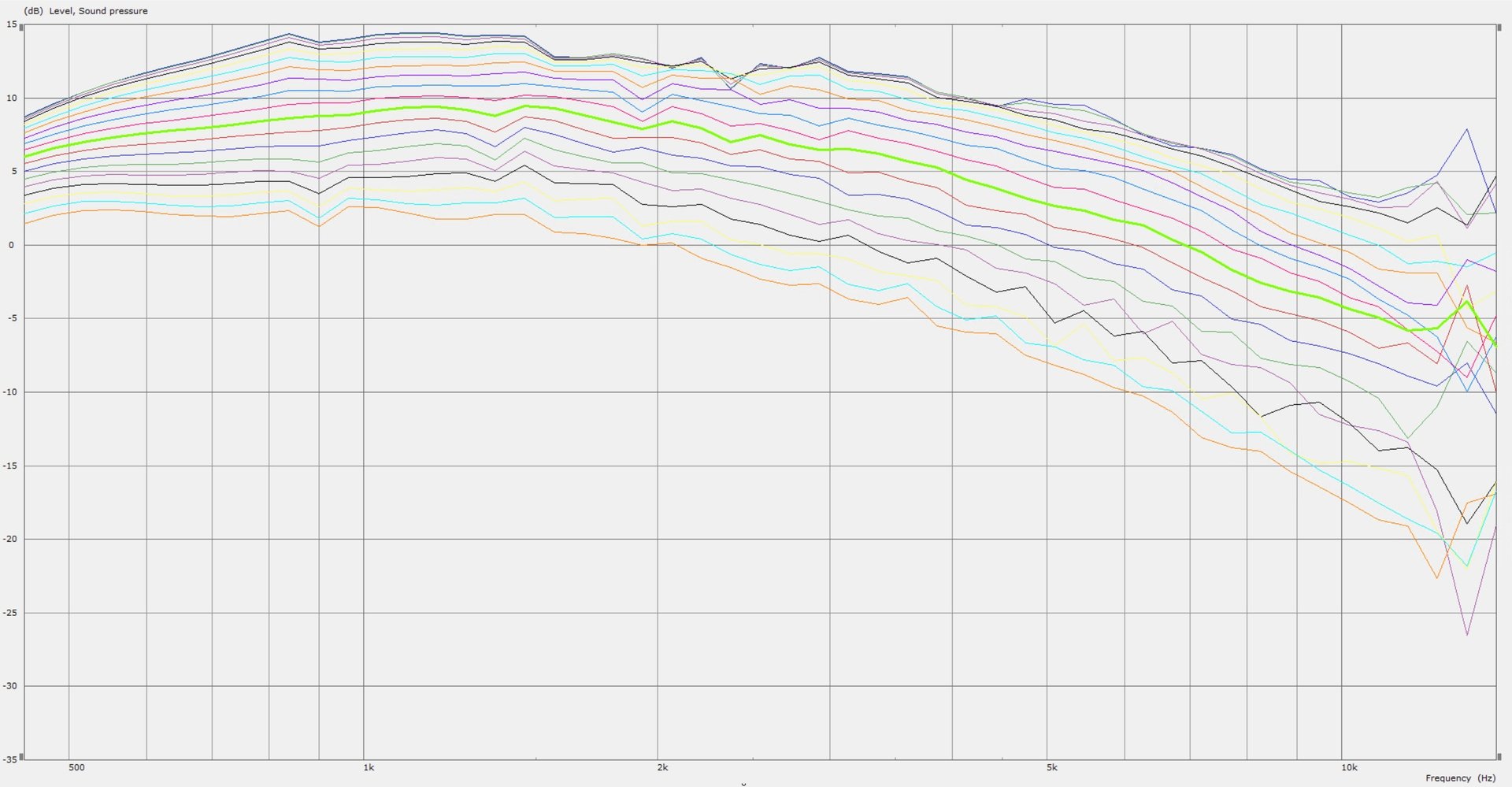

John, may i also respectively say....something looks very amiss between the 15 deg and 0 deg traces.

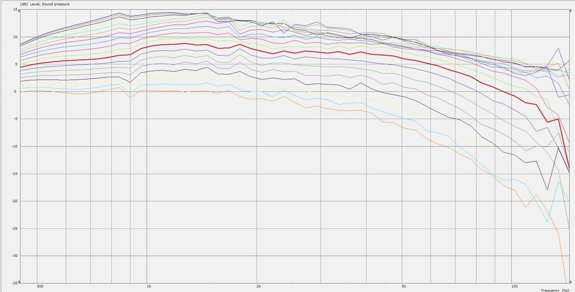

Response at zero degrees
Response at 15 degrees off axis
What's "very amiss?"
Here's the polars from last night, but restricted to zero to 15 degrees in 7.5 degree increments

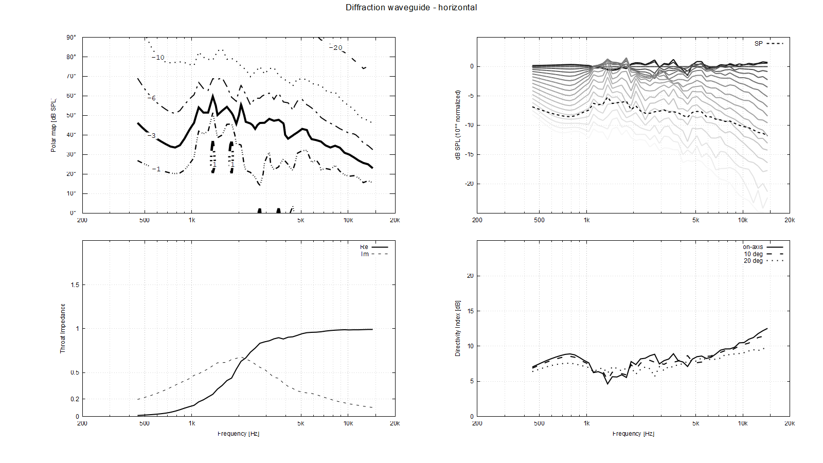

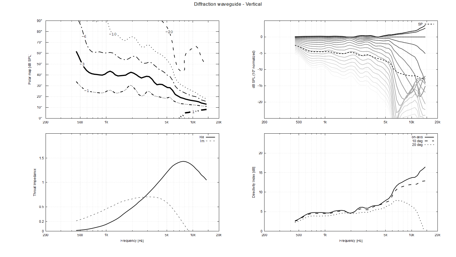

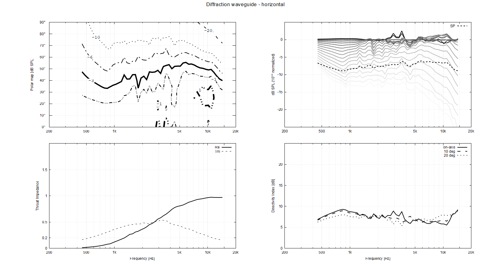

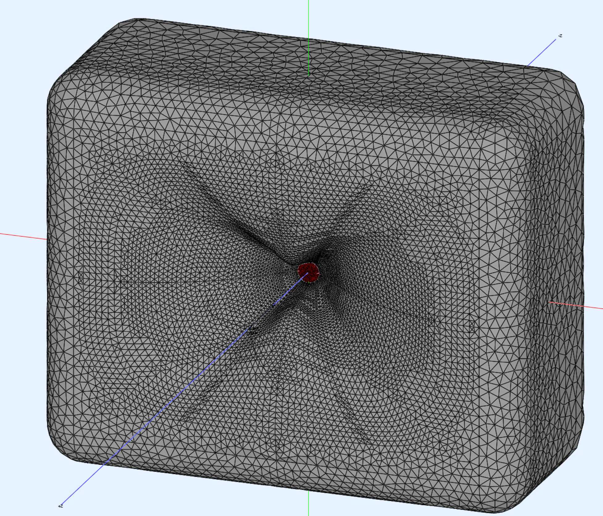

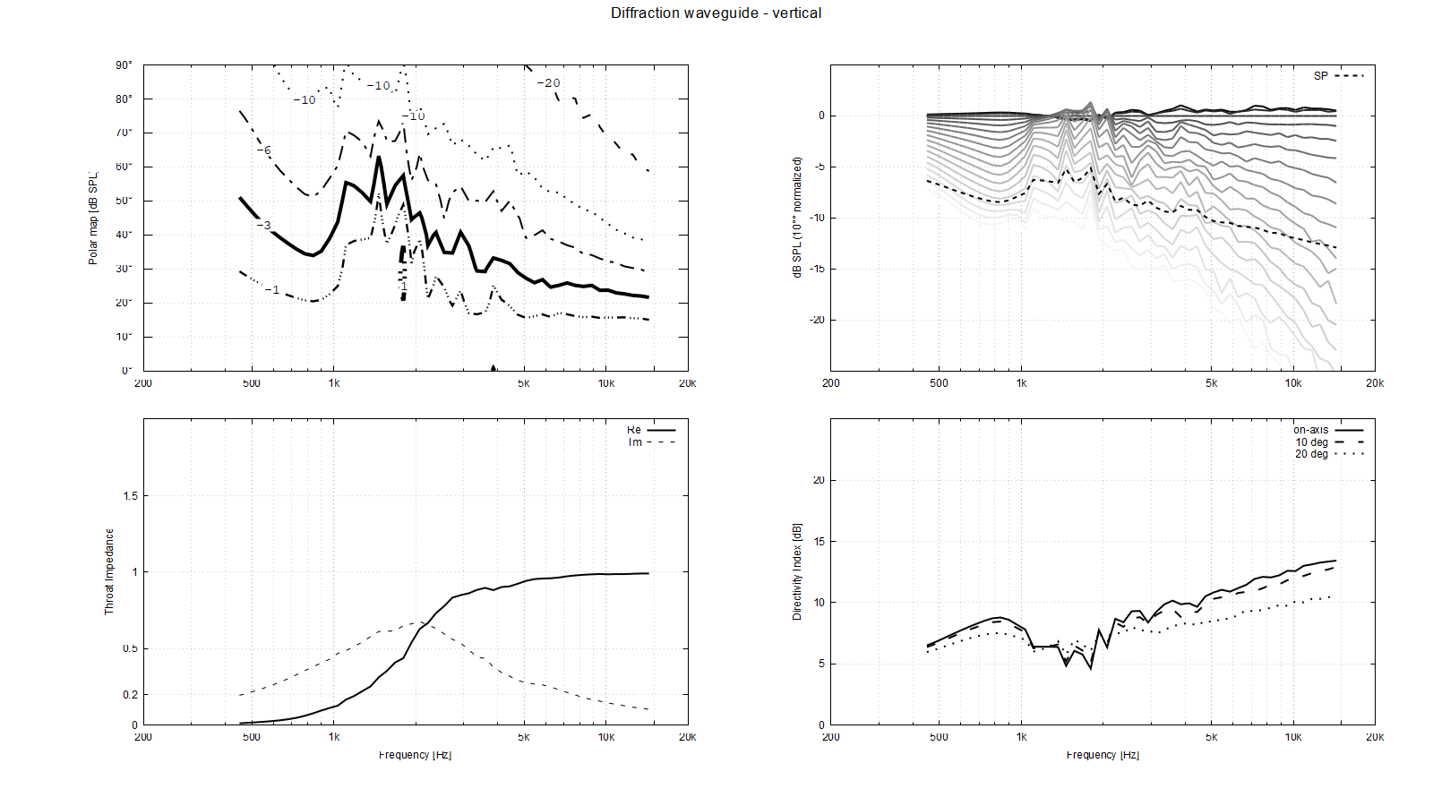

Taking another crack at this one.
Same goals as before: wide horizontal beamwidth and narrow vertical beamwidth.

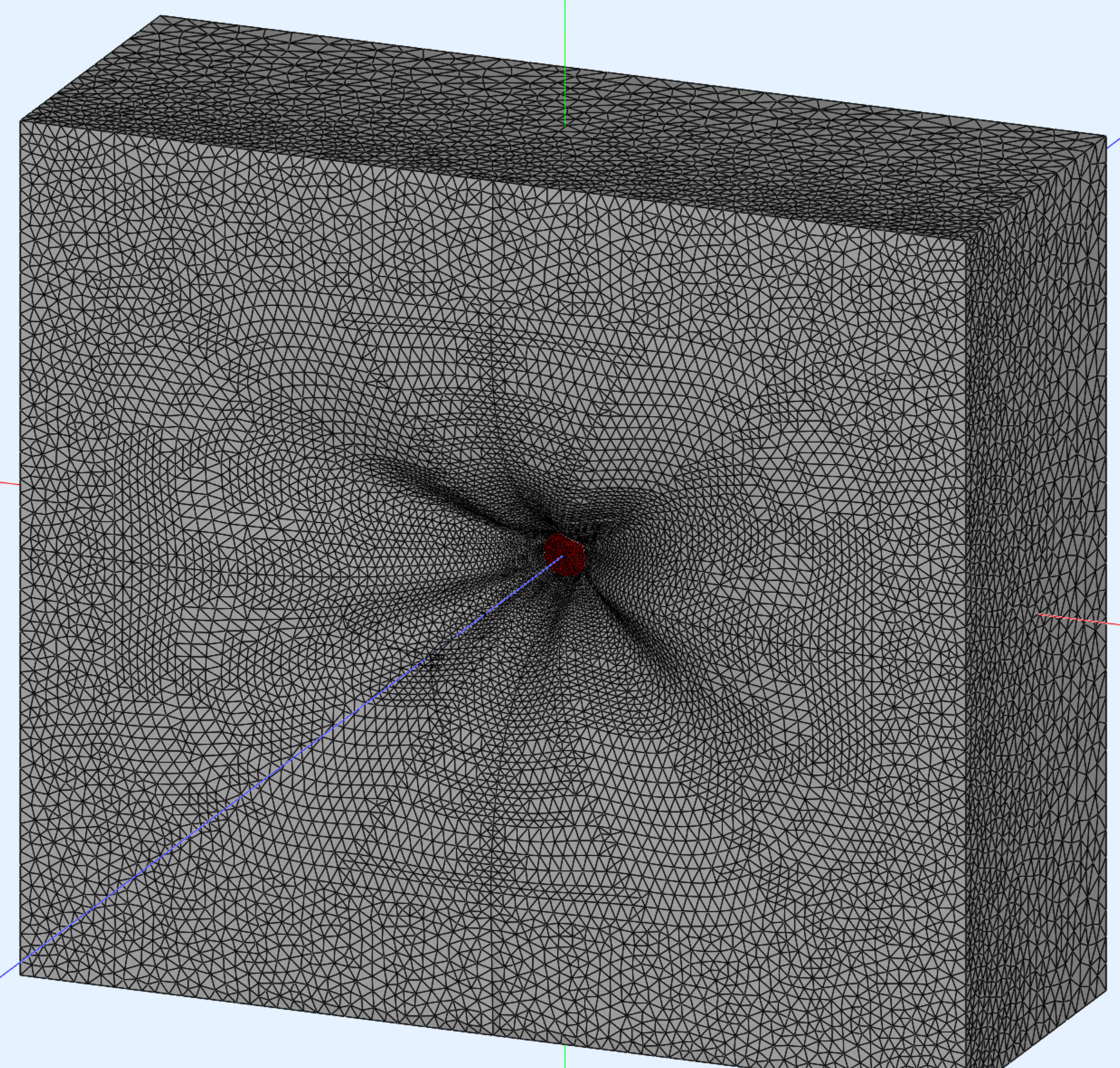

Attached are a pic of the enclosure and waveguide, sims of the horizontal and vertical response.
Here's the config file:

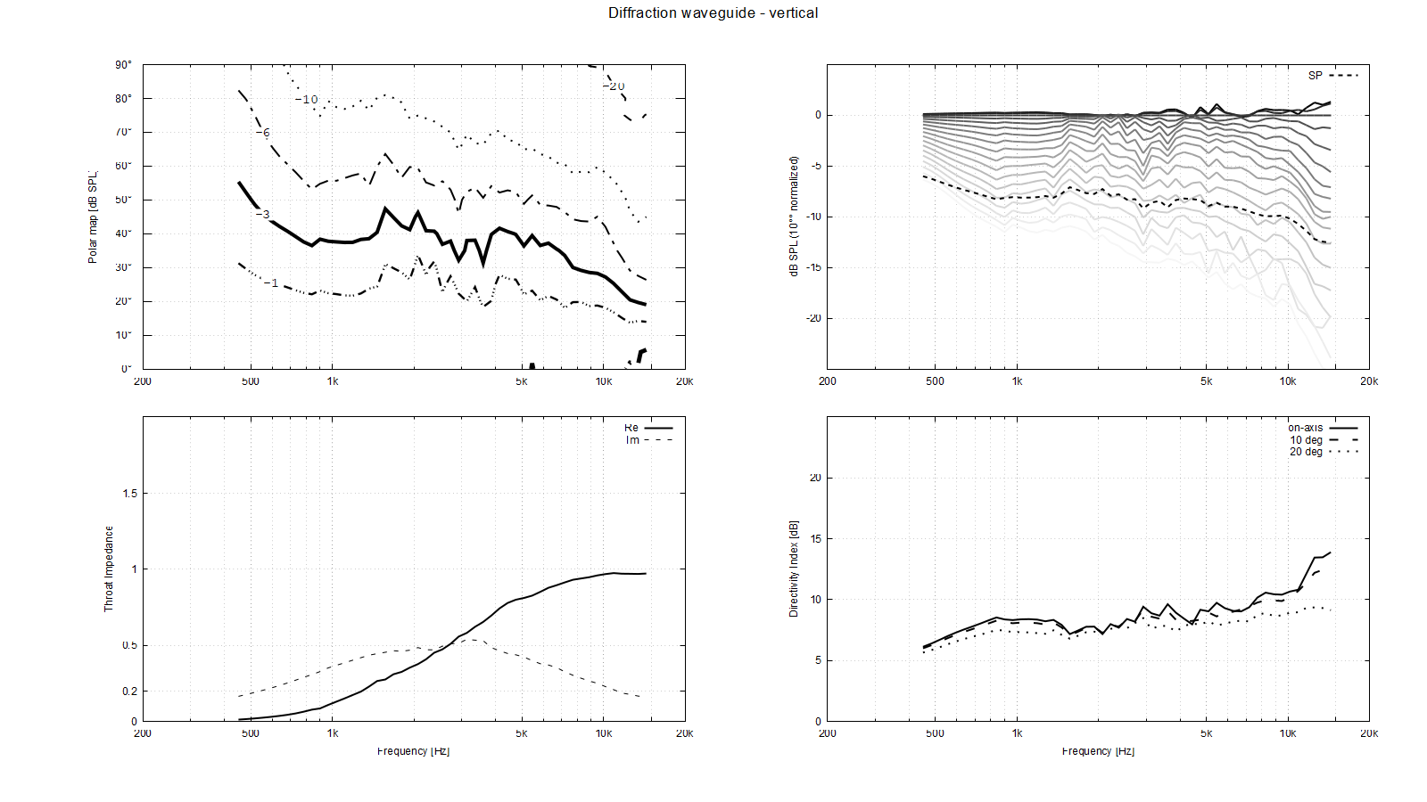

I made a mistake in the post I made yesterday; it still had the stanza for a dome tweeter. I've fixed that, and I've attached new sims of the normalized horizontal and vertical polar response.
The design has a fairly substantial diffraction slot, but I might want to rotate the diffraction slot or even the entire waveguide.
If you look at the simulations from today, versus the sims from 23 hours ago, you'll notice the vertical beamwidth is nearly as wide as the horizontal beamwidth even though the waveguide is significantly wider than it is tall.
Here's the updated model:

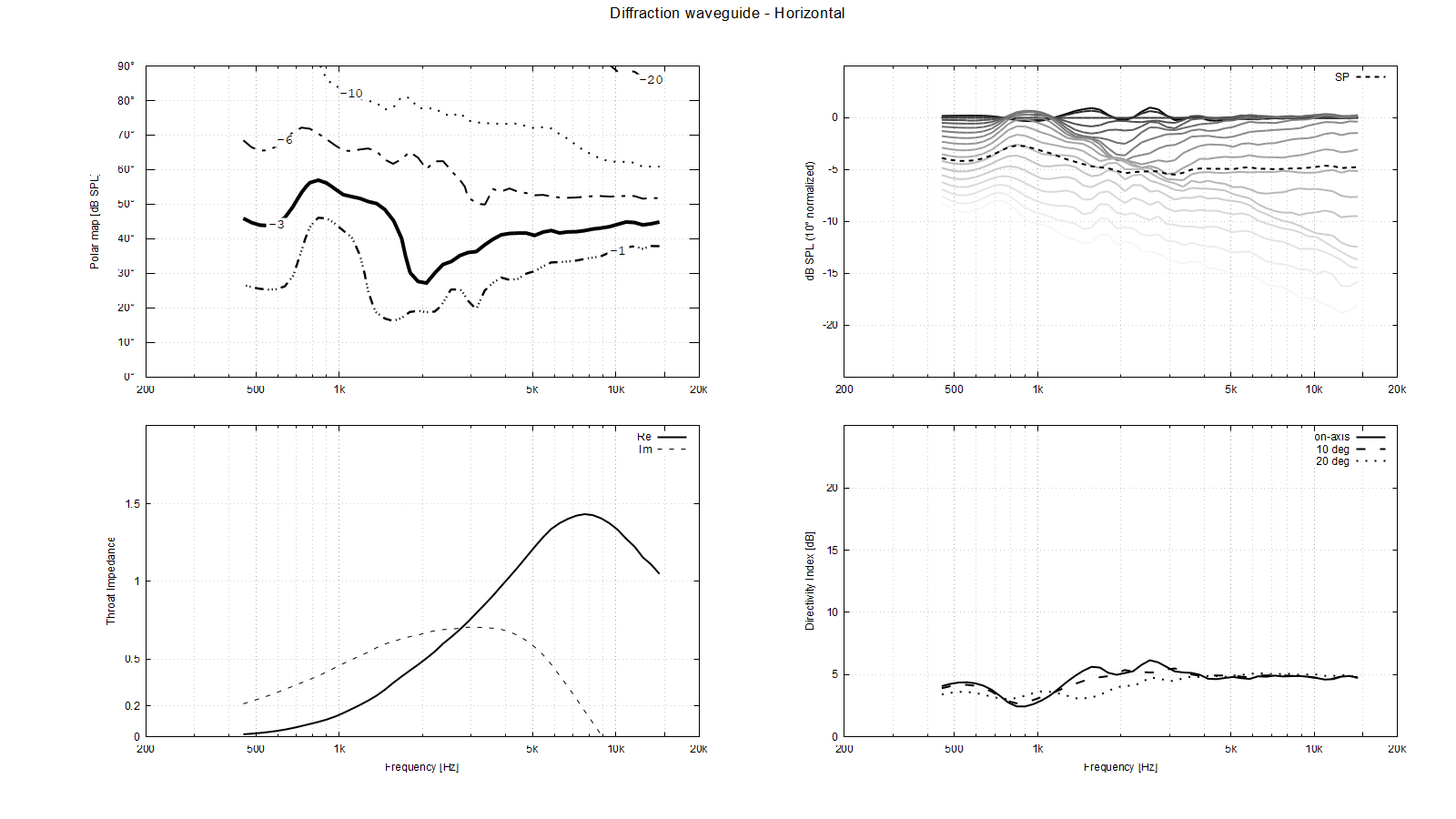

Reactions: Kravchenko_Audio
lol I'm really wondering why I keep trying to use diffraction slots. Here's another one that didn't work great.
Here are some things I don't like about this one:
1) Even though the horizontal and vertical diameter is dramatically different, the beamwidth is similar. This tends to indicate that the diffraction slot is broadening the vertical beamwidth (which is something I don't want.) Basically, the vertical and horizontal beamwidth is similar, whereas I'd like wide horizontal beamwidth and narrow vertical beamwidth.
2) the frequency response is not great
I'm thinking I should make the diffraction slot much less prominent, or just make a conventional waveguide. I have a really hard time taking that path of least resistance 😉

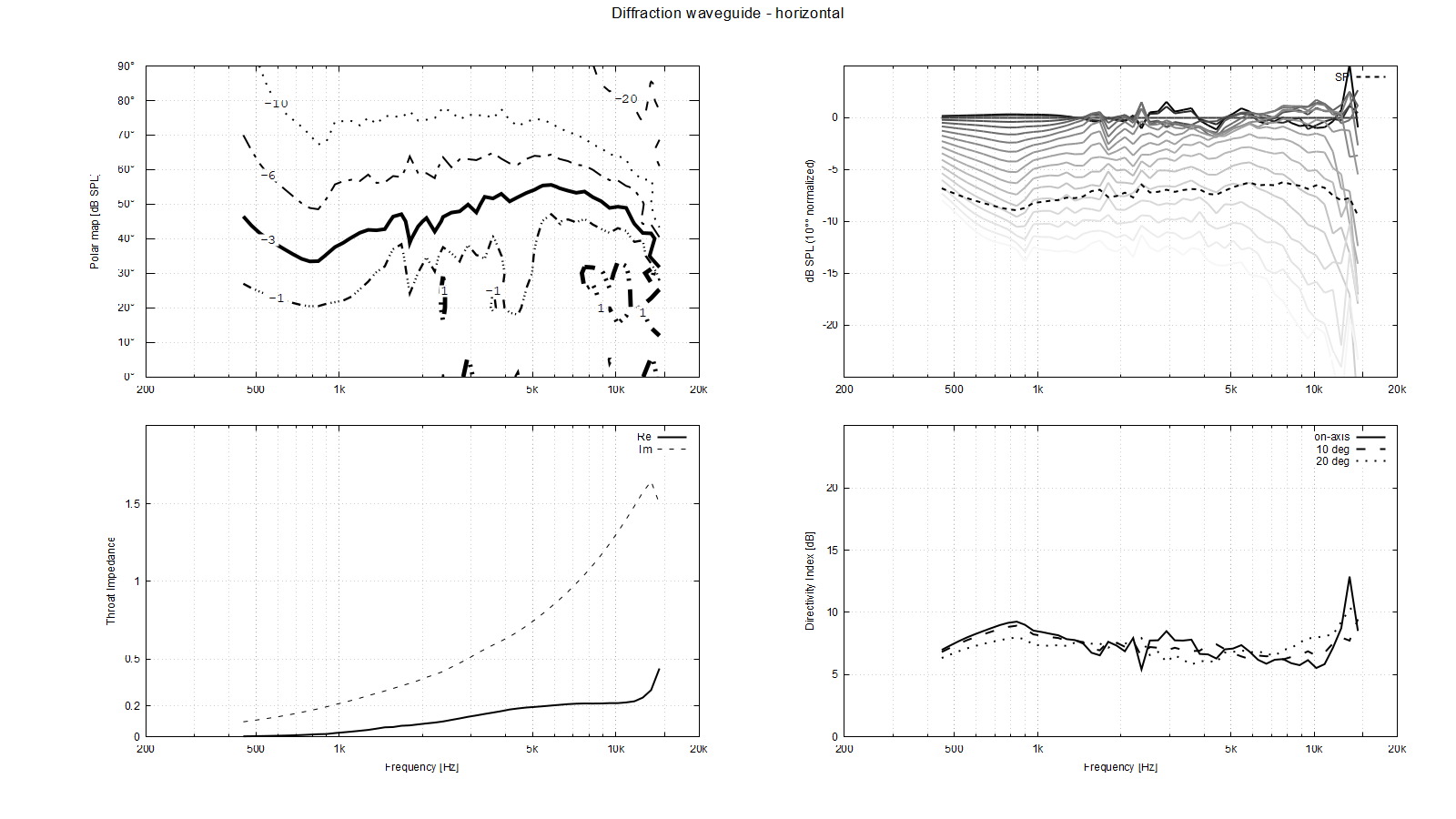

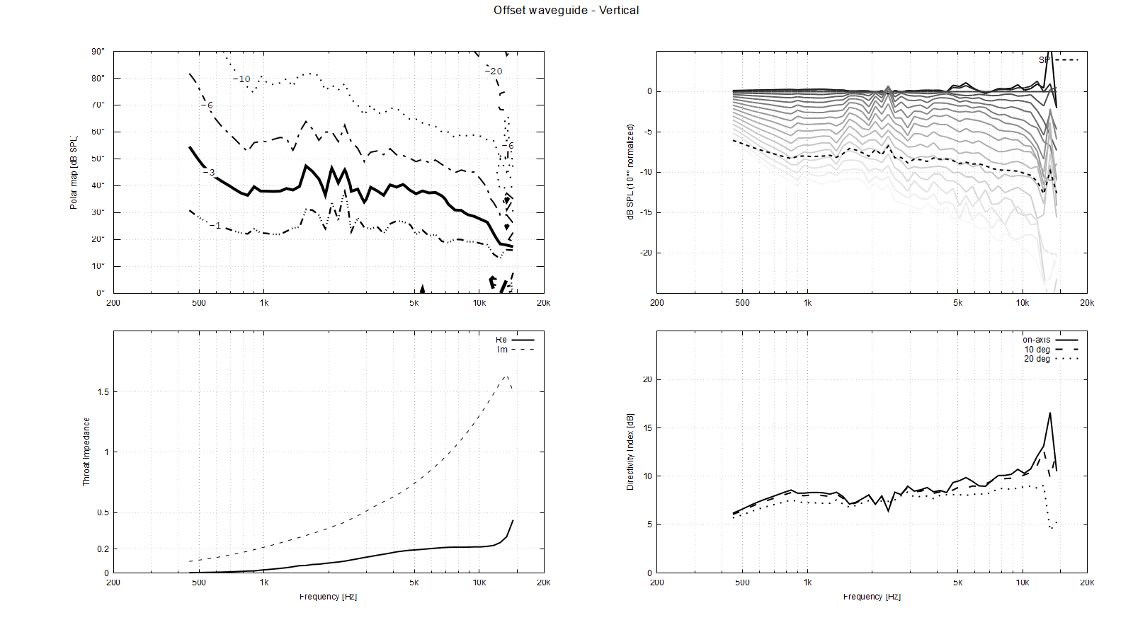

Due to the fact that I'm trying to achieve a narrow vertical beamwidth, ribbons seem to work better than domes in this format (wide but short enclosure.)
I've attached a couple of simulations. They're nowhere near perfect, but they're better than the last ones I posted.
