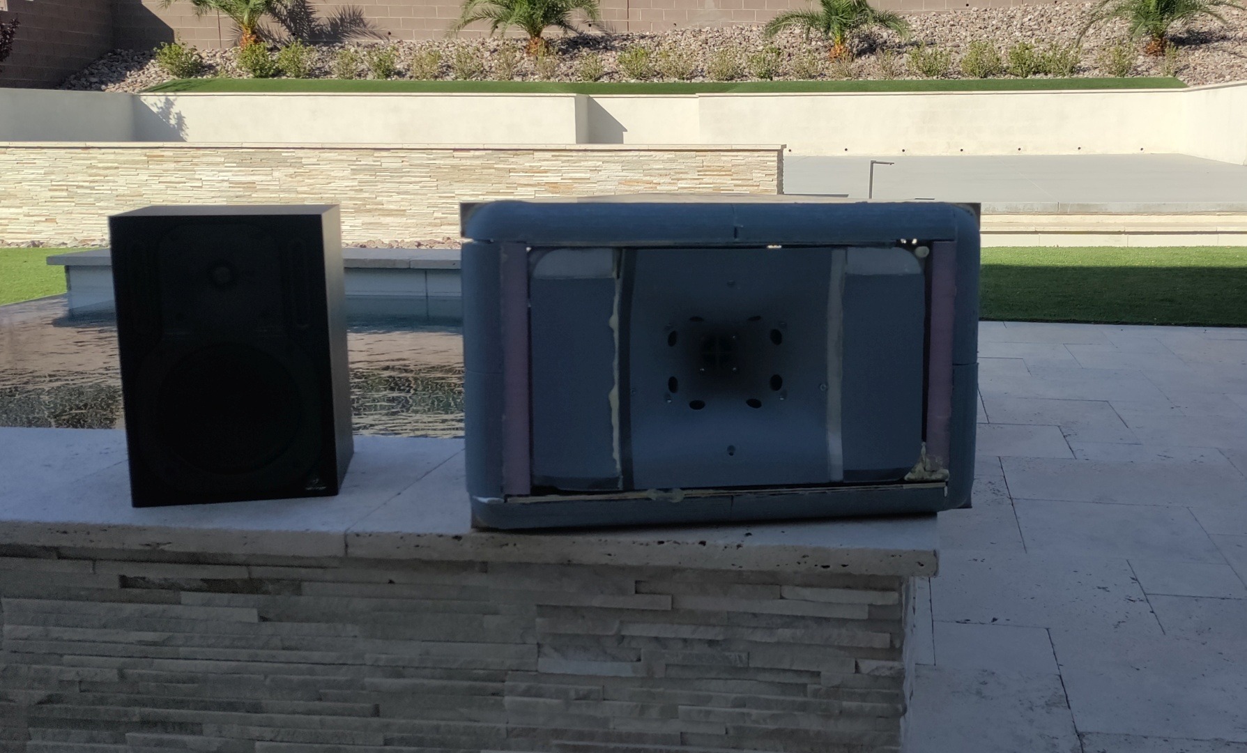

Here's a recording of Metlako III
Obviously this is a work in progress, so there's room for improvement, but I dig it
Here's the original song, you can compare and contrast the original recording versus what's reproduced by the horn. In particular, note how good the percussion sounds. (Unity horns are really good at percussion.)
To compare and contrast, I strongly suggest using headphones or a full-range single driver speaker. Conventional speakers screw up the phase in the crossover region and will obscure what Unity horns do so well.

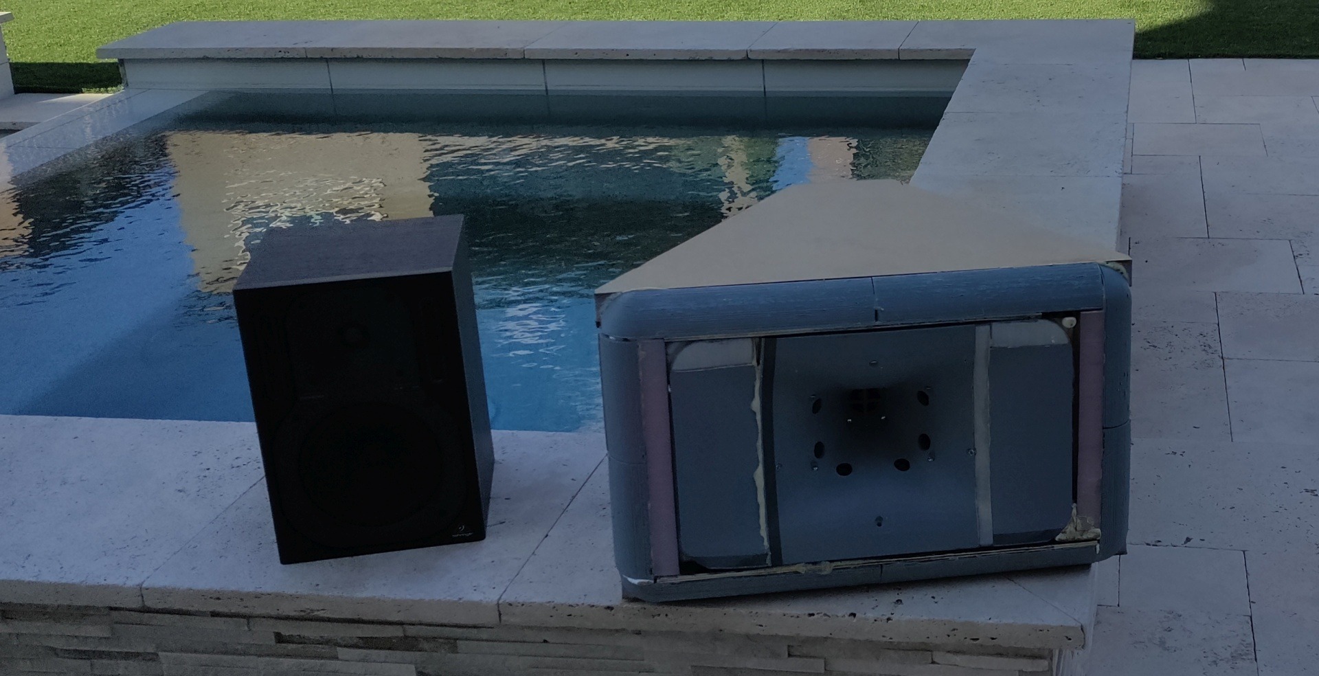

I found a three year old video of Metlako II:
Compare and contrast! I should record MIII playing the same track.

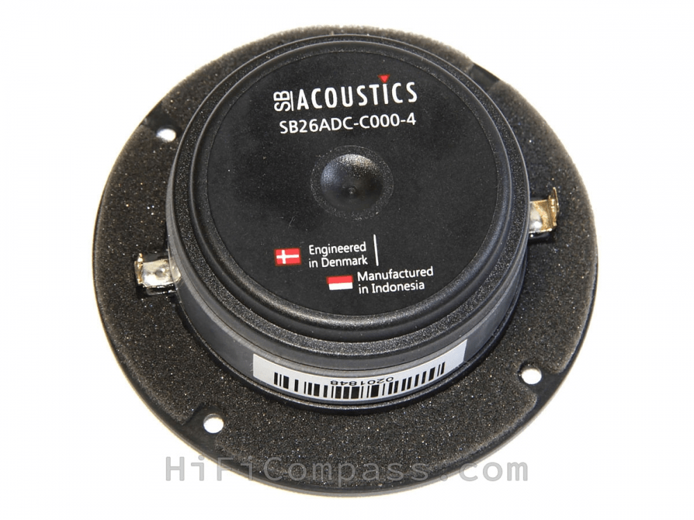

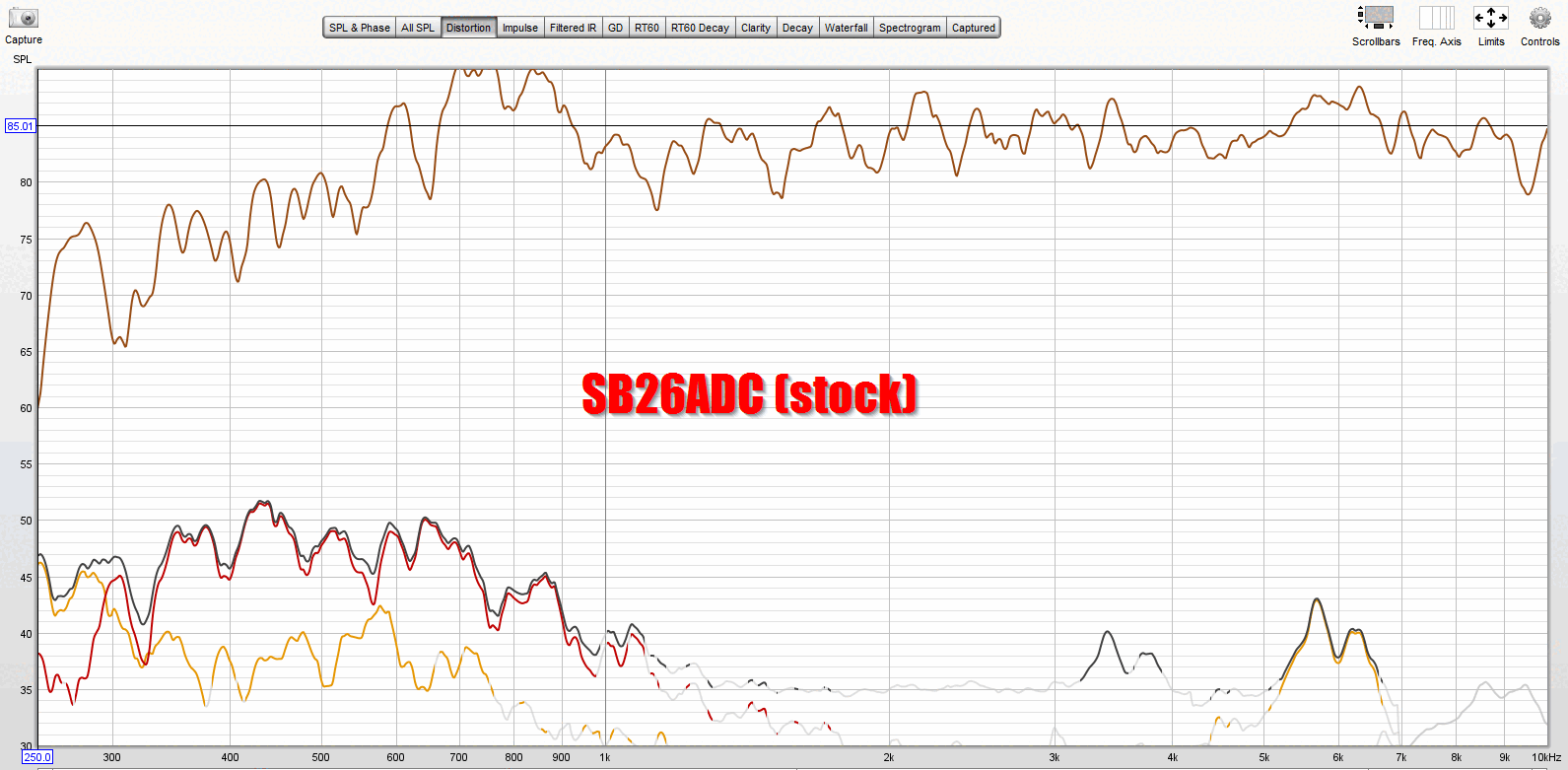

1) the distortion of the "stock" SB26ADC tweeter
2) the distortion of the SB26ADC tweeter with a metamaterial absorber that I designed and 3D printed
3) same as above but with polyfill in the absorber
4) same as #2, but with rockwool in the absorber
I think the results are interesting. With the last metamaterial absorber that I made, documented in the thread "3D printed metamaterials", I didn't use any stuffing. But today I found that stuffing reduces distortion even further than with the metamaterial absorber alone. In all, the metamaterial absorber with rockwool stuffing reduced harmonic distortion by about 6dB below 1khz. More importantly, it flattens out the impedance curve quite a bit, which makes it a lot easier to use a simple passive xover on the tweeter. Basically you can avoid using a zobel filter. Which is especially nice, now that inductors cost about ten bucks these days.
You'll probably notice that the overall frequency response is pretty rough. This is because I measured the tweeter with no baffle. I wouldn't go that route if I was focused on evaluating the frequency response. But since all I was doing was measuring distortion, and I was doing an "apples to apples" comparison (all variations were measured with the same voltage, distance, etc) I think the results tell me what I need to know.
Which is basically: metamaterial absorbers work. Realistically we should probably be using them in ALL sealed boxes, particularly tweeters.
It's a pretty simple print too. It took less than two hours and the cost of the filament is probably about three bucks.

According to "Sound on Sound:"
"Second-order harmonic distortion comes from non-linearities in the system — for example, the 'air springs' on either side of the bass driver being different (the air on the inside of the cabinet is stiffer than the open air outside, and more so in a sealed cabinet than a vented one) — and it sounds nice. It brings 'warmth' and 'fullness' to the sound."
That would seem to indicate that the reduction in distortion we're seeing is due to the absorbtion of the tweeter's back wave. Taken to the extreme, you'd absorb 100%, similar to what B&W strives for in their "Nautilus" speakers.
Some might argue that one could get the same results by simply using a very large back chamber for the tweeter. But there are additional advantages to the metamaterial absorber:

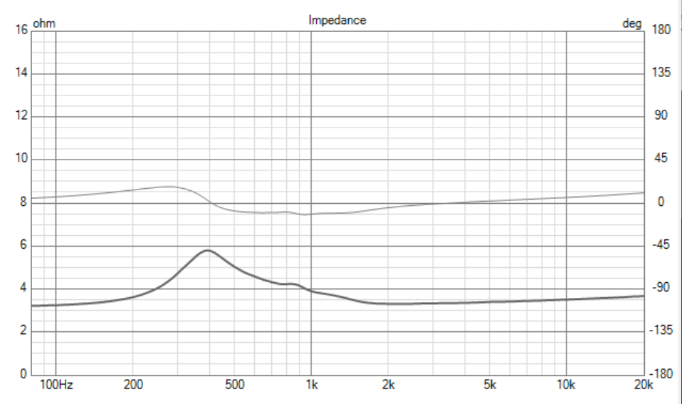

1) It's pretty darn small. Mine isn't remotely as small as the one in the Kef speakers, but it's still small enough to fit in the palm of your hand. (I'll post pics soon and the STL file.)
2) I believe the reduction in impedance is a pretty big deal. It makes the crossover a heck of a lot easier (and cheaper.) And another cause of distortion is variances in inductance. Since the impedance peak is reduced substantially by the metamaterial absorber, it stands to reason that inductance related distortion should also be reduced. In order to test this out, I'd likely need to test at much higher power levels (to push the excursion up) and I wasn't too keen on doing that because I'm not eager to destroy my tweeter.

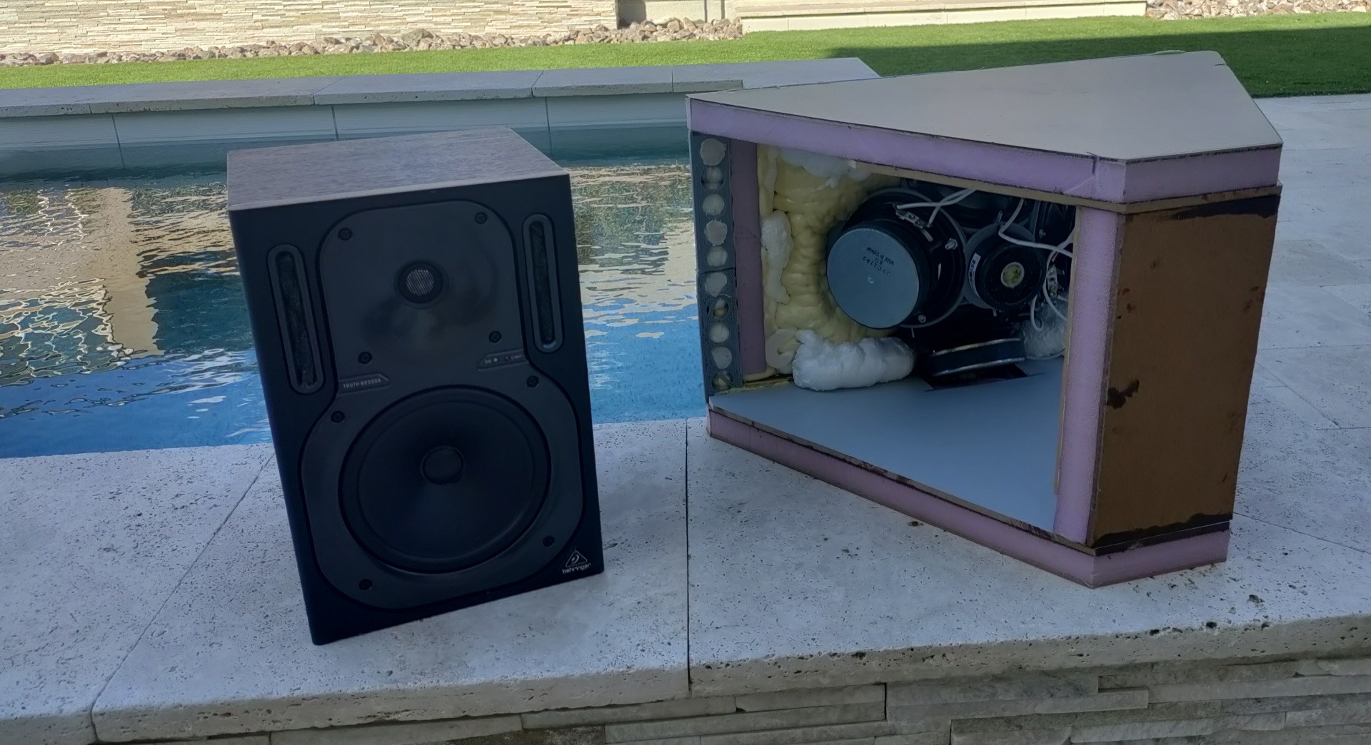

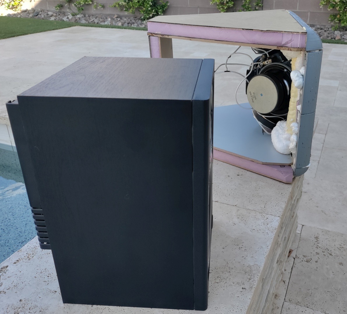

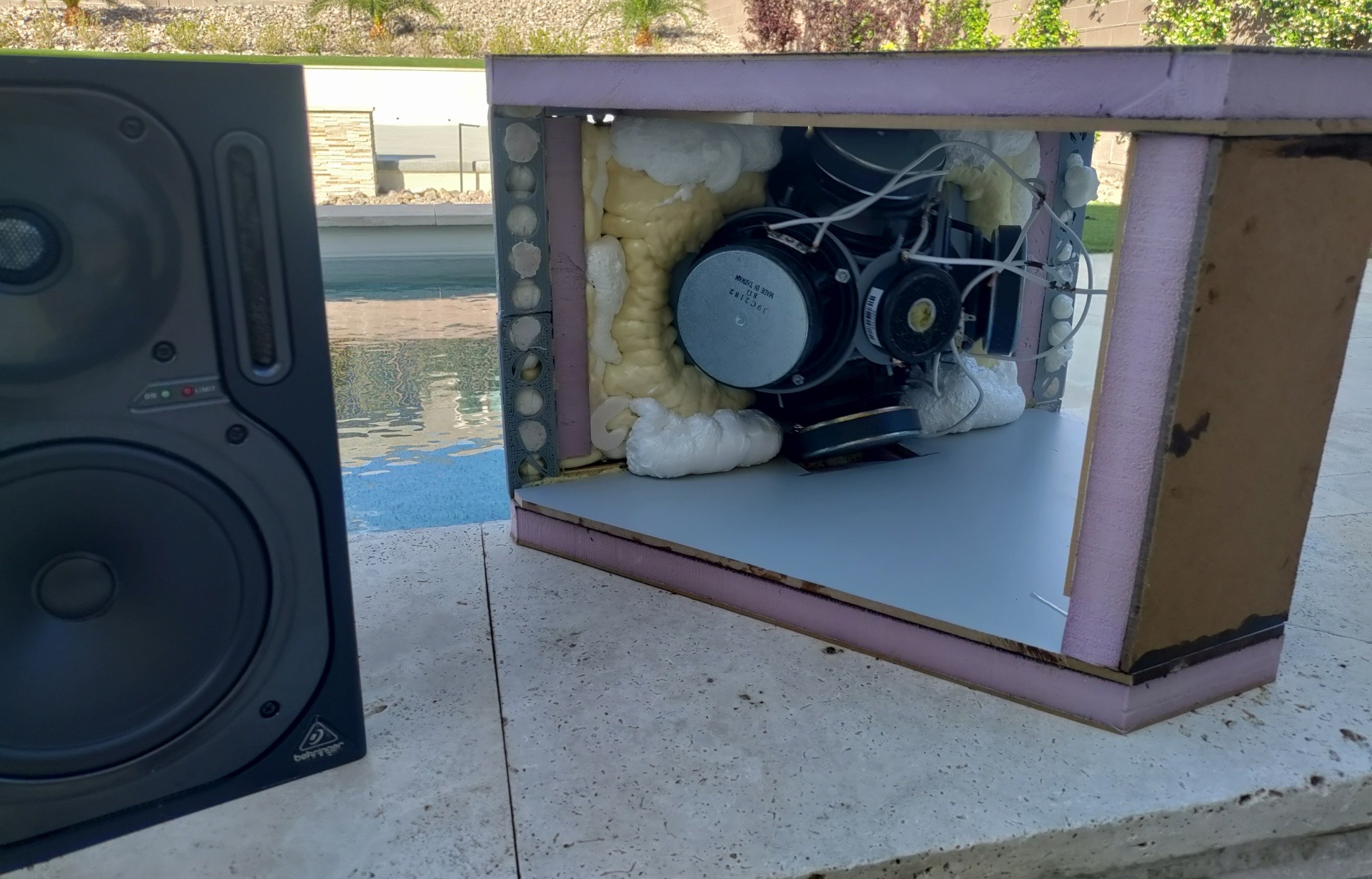

Moar pics.
I included a Behringer 6.5" two-way for comparison's sake.
3D printing allows you the opportunity to pack the drivers together to a ridiculous degree.
impresive packing density. I notice the box is quite deep compared to the waveguide assembly. Perhaps the waveguide could be in a much smaller enclosure and the bass handed over to a dual opposed woofer array that could fit in the remaining volume in a simlar style to this: https://www.devialet.com/en-gb/phantom-speaker/phantom-i/ (high power, high excursion, small volume)

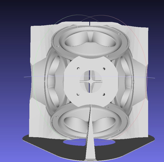

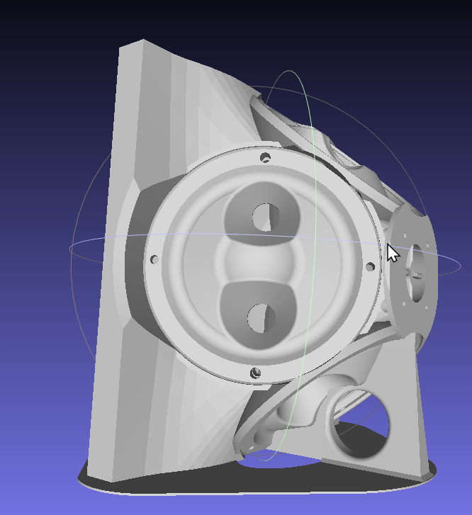

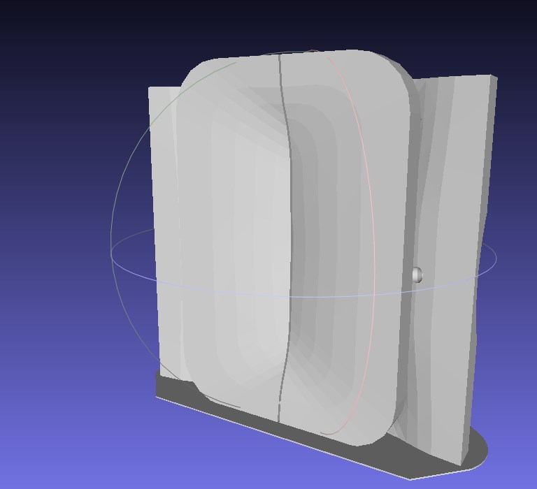

Attached are some pics and the 3D models for the waveguide.
If you just want to get to the print, grab the file titled "Metlako III STL model.zip"
If you want to make any changes to the original model, grab the zip file with the 123D file inside. 123D hasn't been updated in years, but it's still free and it's my fav.
The finished speaker has a roundover that's fundamental to it's design. That file is attached and named "roundover may21"
With the roundover, note that you must print four, one for each quadrant of the waveguide.

It's in post #110, three comments ago:
The model looks a bit strange because the left and the right edge of the waveguide have been sliced off so that everything could fit on one print run. It's also functional; by covering up the throat of the waveguide while it's being printed, it keeps things hot inside that gap, which is why the throat of my print is pretty clean. Any type of air movement is bad news, especially if you're printing in ABS or ASA. (My print is ASA.)
That's the vertical line in my print, it's where the cut is
The change in colors on my print is because I was using up some filament that didn't match. If all your filament is one color, your print will be one color
