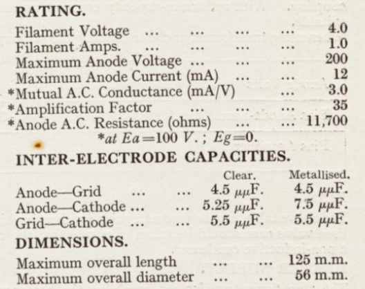

With the 1920s valves, the Pa was not stated, because is is assumed that you run only Class-A, and use the maximim anode voltage (180V) and ½ the maximum anode current (=25mA) = 4,5W
For capacitances, we can use the values of the Mazda AC/HL.
AEI Mazda bought Met-Vick (COSMOS) in 1928, and the AC/HL was the newer version of the COSMOS AC/ valve
Cag = 3,5pF
Ca-> all: 7pF (anode to all earth-referred electrodes)
Cg-> all 7pF
Check out the history of the AC/HL here: Link-AC/HL
Read about the famous 250 000 hour BBC Mazda AC/HL! Worth a read.

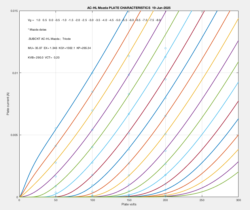

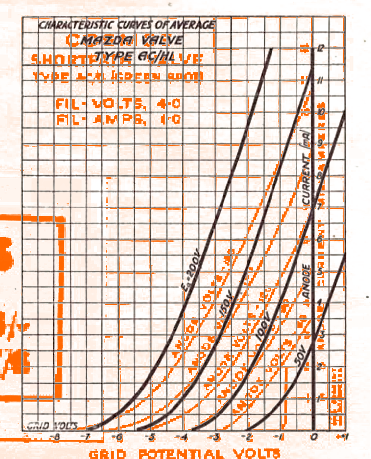

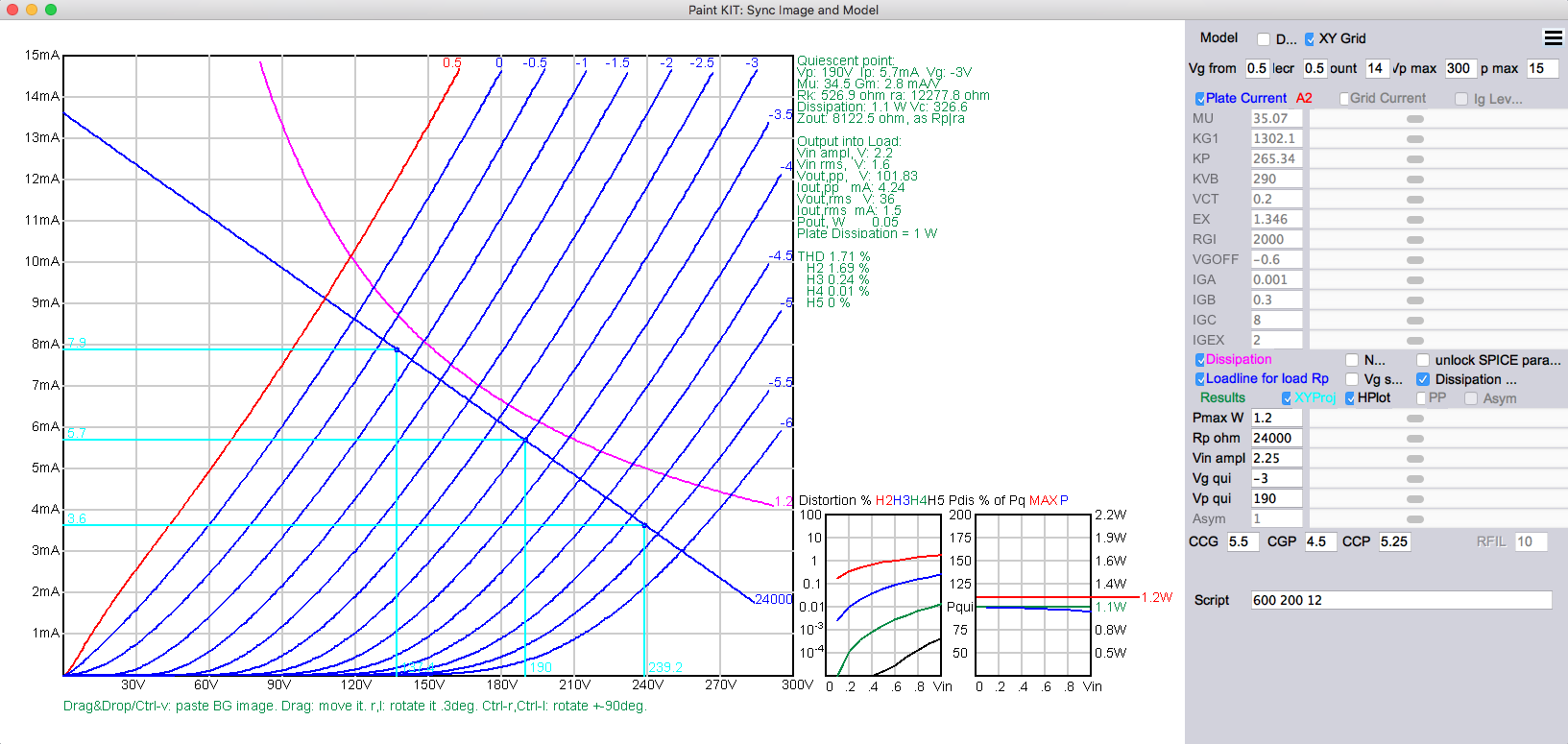

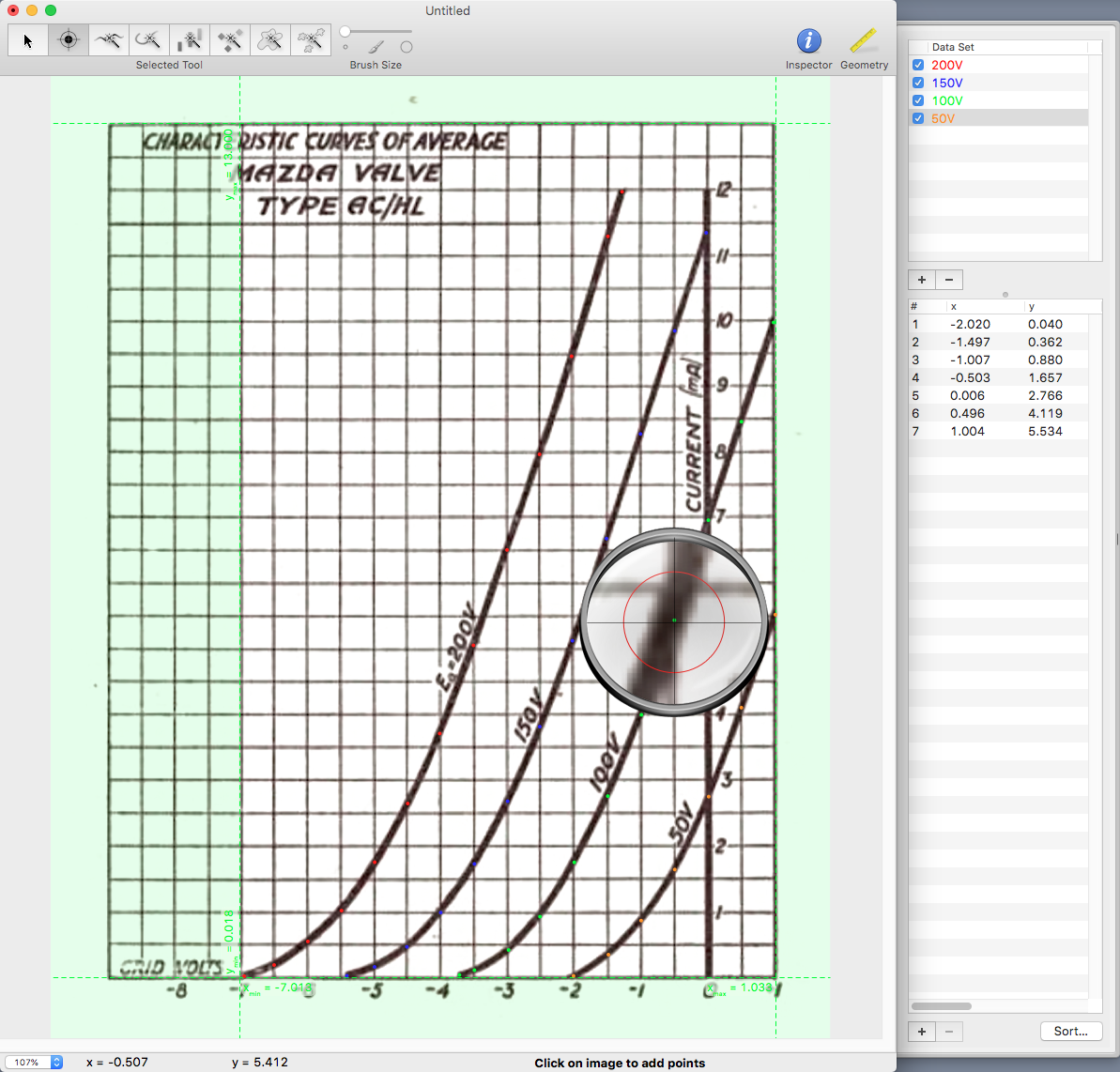

I checked Mazda AC/HL few days ago. Same method as for AC/R.
Graph click data points extraction.
Text Wrangler sorting datas
AC-HL DATAS GC.txt
MatLab modelling
(note that Ug starts from +1V not from 0V)
Again, very linear tube. But it is huge differents from AC/R type.
AC/HL has significantly higher mju factor of 35, and other parameters are different...
Check with the Tools
As You suggest I corrected Pa max to 1.2W ( Pamax x (Iamax/2) )
Capacitances from AC/HL Mazda datas
I put glass non-metallised data for booth tubes AC/HL and for AC/R
Spice models for AC/HL and for AC/R

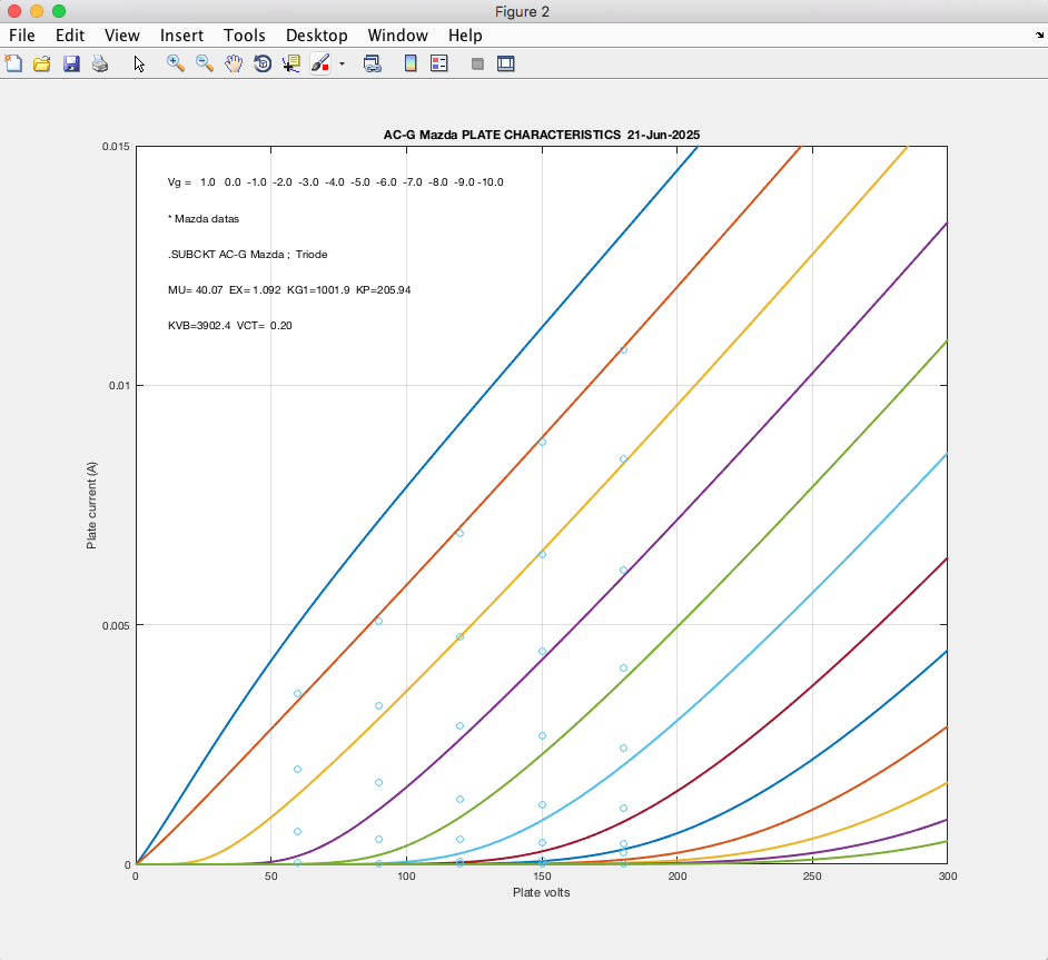

Hi Rod yes but still there are some diferences?the Mother of AC/HL was AC/G

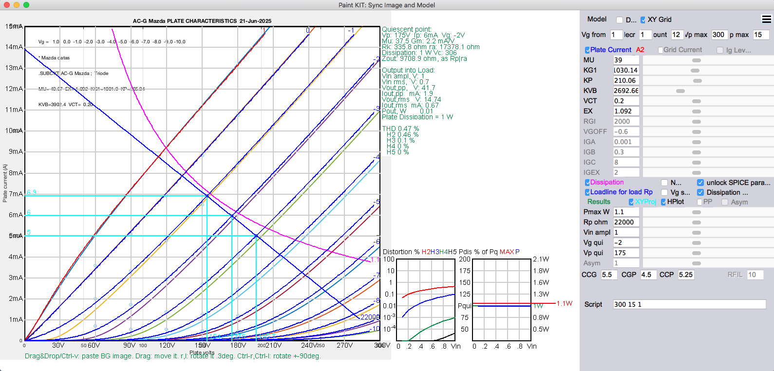

With same procedure I made another model for AC/G
in the AC-G GC DATAS.txt file datas stored.
I additionaly made little improvements from MatLab starting model with tools. To make anode curves crossing as close to the extracted datas.
There is a spice model:
Code:
**** AC-G Mazda ******************************************
* Created on 06/21/2025 15:01 using paint_kit.jar 3.1
* www.dmitrynizh.com/tubeparams_image.htm
* Plate Curves image file:
* Data source link:
* Ug step 1V, from +1V to -8V
* capacitances from AC/HL Mazda type
* Ccg = 5.5P ; metalised 5.5P
* Cgp = 4.5P ; metalised 4.5P
* Ccp = 5.25P; metalised 7.5P
* Pa max. = Va max x Ia max / 2 = 1.1W
* Va max. = 180V
* Ia max. = ?
* Uh=4V, Ih=1A

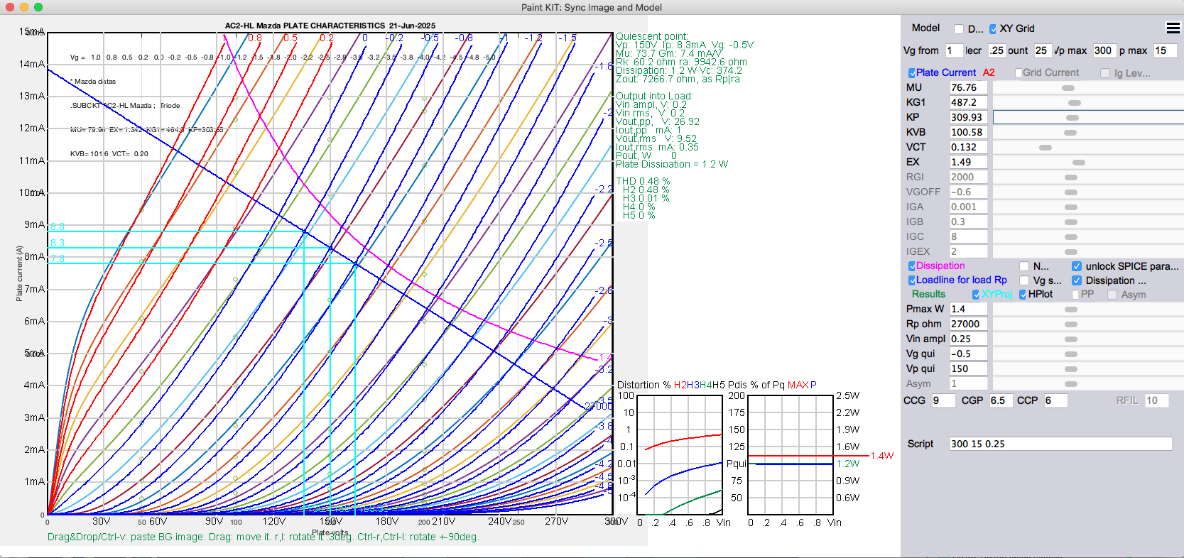

There is one more tube from Mazda AC series but with higher mju factor.
AC2-HL
There are 2 spice models one from MatLab other improved with tools soft.
AC2-HL
Code:
**** AC2-HL matlab model improved ******************************************

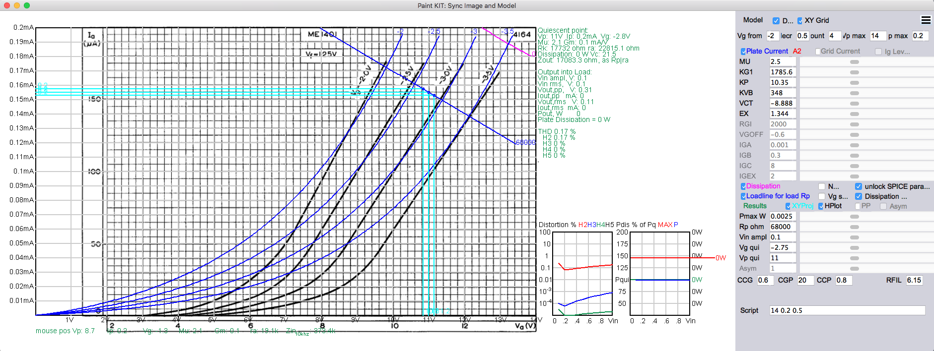

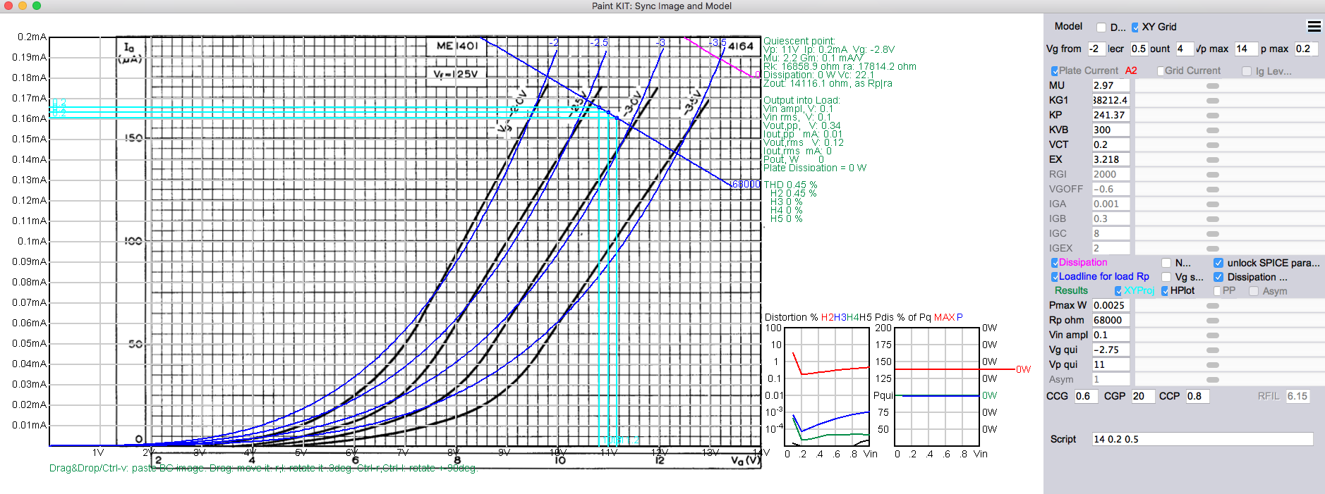

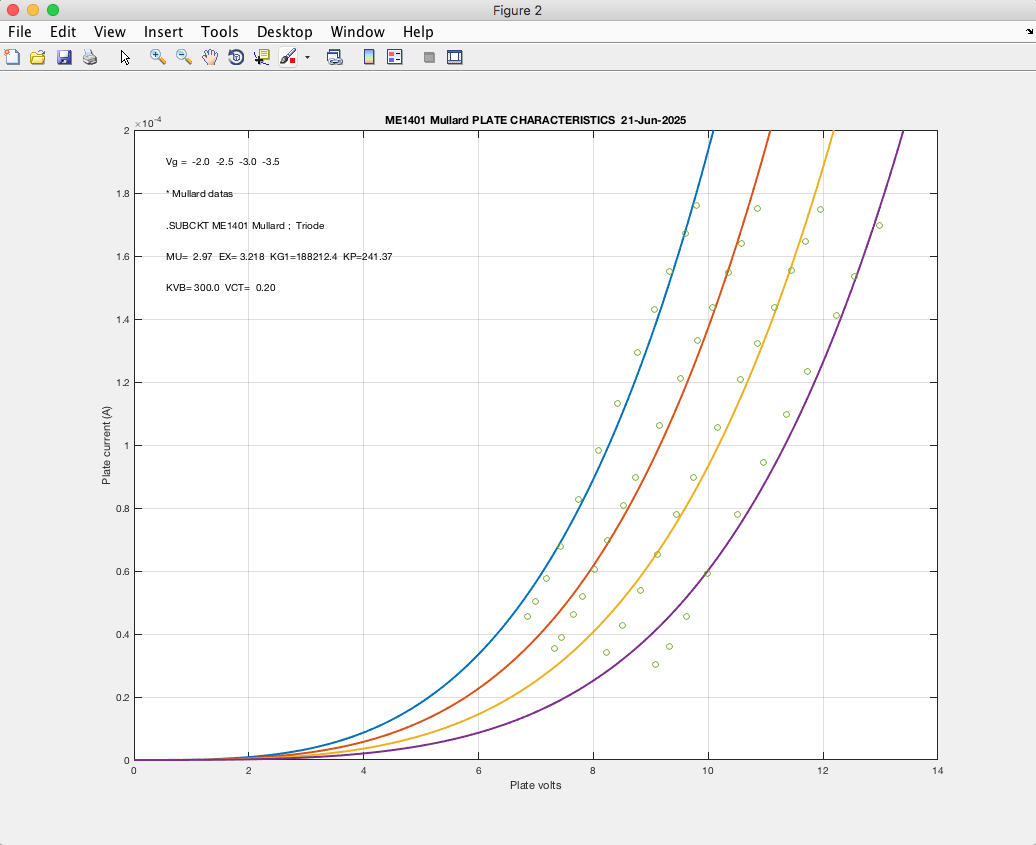

Hi Rod@Zoran - Does the encoder work with constant Ua curves ? I'm interested in the ME1401 - Link to ME1401 data, curves
This is very special little tube.
For now I only find some model but not accurate in whole range... 🙁
Only in the mid-upper region as You can spot.
With Tools soft.
Where in the operating region You want to use this tube?
Probably in linear region gravitating to the "top" of the graph?
I will try to extract point values and put in the MatLab soft to check.
Grid currents probably be very hard to model?
Start models for ME1401, DHT and plain triode

* Created on 06/21/2025 16:51 using paint_kit.jar 3.1
* Data source link:
.SUBCKT ME1401_start 1 2 3 ; Plate Grid Cathode
+ PARAMS: CCG=0.6P CGP=20P CCP=0.8P RGI=2000
+ MU=2.5 KG1=1785.6 KP=10.35 KVB=348 VCT=-8.888 EX=1.344
* Vp_MAX=14 Ip_MAX=0.2 Vg_step=0.5 Vg_start=-2 Vg_count=4
* Rp=68000 Vg_ac=0.1 P_max=0.0025 Vg_qui=-2.75 Vp_qui=11
* X_MIN=72 Y_MIN=34 X_SIZE=1007 Y_SIZE=580 FSZ_X=1881 FSZ_Y=709 XYGrid=true
* showLoadLine=y showIp=y isDHT=n isPP=n isAsymPP=n showDissipLimit=y
* showIg1=n gridLevel2=n isInputSnapped=n
* XYProjections=y harmonicPlot=y dissipPlot=y
E1 7 0 VALUE={V(1,3)/KP*LOG(1+EXP(KP*(1/MU+(VCT+V(2,3))/SQRT(KVB+V(1,3)*V(1,3)))))}
RE1 7 0 1G ; TO AVOID FLOATING NODES
G1 1 3 VALUE={(PWR(V(7),EX)+PWRS(V(7),EX))/KG1}
RCP 1 3 1G ; TO AVOID FLOATING NODES
C1 2 3 {CCG} ; CATHODE-GRID
C2 2 1 {CGP} ; GRID=PLATE
C3 1 3 {CCP} ; CATHODE-PLATE
D3 5 3 DX ; POSITIVE GRID CURRENT
R1 2 5 {RGI} ; POSITIVE GRID CURRENT
.MODEL DX D(IS=1N RS=1 CJO=10PF TT=1N)
.ENDS ME1401_start
Yes, only in the anode current > 75uA, or the linear current, and only 9 - 14V maximum.Where in the operating region You want to use this tube?
The grid current - I don't care. For my application, it's always zero.
Thank you very much!
