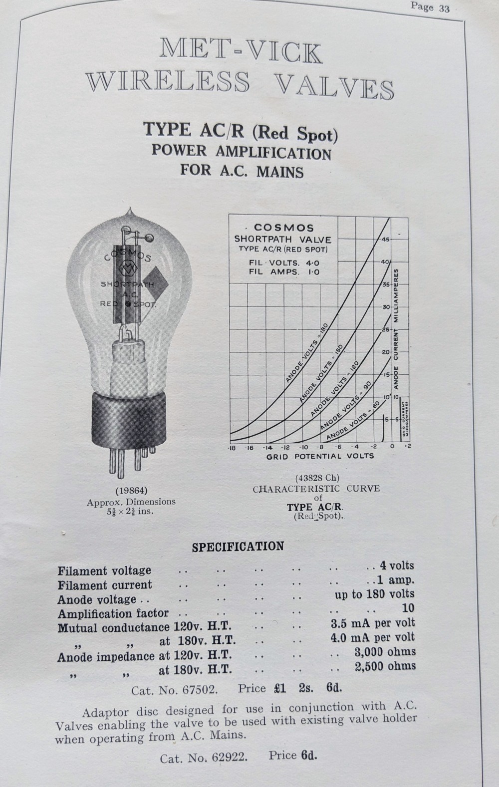

Or, maybe even better - the first truly reliable indirectly heated. This one uses E. Yeoman Robinson's slip-coated heater assembly for higher gm.
It also appeared in year 1927.- the Met-Vick - COSMOS AC/R, with 4mA/V:
Link: COSMOS AC/R
There are little or no data sheets for COSMOS valves on the web, but I can begin fixing that with uploads from a Septmber 1928 data book I happily acquired for a price of a half-pint.
The refererence to "Short Path" is an indication of how close the grid approached the cathode sleeve, which was apperently only 1mm diameter.
The 4mA/V that resulted was notable for the tim, and a while afterward.
