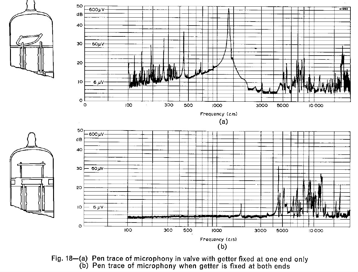

Microphony can be caused by any of the elements of the electrode assembly. Even the Getter!
This should not be a surprise, since lightweight metallic parts formed of thin material are liable to have sharp (like high Q) resonances. Even where these do not directly generate an electrical output, a high-Q mechanical oscillation can readily couple to grid.1, or any other feature than can.
And yes, it has been measured. Here is an example where modifications to the getter-attach (1 point vs 2-point) are compared in the response to vibration-table stimulus.
It should be carefully noted that these measurements are for miniature all-glass construction.
Large structures in the kind of valve that have mesh-anodes as an alternative (power Valves) will probably have more resonances - with higher "Q" for stiff material like Nickel sheet, less so for Mesh structures.
Reference: MULLARD RADIO VALVE Co, Ltd "Mullard Technical Communications № 61" LONDON: 1962 November.

Yes! And any resonating element will transfer that energy into the entire structure. That may well excite the more sensitive elements. I guess the one question would be, by how much? This will probably vary between production runs and certainly tube type.
Plate structures are usually circular, or box shaped with stiffening ribs. They are probably not prone to vibrating nearly as much. You would also be talking about a higher frequency, very strong vibration. In a home you'd have more pressing concerns. In an aircraft or missile/rocket, it would be cause for concern.
Anode assemblies are the element with the largest unsupported areas of thin metallic material in the electrode space. They are often assembled by methods designed for speed of manufacture, not rigidity. Actually, the cross section often looks like two bells facing each other. Ding Dong!
If you take the trouble to read the rest of the cited article, you'll see and example of a typical two-part anode vibrating most vigorously, due to a lack of overall rigidity.
I have another article assessing the microphony of a valve expressly designed to minimise it - not wholly a success.
The article only treated all-glass valves; others are likely to be worse, and sometimes much worse in this regard.
All of this points to the anode being a potential weak spot, in power valves even more so.
There are exceptions - EML has done a fine job of suppressing microphony in power DHTs by careful design touches. But it was a conscious effort - an example of design for purpose. They are aimed at modern designers of top rank audio, in the way that Marconi-Osram, and Western Electric did with theirs ninety odd years ago.
