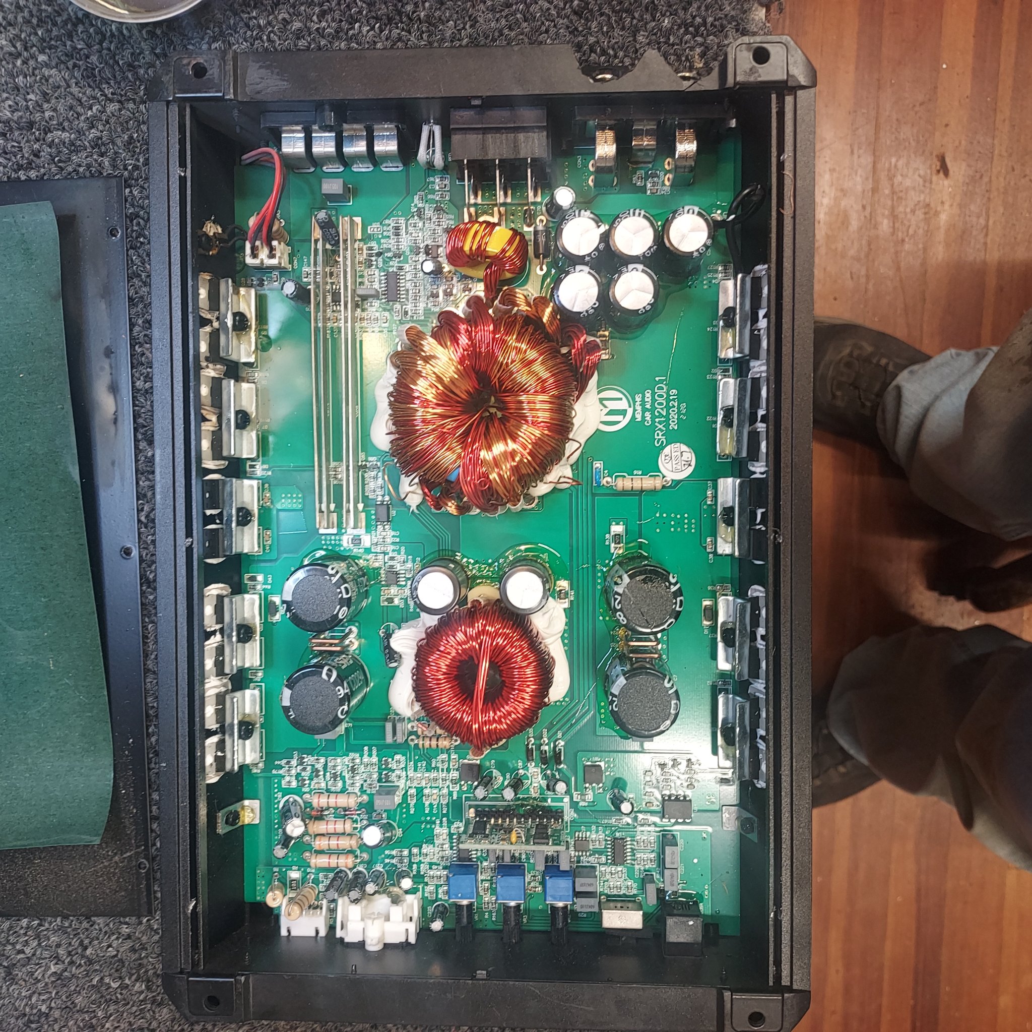

Memphis SRX1200D.1 protection circuit
Does anyone have a schematic for this amp? I am having protection circuit anxiety.

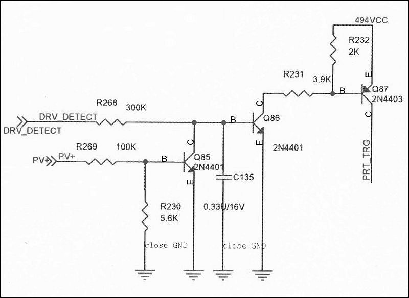

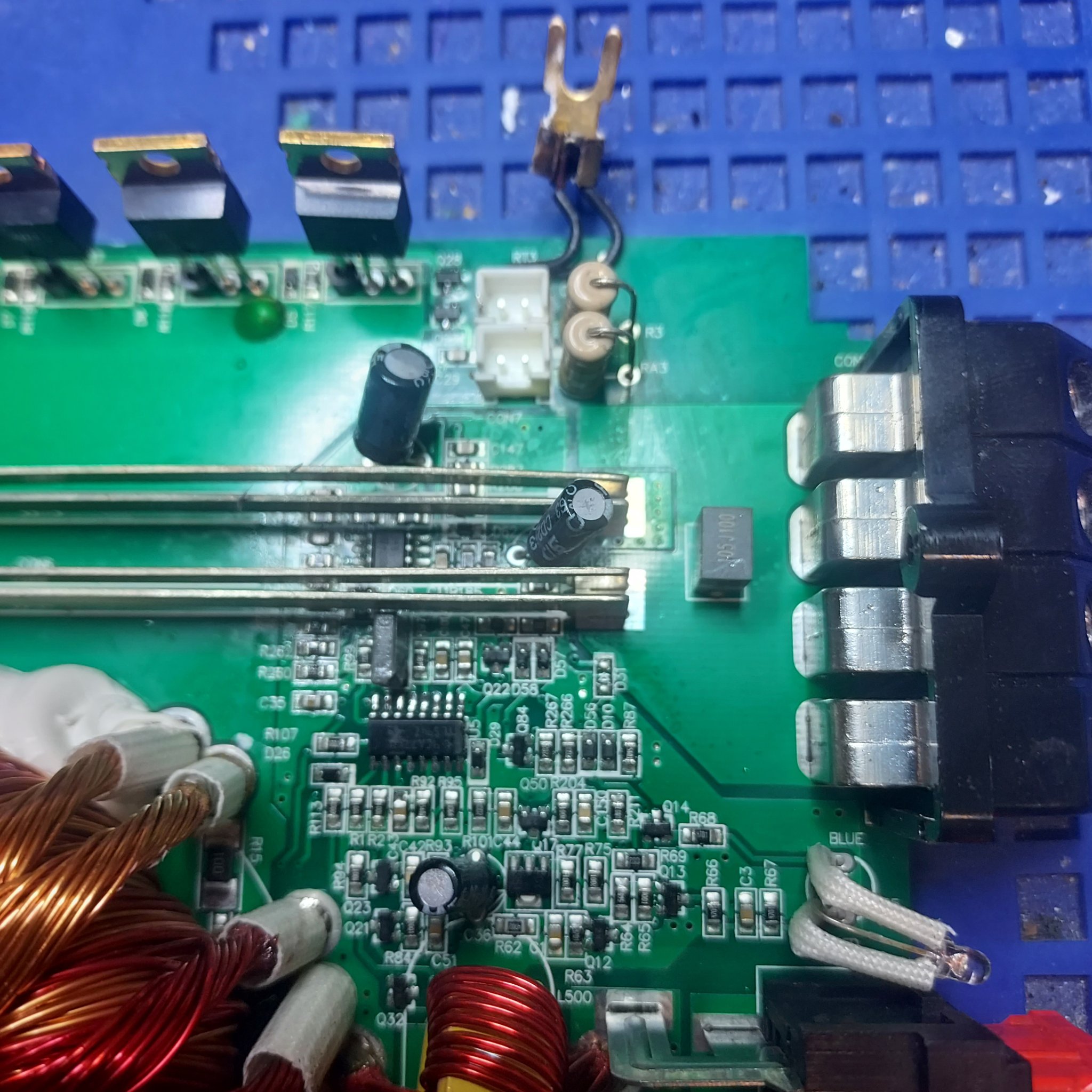

Some of these amps have a protection circuit that will shut the driver IC down if it doesn't see rail voltage. You can either find the protection circuit transistors or install the rectifiers.
There are variations but the attached is one version. You'd remove/lift Q87.
Feel free to ask questions.
Wait until you get a Brazilian type amp that uses an MCU to control everything and all coding is proprietary... and many replacements must come from Brazil... and they do fail. To make them even more fun, many deface the semiconductors and to make it just a bit more fun, the over-current protection is (supposed to be) matched specifically to the output FETs. Failure to make the calculations and circuit mods will not allow the over-current protection to function. They also have two different protection circuits per driver IC that require different calculations. AND that's virtually all that's being sold because they're cheap and that's the most important aspect of an amplifier for many people. For the larger amps (power rating), they can take 900+ amps of current to run up to full power.

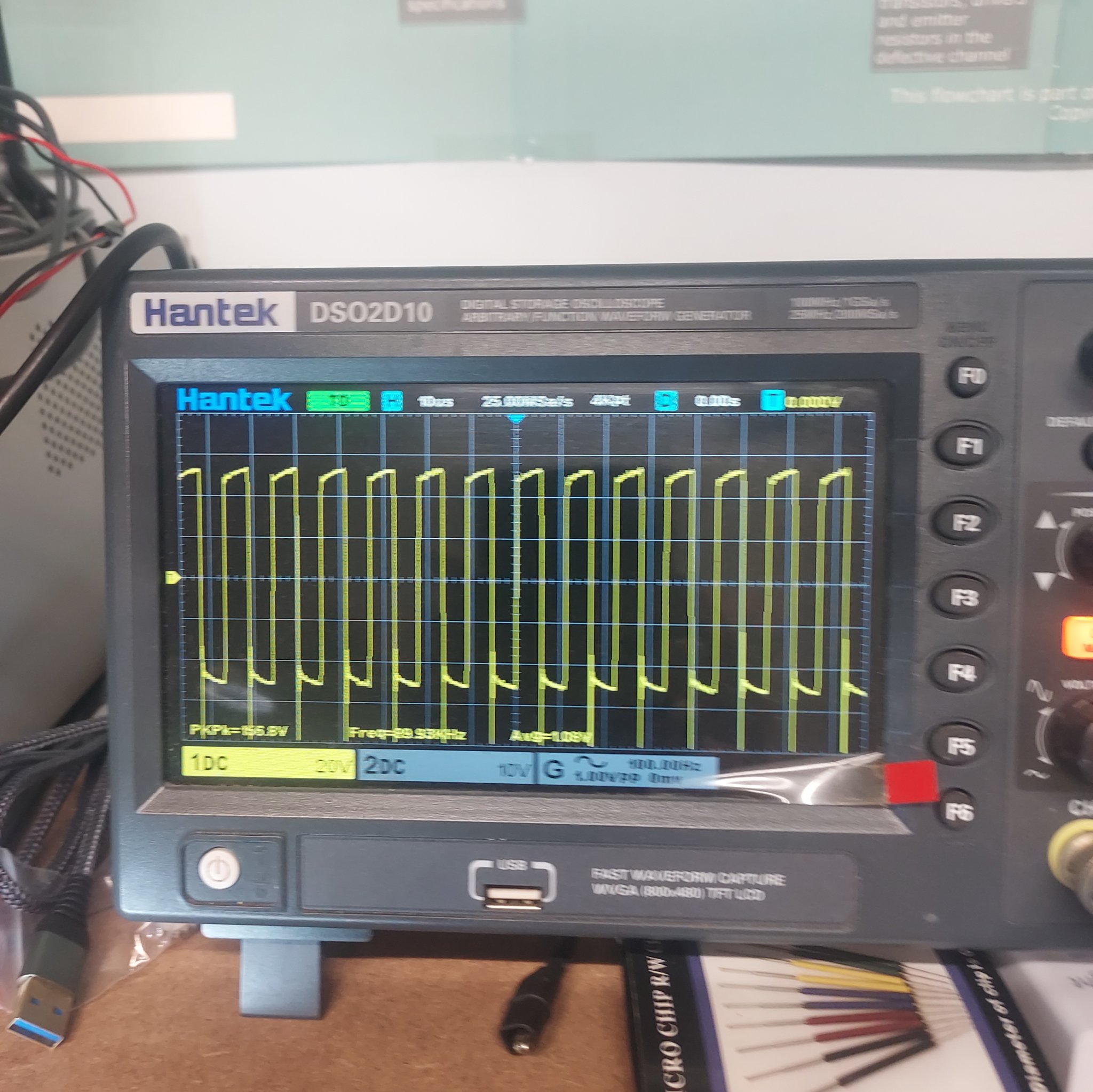

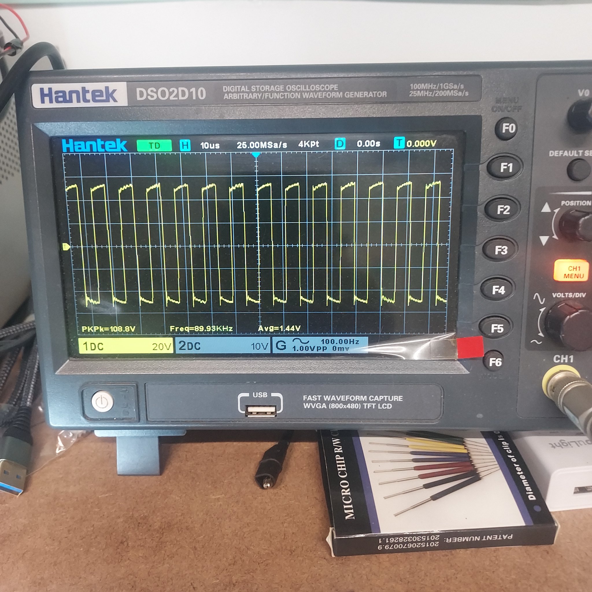

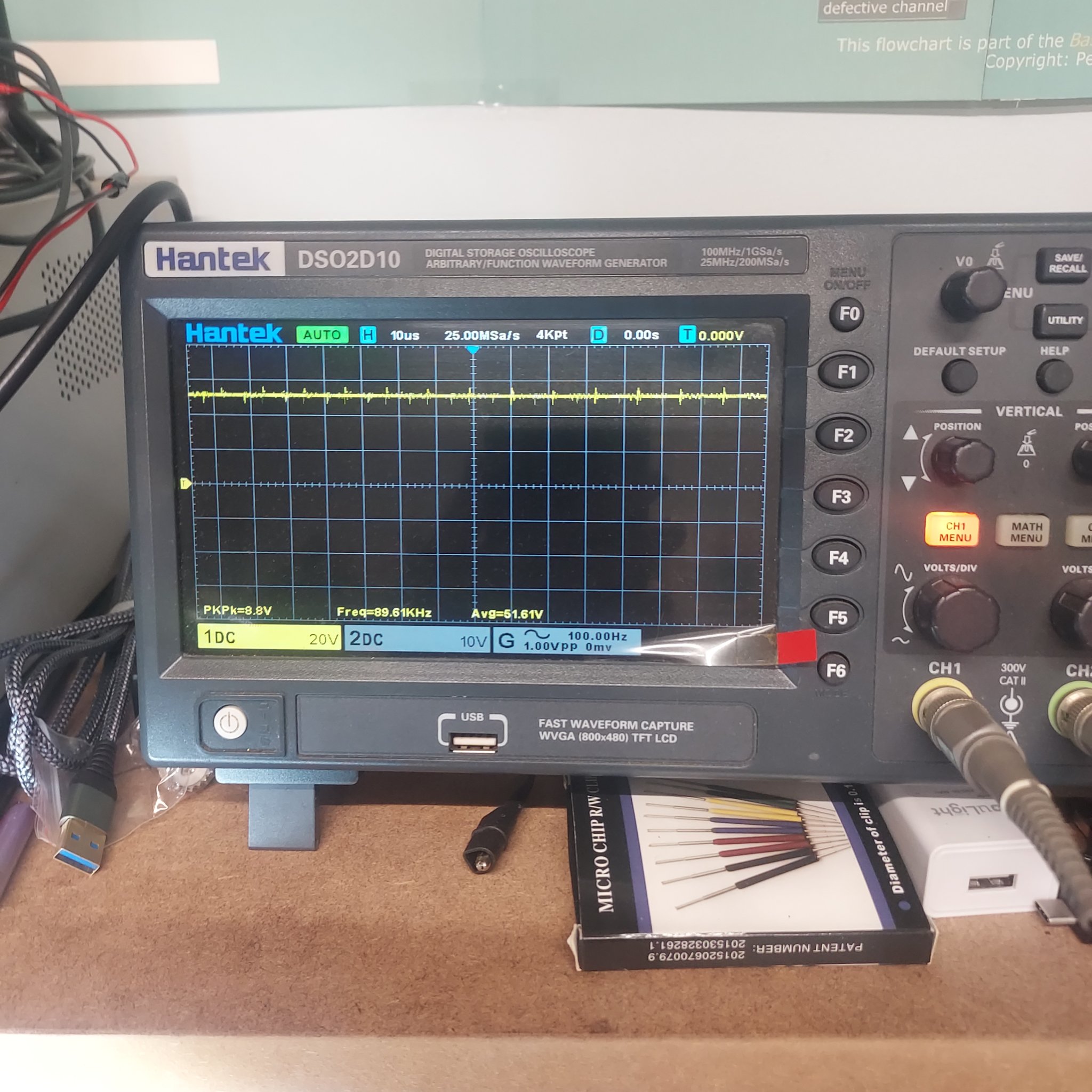

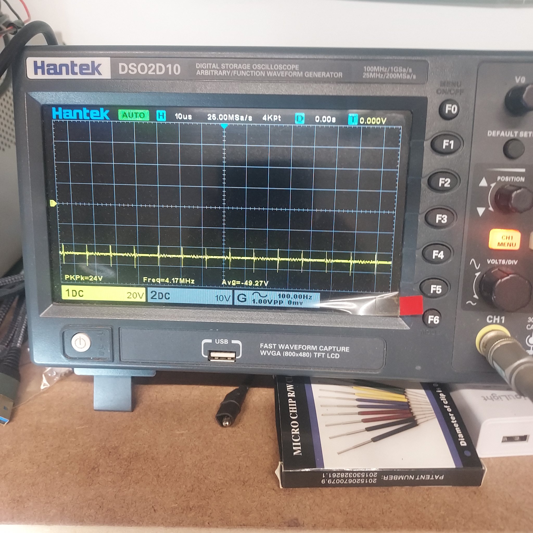

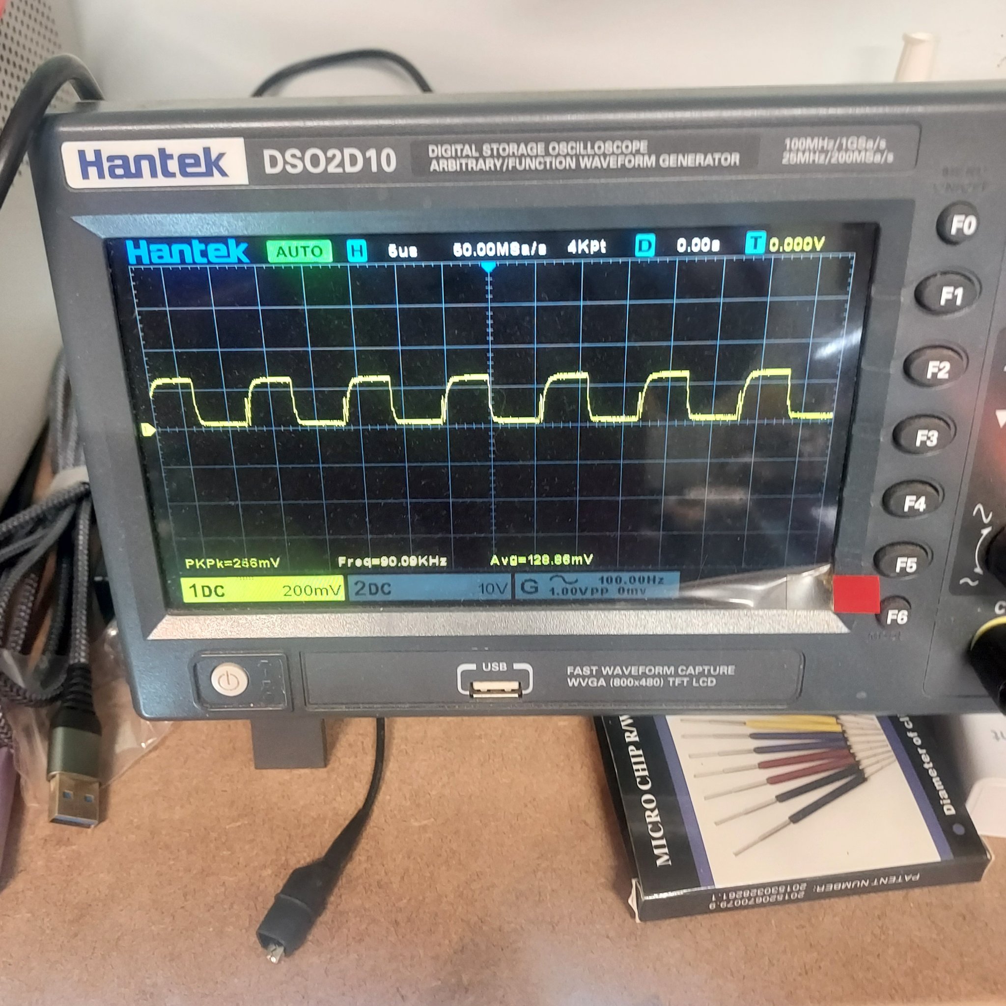

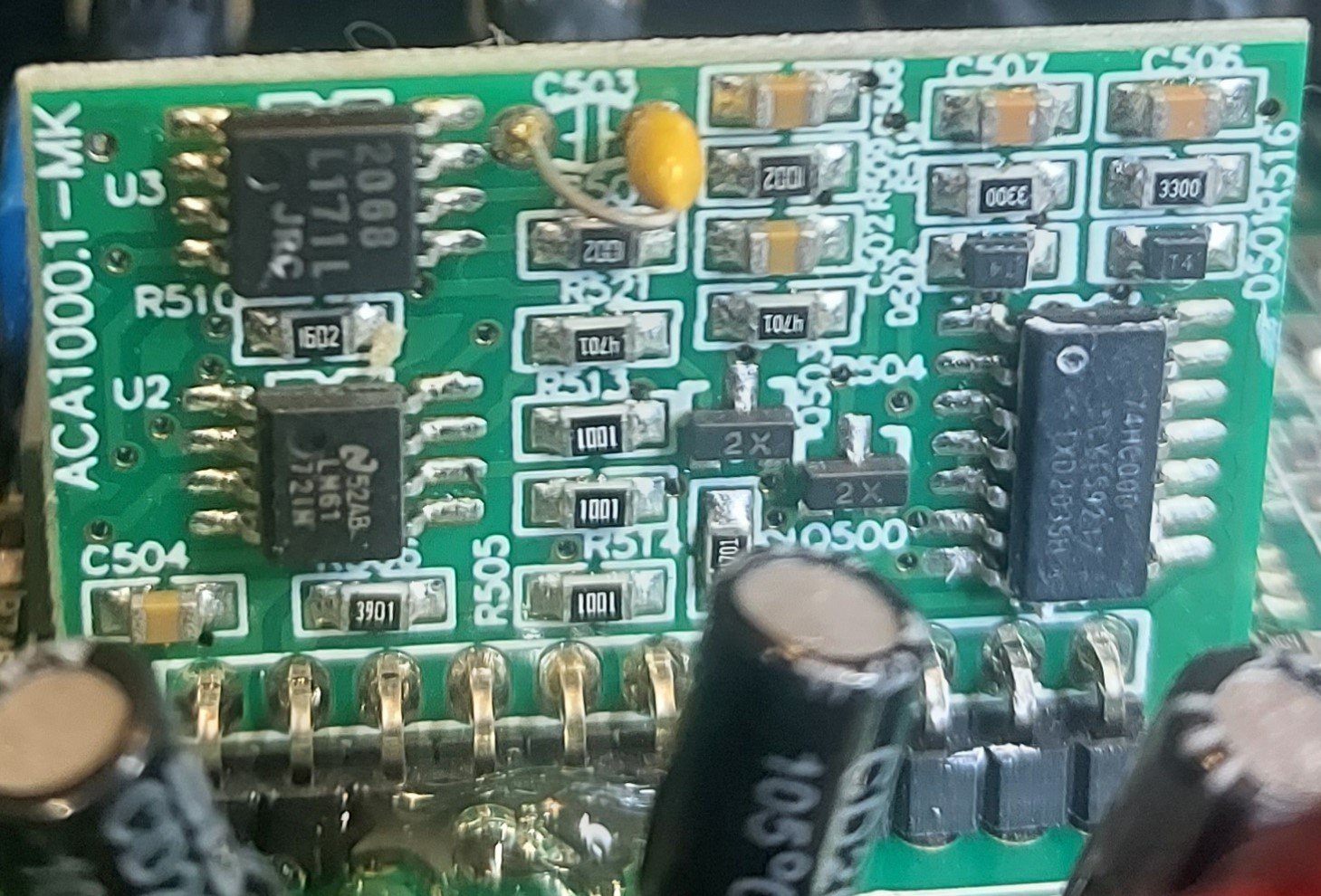

Trying to identify this output board. U3 is a dual op-amp. I have been unable to identify U2. The 14-pin IC from what I can gather is a quad 2 input NAND gate. I don't think I have ran across this and I can't seem to locate it in the repair tutorial. I seem to be missing drive on one side of the amp.
JRC2068 and LM6172. These vary quite a bit from various build houses.
If you have the tutorial, on the Type 4 page, perform a ctrl-f search for:
The letters on the diagram
There is a white diagram under that that shows the basic circuit. Again, not all are identical but it gives you the basic layout.
Do you have two output signals from the board? That will give you a good idea as to where the problem is without replacing parts.
I have a set of differential probes. Where do I reference for the high and low sides? The rail voltages? The IRF640s were heating up faster than the IRF640Ns. I have it in the heat sink now, but that side with the IRF640s still seems to be running warmer. Do you think using a different gate resistor would help? It has 22 ohm resistors in it.
