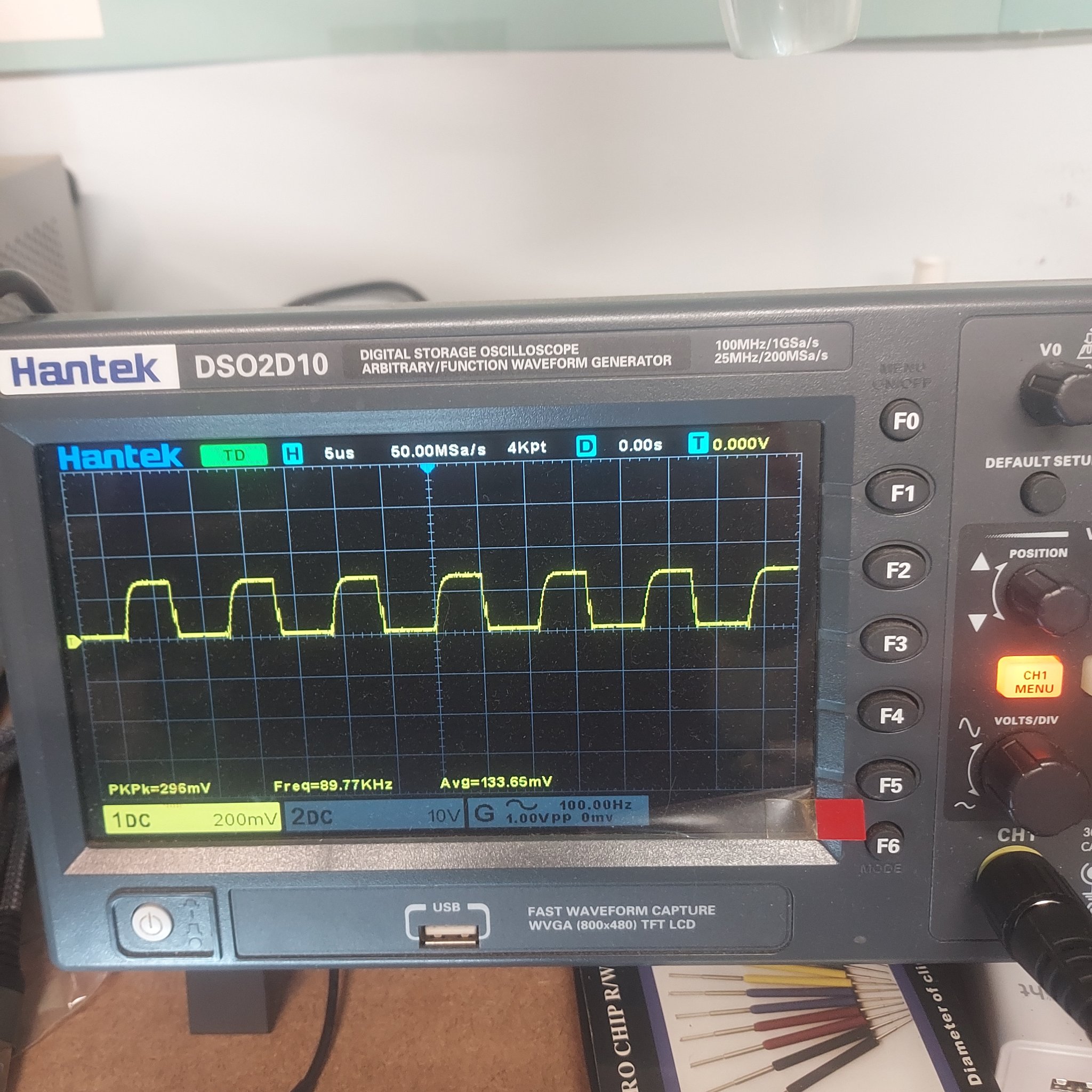

They really don't look bad but it doesn't take much cross-conduction to cause heating.
This type of amp generally uses 10 ohm gate resistors. You have a couple of options, replace the gate resistors or the 640s with 640Ns. I think I'd start with the resistors.
I use it a lot. Just have to set your temp and air flow rate correctly. I don't want to take it out of the heat sink unless I have to. I do have some hot tweezers if I can get them in there.
