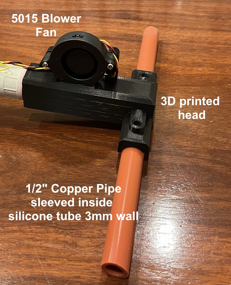

I have finally managed to finalise this project and in this message, I'll provide the (previously missing) data and construction details.
The previous iteration worked quite well but (in my opinion) had a couple of issues :
1) Borosilicate glass is a great insulator, however, it is fragile
2) The HV electrode inside the borosilicate tube gets quite hot after a couple of minutes of continuous use
To address the above problems and finish this project, the following changes have been made:
A) HV electrode is now a 1/2" copper pipe (plumbing) sleeved inside a silicone tube with 3mm thick walls
B) 5015 blower fan is introduced in the corona stick head to cool inside of the copper pipe(s)

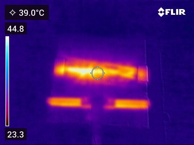

The additional air cooling has eliminated the HV electrode-heating problem.
Even after several minutes of operation, the electrode temperature is lower than 45 degC.
The FLIR image below shows the PCB sheet being hotter than the HV electrode below.
With 3mm silicone insulation, I need 24DC and approximately 5A for a stable and uniform corona discharge.

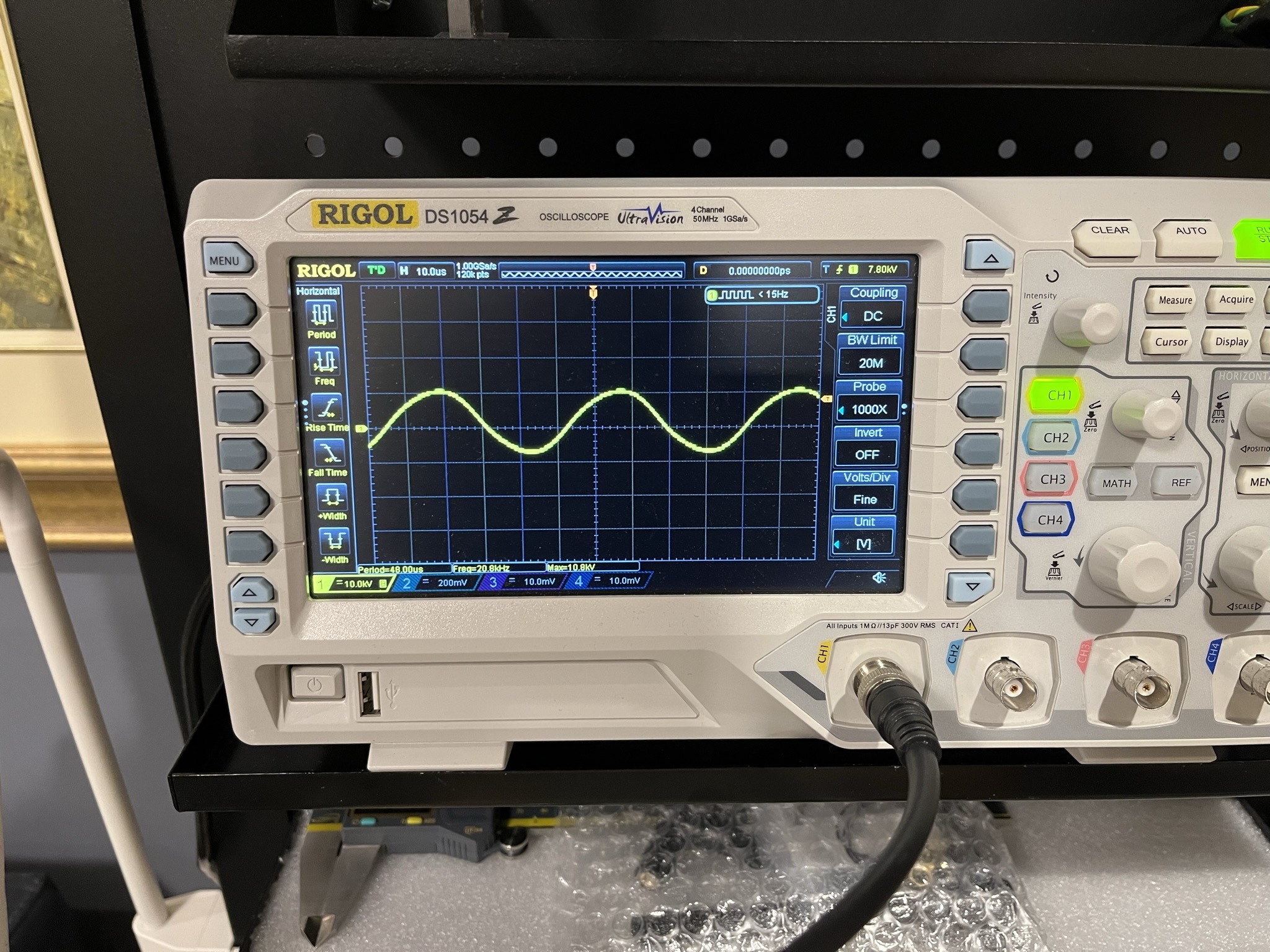

The HV output is 10.8kV at approximately 20.8kHz. (finally managed to build that HV scope probe 🙂 )

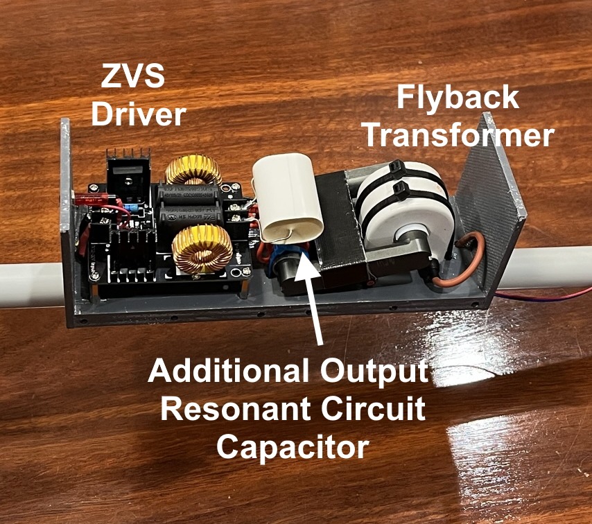

The corona driver details are provided in the paragraph and image below.

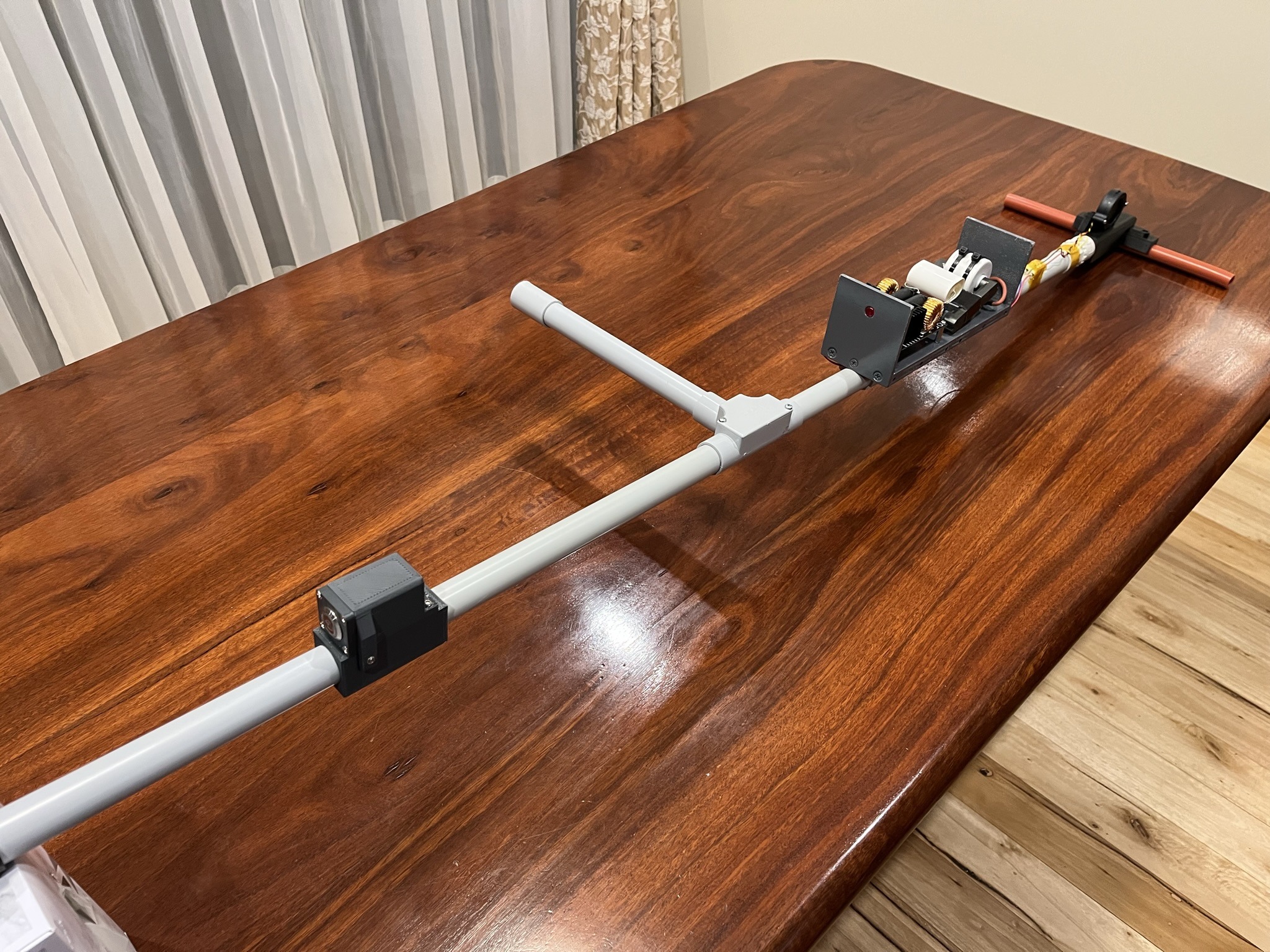

The final version of the corona stick

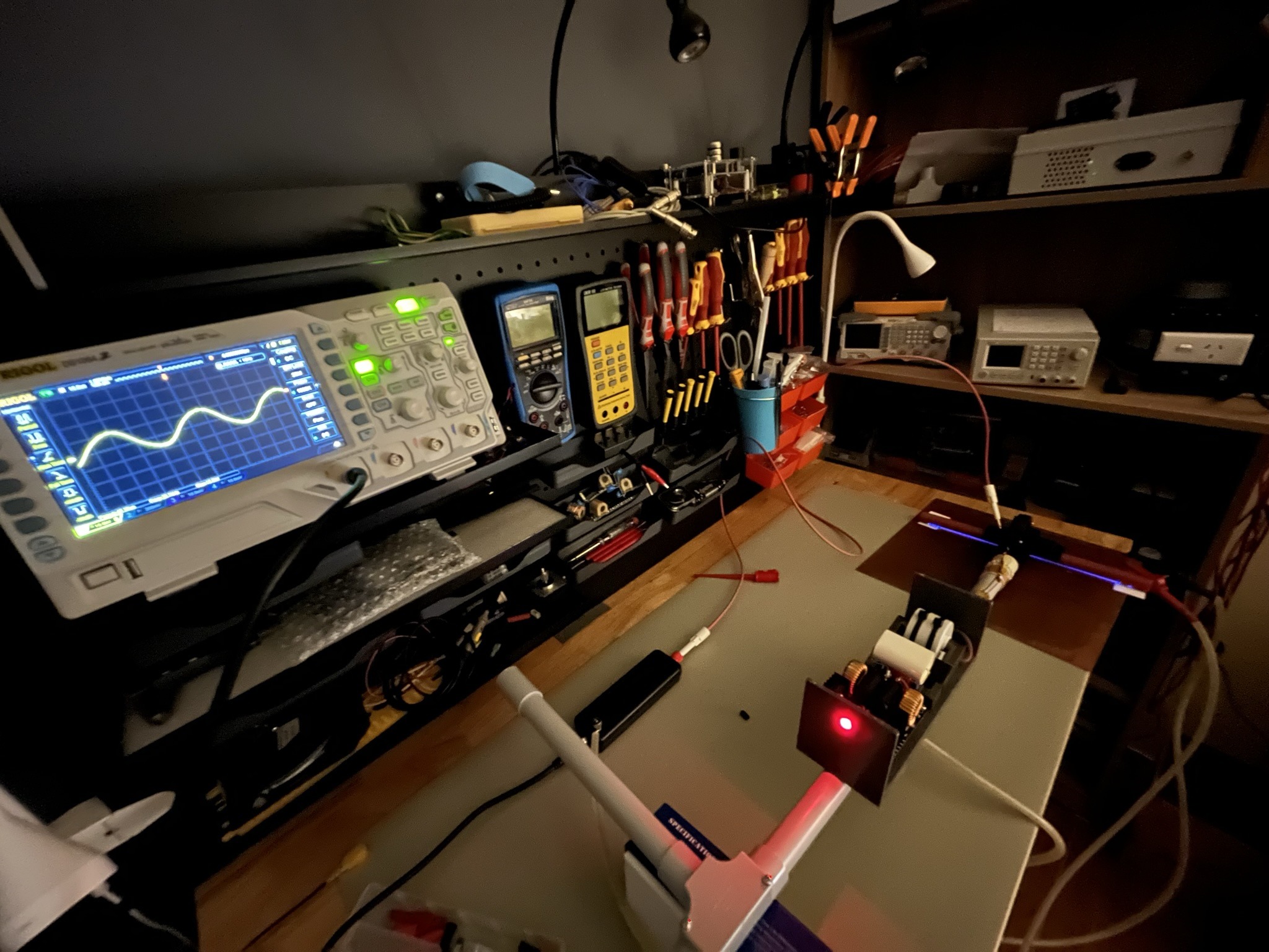

Final testing

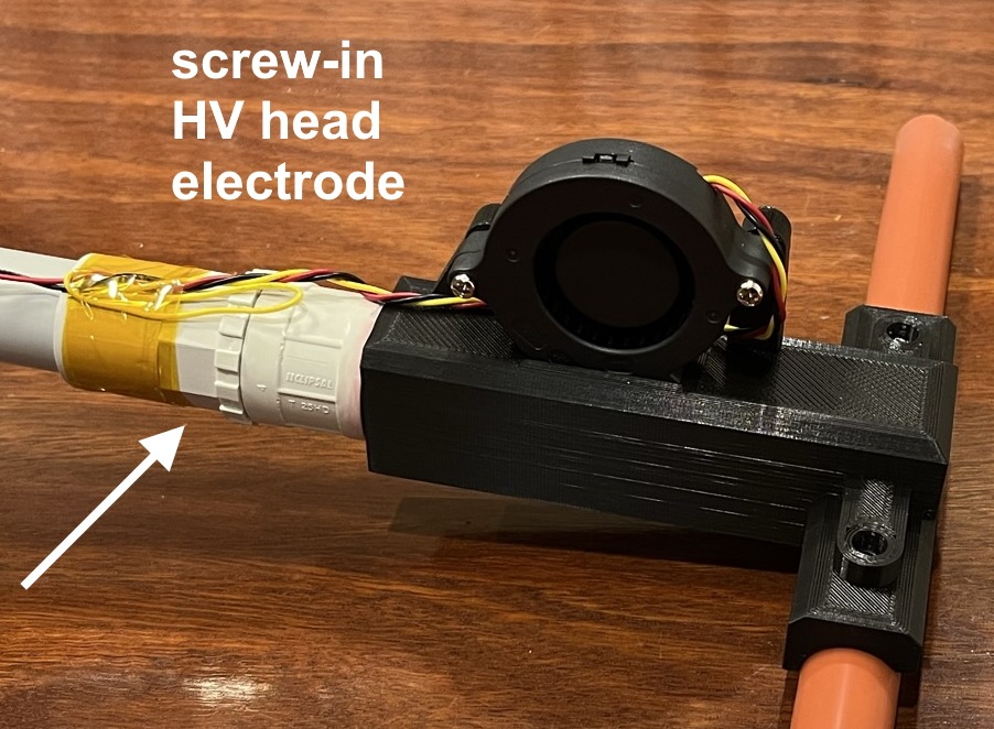

Also, the corona HV electrode is now replaceable and I will make another head with a blower and Jacobs ladder-type spark generator (previously mentioned by Calvin). That should be quite useful for the activation of irregularly shaped plastic objects that require glueing (e.g. ESL63 PCB to eggcrate).

- Input 24 V DC @ 5A
- ZVS Driver from eBay or Amazon (use the one without the inductor centre tap)
- Additional 1uF film polypropylene capacitor across the inductor to lower the resonant frequency
- AC flyback transformer (must not use DC flybacks with built-in diodes) FLYTCL250 from https://www.amazing1.com/transformers-high-voltage-high-frequency.html should work

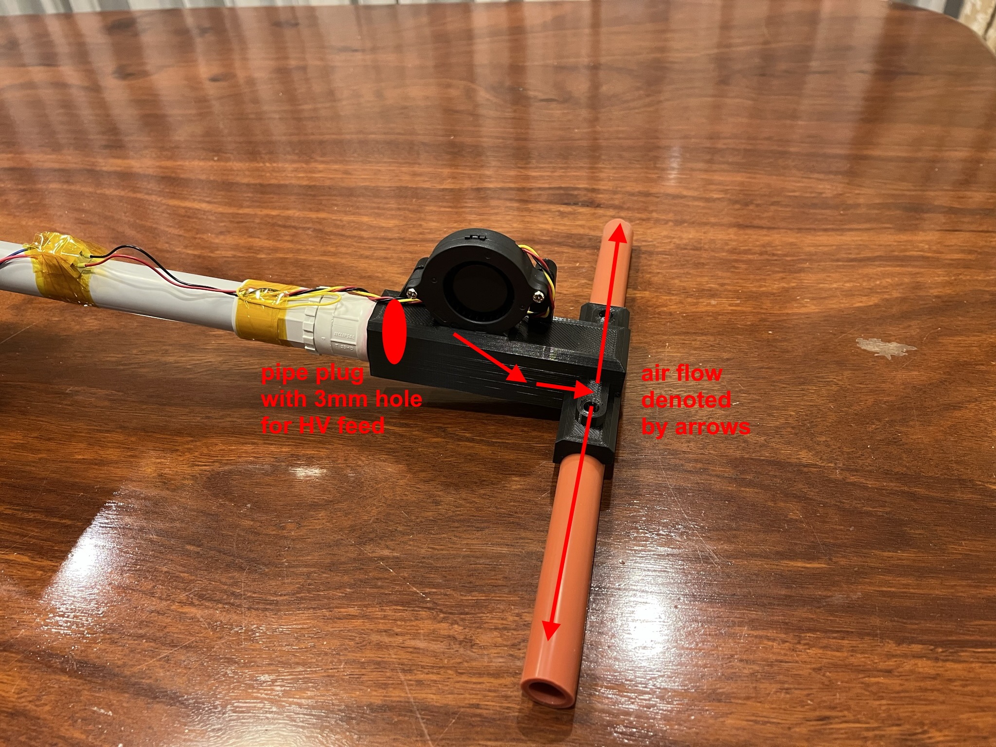

Сongrats. Not sure if you need to cool electrode per say. It probably helps electronics rather than piece of copper. Nice solution though.In my final prototype the "hot wiring" is fully enclosed, and cannot be touched, however, bear in mind that this is a dangerous high-voltage device that can easily push more than 15mA @ 7.8 kV RMS and this is lethal ☠️ ⚰️💀
Hi Alex, thanks for the nice words.
The pipe has a plug inside with a 3mm hole for the HV cable and all fan airflow is directed through the copper pipe.
The copper electrode and silicone sleeve have an elliptic hole in the middle intersection to accommodate the airflow.
The copper electrode is fixed to 3D printed head by 2 x M4 machine bolts that are recessed into the print head.
I have 3mm thick press-fit hole plugs to seal the holes and bolt heads that are @ HV.
