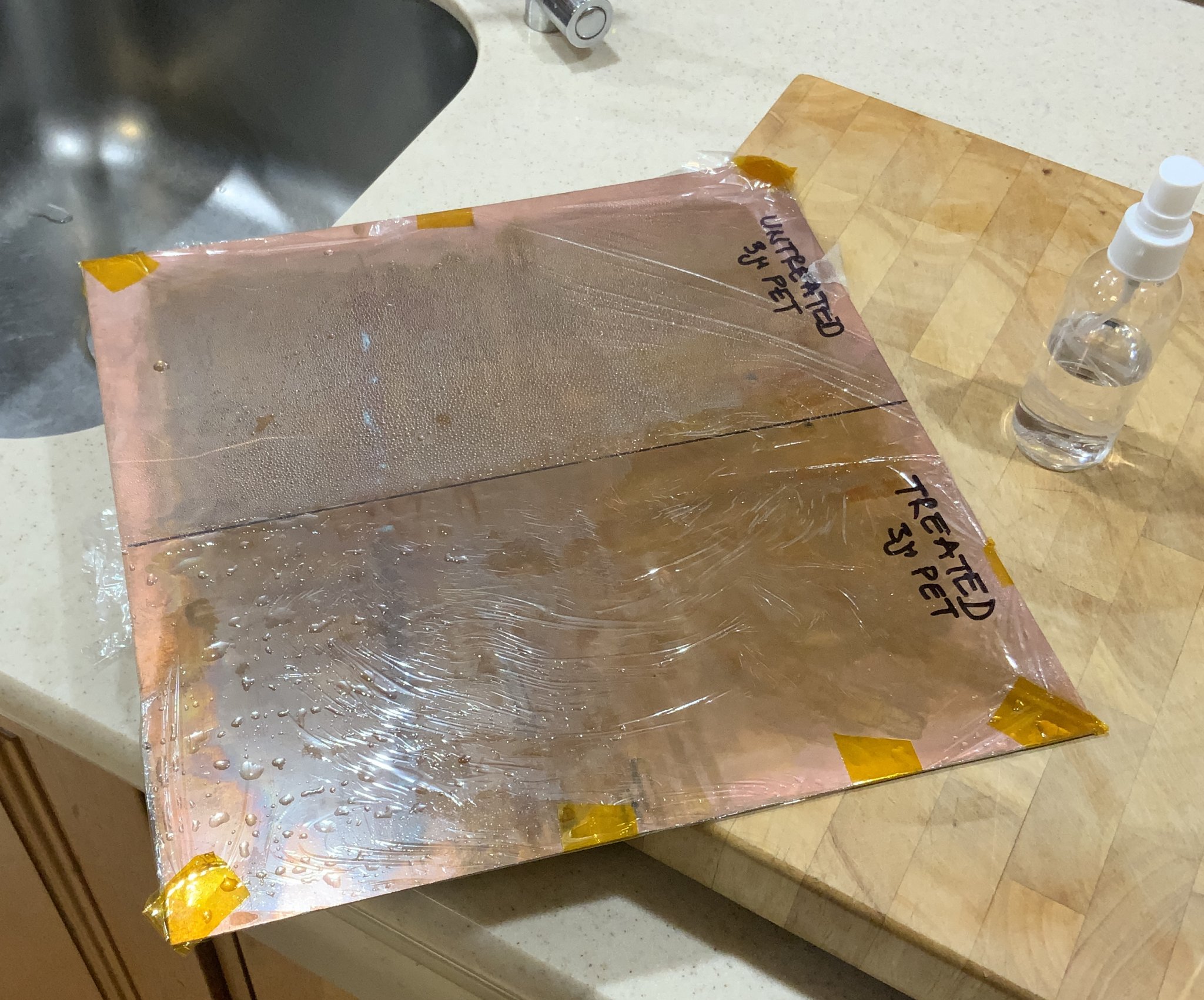

Treating the surface a cable duct prooved that the thing worked. Plain water spread evenly over the surface.
Tested with kind of green Edding pen also. After drying I tried to wipe it off of the cable duct using a cloth and solder resist cleaner.
While it came off completely from the untreated area with some scrubbing it stuck like mud to the proverbial boot on the treated area.
That may answer Daihedz´s Q: "What is it good for?" ;)

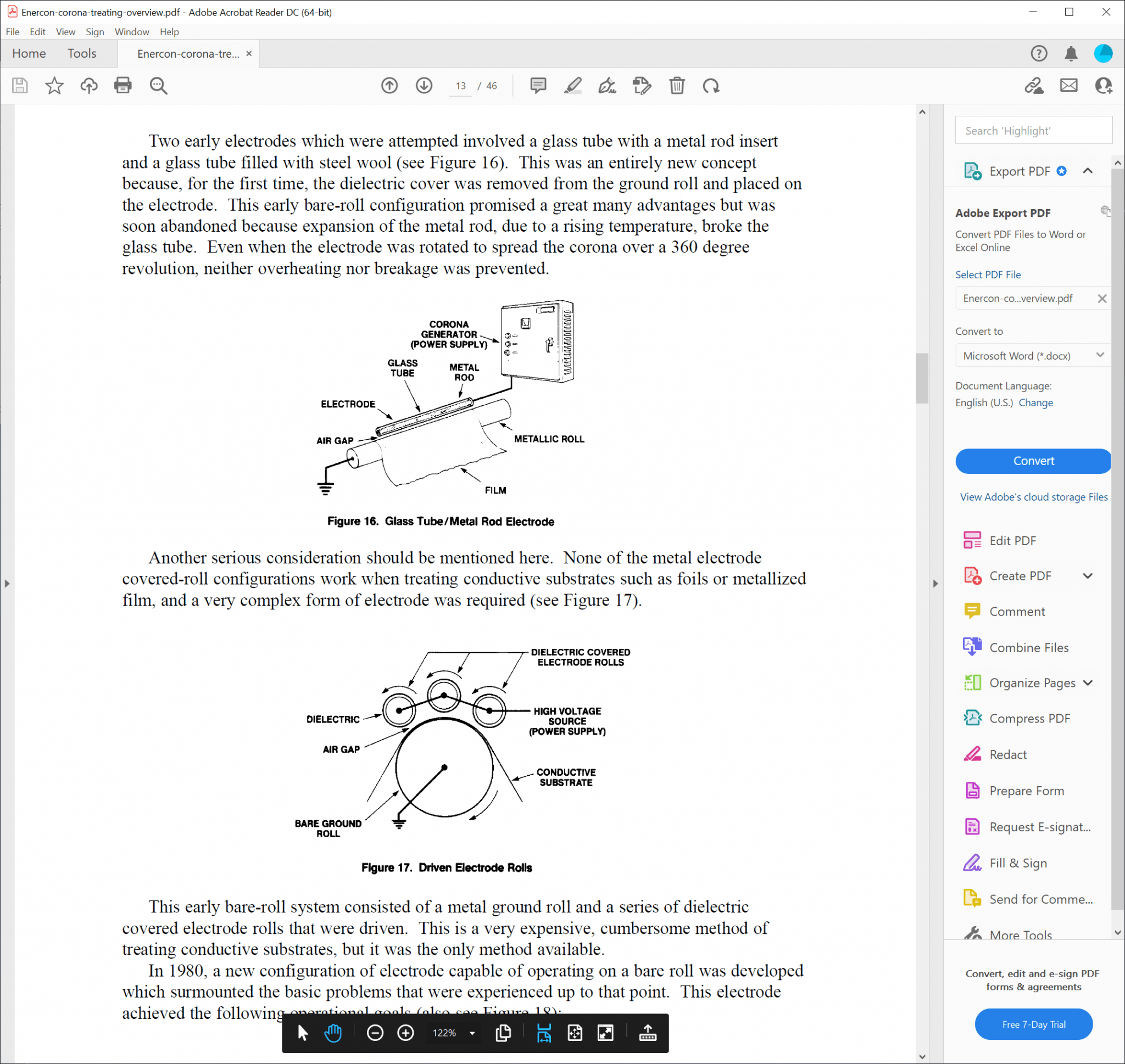

This webinar by ellsworth/enercon gives some insights to what the treatment achieves and what is basically going on.

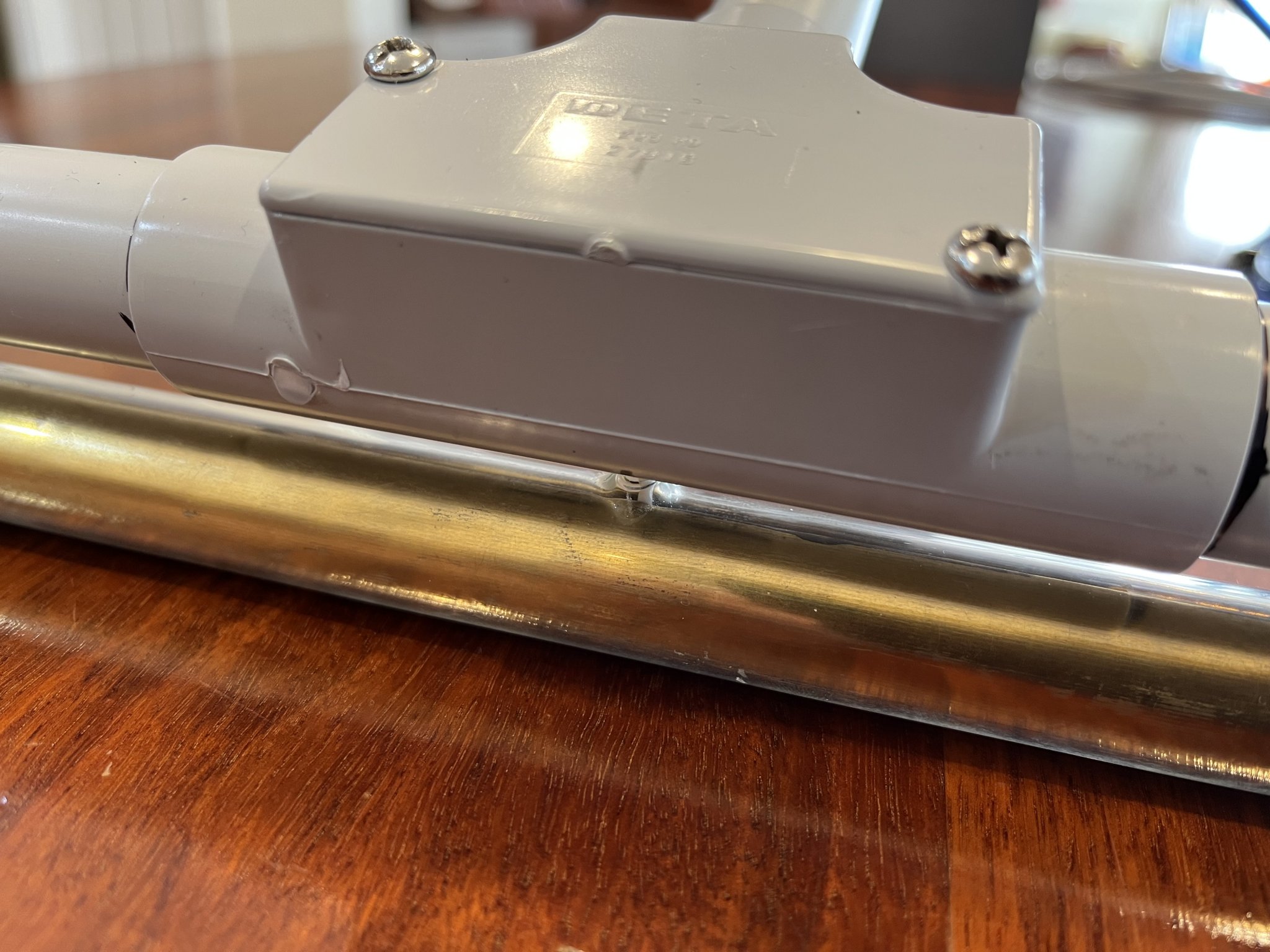

Here's one of the protos. Even and odd electrode terminations as well as air path. 3 gaps 1.2 mm total and 4 insulators 3.2 mm total. In order to increase working surface one may do just like that. No picture when operated though.
tried today with a aluminum pipe electrode, but w.o much success.
Just a bit of discharge noise and every now and then some serious flashovers.
The BSC25-T1010A CRT Flyback transformer I have contains a couple of Diodes and in #4. no3 Zvon also mentioned to have had bad luck with such transformers.
So I think I need to get me a real ac-transformer.

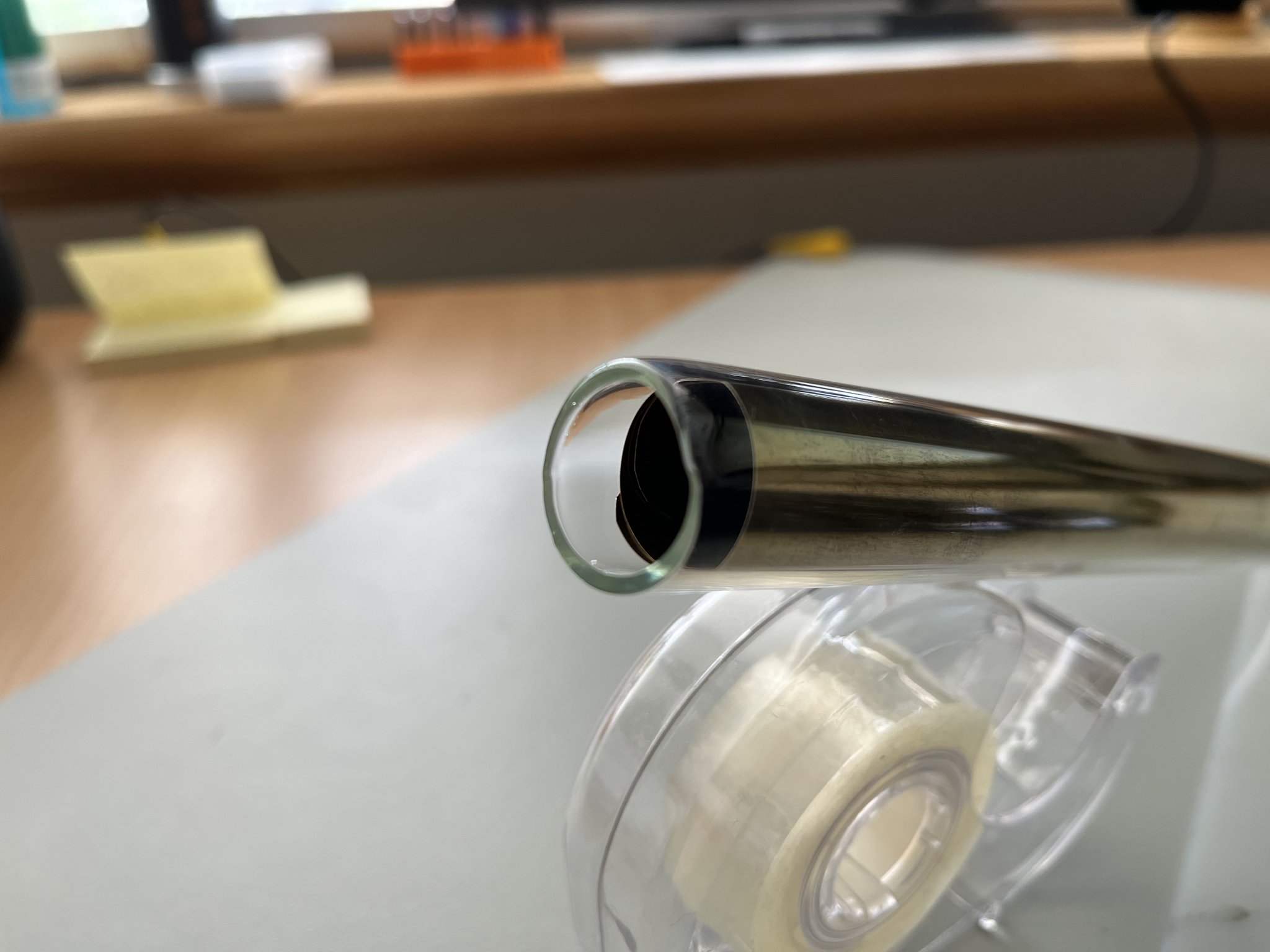

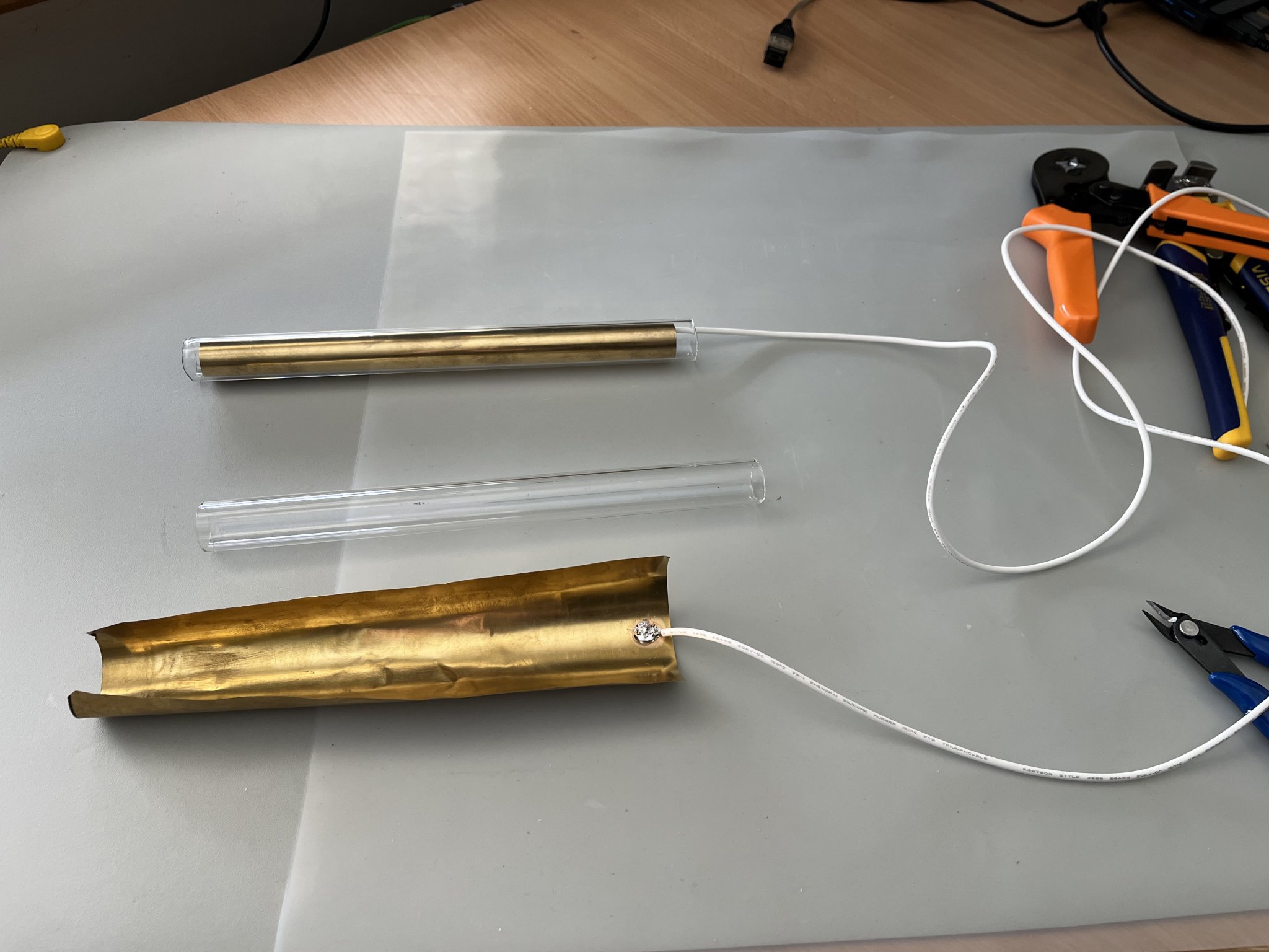

New Pyrex Electrodes Update,
I have made some progress on the latest version of the Purex electrodes (as discussed with Alex).
Pyrex tubing OD 22mm with a wall thickness of 1.8mm has been cut to size.
My glass tube cutting skills left a lot to be desired, so I had to melt the tubing ends to eliminate (very) sharp edges.
To my surprise, I managed to melt the ends with MAPP torch.

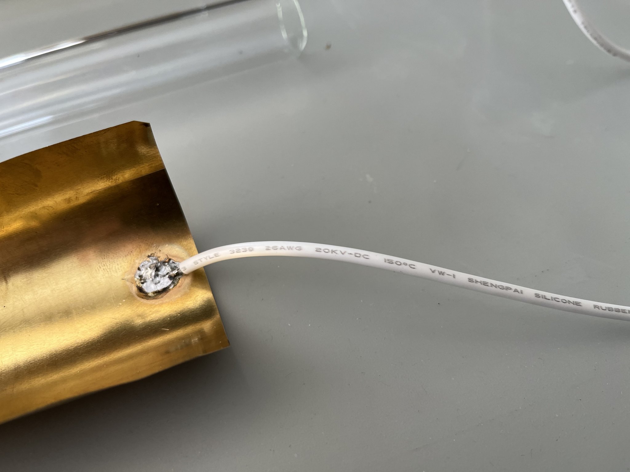

Brass foil 0.1mm thick cut to size and HV (20kV DC) cable soldered to the foil.
Done two electrodes (just in case :))

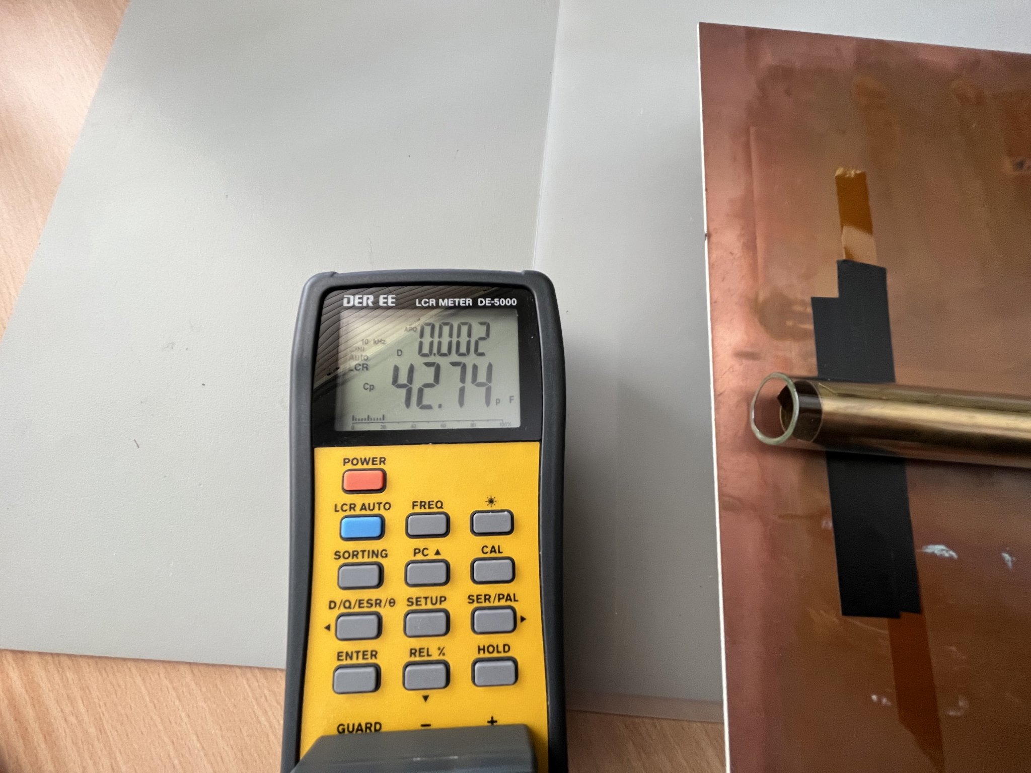

Check the capacitances of the electrodes
1.8mm thick pyrex wall + 0.4mm air gap
1 layer of Kapton tape (0.05mm) + 2 layers of electrical tape (0.35mm)
The first electrode 43pF
The second electrode 44pF
So far so good - happy chappy at the moment!
Regards
Hi Calvin,
Just confirming the corona treatment works on thin PET (Mylar) film.
The used power was 17V @ 5A (85W) - if I conservatively deduct 50% on switching, transformer losses and heat, it is still 42.5W.
The recommended PET corona dosage is 10-13 W min/m2.
My setup is 42.5W/ (0.24m*4.5m/min* 1 side * 1 electrode) = 39W min/m2 - should be enough.
The result is presented below
Fixing 3 micron Mylar to PCB is :mad::mad::mad:
The PCB was inclined when I sprayed water, and water on the treated side started to flow down immediately.
Water on the untreated side beaded and did not flow.

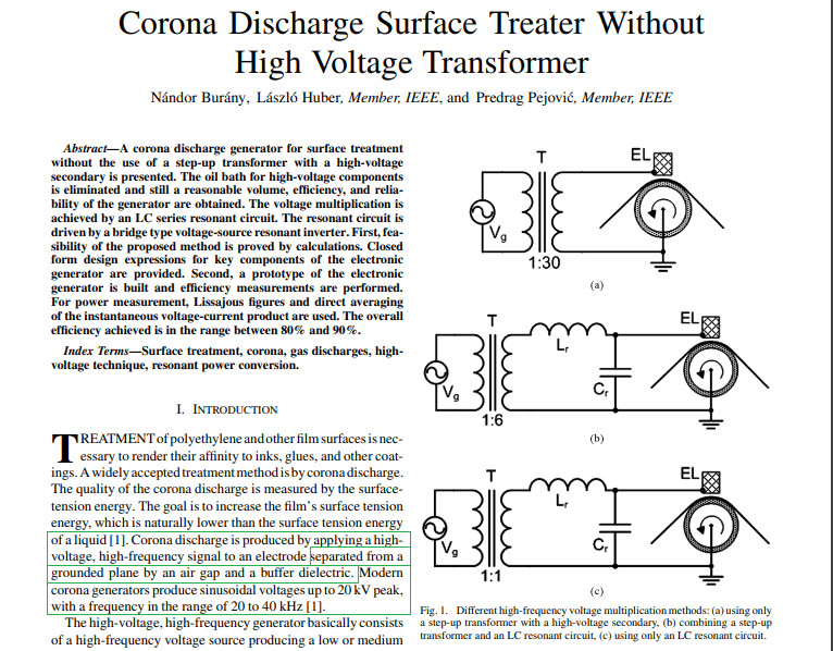

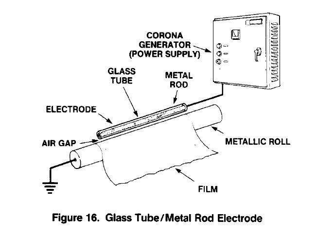

It looks though you have not check the article I've cited, it's free from research gate. It has basic idea how the film is treated without huge ground plane using simple roller. View attachment 1078303
https://www.researchgate.net/profil...-Treater-Without-High-Voltage-Transformer.pdf
Hi Alex,
Yes, I have read the full article (funny, one of the authors is a friend of my university colleague).
My mini treater is in the typical frequency range and hopefully with a much lower peak voltage (to be confirmed soon with an HV Scope probe).
The commercial corona treater rolls (and film) move at very high speeds (for cost/commercial reasons).
The rollers are massive and require (sometimes) liquid cooling due to the very powerful treater supplies (kW's in single and double digits).
The initial "hot" electrode concept came from:

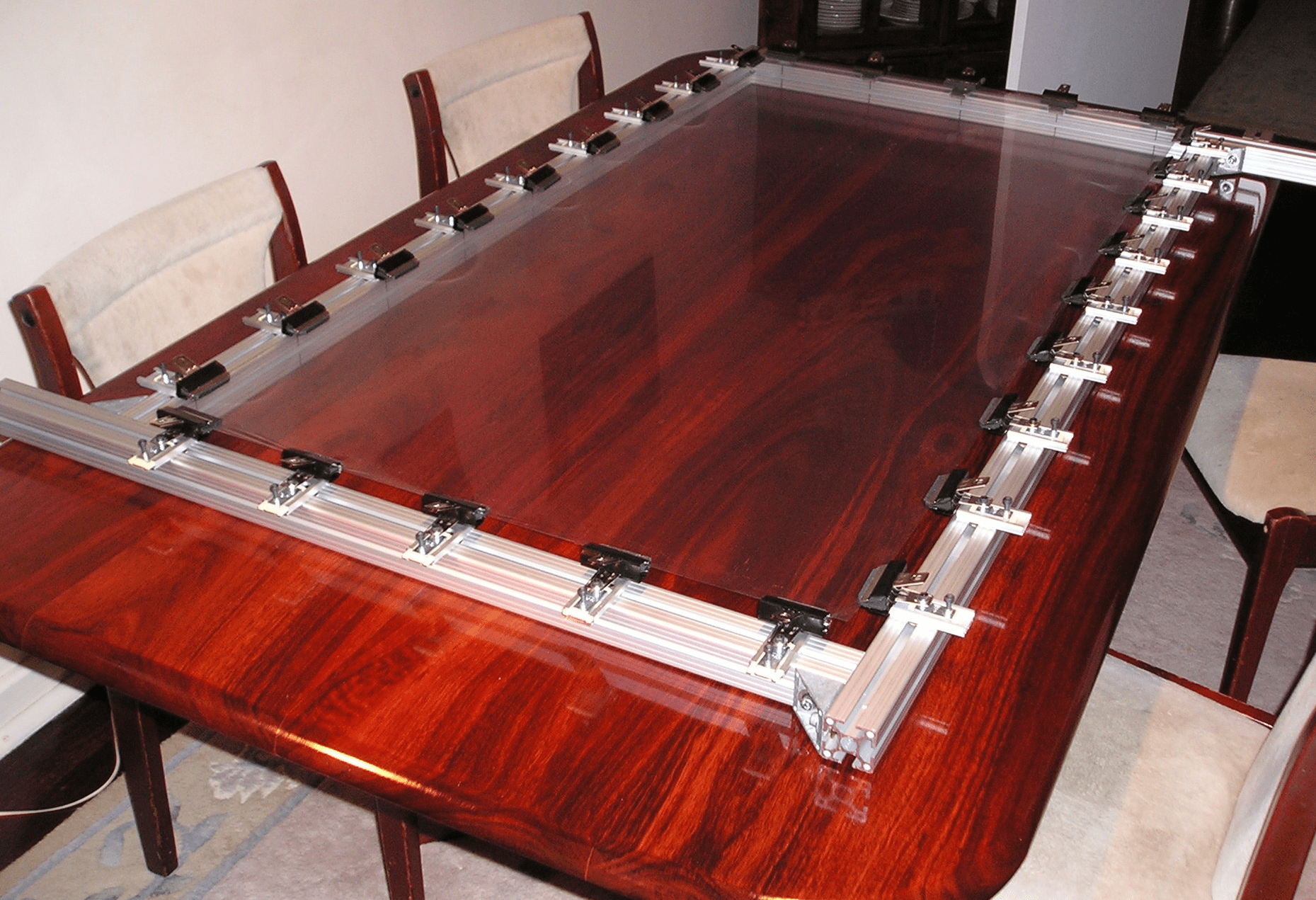

I prefer to replace the grounded roller with a cheap 0.5mm aluminium sheet sourced from a local hardware shop.
This flat sheet ground electrode would suit my Mylar stretching jig better (refer to the image below).
The Alu-sheet will be glued to an MDF sheet (to ensure flatness) of suitable thickness that can be easily placed below Mylar.
The sheet will be covered with a 0.1mm thick acetate sheet to prevent any Alu-sheet burrs tearing Mylar
After the treatment, I will remove the Alu-sheet and slide the ESL frame/stators with D/S tape facing up to fix Mylar.
Then, the film tension will be released, Mylar cut with a hot knife and the membrane will be coated within hours.
If you see any hurdles in the above process I would appreciate your comments.

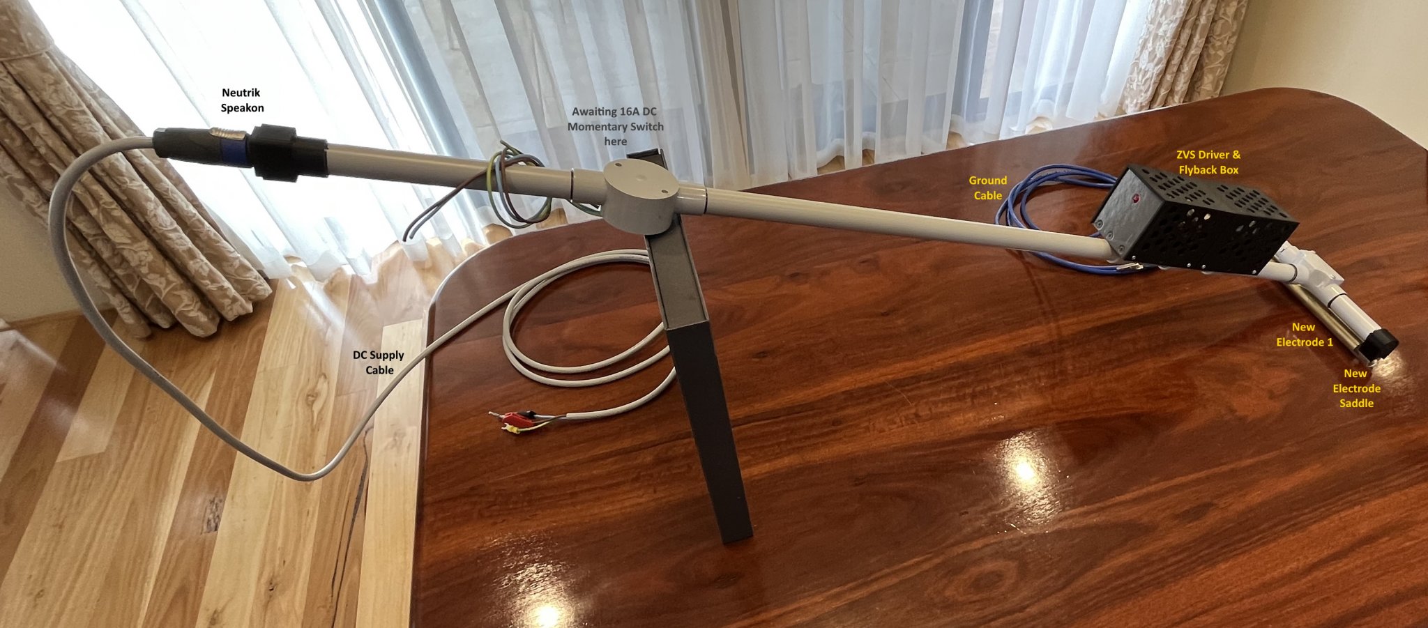

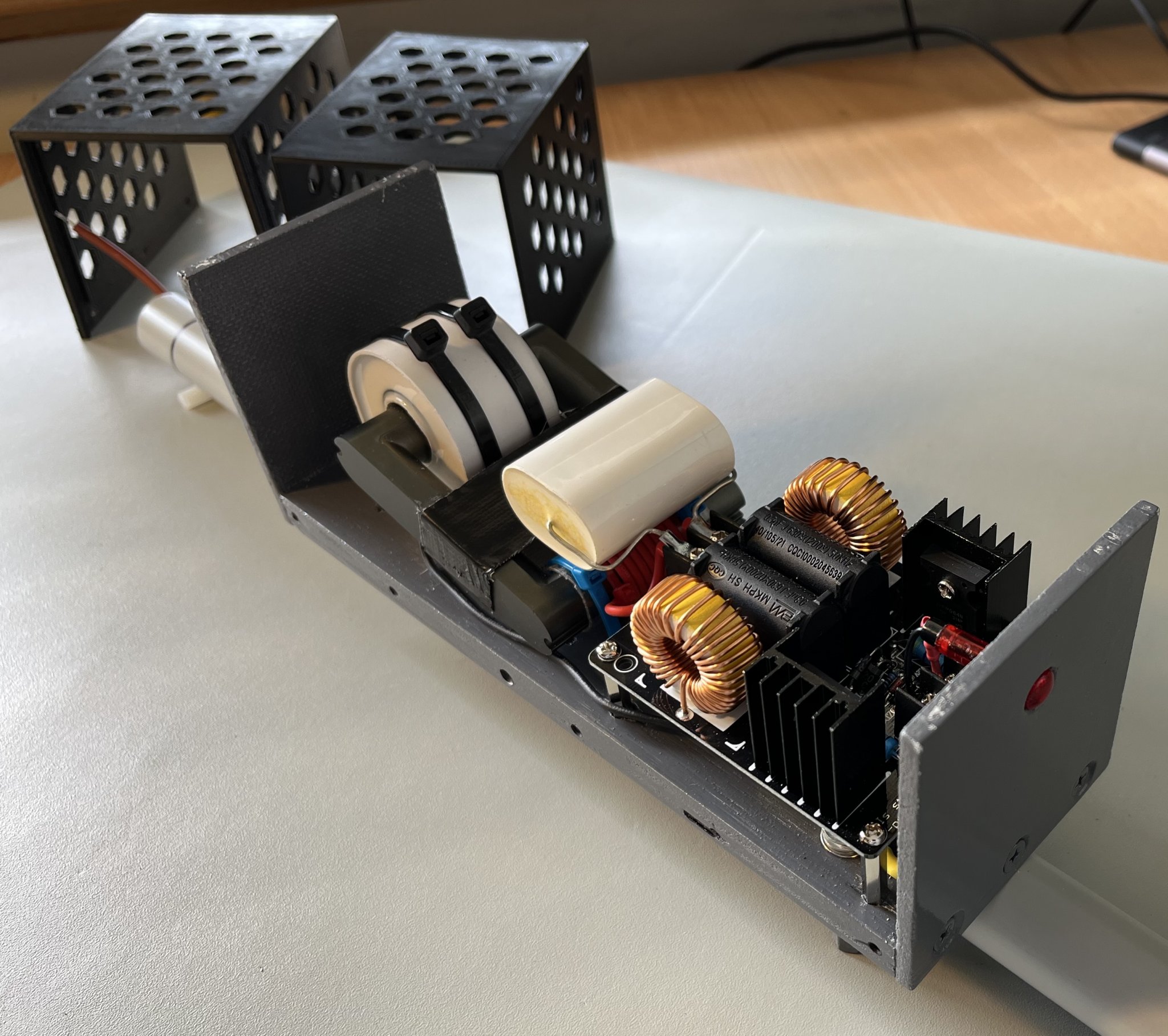

Hi All,
This tread is getting old and should be closed with some helpful photos and suggestions.
Down below you will find my last (hopefully the final) prototype.
I have made a number of changes, photos are provided for (in my opinion) important ones.

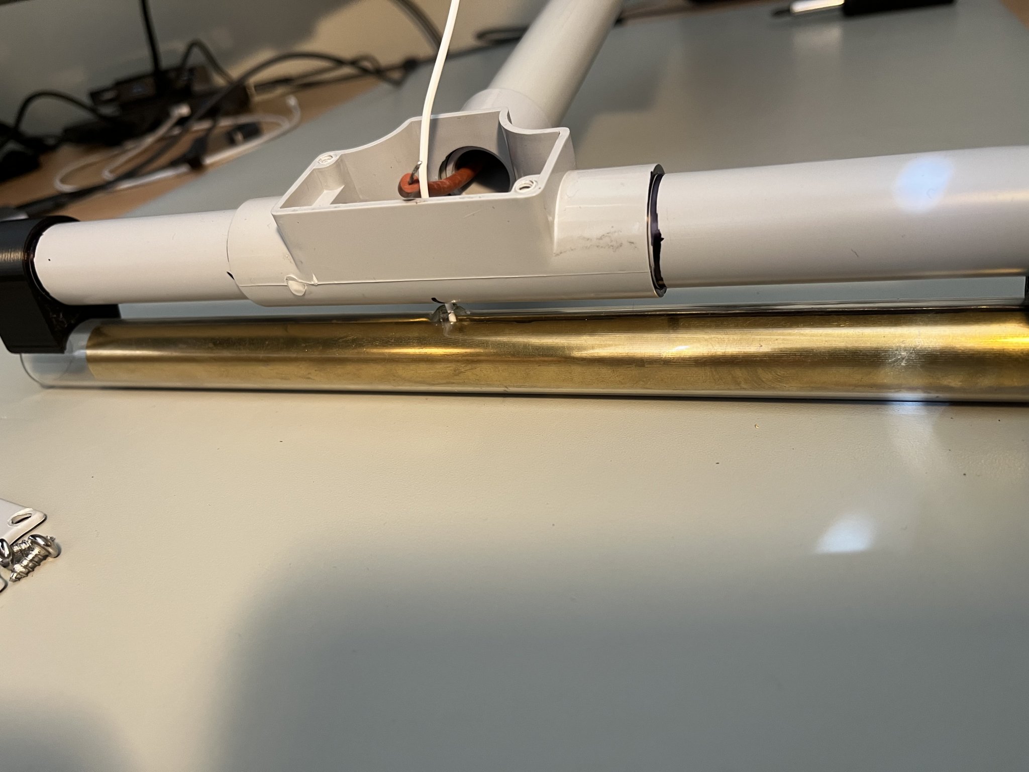

This is my final Mini Corona Stick

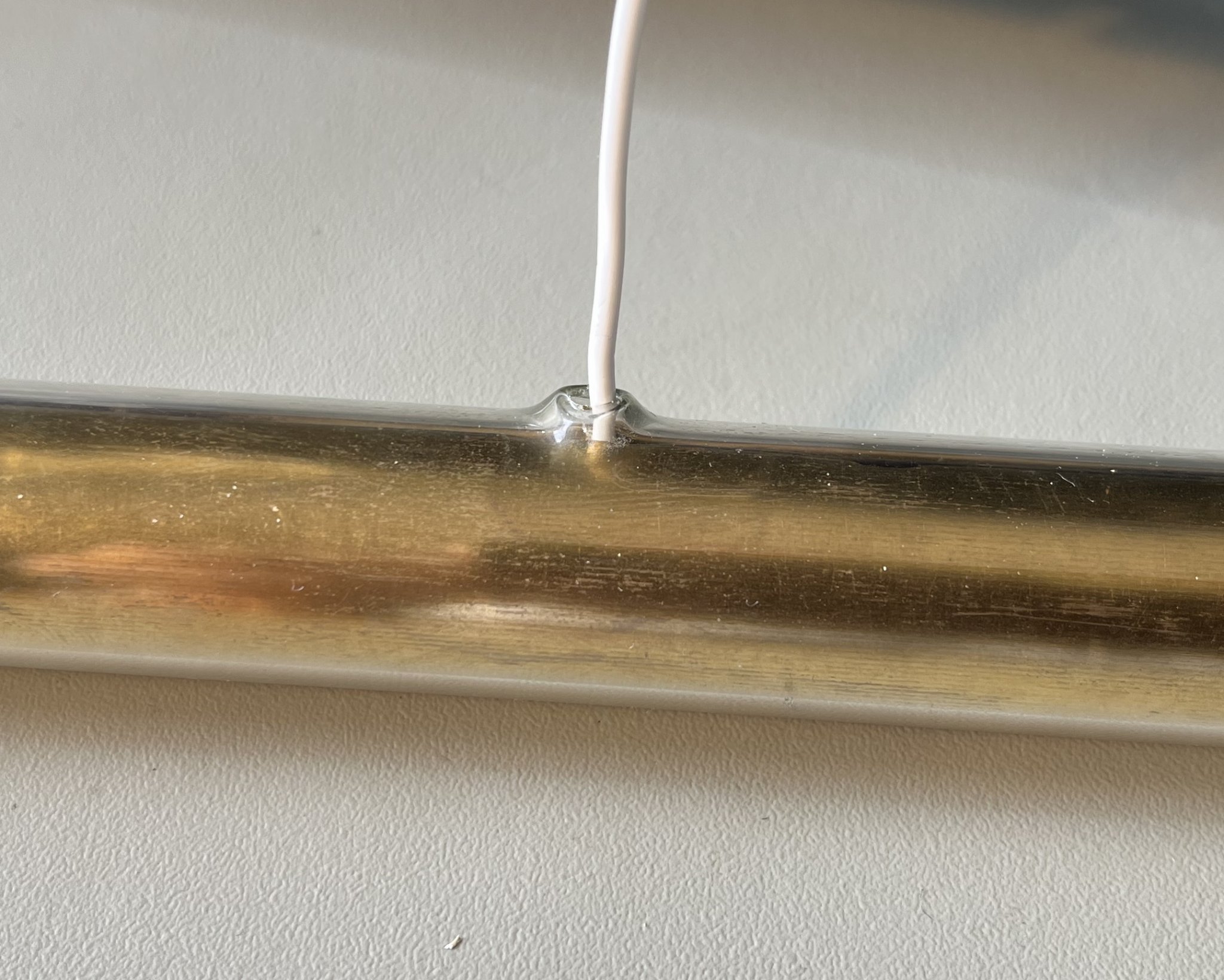

The most important upgrade (the difficult one) is my new electrode.
I have managed to blow a hole in the Pyrex tube, centrally located, and the HV cable goes straight into the PCV conduit
This is the shortest path of HV cable (and the safest that I could come up with).

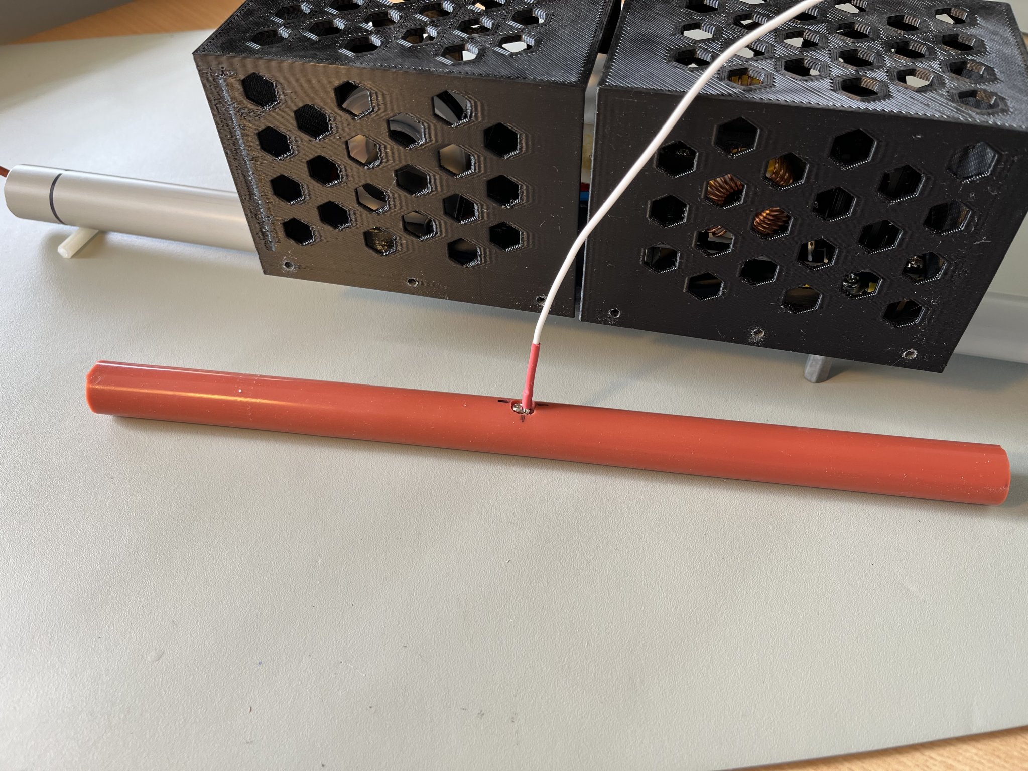

I have another electrode to try - a copper pipe inside a silicon rubber tube with 3mm thick walls.
This was a really tight fit. The cable spade was bolted to a tapped hole in the copper pipe.
This electrode is much cheaper and not as fragile as Pyrex, but needs to be tested.
The rubber tube is about 30mm longer than copper pipe on each side.
The ZVS driver and Flyback housing has been cleaned up.
The ventilated cover is 3D printed in two pieces.
The large white capacitor (Cornell Dublier 2000V DC from my Tesla Coil :) ) was used for tuning.
Once the DC switch and potting compound for the scope HV probe are received, I will send the final post with the stick in operation and general building notes & suggestions that should be sufficient for a knowledgeable person to replicate this gadget.

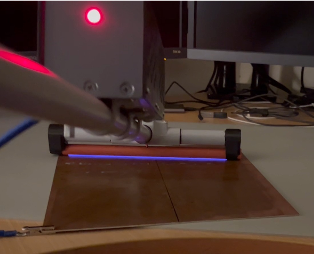

Just a quick update,
The silicon rubber insulated electrode works beautifully.
I had to increase the input DC feed to 24V (as expected because of the thicker insulation).
At 24V DC the current draw was about 4A (96W).
This setting produced a nice and uniform corona - an image and a very short clip are below.
