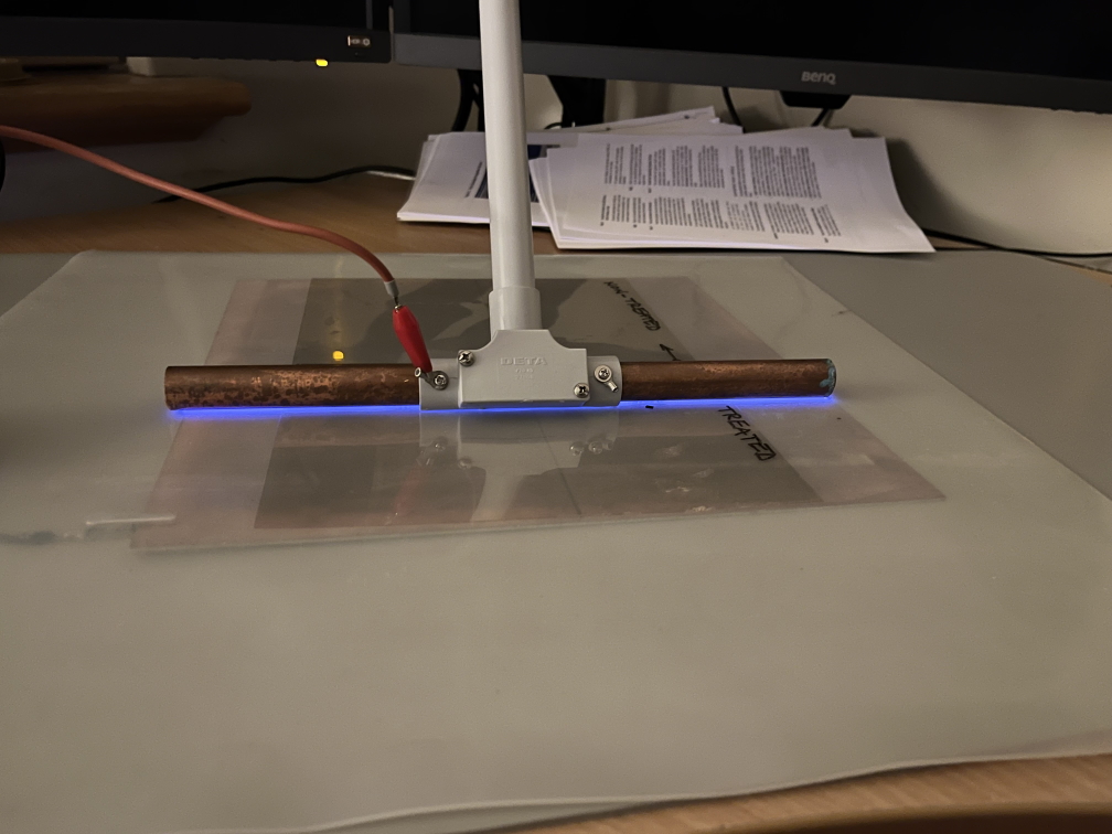

TAKE 2 - Use AC flyback to make a treater - SUCCESS
Build a driver for AC flyback and use a 300mm long 19mm Dia (3/4in) copper pipe as an electrode.
This is a small treater that does 100W at approximately 30kHz and the photos of the unit in action are below.
To my surprise, this treatment's effectiveness exceeded my expectation by a country mile - and I am serious.
I treated an A4 sheet of acetate (from my local craft store) and the difference between the treated and non-treated areas is amazing - refer to the images below.
I used plain filtered water to check and compare the wettability.
CONCLUSION - I will treat all membranes prior to coating for sure. - thanks for the advice SY !!!
The treated section has a uniform film of water over the whole area.
The treater in action (feediing diriver with 20V dc & 5 amps)
This is a small treater that does 100W at approximately 30kHz and the photos of the unit in action are below ...

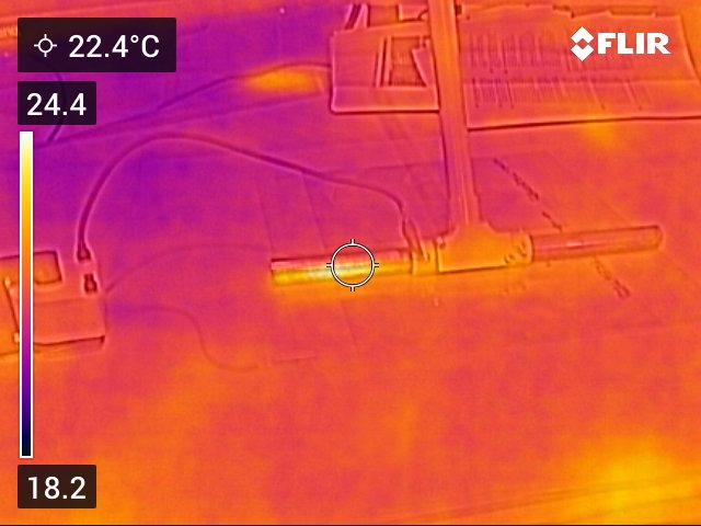

... My little treater electrode (copper pipe) becomes very hot after a couple of minutes of treatment ...

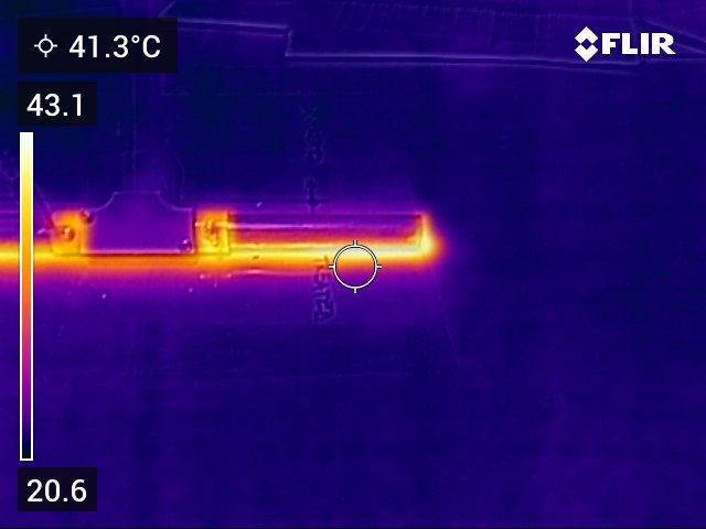

Hi Daihedz,,
My posts appear quite long, so I'll try to be short.
Photo of the copper electrode during the temperature test.
Thermal image before the test (electrode is at 22.4 degC) so lets say aboyt 20 debC
Thermal image after 60 seconds of treatment (electrode is at 41.3 deg C) so let's say the temperature rise is 20 deg C /min
This correlates well with 60 deg C after 2 minutes (which is ok to touch but too hot to hold)
Regards

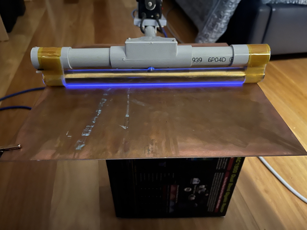

My first prototype has a brass foil electrode inside a pyrex (borosilicate) glass tube.
The glass tube is a great electrical insulator, but also a great thermal insulator.
The brass electrode would require active cooling (small blower).
Something like blowing cold air into a silicone hose connected to one side of the pyrex tube.
Prototype Photo
Prototype Working

Hi Daihedz,
The Tesla coil I built was an old fashioned type with a non-electronic neon light transformer (7.5kV) as feed and a spark gap. It was way to much to handle, big, very heavy, with huge arcs - as I said it was fun for my kids (btw my kids are 30 and 27 years old 😂 and refused to even hold a fluo tube in poroximity of the secondary coil 😁).
The current corona treater with ZVS driver being fed 20V at 5A works great when I move the electrode approximately 1m/min (approx 15mm/sec). I will revert back to a Pyrex protected “live” electrode and grounded aluminium sheet as other electrode (as sugested by Alexberg). The Pyrex tube has 1.5mm thick wall which should ensure a breakdown FOS of 5-6. This way the HV section of the circuit will be fully contained / isolated.
One minute of treatment should be good for approximately two ESL63 panels. After that, I can take a short break to cool the Pyrex electrode.
And finally, I have to concur with Alexberg - simply don’t do it if you have no experience with high voltage RF. The voltages AND currents produced by the AC Flyback are lethal !!!
Regards
Regards

Your Flir pics seem to indicate though that the corona is not burning so hot to fry the plastic.

Calvin, corona is not that hot, but the single discharge may be, otherwise what is glowing all about. It all depend on power density. In ozone production you need to have cooled electrodes and rather high flow rate. I've stumbled on articles here and there - basically you need a smooth cylinder over which film is moved under some tension. This way film is basically pressed to massive cold metal piece thus the former will not burn. I suspect something similar is done during metallization of film for capacitors even polypropylene by sputtering of aluminum in vacuum. Anyhow I do know few people who used D'Arsonval with good results being not that proficient in the art and perhaps having more patience or persistence.

In regard to the Calvin’s question, I have tried corona tratment of PET film with my first prototype (Pyrex enclosed electrode) - it works great. No problims with heat at all - this type of corona is treated as “cold flame”. I haven’t tried the exposed copper pipe because PET is very prone to tears and I have not polished the copper pipe to remove the ends cut burr’s.
Alexberg
Thanks for your explanation, now I understand your concerns. A single spark would certainly burn a hole (or multiple holes) in the film and make the use of corona treatment counter productive. I would never consider using my treater wih a membrane film only between bare electrodes. With the exposed copper pipe electrode there is a sheet of 1.5mm thick silicone rubber on the top of grounded PCB sheet electrode.
The electric breakdown of either Pyrex or silicone rubber (1.5mm thick both) are multiple times higher than my (estimated) flyback secondary output. I will measure the actual output as soon as I build a HV scope probe - again I can’t afford a Tectronix HV scope probe. HP 34111A 40kV probe that I have is good only between DC and up to 200-300Hz max.
