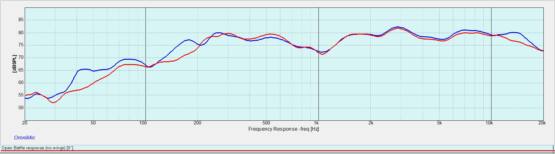

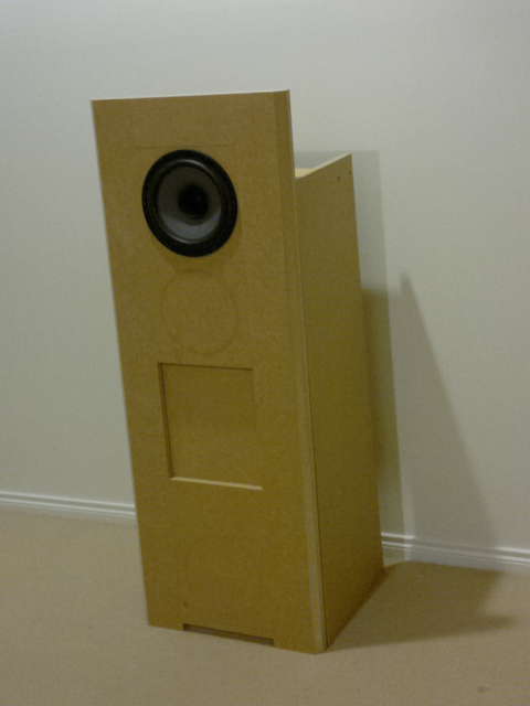

Seas FA22
Frequency Response of Seas on OB with and without wings
Red trace is without wings
Blue trace is with wings
