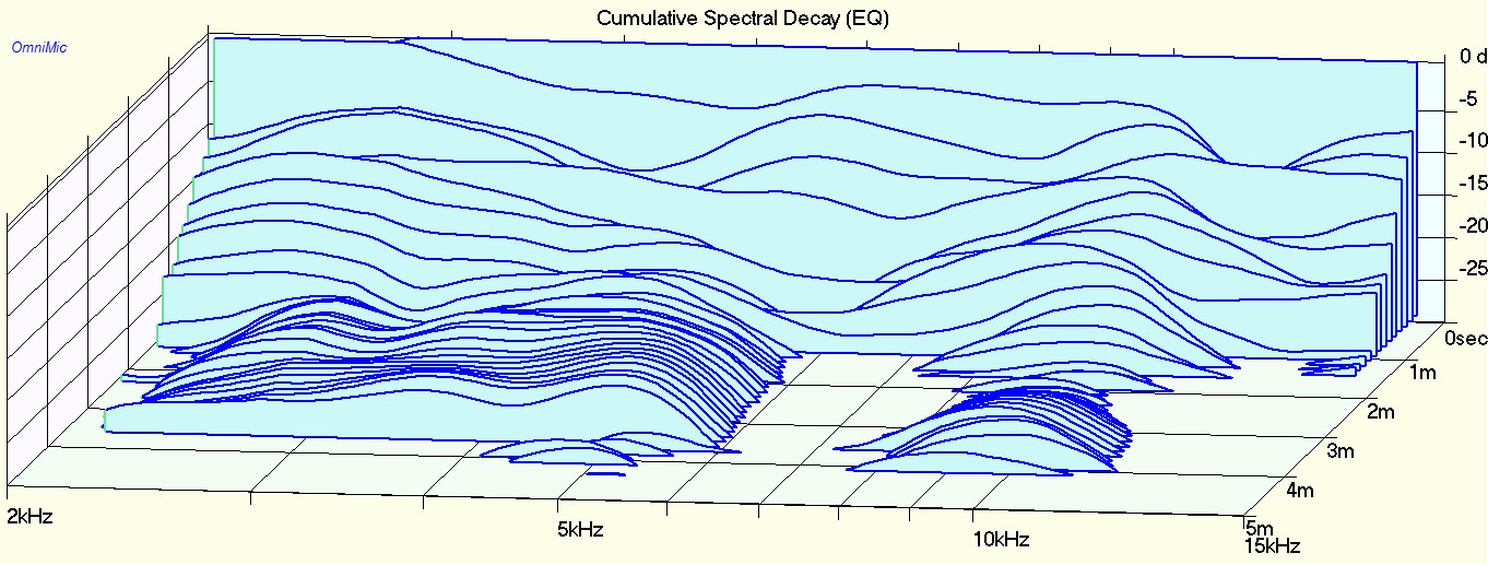

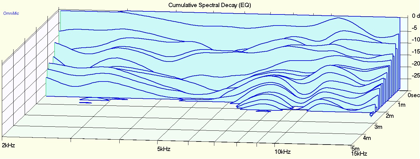

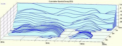

CSD PLOTS Seas FA22 vs Radian 475pb
Radian clearly superior to Seas FR
Probably unfair test, but interested to know how it compares
I am now keen to try ENabl on the Seas and see how it may improve things
The first plot is Seas FA22 and the second is Radian475pb
