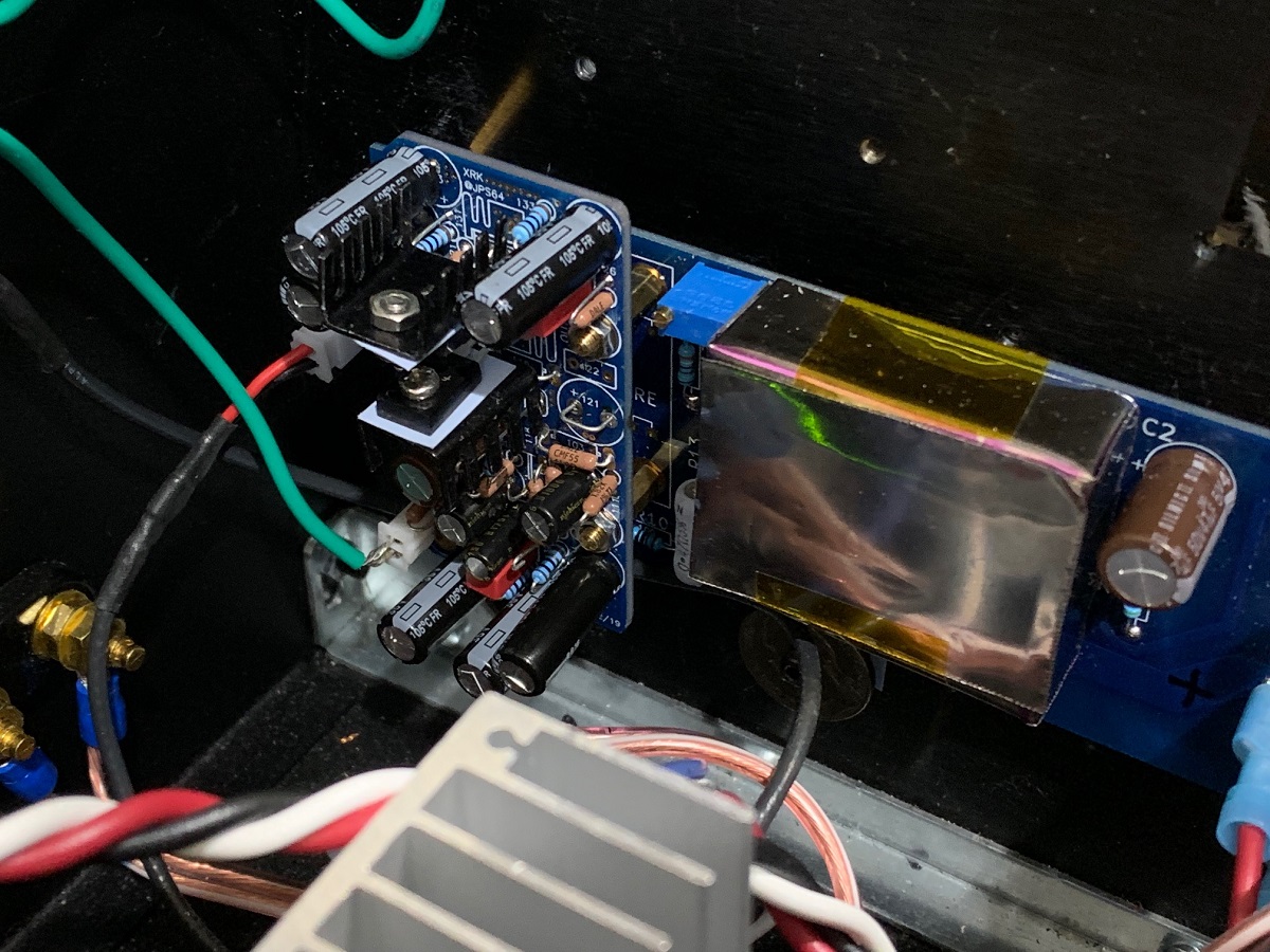

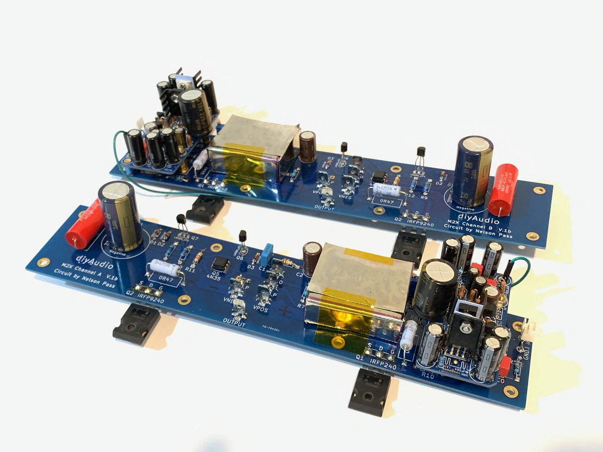

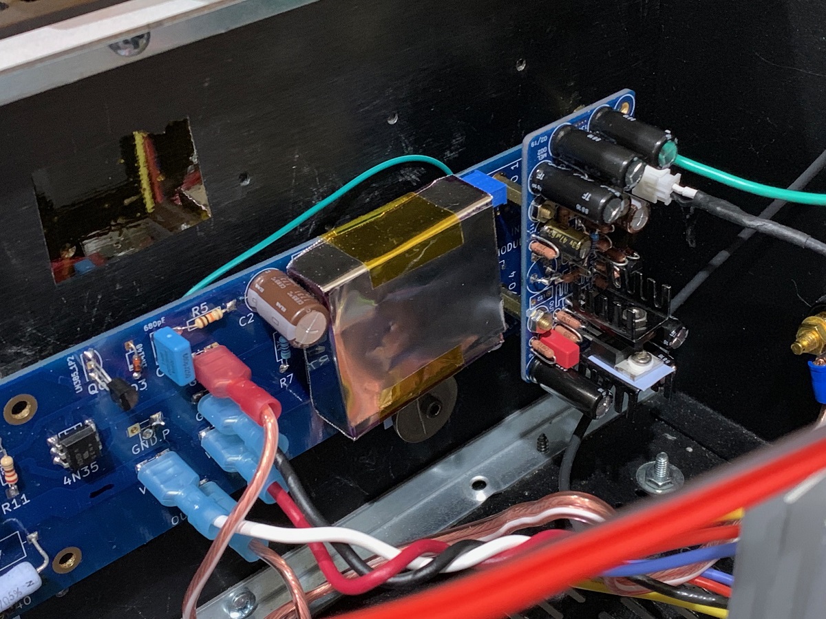

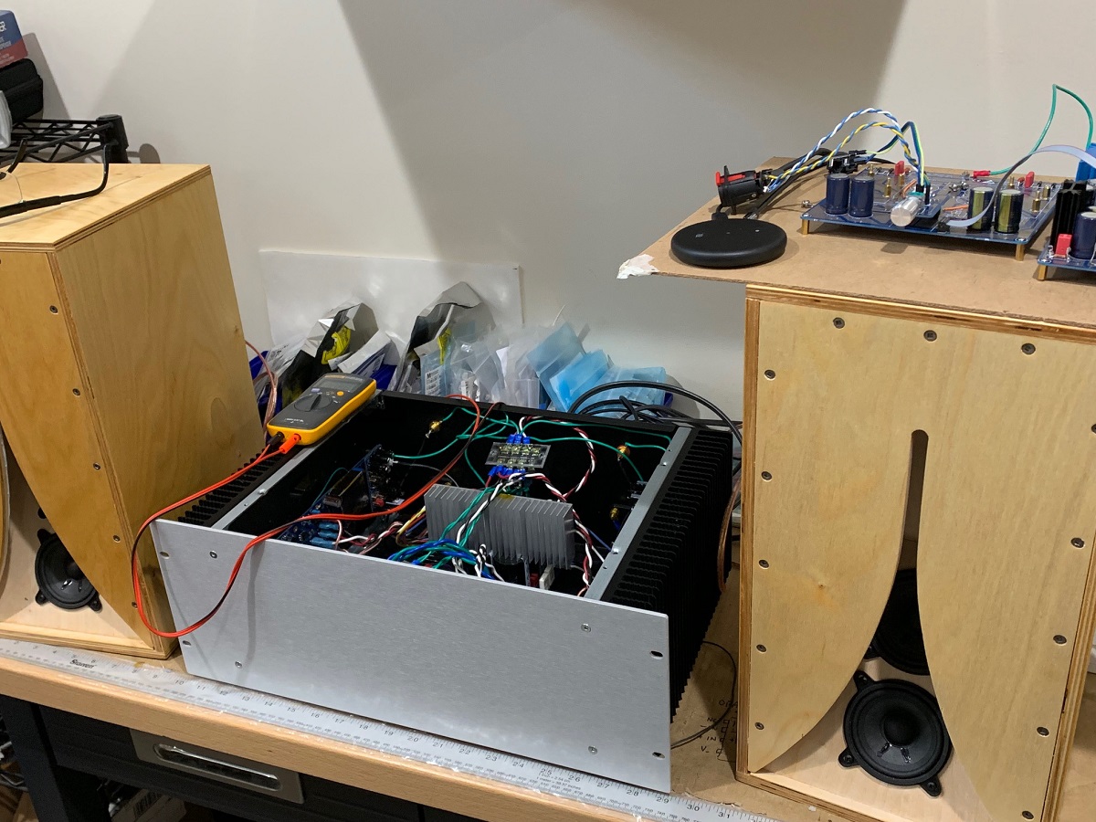

Melbourne in M2X Test
The Melbourne works very well inside the M2X as an input stage daughter board. It took me quite sometime to debug a shrieking oscillation that would result whenever I connected a source to the RCA input. Finally figured it out - it requires that the ground on the Melbourne be connected to the PSU star hub GND, and not the local GND on the M2X board. Also, the Melbourne needs to be DC-coupled to the Edcor (use of a 220uF cap seems to induce some sort of LC circuit that shrieks at circa 2khz to 5kHz). Once this was resolved, I was treated to a very quiet amp - now measuring 100uV rms at the speaker output with input turned off. The gain on the Melbourne using 33k and 5k6 pair gives 15.6dB, which is a good match for sources like a phone, mp3 player, or Bluetooth source. I have been testing with an Amazon Echo Dot or Echo Input. The sound is very nice - great bass, wide soundstage, clear imaging, and a pleasant articulate, and natural sound.
This M2X is using the SLB PSU, more details on that here.
Melbourne's mounted on M2X (note that output coupling cap is shown here, but had to be removed):
Detail of left channel:
Detail of Right channel (note green wire from Melbourne GND to SLB PSU star hub Gnd point):

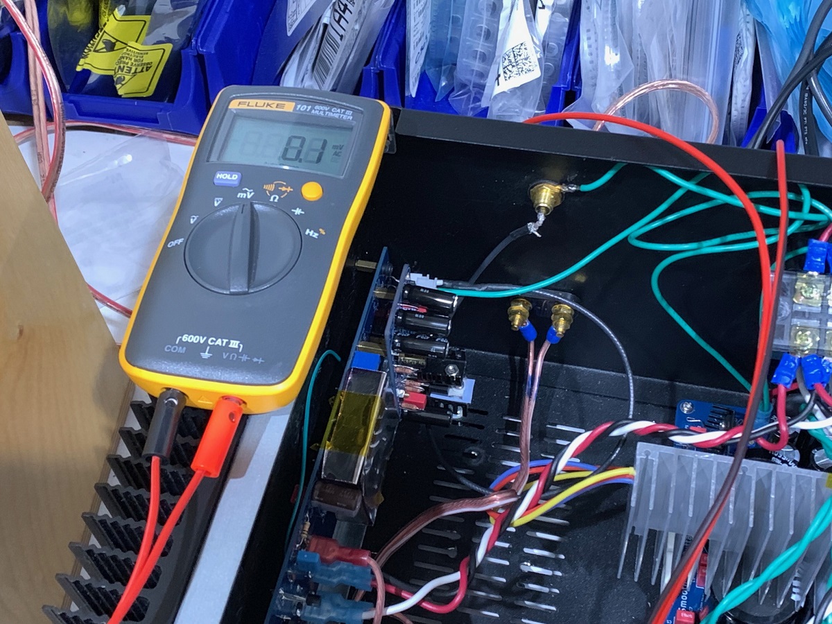

Fluke 101 noise measurement at amp output with source off:

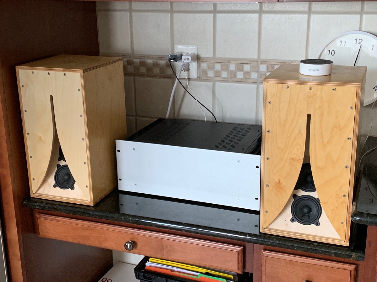

Initial listening on the bench:
Longer term listening upstairs:

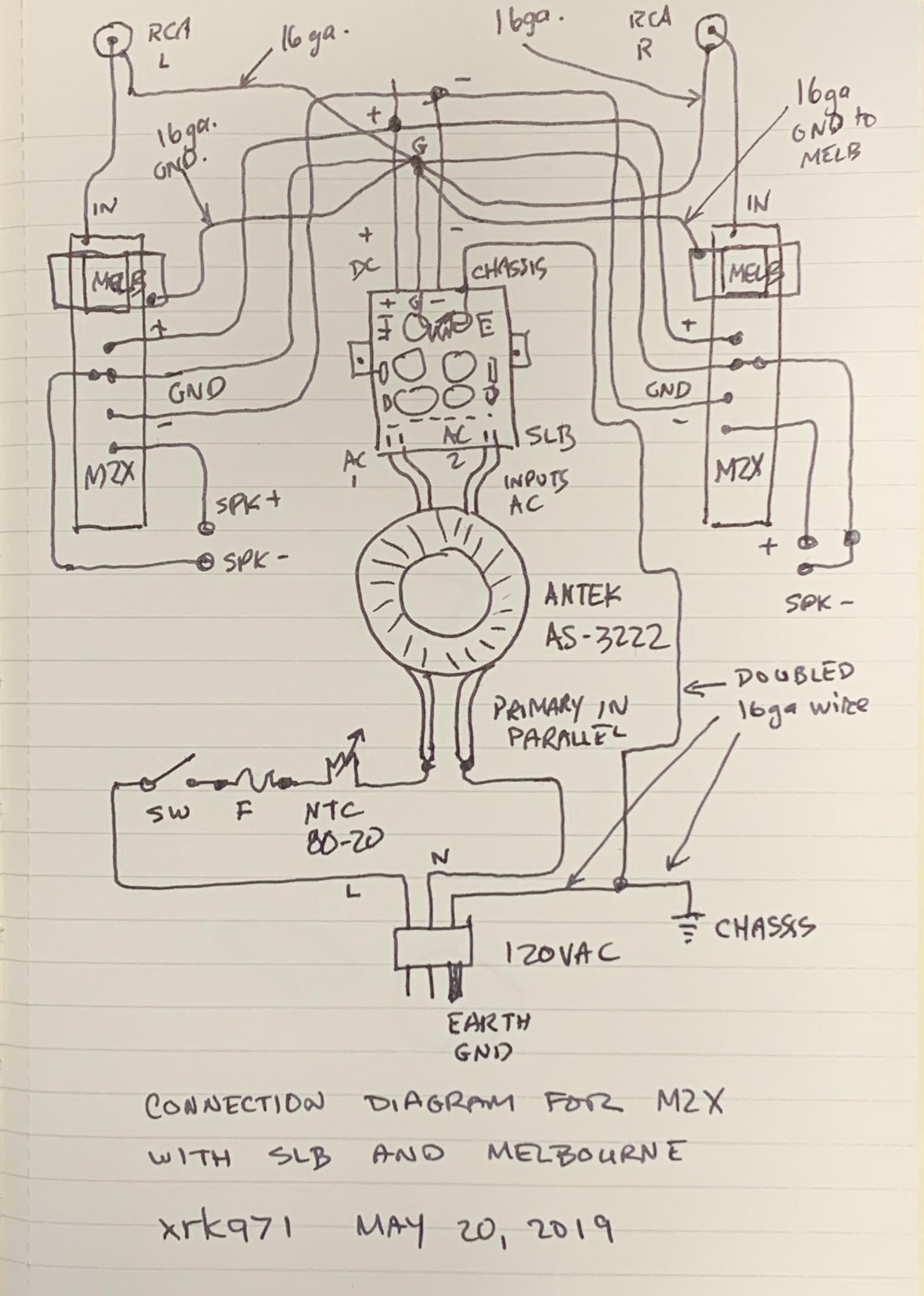

Here is a grounding connection diagram for the Melbourne on M2X and SLB PSU. Note that on the new SLB due to arrive any day now, plenty of ground Faston spades are available directly on the board to serve as the star hub. I had to use a terminal block which is not as good. It may be overkill but I used quality stranded copper 16 gauge wire for all the grounding lines to the star hub. I doubled up the 16 gauge wires between the PSU to chassis and to earth mains ground.
If you are using a dual SLB and dual trafos, this doesn’t t apply and ground loop hum is much less of an issue.
