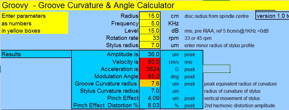

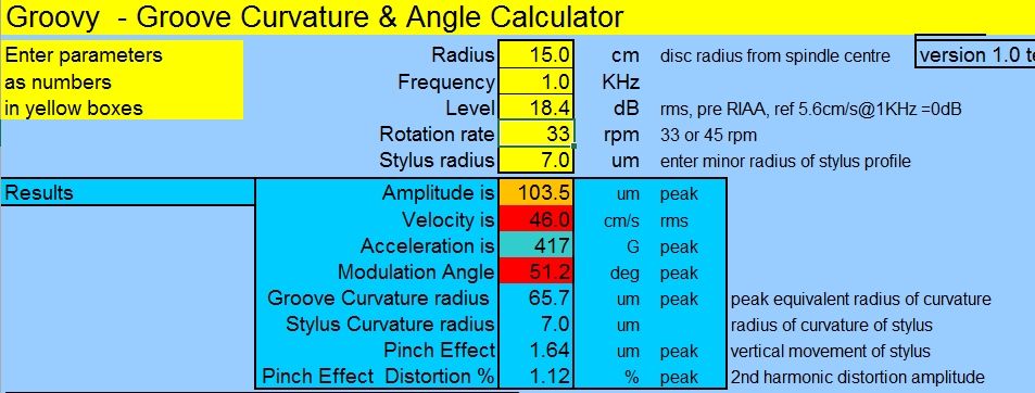

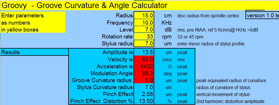

Hard to know whether to laugh or cry....... 😉Trackability at 1 gram (10 mN ) Tracking Force (typical values shown in cm/sec peak velocity):
400 Hz: 30 cm/sec
1 kHz: 46 cm/sec
5 kHz: 80 cm/sec
10 kHz: 60 cm/sec

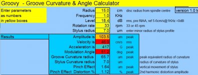

A few years back I wrote a calculator that allowed me to explore physical trackability limits in terms of programme levels and physical grove parameters. All trace gone in the great purge, presumably.
Attached below are 4 charts from that calculator 'groovy' that show 'what if' for those conditions from the Shure literature.
Parameters in red are, IMO, untrackable at any VTF by any cartridge. Amber is possible but difficult.
Absolute physical trackability limits are about +/- 120um groove amplitude, 40 degree groove angle, and 1200G curvature/acceleration IME, for good theoretical reasons. At different frequencies, cartridge spring, cartridge damping, and cartridge inertia dominate.

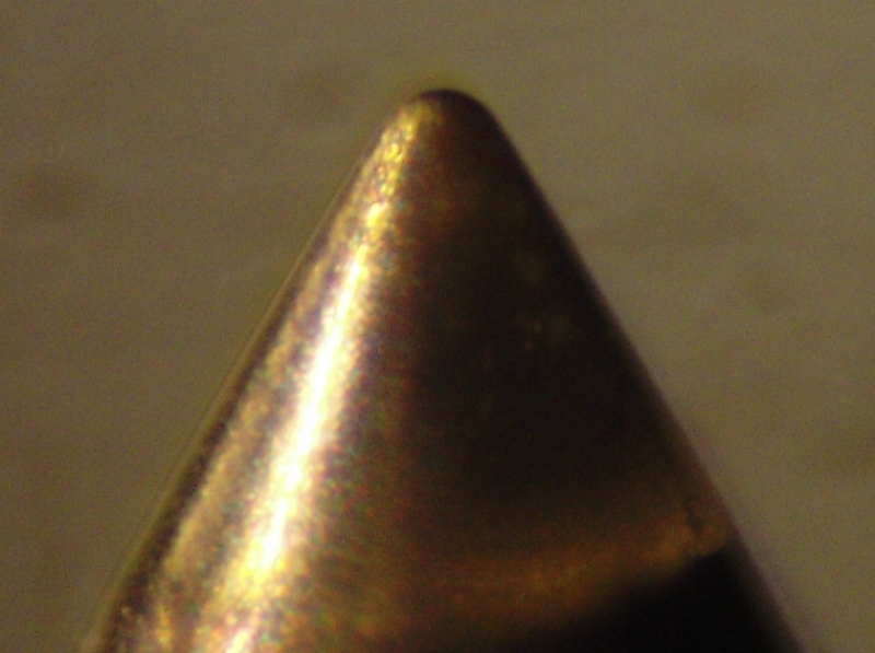

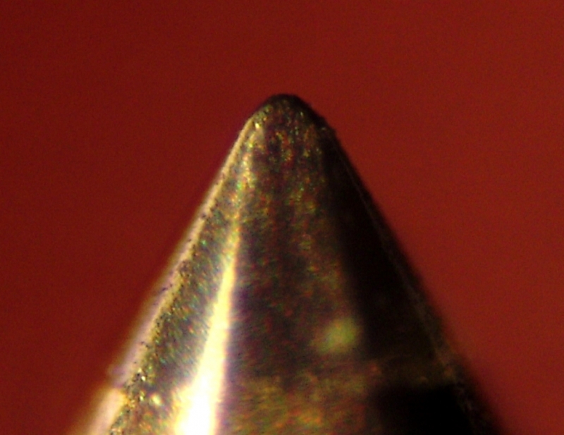

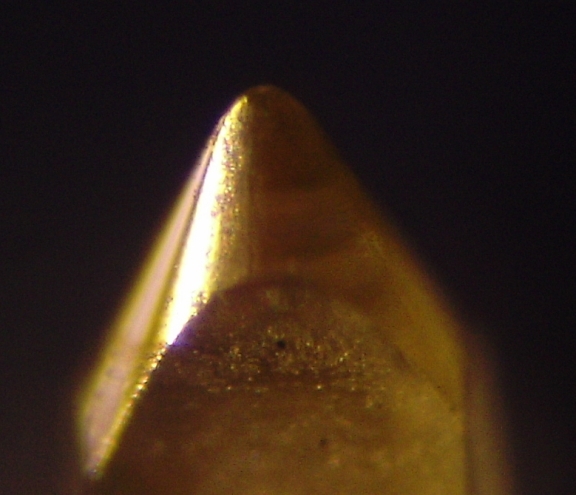

Optical microscopy has limitations due to wavelength of light. Here are a couple of my own images in as fine detail as I could obtain, of 2M Blue and 2M Red stylus tips. They're better than many (if I might say), but one still can't explore the contact regions to any meaningful extent.
Since these images are up, thought to raise a flaw in the basis of Hunt/Barlow/Walton et seq indentation tests: these tests were done (IIRC) by scraping a stylus across a flat plane of vinyl, and measuring the scratch.
However, the contact point in that case would be the base of the stylus, which need not have the same radius nor polish as the true contact regions. In these images, the base radius isn't too badly pointed, but it's not a safe assumption that stylus base has the same shape, radius, nor polish as the contact regions - and AFAIK back in the day this was never measured in those tests.
One has to scrutinise this stuff, not just accept the narrative/conclusions, IMO.
Also in the Barlow article Hiten linked, one might see how Walton's description of a 'try' at explaining dynamic behaviour had become lore and accepted as fact- whereas it omits significant viscoelastic and other physical properties of vinyl as previously pointed out.
And one can begin to see how a self-fulfilling spiral of acceptance might have emerged which, IMO, often doesn't stand scrutiny or describe what might really go on at the stylus groove interface. Never in the field of human endeavour was the Hertz equation wheeled out so many times when boundary conditions proscribe its application 😉
Anyways, here's some of my own pretty pictures of 2M styli from the archive.
LD

LD: where does the diamond end and the shaft start on that?
