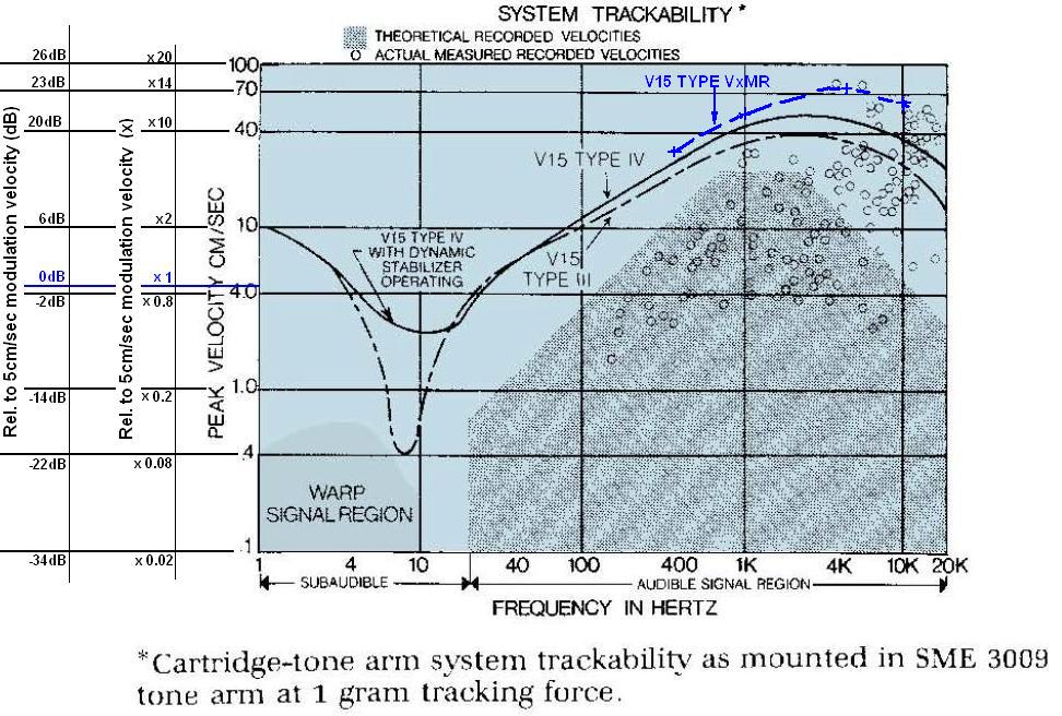

None of which helps me as I am confused trying to understand how to map velocity on a recording to um peak excusion. B&K QR2010 has a max of 24cm/s at 1KHz (or +8dB). I am stuck finding the derivation. is the 24cm/s peak velocity of distance travelled by the wiggle?
Short answer: for a sine wave, peak excursion = peak velocity/ω
Peak velocity means instantaneous velocity of the stylus due to groove modulation, in a given direction.
ω = 2*pi*f, of course.
Derivation from rotational physics:
Instantaneous displacement D = peak excursion * sin(ωt)
Instantaneous velocity V = dD/dt = peak excursion * ω * cos(wt)
[hint: d(sin(ωt))/dt = ω*cos(ωt) by the chain rule]
Peak velocity [hint:when cos(ωt) = 1] = peak excursion * ω
Rearranging gives the result: peak excursion = peak velocity/ω
HTH!
LD
Thank you. Google for once had failed me. I shall remember that now. So 24cm/s at 1kHz is roughtly 24/6000 or 40um. I note shure boasted the V15-V could track 60cm/s at 10kHz. Not sure how true that was, or if actually there ever was a record recorded quite that hot.
http://pubs.shure.com/guide/V15VxMR/en-US.pdf
V15xMR
Trackability at 1 gram (10 mN ) Tracking Force (typical values shown in cm/sec peak velocity):
400 Hz: 30 cm/sec
1 kHz: 46 cm/sec
5 kHz: 80 cm/sec
10 kHz: 60 cm/sec
