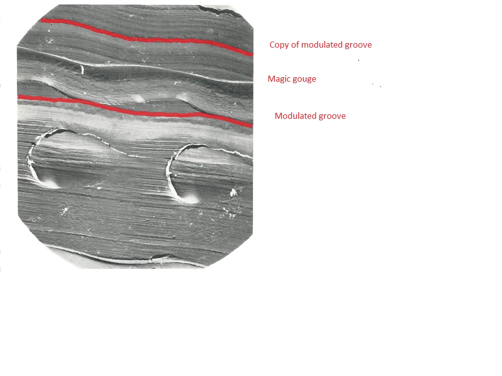

Just to make sure I am reading the plates the same as you are have marked one up.
The top red line is the 'copy' of the modulated groove. The lower one the best line I can find through the actual modulated groove using a trackpad. Clearly not the same section of groove, but close enough. The 'magic gouge' is the bit none of us can quite work out and at the bottom is the damage caused as the stylus, weighted down with 2 guineas slams into the wall.
If you look between the two dents in the modulated wall you can see that the gouge doesn't follow the modulation and instead mistracks, possibly catching a bit of air as it does ready to slam back down and dent the wall again. (note still clueless as to how this was captured)
At least that is how it looks to me. Heroic effort to get it to misbehave that badly on a mild modulation...

Bill,
Just as LD has suggested, the gouge is almost 180 degrees out of phase, as to be expected from a second order mass-spring system no longer being able to follow the "road".
Compare it to the movements of a wheel from a car with a broken shock absorber, following the road bumps 180 degrees out of phase.
Hans
Yes, was just checking we were all looking at it and seeing the same thing. There was a major tank slapper going on. just off to scan the missing page.

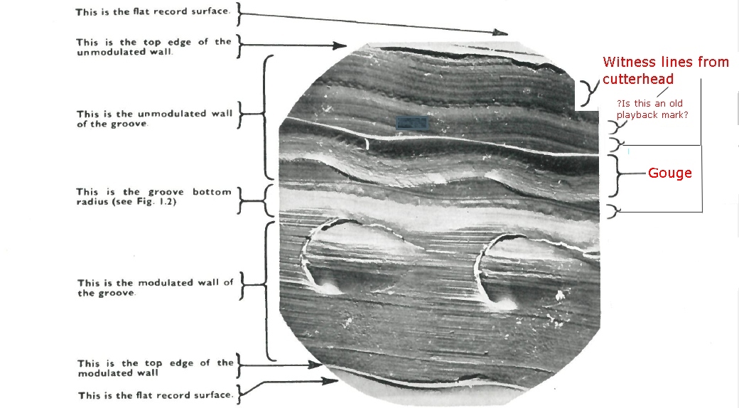

Hi Bill, thanks for that and the extra scan. I attached my own mark up of that plate, leaving in place the labels I think the author has correct, and adding my own in red for what I believe we are actually looking at.
If one wishes to see the true locus of the groove modulation as cut, vertically it is the lines of the witness marks and laterally it is the boundary of the groove base and the modulated wall (same as the boundary of the record top and the modulated wall). Then it's clear that the locus of the gouge has a phase offset - as you say it appears to 'catch air' at least on the modulated side, and lands on the elevated parts of the modulated wall.
As to how the SEM image was made, I think the record must have been dissected and a section small enough to fit in the SEM chamber prepared. Before placing in the SEM, the sample has to be sputter coated with a conductive layer, such as carbon or gold - but this must be after the playback when the sample has already been dissected.
There are so few SEM images of grooves in the public domain that images such as these might have been very influencial in terms of public perception. All the more reason that correct interpretation was made, whereas on the face of it, that might well not have been the case, unfortunately.........

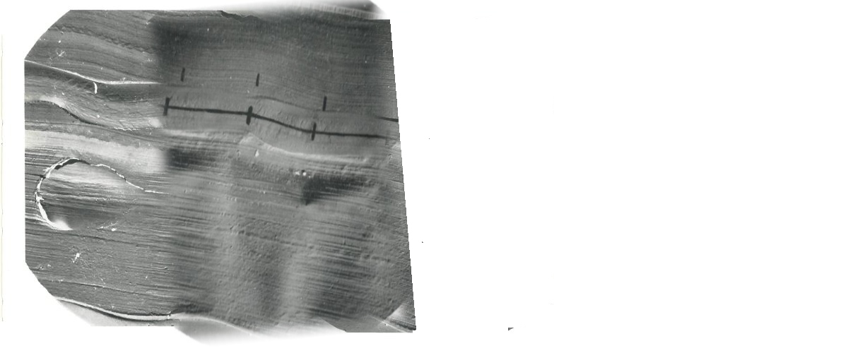

I noted something else this afternoon and need to do a bit of scaling. Plate 4 (250 plays) also shows the beginnings of a gouge where the stylus has been sliding up and down the wall. I need to rescale and put them side by side for comparison, but I believe that is the conclusive proof that you are right.

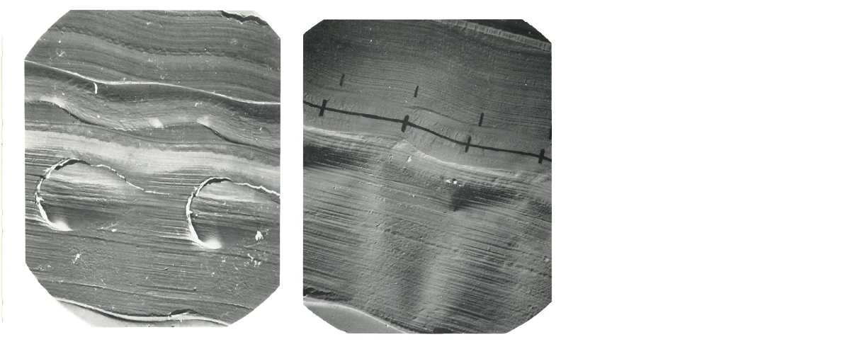

Meantime, here's an attempt at creating a composite image of the 'damaged'/'undamaged' SEM plates Bill posted. If the conditions for the 250 playback test are as described, right of the image, it supports the idea that polish of surface texture might happen after multiple playbacks IMO. Also supports that unmodulated wall contact was similar between 'damaged' and 'undamaged' images, and that the significant difference might have been excessive VTF based upon the depth and continuity of the gouge, IMO.
LD

I still don't understand that gouge. It looks like it was made with a sharp tip, a tip much sharper than a stylus would be. Normally the stylus is too large to get to the bottom of the groove.
The way the image flattens the groove, it's a little difficult to tell what the gouge is like. Is it up the wall a few microns from the bottom of the groove? Would something sharp be needed to plow a row like that, or is it not as it appears?
If you think of the contact blob of a spherical tip sliding up and down the unmodulated wall then it makes sense. for the 250 plays case it's smoothed out its path, like the tracks you see on any two sliding surfaces after a number of operations. For the damage case its because we think VTF was well above plastic deformation threshold and the contact patch 'dug in'.
