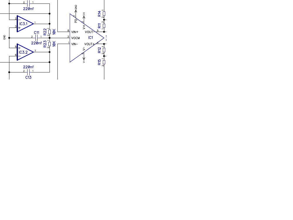

Ok, so I have my twisted pear boards. I'm looking at Hans' schematic Aurak 8, R9 and R10 represent the cartridge R? Also, R1 and R2 are the solved for R from earlier Auraks? The twisted pear schematic shows 2 10k resistors and a 220n Cap that didn't make it over to Aurak 8, do these stay blank, get jumped...? And I only have 7.5k's for R15, R16 will that value be a problem? Thanks Very excited about this project.

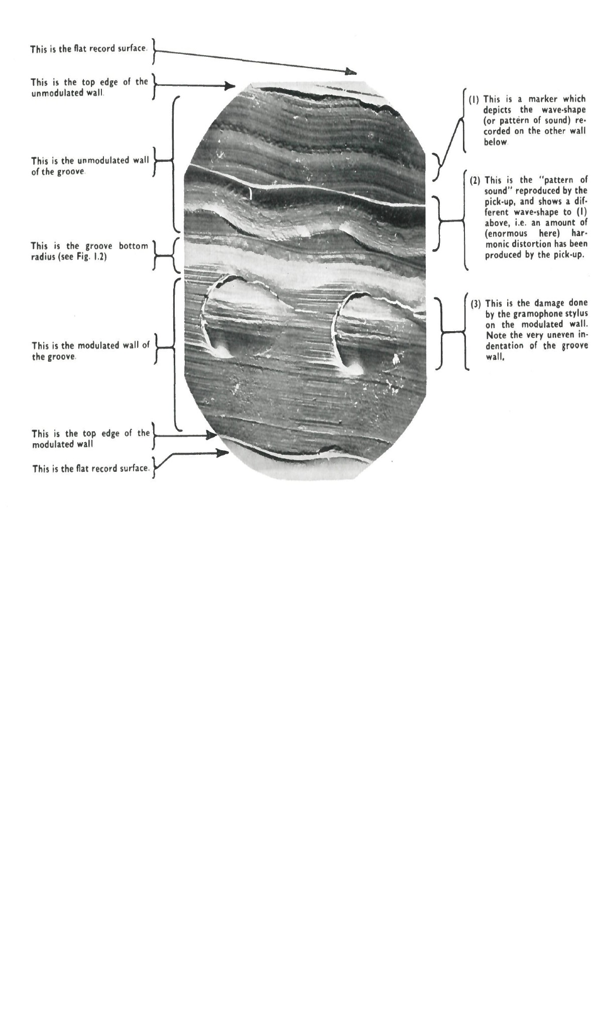

I'm still looking at the SEM images Bill posted from Walton's book, esp the one that allegedly shows significant damage from a single reasonable play.
Having spent a long time looking at it, I still don't get that image........I think there might be some mistake?
There's a continuous gouge along the unmodulated wall that isn't consistent with normal playback at reasonable VTF for healthy cartridge/suspension IMO. So that one knows what one is looking at, the gouge shifts vertically on the flat groove wall following the locus of the groove base, since only the opposite wall is modulated.
Explaining this gouge seems the forensic clue to understanding true conditions for the image. Thoughts ?
It looks more like a single playback at excessive VTF, or with a non-compliant vertical suspension cartridge, or a damaged or poor quality stylus, IMO.
I think this image, and its explanation, might lie at the root of much common knowledge and lore about the nature of vinyl wear, especially as to 'tip-mass'. If it's conditions were 'wrong'.... that might just explain a lot?
LD

R9+R10= RcartOk, so I have my twisted pear boards. I'm looking at Hans' schematic Aurak 8, R9 and R10 represent the cartridge R? Also, R1 and R2 are the solved for R from earlier Auraks? The twisted pear schematic shows 2 10k resistors and a 220n Cap that didn't make it over to Aurak 8, do these stay blank, get jumped...? And I only have 7.5k's for R15, R16 will that value be a problem? Thanks Very excited about this project.
(2xLcart-Rcart)/2=R1=R2
7.5K for R15,R16 is not O.K. so put ca. 305K in parallel.
2x10K + 220n ? I can't find what you mean. Please point me to the posting in this thread where you see them.
Hans
That's correct. I would replace the 220N by a short circuit and leave the 2x10K resistors away.Hans, the 2x10k plus 220n is the vcom connection to the output opamp that we discussed on pm a couple of weeks ago and you recommended not be used.
Hans
Bother. I got the book out ,put it in the pile to go in my bag and somehow didn't put it in. Phooey. Will copytype the page tomorrow, but for now, if you look at the first scan page (rotated 90 degrees) there is a description of how to read the pictures and you will see how they put together the composite. So you don't actually get to see the unmodulated wall.
The gouge is described as the 'pattern of sound reproduced by the pickup' so it trying to show that the HD due to resonances is huge and in fact that stylus is moving antiphase to the groove. Still no idea how they recorded that. Must be some papers on it somewhere.

Well, that published description of what appears to be a deep gouge on the unmodulated wall (labelled '2') seems suitably vague and woolly as to suggest it wasn't clear to the author what had caused it either, IMO............
There are witness lines from the cutter head (labelled '1') which run along the groove on the unmodulated wall, and they serve as a marker for the height of the cutter head in vertical sinusoidal motion: the groove base moves up and down as the modulated wall is cut, and so must the cutter head and so do the witness lines on the unmodulated wall. However, the gouge does not follow the witness lines; rather it has a significant phase offset......
It really looks to me as though, for that plot, the stylus had followed a delayed path and cut its own phase shifted gouge in the unmodulated wall, whilst depressing parts of the modulated wall. Besides trying to understand how that is even reasonably possible, surely this can't be normal playback as stated, for any reasonable configuration of VTF/stylus/cartridge............. ?
LD
Can't argue with you on that. Reading the missing page doesn't make it much clearer. Basically as only one wall is modulated the stylus will slide up and down the unmodulated wall, but how on earth Dr Chippindale recorded that is the mystery I have no idea. I'll try and find out more.
As regards reasonable situation, that comes back to the issue of when the plastic deformation limit is reached (and if in fact it can be) which links to forced applied due to resonance.

I think there were Letters to the Editor asking this exact question.as only one wall is modulated the stylus will slide up and down the unmodulated wall, but how on earth Dr Chippindale recorded that is the mystery I have no idea.
IIRC, the path of the stylus on the unmodulated wall was via the 'polishing' that occurs even with 'etm' 0.6mg It's very faint as can be seen from the other SEM scans.

Yep, indeed.Hans, in your Aurak 3 schematic you have R2 which controls gain. In the Aurak 8 can R23 be similarly used? Thanks.
Hans
