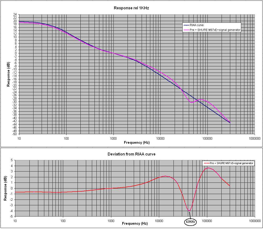

Here we are 🙂
George
Here we are 🙂
George
When this is recorded with your recently breadboarded Aurak, you have my compliments, great result.
I'm curious to hear the explanation behind the dip.
Since nothing is moving, is the cause of pure electrical nature ?
Hans
Thank you, George.Here we are 🙂
If you haven't already, would you please do a run with just a resistor equal to the cartridge coil resitance, so we can see the transfer function of your new Aurak ?!
Seems there's something odd with the general hf audioband lift, and would be good to find it methinks.

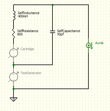

Yes, I think there's no surprise you clearly see the coil electrical self-resonance in that method. I've attached a schematic/topology sketch that I think illustrates why you see this with the external generator but should not in real playback.
In the sketch, there are two voltage separate voltage sources: one is the cartridge generator, the other is your external test generator. The current sensor, Aurak, has zero impedance, and we are interested in that current in Aurak when we use only one of the two voltage sources. I think it's easy to see the difference, and that, when the test generator is used, self-resonance of coil applies. Whereas, when the cartridge generator is used, self-capacitance is shunted by Aurak's zero input impedance so there should be no coil self-resonance.
PS: Oops, sorry I misdrew the sketch - appols for confusion, kindly ignore - I'll repost thx LD
PPS: Having some kind of mind melt, appols, I think the sketch is correct after all......... I'll go have a coffee !
LD

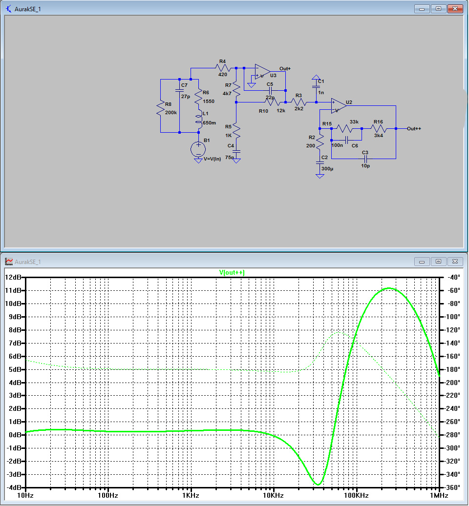

George,
It would be nice if you could show a copy of the exact circuit diagram that you are using, especially knowing the bandwidth reducing caps is important.
And also the details of your Cart, for Lcart and Rcart.
With all this info will it be possible trying to match the simulations in LTSpice to your measurements.
Just inserting a 50pF cap in parallel to the cart gives a different image with a much deeper dip as you have recorded.
When placing instead 200KOhm//50pF parallel to the cart, gives a dip of -4dB like you have, but without the shoulders before and after.
See both sims below.
Hans

A combo of 27pF//220K in series with 56K, will bring the sim even closer to Georges recording, with a dip at 34Khz of -3dB and a 4.5dB peak at 130Khz.
Hans

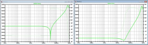

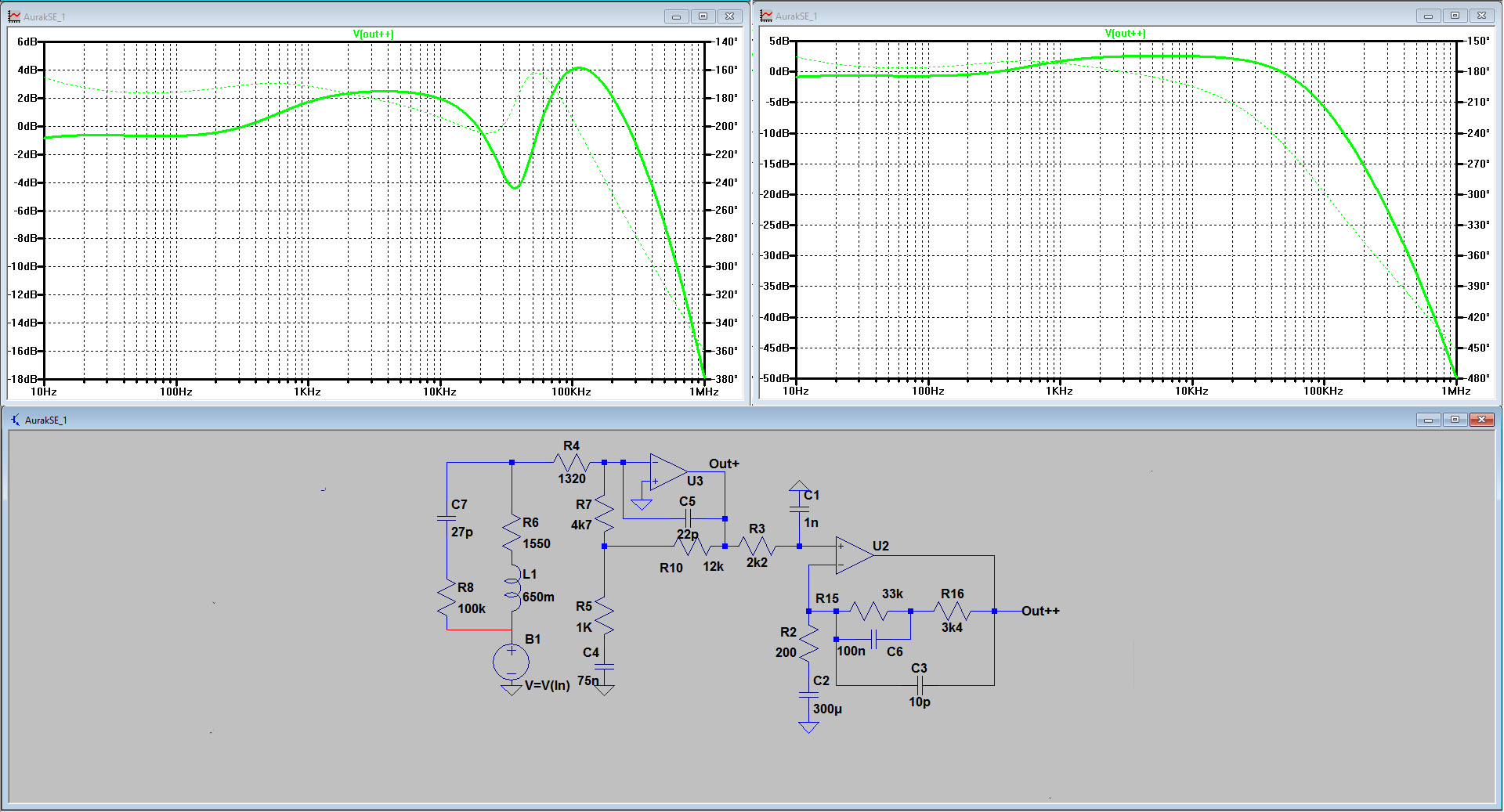

George,
Since you didn't have the opportunity yet to respond to my questions, I simply went on.
I was very well able to reproduce quite accurately your recording with an external generator, see below on the left side.
However when simulating this circuit with the internal generator, FR was not flat as shown at the right side.
So your input resistor may not have the right value, causing the shoulder at the left side of your dip.
Hans

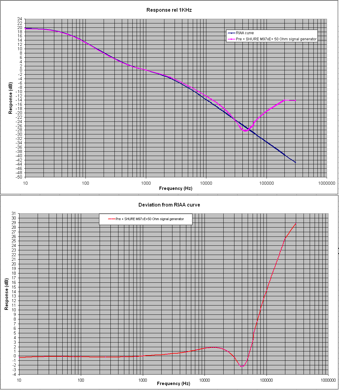

Sorry for not responding so far.
Hans and Lucky, thank you for your interest, particularly for the sim efforts.
Hans, don’t spend your time again trying to chase stupidity.😀
I had connected both pre channels at the generator out, L directly, R in series with the Shure cartridge for to monitor L out and R out on the scope simultaneously and when the time came for measurements, I forgot to disconnect L from the generator.
So, the input impedance did change and the diagrams in post # 487 were (unintentionally) misleading.😱

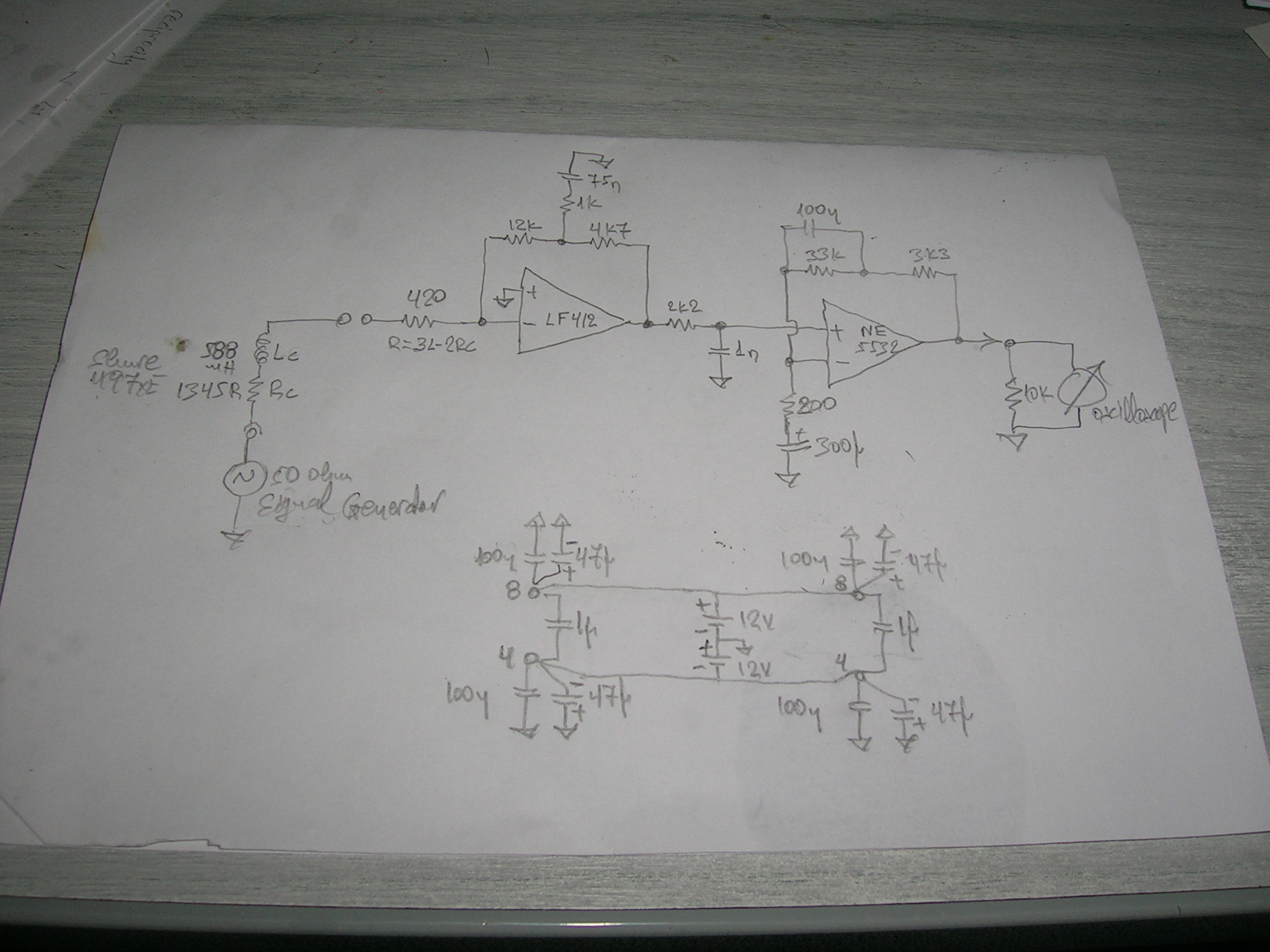

I attach the schematic of what I have built and the connection used to take the measurements (only one channel connected this time 🙄)
Lucky, I am going to take measurements with an R in place of the cartridge
George
