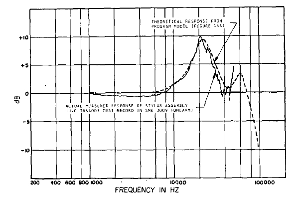

I have the Happ paper I was posting about, Happ, L. R. (1979). "Dynamic Modeling and Analysis of a Phonograph Stylus." J. Audio Eng. Soc 27(1/2): 3-12.Sounds plausible but I can't recall seeing any MC FR plots that show the dip so I would need some convincing.
There are many possible choices as to the modeling technique used to represent a mechanical system. The traditional method within phonocartridge development has been the electrical/mechanical analog circuit. The approach taken in this study was to mathematically describe the stylus system in terms of a series of continuous, flexible beams undergoing transverse vibrations. It is assumed that the structure undergoes sinusoidal motion and thus the wave equation for the beam has a general solution. The boundary conditions are progressively improved to provide a realistic representation of the system. New approaches to stylus shank design are presented.
Whilst I don't agree with all of it, especially the boundary conditions which define modes of vibration available, I think by happy coincidence the general form of the model is good, and it is well worth seeking out on the web and reading IMO.
Part of the paper describes the transfer function of the cantilever system in isolation, and compares modelled versus real measurements of f response. In this, the real measurement shows a classic mid-dip, whereas the model doesn't (my thesis is because the model excludes tonearm effective mass element).
Attached is the relevant plot.
There is no clear trend from the Miller Audio data, which is a pity because that is the only site I know with such comprehensive test measurements.
My thesis predicts that mid dip would be more pronounced in carts with low compliance, and therefore low damping, typically identifiable by low VTF requirements. I believe this might be why MCs tend to show it less, if that is the case at all, perhaps ? I'd cite some of the old Shure carts a an example, I think ?
One might ask 'what's a few dB of mid shape between friends?', but I believe it probably has a mechanical cantilever cause, rather than a generator artefact as commonly accepted. So thought this a good place to trot it out......

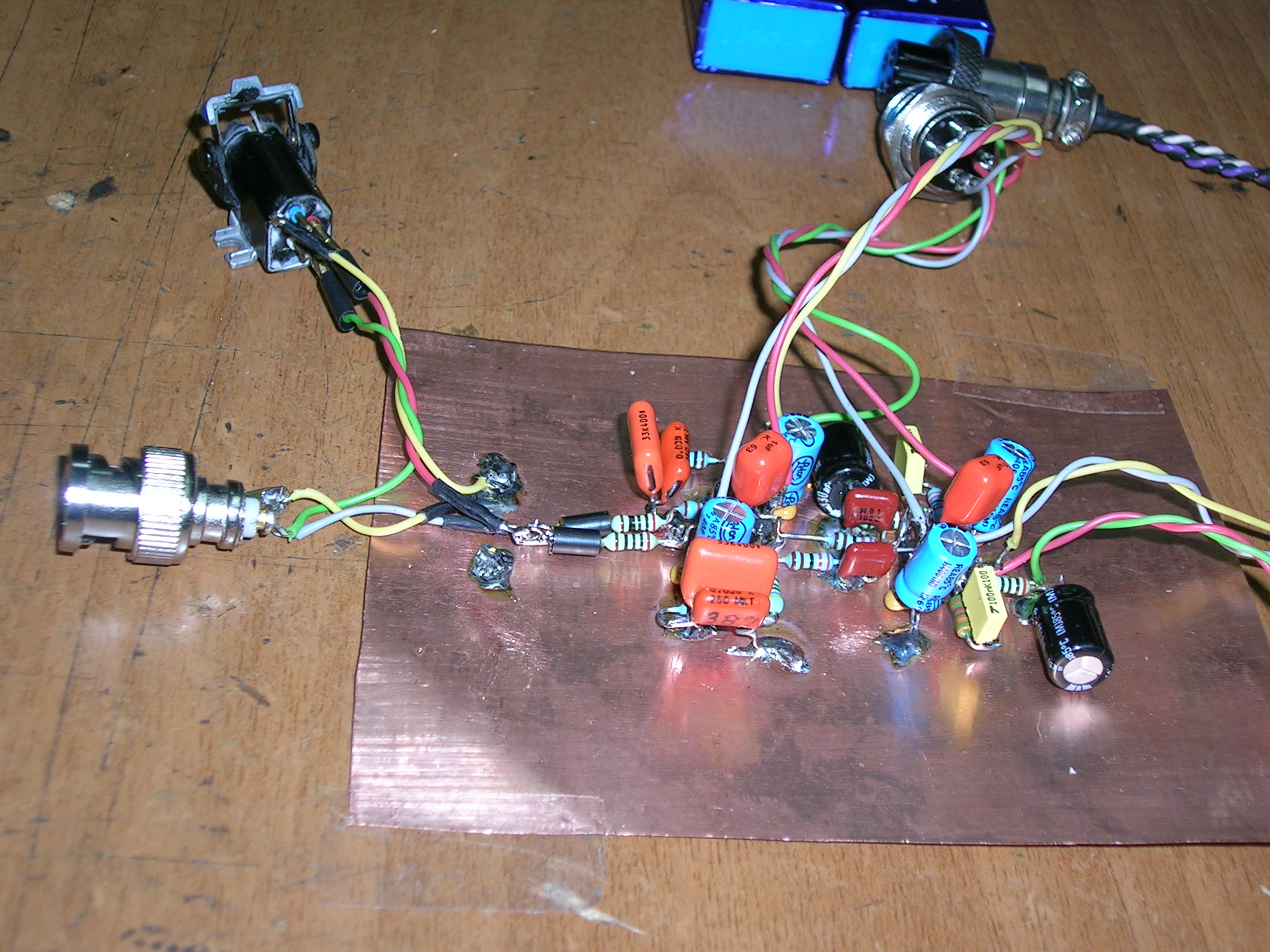

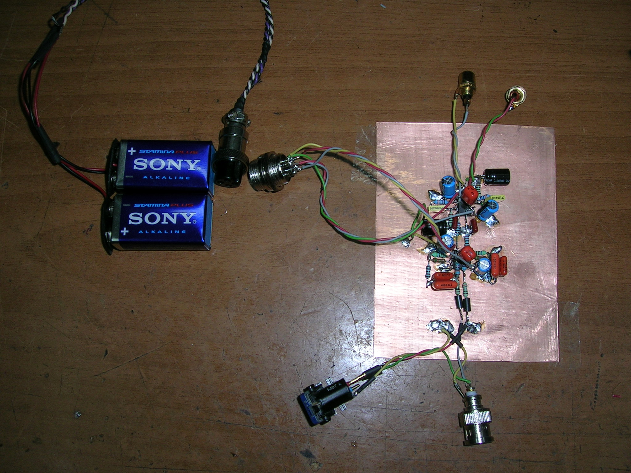

I spent the day building the Single ended Aurak V3 trimmed for the Shure M97xE.
IC1 LF412, IC2 NE5532.
I’ll fire it up tomorrow after rechecking connections. Wish me good luck 😀
Left channel input is signal generator only.
Right channel input is signal generator in series with the M97
I’ ve ordered some OPA2134 for IC1. I’ll have them in a week.

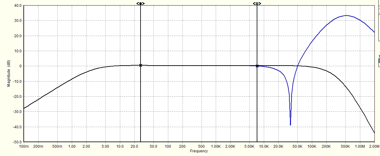

George, yes good luck, but will this not simply confirm the outcome of your previous test with this setup: that the impedance of the coil in this regime comprises self inductance and self-capacitance in self-resonance ??Left channel input is signal generator only.
Therefore I predict you'll observe the self-resonance of the coil again, I think.
We discussed this previously, and topology differs from the real playback situation where the generator is intrinsic to the coil, and transimpedance input loading shunts self-capacitance of the coil and eliminates the resonance.
So I predict you'll obtain a different result from real playback of a sweep f test record, and only real playback will obtain the true transfer function of the generator loaded this way. So a test record is the only way, I think.
But good luck, and at least you'll have a working transimpedance MM/MI preamp.
PS: Attached is a simulation to illustrate. I predict you will obtain the blue trace, whereas playback will obtain the black trace.

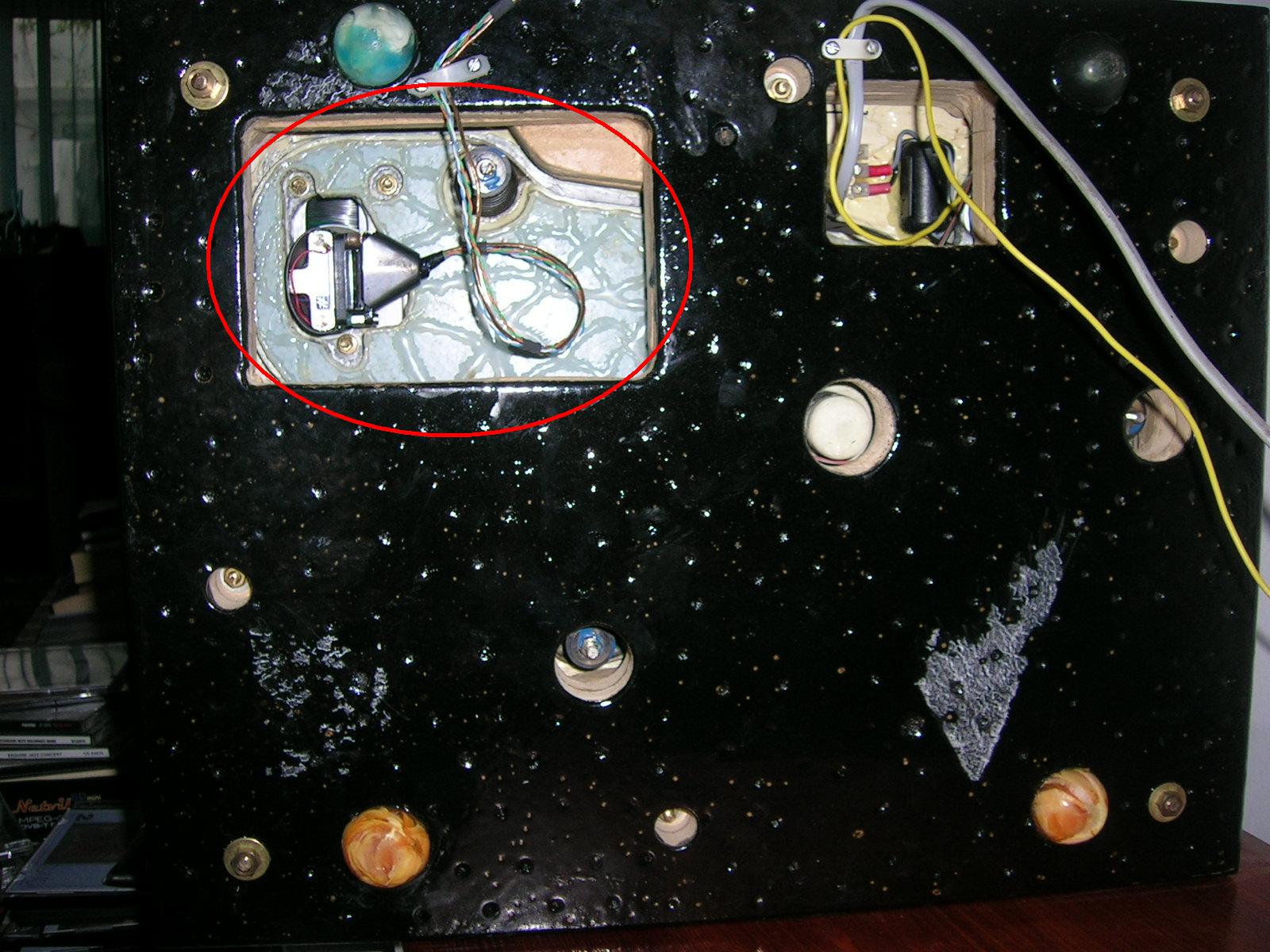

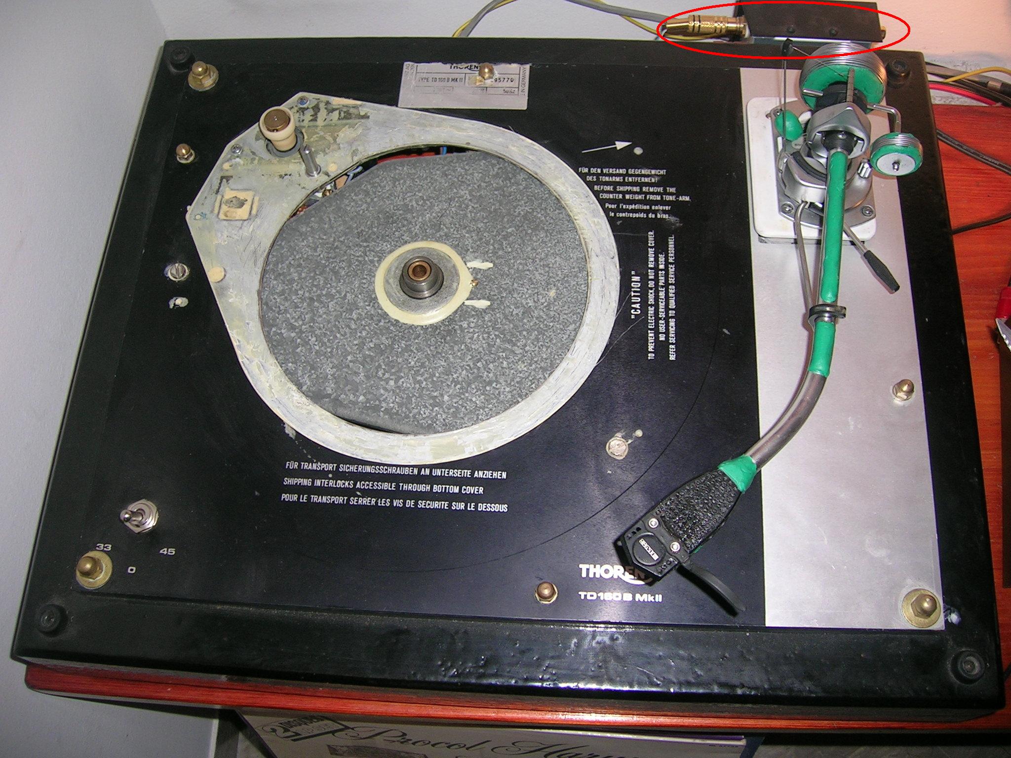

With the DL-103, I had the pre-pre at the back of the TT, 10 cm wiring.
Now with the MMs, the pre will be just by the base of the tonearm, in a recess of the TT chassis, 3 cm of external wiring, direct soldering, no connectors. The internal wiring of the SME arm is only 10pF.
