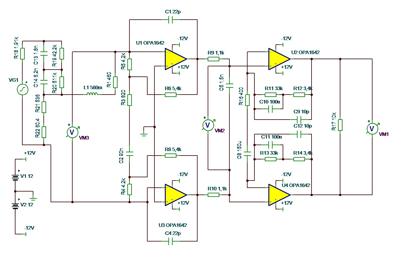

Here's a schematic of what I believe is a balanced iteration of the transimpedance phono preamplifier that luckythedog mentioned a few days ago. Alas, I lost the original schematic. I do know the opamp has been changed from the original AD743 however. And IIRC, there's also a few other changes that maybe bother luckythedog enough to set the record straight for us all.
Well, that looks a TI variant, but it's not one of mine, is it yours ?

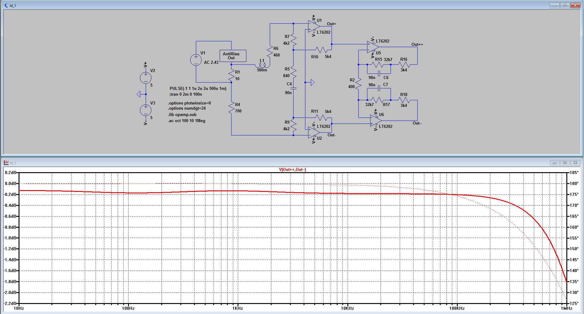

Here's, I think, the first version of Aurak that had a simple way of setting up for different carts. All these were sketches, enough to discuss the concept. Naturally there's potential for improvement, all my stuff is spherical cow based. Op-amps should be 745s or 5534s, not 743s I later realised, for GBW reasons.
LD

No it's not one of mine but I played a part in it getting cooked up in the first place.
About four years ago I approached you on another forum about build assistance on the Aurak 3.0 but at the time you weren't interested in discussing the matter so I let you be. The schematic I posted is all I have left from that aborted project (and a few AD743s), the result of having taken the discussion elsewhere. About that time the family relocated and the project was completely aborted when I sold my turntable shortly thereafter.
Thank you for the upload, btw. :up:

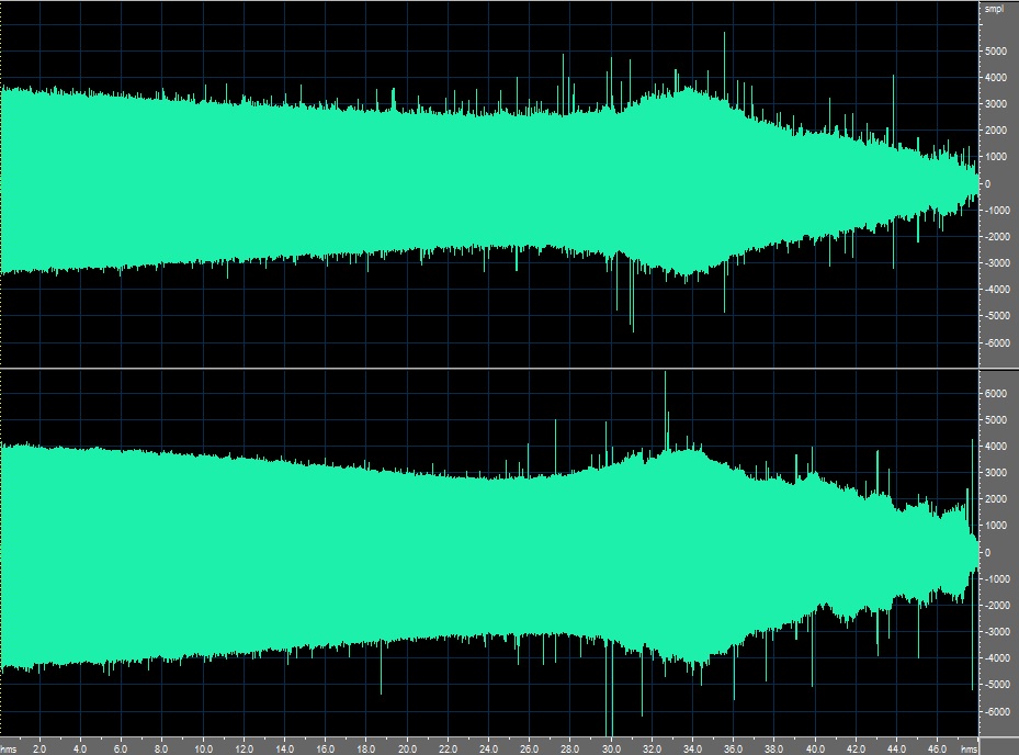

My apologies if I have missed something - did we establish that the 40kHz signal riding on Scott's square waves was from an electrical system? Or was it an artefact of the measurement system? If it's not clearly either of theose, then is there a mechanical system resonating at 40kHz that we need to consider?
No, in my case I think there are visual artifacts from the software doing a sinc interpolation for display of a squarewave. Here is a 500-50kHz frequency sweep at constant velocity, the bump at 34 seconds is at around 13kHz with the sweep in fractional decades per second. With some imagination one can see the TL effects especially in the lower channel but no sharp resonances. I mentioned yesterday that my recorder aliases so there is actually information here out to 50kHz at 96kHz sampling.

OK - thanks, Scott
Thanks for the explanation - much appreciated. And hence the main focus of discussion is the electrical system.
