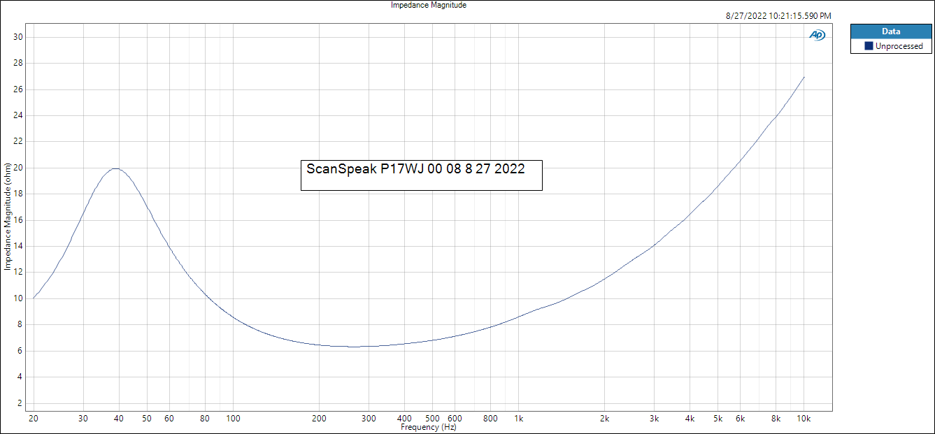

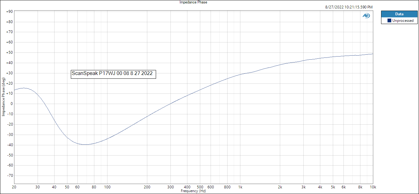

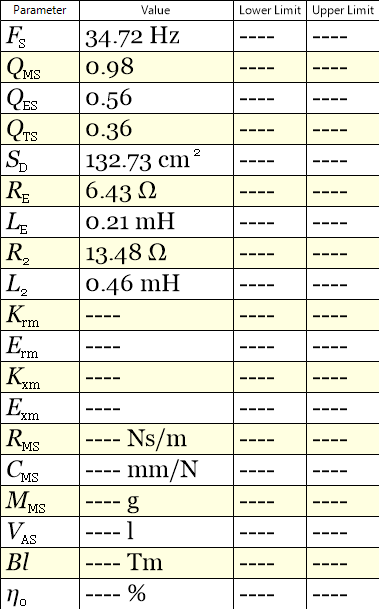

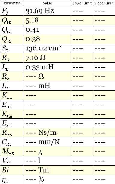

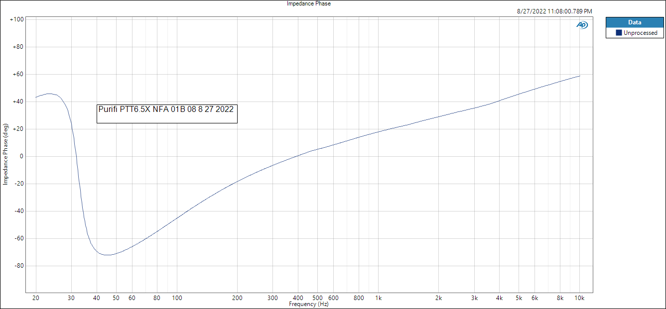

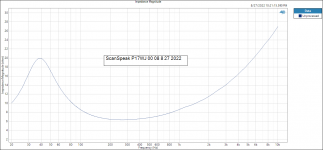

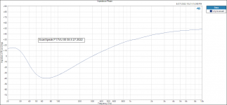

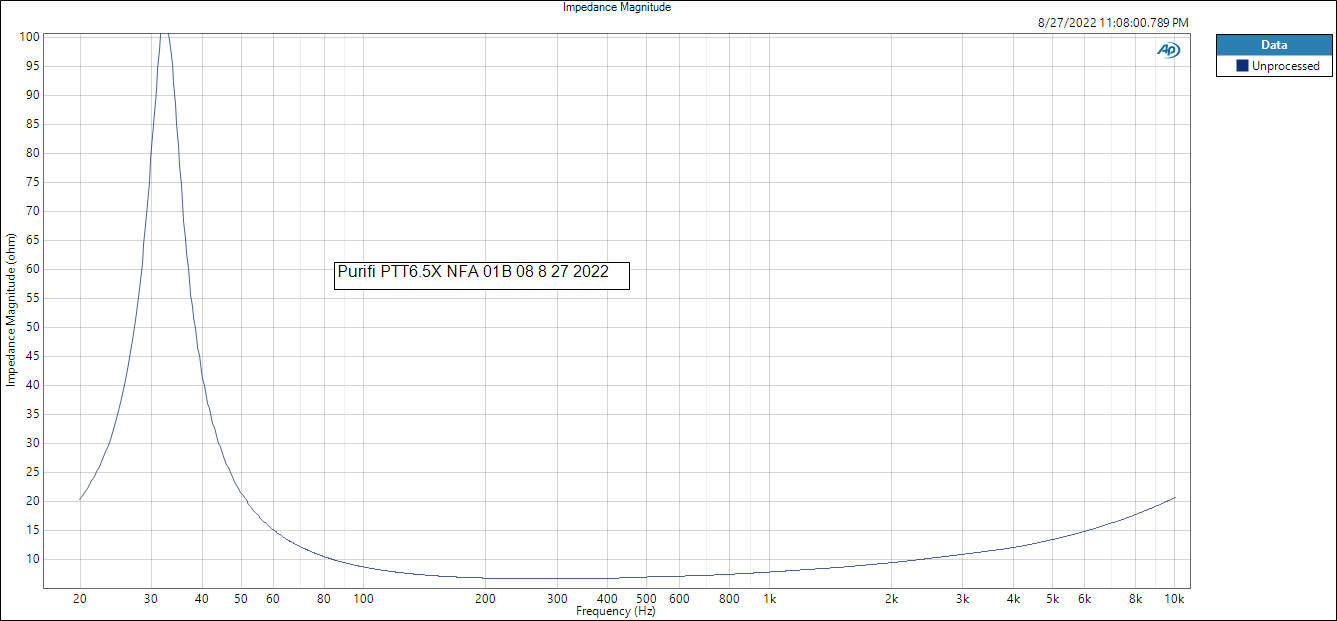

Back to testing drivers, Mid-Bass drivers this time.
I am looking to make a pair of Mini-2-Ways this time.
There are a couple of mid-bass candidate drivers sitting here on the bench. This is for fun so we are open to other thoughts.

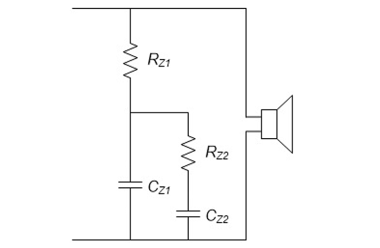

I have read a couple of places that amplifiers and crossovers perform better wit Zobels or compensation networks in parallel with the mid-bass driver. Perhaps even less distortion.
A couple of references below.
https://leachlegacy.ece.gatech.edu/papers/zobel/zobel.pdf
https://www.klippel.de/fileadmin/kl...iterature/Papers/Voice_Coil__Impedance_04.pdf
https://audioxpress.com/article/voice-coil-lab-notes-improved-zobel-network
I have a couple of test plots of Impedance Magnitude and impedance phase for each below.
I have resistors on order for the Zobels.
Impedance Magnitude Purifi PTT6.5X NFA 01B 08 8 27 2022.PNG16.8 KB · Views: 68
