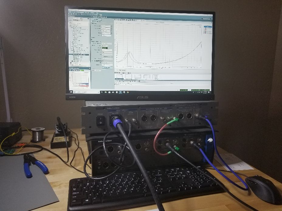

Hello All,
Sparky, the cat, and I have been setting up Sparky’s Lab. First off we have been sorting out the hardware and software to do Thiele Small measurements and calculations.
We think that we will like this AP test gear. The learning curve is really tedious and convoluted. You would expect the documentation to have the use and setup all in one place. It is not that straight forward. It is a lot like computer programming; it can be 98% correct, however put one misplaced check in a box and the entire thing will not run. There is no illustrated guide that shows sample applications with hardware connections and software set to go. No you need to bounce around among the manual chapters and do a considerable amount of trying different stuff. We are keeping a lab daily journal so we can do this again in the future. I think like a teacher, and make a lesson plan for teaching stuff to other folks.

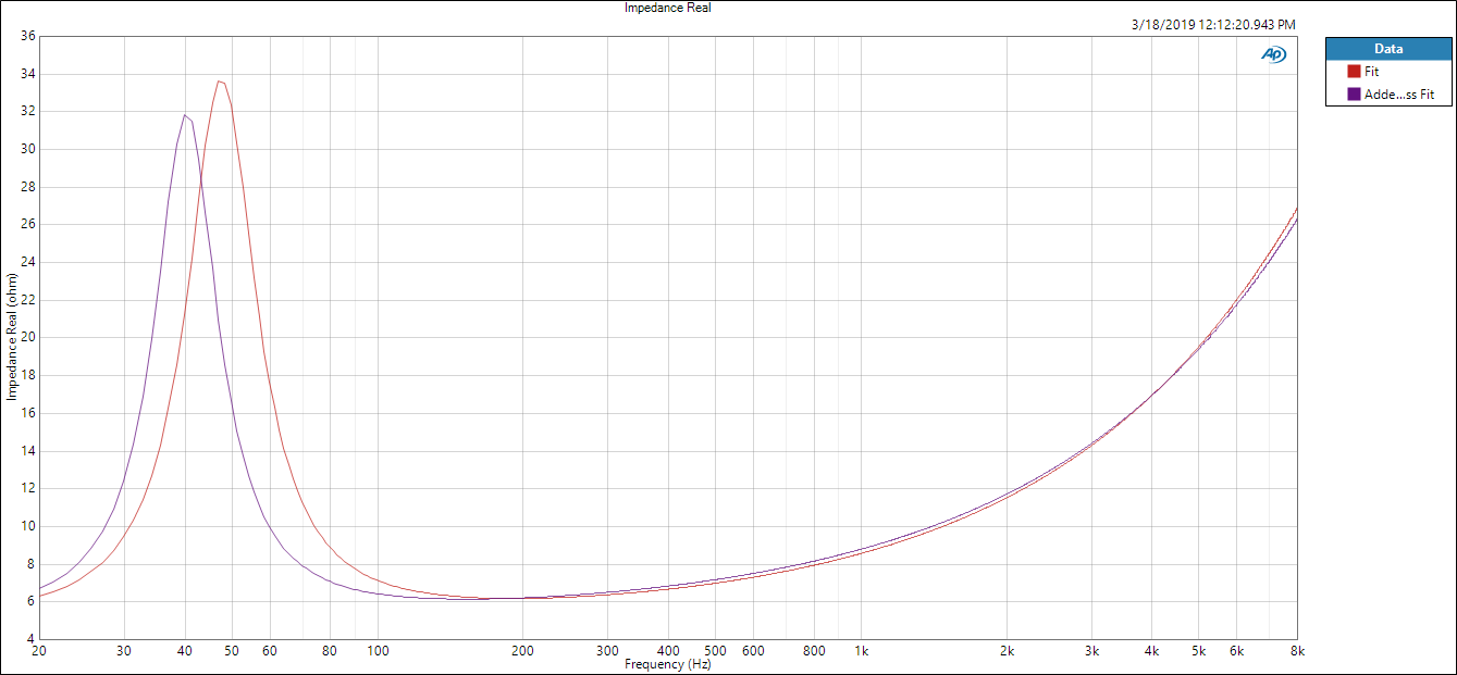

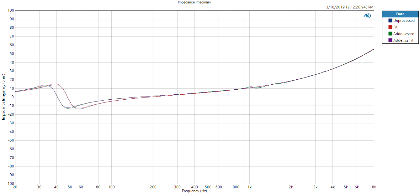

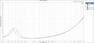

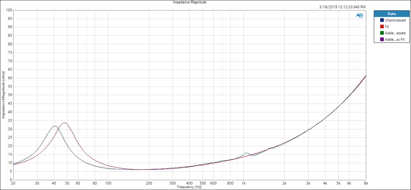

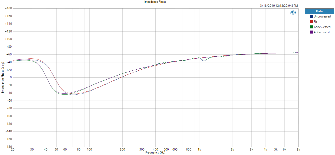

The first project was to measure the Thiele Small Parameters of a JBL 2226HPL woofer. Using 0.5 Volts input. The two sample woofers measured very close to the same values. The Fs of both drivers was very close to 47.5Hz. The factory data sheet says that the Fs is 40Hz. My drivers measure 18.75% higher than the factory specified resonance frequency.
Perhaps it is a break in thing?
See the attachments.

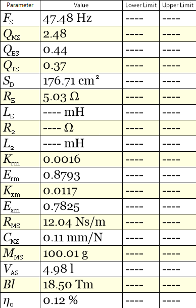

Hi, how did you get to shrink the woofers down to Sd=176 cm2?
GIGO
Garbage IN, Garbage Out.
In this case enter 15 centimeters rather than 15 inches you get square centimeters out.

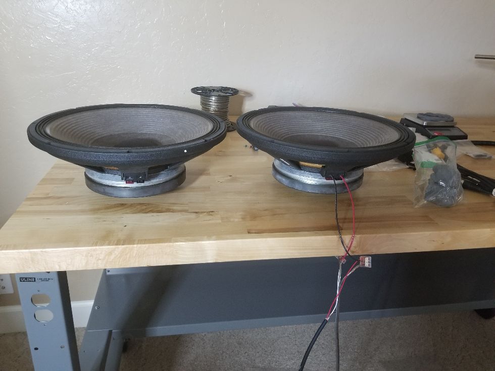

Interesting, Sparky and I went into her lab this morning before turning up the heat. The 2226HPL resonate frequency went up to 50Hz over night. Temperature does make some things stiffer.
Thank You DT :snowman2:
Several issues here.
1) You can't measure the driver on its back. The moving parts are going to sag some into a stiffer part of the suspension's range. This will result in lower Cms and higher Fs. Also the air load is increased when the driver cone is this close to the table surface.
The driver must be held with its central axis parallel to the ground. You can do this by cutting out a Vee block and then screwing this into the top of your work bench at the front edge with the Vee on top. This gives the magnet of the driver a saddle to sit in. Then get a bar clamp. Cut a slot in the table behind where the magnet will be. Take he clamp apart. The fixed end of the bar should be under the table. The moving end will now be above the table. You can use it to clamp the magnet from its OD.
https://www.homedepot.com/p/TEKTON-36-in-Ratchet-Bar-Clamp-42-in-Spreader-39186/205606940
2) You must excite the driver to minimize creep in the suspension before measuring. This is done by driving the woofer with a sine wave at Fs for a certain period of time, then letting it cool for a certain period of time, before measuring.
It's a myth that drivers "break in". They change behavior over the short and mid term when exercised and/or are heated up, but they return to the exact same state after resting for a period of time. Below is a link to a report on some of these issues. I don't have the original file, only a printout of it and the graphs are really small, so I had to scan it at a really high resolution. You'll have to download each of the pages from the link below, if you want to read it.
Dropbox - TSP - Simplify your life
In particular look at figures 7 and 8 and the associated text. Notice how in Fig 8, Fs decreases each time a new measurement is made? The driver is becoming more compliant from the measurement excitation.
3) I assume that you are using AP to measure the impedance curves, then using some software to look at the resulting data points and calculate the TSPs from it. Correct?
If this is the case, you are wasting a lot of accuracy in your test equipment. When you make an impedance curve by sweeping the driver with a sine wave, you can get significantly different curves depending on which direction the sweep runs (high frequency to low frequency or vice-versa). This has to do with how nonlinear the suspension and BL curves are in the driver. The worse they are, the more different the curves will be.
Another problem with this technique is that you are putting much more heat into the driver than you need to for the data you need to measure. You are sweeping it across its entire bandwidth, especially right through the impedance minimum around 4*Fs.
To get the best use of the AP, you should program it to search for Fs, by finding zero phase. Once that is done, record the Fs frequency and impedance magnitude. From that data and knowing the drivers Re (measured before testing starts), AP can automatically be programmed to find the -3dB points on the impedance curve. These frequencies are recorded. Then the driver is perturbed somehow. This is normally done by adding a known mass or installing it in a box. Then a second impedance curve is taken. The FS shift is then used to calculate a number of other driver parameters.
Both adding mass and installing the driver in a box to look at the Fs shift have problems associated with them. By far, the best method for determining the drivers mass or compliance is to use an added mass, but with before and after SPL sensitivity measurements used to determine the drivers moving mass. This avoids an entire area of nonlinearity in the drivers behavior.
I'll post more about this later, when I have time.
I've attached the formulas needed for calculating all of the driver parameters from these measurements using both the mass and compliance perturbation techniques.

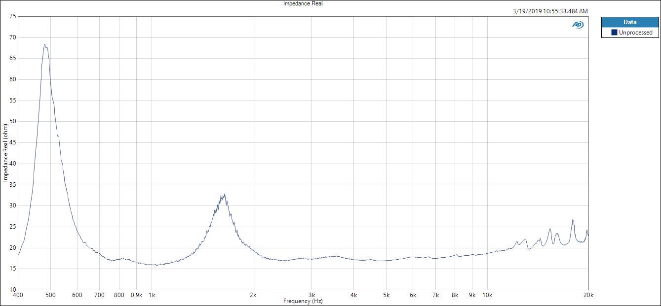

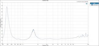

DT,
There is something wrong with your impedance measurements from the other thread. Assuming they are taken with swept sine, they should be very smooth. The jaggedness indicates some type of loose connection or you have not programmed the settling parameters correctly into the AP. The adjustable settling parameters are one of the best features in it. They allow one to take good measurements in the shortest time period possible without getting junk data. They are only relevant when the test signal source is a swept or stepped one.
Hello,
Other than the assumption that “there is something wrong” this may be a good discussion. The jagged impedance plots you are speaking of are produced by the APx500 Impedance-Thiele Small application using the APx555 analog frequency generator. The data are collected at a finite number of discrete sampling points. The data can be downloaded in comma separated format or in a spread sheet. There is the option of sampling over a short period of time and over a wide frequency range; the data may stair step or even saw tooth because of the course resolution. Or we may sample over a long period of time with many samples focusing on a narrow frequency range. In this case there will be much better resolution. It is a tradeoff between sample size / time, band width and resolution.
It is my test I get to pick.
There may be something else going on with the DUT. If we were sampling a smooth continuous function I would expect to see stair steps not saw teeth even with course resolution settings.
The plot with jagged edges was a test of a compression driver attached to a waveguide / horn. At the time I said that I was surprised at the multiple large impedance peaks of the CD / waveguide combination. I recall seeing similar impedance peaks and saw teeth in other people’s plots of similar CD / waveguide combinations. I will zoom in and take a higher resolution look at the waveguide.

DT,
I have 20+ years of experience in using and programming AP sys1 and sys2 hardware. I have never used an APx analyzer, but I have looked over the hardware and it doesn't operate significantly differently than the earlier models, so I'm very sure that the measurement results will be better or the same.
The jaggedness in the impedance measurements that are visible in the other thread can not be in the behavior of the DUT. They must be results of the measurement setup. For the driver to behave the way it does with the raggedness visible would break the laws of physics.
The impedance peaks at 500Hz, 1.7kHz and above 15kHz are of course all characteristics of the horn and the driver combination. Almost all of the other features in the measurement are not real.
I've attached a measurement of a metal cone 6.5" woofer for comparison made with a sys2. Note how it is completely smooth. There is no smoothing in the measurement. I can't open the original data file right now, but this curve probably has 150 data points over the measured bandwidth.
If you are interested, I'd be happy to come by and help figure out what is wrong.

DT,
"Processing" has nothing to do with your measurement results. Something about the test setup is not correct.
I'm measured hundreds of drivers with different AP systems. If the results look like what you have, something is wrong.
The roughness can't be due to the driver bouncing around on the desk. The ratio of masses is far too high for that. The motor plus horn weight is probably 1,000 times the moving mass of the diaphram and voice coil.
If the roughness was due to a resonance, there would be frequencies around which the roughness had a lot of amplitude and then at most other frequencies, there would be no roughness.
The impedance curve which I posted looks exactly the same in the AP test software as it does on the pdf file. It is perfectly smooth in both cases.
I'm really trying to help you here with something that I appear to have orders of magnitude more experience with than you do. I can not understand why you are blowing off my help or experience.

I don't know if you have ever used an Audio Precision test system or not, but the analog detectors in them have programmable settling in them. I know of no other audio test hardware with this capability. It allows one to guarantee good data when measuring acoustic systems, which have varying settling times due to resonance and propagation delay. With the AP software, there is some degree of adjustment required when setting up various acoustic tests.
DT's impedance results look like the settling is set to linear and only one or two samples.
Hello,
This is the identical setup, one hour different in time, for the JBL2226 woofer. Appears as it should.
The only difference is the DUT, no other changes were made. Except BW.
Thanks DT
