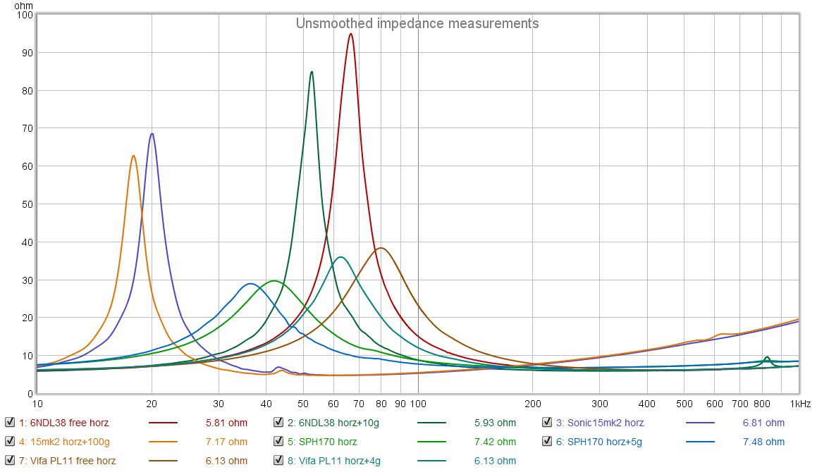

You are making statements that are simply incorrect.
I have the impression that smooth is the exception and not the rule.

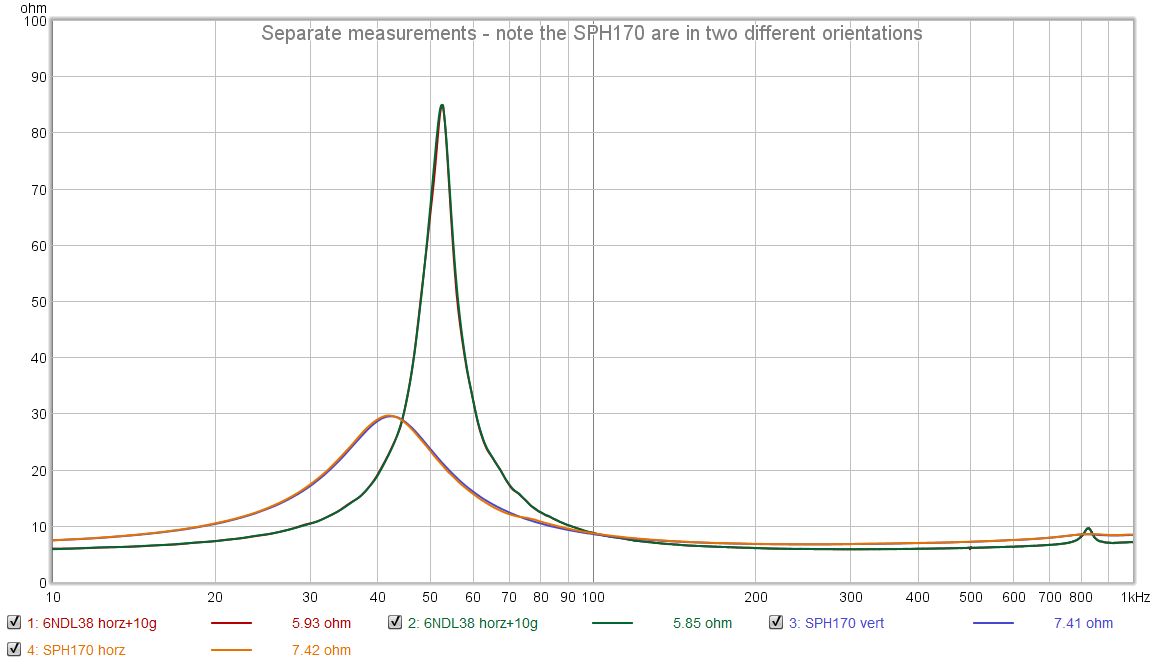

It is not. Here are some swept sine measurements of a variety of drivers with and without added mass. The frequency resolution is 0.366 Hz, so there are about 2,700 points for each measurement in the span shown. This is raw measurement data.
Take a dozen separate tests and plot the smooth looking curves on the same graph page and none of those perfect looking plots will fit onto another.
They will with a proper measurement setup. I don't keep many repeat measurements since they are near identical, but I found a couple. Again, raw measurement data.
Averaging and smoothing are often used to cover the warts.
No, they are not.
You may wish to learn a little more about the measurements you are making rather than treating your incorrect assumptions and assertions as fact.
What John is saying is true. These are representitive curve:
745333d1553547562-measuring-speaker-stuff-starting-thiele-parameters-various-jpg
There are few bumps and they are the results of resonances in the driver. If in a box they will also show where box resonances are.

What john is saying is completely missing the point.
The plot you are saying is representative is new to the discussion. It has thousands of data points. The cone woofer plot that is the example plot for this discussion has only 150 data points according to Jack who posted it.
At this point these cone woofer plots are a distraction.
I started this with impedance plots and Thiele Small Parameters done on my bench top of a JBL 2226HPL. The impedance plots are as smooth as any see post #23. Longer sampling duration will add more data points. The old time vs. quality discussion.
What got people excited was an impedance plot for a compression driver attached to a horn / waveguide. It was not nearly so smooth. see post #39.
Posting smooth cone woofer impedance plots does not help the discussion of Compression Driver / horn impedance peaks, dips and ripples.

These impedance peaks & ripples are real. They correspond to resonances, both mechanical as well as acoustic resonances in the horns. You will see a set of resonances when the horn 'unloads' ie stops providing horn loading. Look up Jurassic articles on horn design. Also resonances due to reflections etc.
They appear bigger cos the 'efficiency' of the horn loaded units is greater than the bass units.
For good bass units, usually the only one visible is the surround resonance.
You see these at 43, 620, 830 Hz on John's measurements.

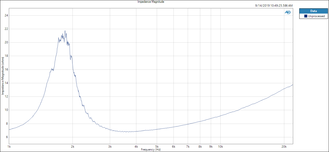

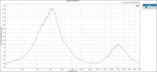

impedance graph of the JBL D2 / JBL PT 1010HF-1 waveguide combination

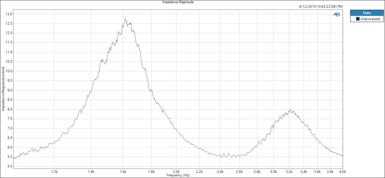

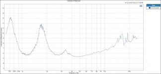

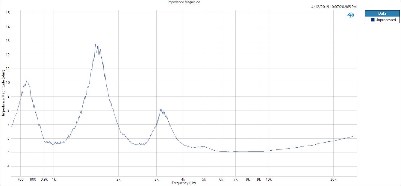

Hello All,
If you recall a month ago I did some testing / plots of Compression Drivers / Waveguide combinations. I have returned to Sparky’s Lab and completed additional follow up impedance plots. Attached is one sample set of plots for the D2 CD used in the JBL M2 monitor the waveguide is the PT HF1010HF-1. There are more plots to post when I return home.
If you recall I posted impedance plots that included the large mechanical CD impedance peak below 600 Hz and near equally large peak at 1.6K ish. There were small ripple like peaks distributed along the impedance plot. There were comments that he ripples were not likely periodic and not caused by the DC / Waveguide assembly. It was commented that the ripples were likely caused by noise from bad connections or something similar.
I took a closer look and repeated the impedance plots many times. The ripples appear to be very much periodic. I plotted the impedance plots one on top of the other many times. The plots appear to be a single line plot with each plot exactly matching the others, ripple for ripple.
See the attached plots for the D2 CD and PT 1010HF-1 waveguide.
1 A single plot zoomed in to show 1K to 4KHz.
2 A second single plot zoomed in to show 1K to 4KHz.
3 A full Band width plot 630 to 25Khz. To show the complete impedance graph of the JBL D2 / JBL PT 1010HF-1 waveguide combination.
Thanks DT

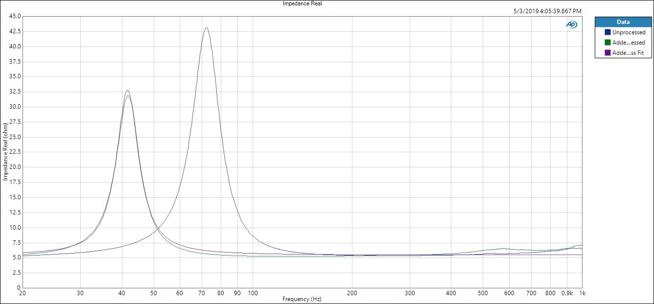

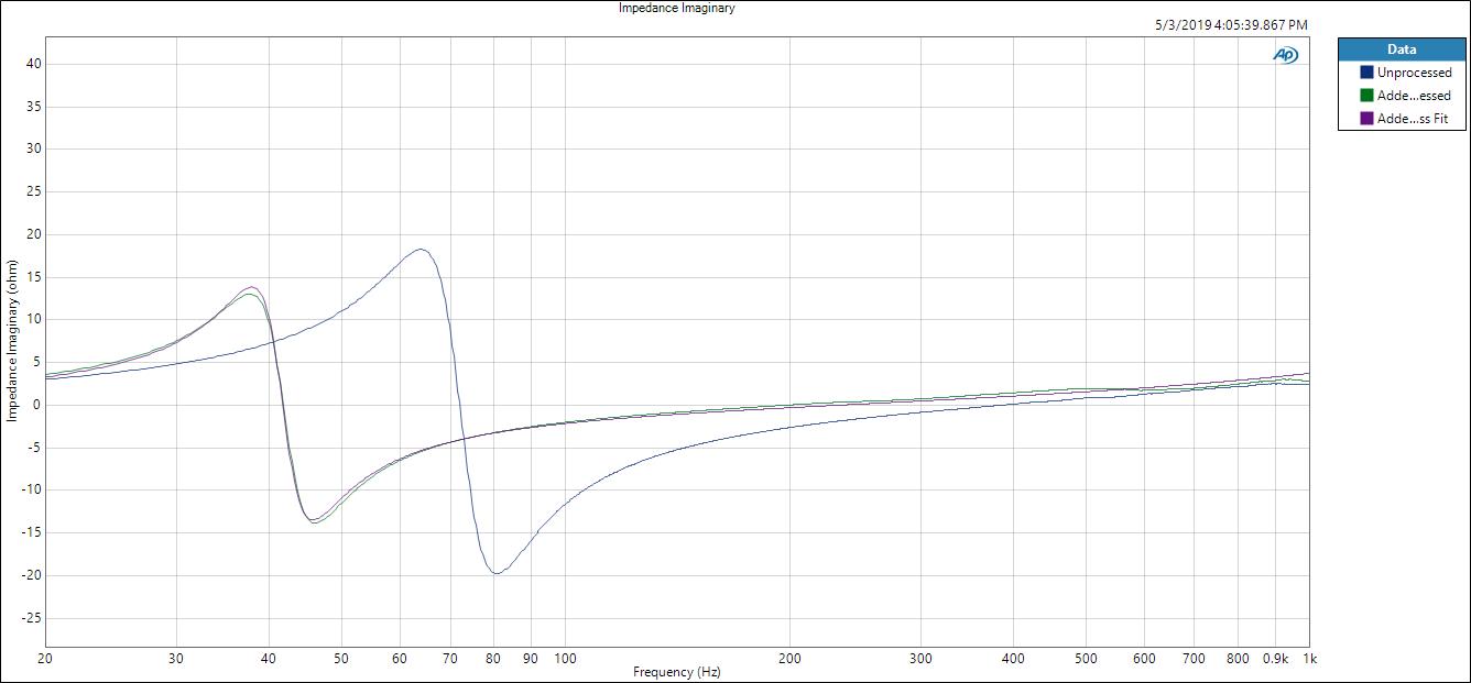

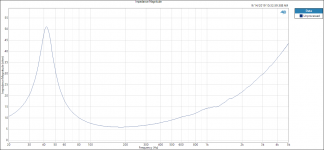

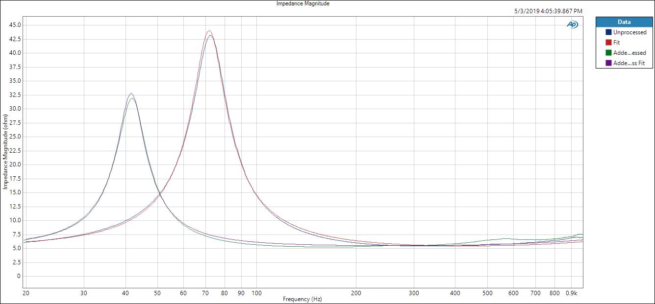

Hello,
Back in the lab for a couple of days.
I opened the Lab Log book and set up the analyzer the same as the last time. Today the windows are open a little and things are several degrees warmer. What a difference it makes with thing / parts a little warmer.. The T S / P are closer to the factory numbers.
Take a look at the attached JBL 2118H impedance plots and T S P test results for a used Ebay driver.
Found that the modeling clay sticks to the speaker cone if you use a smaller amount (smaller weight)
Thanks DT

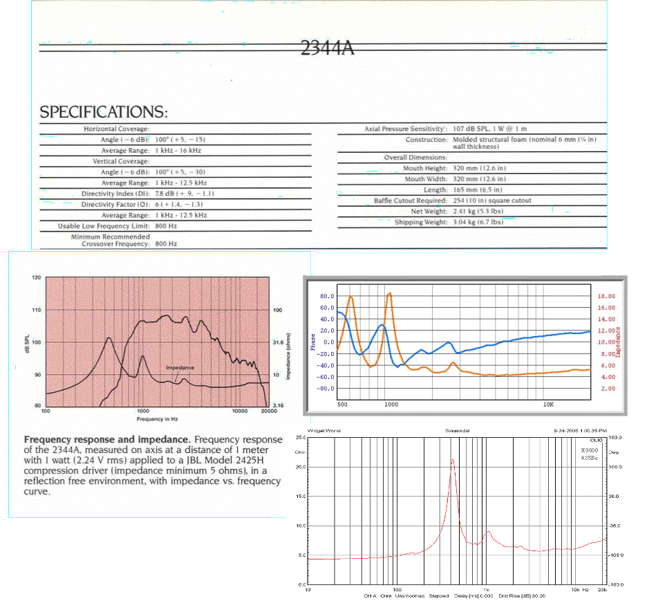

Hello All,
I have been looking at Sean Olive’s Audio Musings at
Audio Musings by Sean Olive: Search results for geddes .
It appears to be a forming consensus that it is not so much nonlinear distortions (THD and IM type distortions) that are audible and irritating to the listener. It is more linear distortions; as in lumpy bumpy frequency response, think peaks and dips or otherwise missing or peaked frequencies, crossover and other non-time or phase aligned discontinuities, reflections and resonances that are the prevalent irritating linear distortions in the speaker response.
Starting with the older waveguides, I have been looking at previous posts regarding Constant Dispersion Compression Drivers and Waveguide combinations plus doing some of my own measurements and plots. It is my impression that the unequalized lumpy bumpy frequency response of the JBL 4344A and JBL 2425H CD has the “classic horn” sound. The mouth, throat and length geometry of the waveguide ensures a peaky resonate horn signature. Equalized with a Klark Teknik DN370 30 band equalizer the JBL 4344A / JBL 2425H CD sounds pretty nice to me.

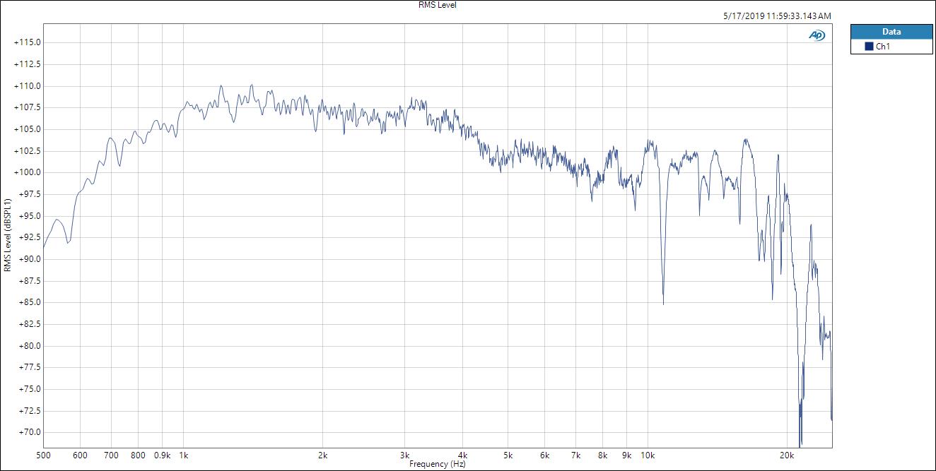

Take a look at Earl K ‘s post including impedance and Frequency response plots. Note the saw tooth pattern in the included impedance plot. Note the resonance peaks and valleys in the Frequency Response Plot.
Experience with PT Wave Guides
I neglected to save the impedance plot on the USB drive and bring it home with me to post it here.
See the Frequency Response of the JBL 4344A and JBL 2425H CD from Sparky’s Lab; on Horizontal axis, 22.5 degrees off axis and 45 degrees off axis. (no smoothing , Raw)
Thanks DT

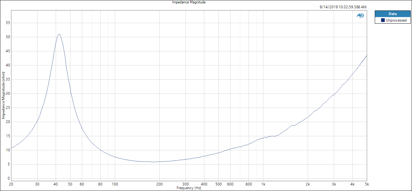

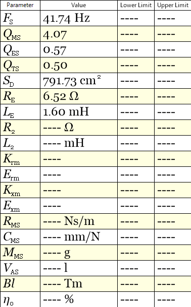

Hello,
This is not your glossy sales brochure kind of impedance plot. This is high resolution with no smoothing.
First up is a JBL2226HPL driver. No lumps or bumps or ragged edges.
Next up is a FatialPro HF111 Compression Driver attached to a STH100 horn. The rough edges that you see on the impedance plot are real. This is typical CD / Horn behavior never shown is a sales brochure.
Someone sent me an PM asking me to post a impedance plot of the FatialPro HF111 Compression Driver STH100 horn. I could not attach a PNG image to a PM so here it is.
Thanks DT
