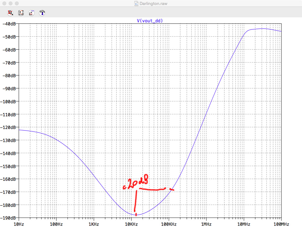

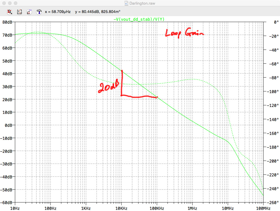

The LTspice simulation of my discrete regulator also forecasts a circa 20dB fall in PSRR from 10kHz to 100kHz. Again you can see that this matches the roll-off in loop gain in the modelled circuit and we know such a roll-off is necessary for the feedback circuit to be stable.

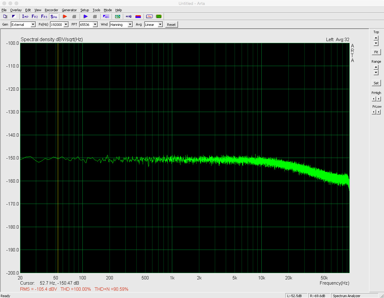

My latest test of the discrete regulator (post 74 above) showed a 9kHz - 90kHz change in PSRR of 121.4-104.5 = 17dB. I can't test 100kHz and 9kHz is a little short of the expected inflection point shown in the sim I referenced before so I'd expect it to be a bit shy of 20dB. I'm not sure 17dB is "accurate" but certainly 17dB is likely a more correct result than the former 12dB. It's at least heading more in the expected direction than otherwise.
So then the question becomes what in this test setup could be masking the expected roll-off in PSRR (in both the discrete voltage regulator and the known LM317 - and for that matter the LM7812 which was also tested)? For better or for worse, I'm referring to this as attenuation of the output signal - an attenuation/reduction of the residual ripple one would expect to see. How that is occurring remains to be figured out and is the question of the day.
The input stimulus has been monitored and shown to remain at the requisite 1Vpp ripple for all frequencies of interest during testing. (Surely if an offset was being coupled into the input one would see a rolloff in the stimulus ripple.) The sound card FR has been shown flat (enough for these purposes) and the preamp+sound card combo flat also. A further check of the test setup was done by replacing the regulator DUT with a simple voltage divider directly at the output of the rail driver (together with a 470n cap and 0.5A load - those used at the input and output of the discrete regulator DUT during testing) and it was shown flat - no decline in residual ripple. All as expected. And yet when I place a regulator circuit between rail driver and preamp - connected by wires - I get unexpected results. Lowering the impedance of the GND connection between rail driver and regulator moved the needle decidedly towards results that were closer to those expected. The challenge is to understand why and potentially improve the test setup if need be (if it can be done within reason).
For example, a first order low pass filter with a corner frequency of around 10kHz would mask the expected roll-off in PSRR/rise in residual ripple. RC or RL? Reducing the impedance of the ground connection between reg DUT and rail driver 'improved' results. Perhaps this points to RC as reduced R would shift the cutoff frequency further out...
You measure PSRR. Compare actual PSRR values, not a randomly grabbed gradient in a narrow domain! And don't "refer" to the simulation, show it! You can do it once easily, other ones must search for one by one, and after all you asked for help.

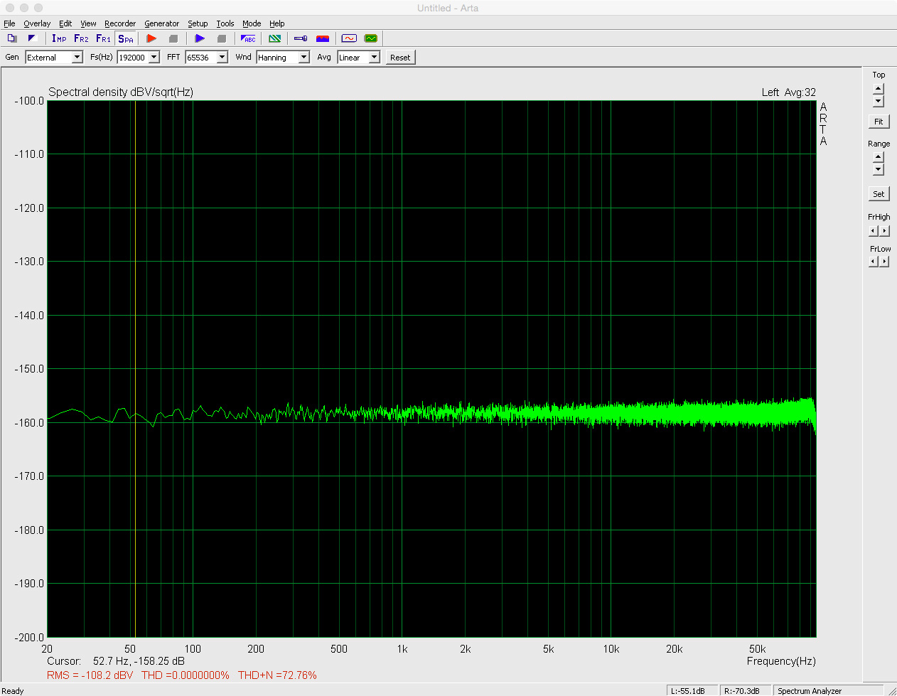

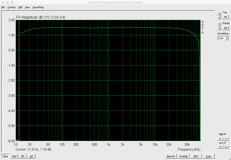

All? You said "flat" many times, but despite of the direct question from Mark you didn't state actual numbers. How many dB? And why scaled in dB/sqrtHz? Soo many problematic/ not described details...

So, from the simulation of the discrete regulator I built, from observing the PSRR charts of known regulators made by competent engineers with very sophisticated test setups and experience (and even from simulating such IC regulators) we can see that one would expect a roll-off in PSRR for both the discrete regulator and the LM317 of around 20dB per decade (or even more in the latter case) beyond circa 10kHz. Certainly flat PSRR would not be an expected result. Until we agree on this the conversation can go no further as this is the topic under discussion.
If we do agree on this then I think we ought to agree that it is odd/puzzling/intriguing (choose whatever adjective you prefer) that my first tests of the discrete regulator and LM317 did not appear to show this expected outcome. As noted above, there might be other things of interest, but for now this is the standout peculiarity of the results thus far - that and the fact that the slope (were the results plotted) of the residual ripple voltage by frequency beyond 10kHz is so sensitive to the nature of the ground connection between ripple driver and reg DUT. Is the latter coincidence? Maybe. Odd? Yes. Explanation? Not yet uncovered. For as long as it is an unexpected result, I query the test setup to see if it is masking the expected outcome in some way.

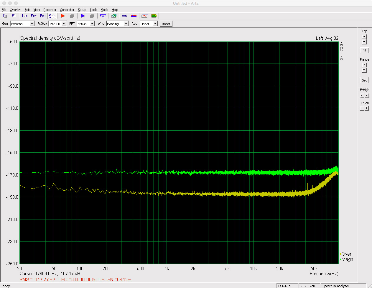

In posts 52 and 57 I presented results with the rail driver, preamp + sound card with a straight divider. I did not do the latter with the cap rolling off attenuation but it is clear that nothing is being coupled in or otherwise to offset an expected circa 20dB roll-off in PSRR in the higher frequencies when the reg DUT is replaced by a simple resistor divider.
Of course, since the signal level was much-much higher! You can add an ant to an ant, and get 6 dB gain, but if you add an ant to an elephant, then you see no change. This shows that the error is NOT an attenuation, but an addition. This is the reason you can't find it at high level. You are searching for the wrong type of error that was never been there.

About post10: Your PSRR and loop gain curves shows sooo obvious dismatc, they are not similar at all! Except for the difference of the 2 marked points they nowhere show the behaviour you stated. Neither between the 2 points nor outside of them, simply nowhere. This is how expectations leads perception. You can see only what you expect. This is normal behaviour for humans in everyday life, but not a successful strategy in research.
Your expected result according to simulation is -170 dB @ 90 kHz. You achieved -124 dBV (after correction with stimulus amplitude it can be around -115 dB). The 20 dB/decade you were chasing is quantitative incorrect and due to the absolutely different levels totally irrelevant. Decreasing PSRR result is not improvement, but further error. Look at the numbers!

Yes, the sim of the discrete regulator produced incredible results. Were it the case that my test setup was unable to discern lower frequency outcomes from the noise floor I might have believed that the reason why we don't see a reduction in reg performance at higher frequencies is simply due to its performance being below measurement at all but the highest freq i.e. we only glimpse the far edge of the rising residual - it begins to rise much earlier but the performance is buried in the noise floor. But we are clearly able to see residuals above the noise floor at all frequencies.
So I care less about the absolute figures in the sim and instead note that a very core characteristic of such error feedback amplifier networks is reduced closed loop gain with increasing frequency available to 'combat' ripple. It's just not possible that PSRR doesn't decline with frequency. So, with respect to my discrete regulator, either PSRR performance begins to decline outside my test limits (above 90kHz) or, as I suspect more likely, the modelled performance is optimistic at all frequencies and it is better to expect a PSRR plot shifted the upwards.
