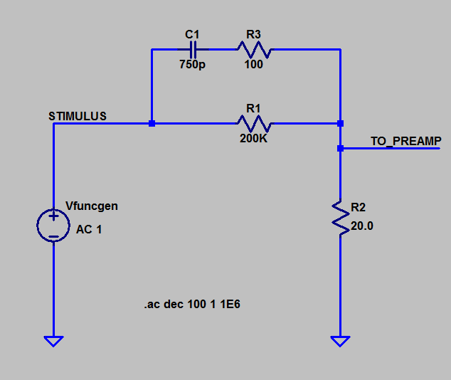

Maybe a little test jig might shed some light.
Shown below is an 80 dB attenuator (attenuation = R2/R1) that begins to poop out around 1 kHz. When the capacitive reactance of C1 falls below the resistance of R1, signal current starts to flow in the upper branch and attenuation starts to decrease. C1 = 750pF has a capacitive reactance of 200K ohms at 1.06 kHz, so that's where the rolloff (frequency) is found on the frequency response plot.
{Resistor R3 is merely a voodoo component, completely unnecessary in theory, but reassuring in practice, just in case the function generator's output impedance gets weird at high frequencies. Me, I'd leave R3 in the circuit. You, can do as you like. Now that I look at the schematic, it seems better voodoo to interchange the order of R3 and C1: put R3 next to the signal generator. They're equivalent in theory, but maybe not in voodoo!}
Naturally you can change the resistance ratio and get different amounts of attenuation. You can also change the R1*C1 timeconstant to move the corner frequency up or down. Perhaps a couple of these attenuator jigs might help you discover whether the measurement gear is giving untrustworthy results.

Ok I don't have as extensive a parts box as you guys. Change R1 to 100k, R2 to 18 and C1 to 4.7n. I make that a 74.8dB attenuator with a 3dB freq of about 327Hz.
As it is very late here I just coupled my signal generator to this jig and connected it directly to my sound card as an interim test.
I set the signal generator to 1Vpp = about -9dBV so the figures below need to be adjusted by 9dBV. (Hmm I think that answers another question I had at one point...) Sorry I should have set it higher to make the following a little bit easier.

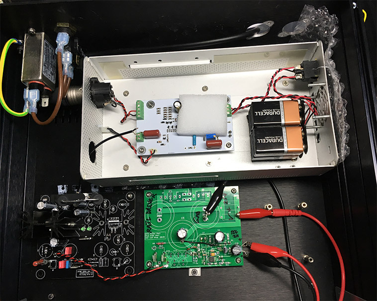

FWIW here is as far as I got. 10mVpp (-49dBV) input from my signal generator -> -74.8dB test jig -> sound card. Nominal 1000 gain for the preamp entered in ARTA.

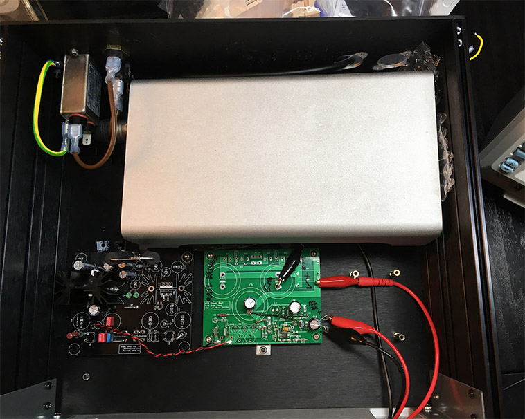

Having eliminated as potential causes everything downstream of the reg under test and its resistor load (i.e. sound card and measurement amplifier) I looked again at the rail driver. Tests of the sound card and measurement amp were done by coupling my signal generator directly to them. As a quick additional test of the rail driver I added a simple 74.8dB attenuating voltage divider at its output (in lieu of a regulator). Not surprisingly the response was flat at close to the expected level of attenuation (and the rail driver generated 1Vpp across all test frequencies). (I still think the nominal gain of 1000 for the preamp is a bit too high - 0.8-1.0dB or so.)
A more useful test would be to do the above but with the rail driver charging a 470nF cap (the biggest input capacitance of the regulators tested). For this I need to construct a suitably-sized resistive load at its output. With 18V +-1V at its output, the two 12R 10 watt resistors I used at the output of the 12V regulators is probably not enough resistance.

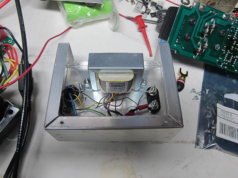

One of the great features of the AP2700 setup is that the stimulus is constantly monitored and PSRR is constantly calculated as the ratio of AC sim to AC out of DUT. It will always be more accurate.
My setup doesn't have this constant monitoring of the stimulus and automatic calculation of the ratio. It injects a stimulus into the high impedance Vref pin of an op amp driving a high current capable pass transistor. This rail driver produces 18Vout with a ripple of 2.6x the input stimulus riding on top. The high impedance of the injection point means the signal generator can easily drive it and the rail driver has plenty of current drive capability to supply the reg-DUT load and charge its input capacitance.

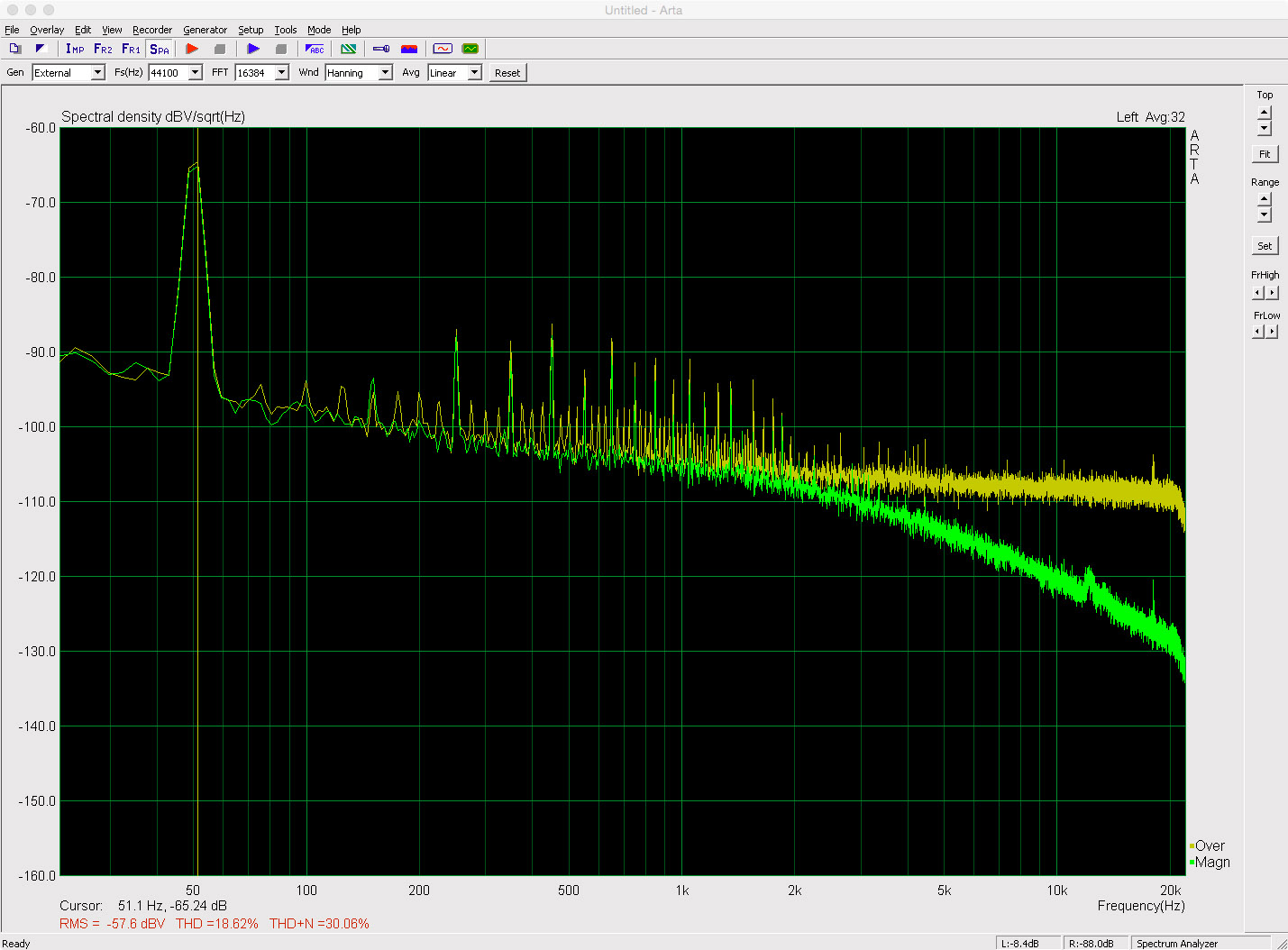

A curious thing happened today while measuring the (currently not so great) noise in my amp build. See attached. I shorted the input to the amp with a 100 ohm resistor. I then measured with the Groner preamp (green trace) and then with a direct connection to the sound card (yellow trace). The former has a 20dB per decade rolloff from 2k-20kHz. There was no such rolloff if the input to the amp was directly shorted....

So I added a 470nF cap and a 36R load to the output of the rail driver. I kept the nominal 74.8dB voltage divider at the output as before and conducted the same set of tests. (Output of rail driver connected to the input of the preamp. Preamp to sound card.) The measured output from the voltage divider was within about one dB from 50Hz to 90kHz and the ripple stimulus remained at 1V throughout.
I'm running out of ideas on how to look for a 20dB per decade roll-off. The sound card is flat. The preamp and sound card are, together, flat. The rail driver has no problem providing the requisite 1Vpp stimulus across all frequencies of interest when loaded with a 470nF cap and 0.5A is more than enough to discharge the cap with sufficient slew rate. When the voltage regulator is replaced with a simple flat attenuator the output reads flat.

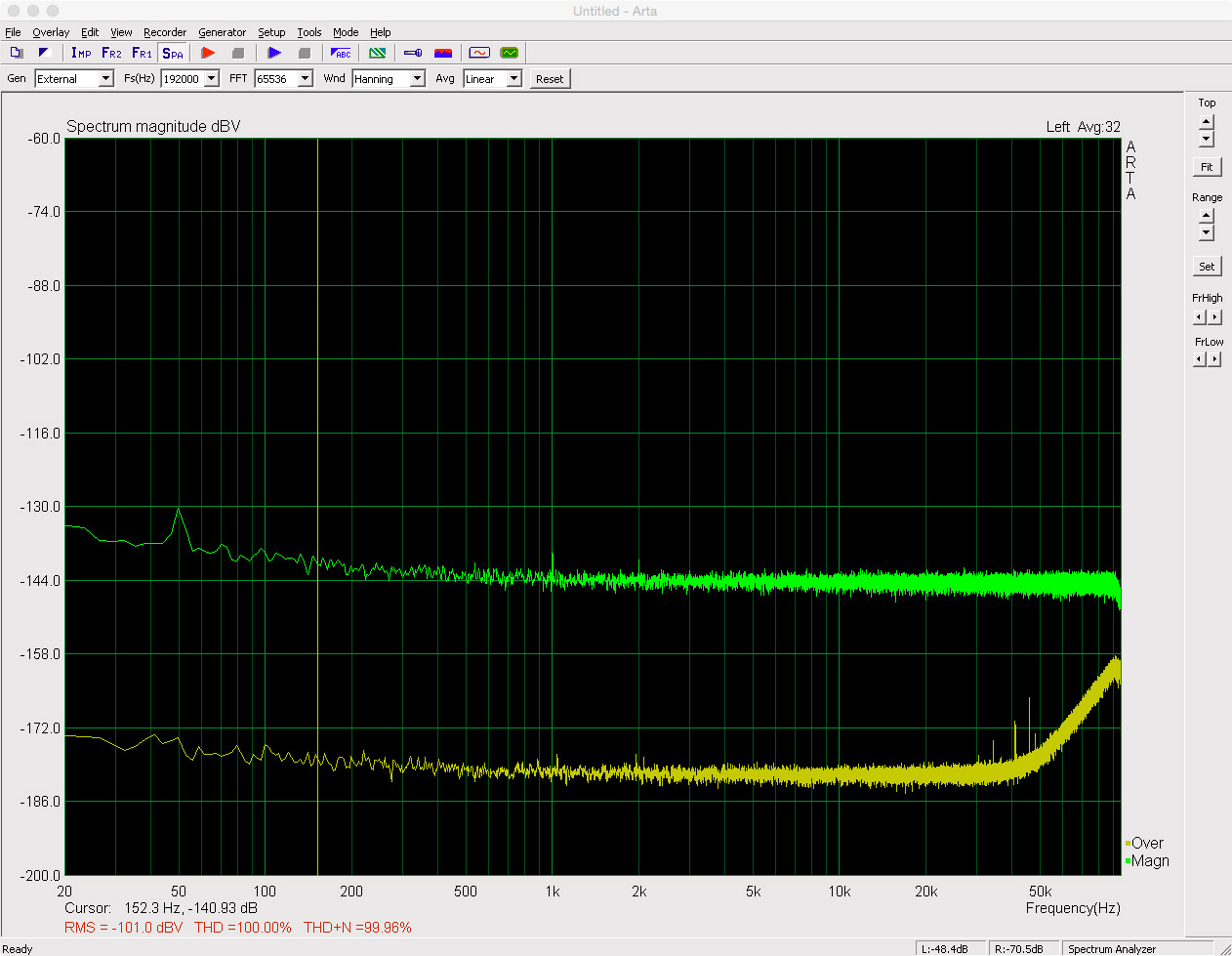

I decided, having exhausted all permutations I could think of, to test the discrete regulator circuit again. (I will post the schematic and screen shots from ARTA tomorrow. It's late here.) I also made better attempts to ground the enclosure of the preamp to the exterior enclosure which housed the rail driver, voltage reg DUT and preamp box.
For the observations below with stimulus frequencies below 50kHz it was a bit like waiting for something to appear from the noise fog as a result of 32 averaging. Nonetheless this is what I got:
192kHz FFT=65536 Window=Hanning 1Vpp stimulus (-9dBV)
Hz dBV/rtHz
50 -136.7
100 -138.5
200 -140.7
500 -140.0
1k -139.9
2k -138.4
5k -135.7
6k -135.3
7k -135.1
8k -134.5
9k -134.2
10k -135.3
20k -132.5
50k -118.4
60k -115.9
70k -113.0
80k -112.1
90k -109.3
A bit more sensible with respect to the expected roll-off in PSRR.
I will do the test again tomorrow as well as check the preamp gain once more. For these tests I had entered a preamp gain of 794x into ARTA.
Well fingers crossed these results are more sensible...
At one point I measured R215 (in circuit) closer to 80k.
(Obviously in terms of PSRR dB the numbers above need to be adjusted by 9dB to reflect the fact that the ripple wasn't 0dBV)
