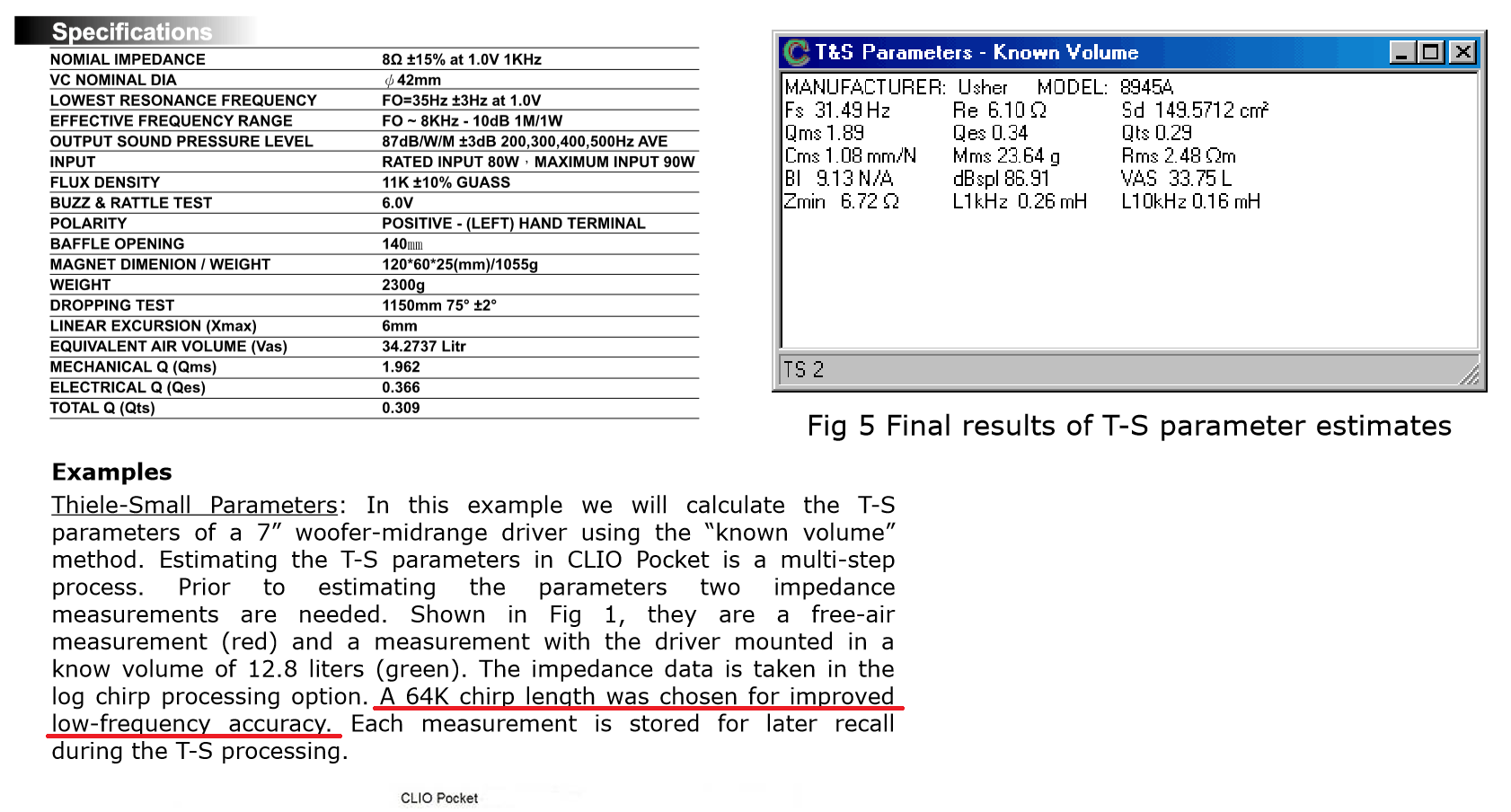

Hey everyone. Thank you all for sharing all this amazing information on measuring TS parameters. I have a similiar issue to ggidzinski. I have a Dats and a Clio Pocket. I have recently been asked to measure / verify TS parameters of a bunch of high powered car subwoofers. Ultimate goal is to recommend enclosure boxes for it. The manufacturer claims to have used an LMS to measure and I measured both with the Dats and the clio pocket. I am getting similiar VAS and FS with both tools but the QTS, QES and QMS are significantly different. Anyone have an opinion or idea as to which measurement device I should trust more? The Clio Pocket or Dats? Also I asked the manufacturer why they use hte LMS instead of the Clio (as they own a clio) and they said a clio is not accurate for TS parameters and is only accurate for Frequency response measurements. I never heard htat before. Can anyone Chime in and help me. Thanks!
interesting, that means you are getting different shape of the resonant peak but same resonant frequency, most common is that the shape and freq changes with drive levels and stimuli, do both use the same signal? What happens if you match drive levels? Also, you can export response curve from both programs and then do manually calc by looking at the numbers in the exported files. Lms uses stepped sine as stimul as far as i know and can be used with additional boxes for constant current/constant voltage method for higher accuracy, maybe that is why they getting different set of parameters
Now if we think a little more about the above underlined statement, it seems not to be an accurate one, especially without any evidence, and I see none so far. There is a Clio Pocket review by Joe D'Appolito where we can see the comparison of TSP for the Usher 8945A as measured by the manufacturer with LMS and the one by Joe reviewing Clio. I have added a paragraph from the same review.

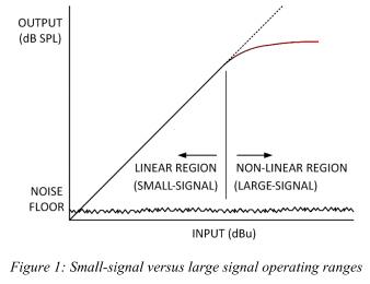

I've only skimmed this thread, but every 2nd comment seems to be talking T/S about things that technically aren't T/S parameters:
Thiele/Small parameters - Wikipedia
"These are the physical parameters of a loudspeaker driver, as measured at small signal levels"
"These values can be determined by measuring the input impedance of the driver, near the resonance frequency, at small input levels for which the mechanical behavior of the driver is effectively linear (i.e., proportional to its input)"
I'm not dismissing your answer (which seems to be very well informed), just mentioning that if the higher drive level gives a different result, then, by definition, the higher level is not giving T/S parameters.
it pulls the scalars off a different part of the T/S curves.
Ditto. If there is a "curve", then the measurement is not where the "behavior of the driver is effectively linear".

still within the small signal domain, some drivers, with high qms, reacts highly with each change in drive level. as well stimuli makes a difference too, stepped sine, sweept sine or chirp, or mls makes a huge difference on some drivers
