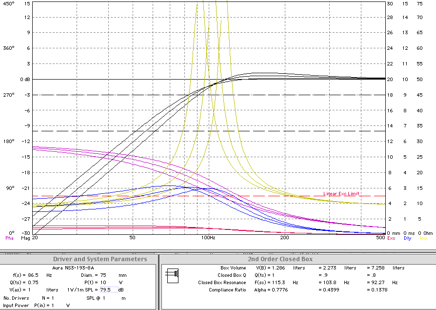

Unlike many sw measuring packages it actually goes looking for the key T/S base numbers instead of estimating them from an impedance curve. It comes with its own USB connected current amplifier. It means the impedance curves are not always pretty but they are relatively repeatable and the closest i have gotten to factory.
The Aura NS3 goes nicely into a small sealed box.

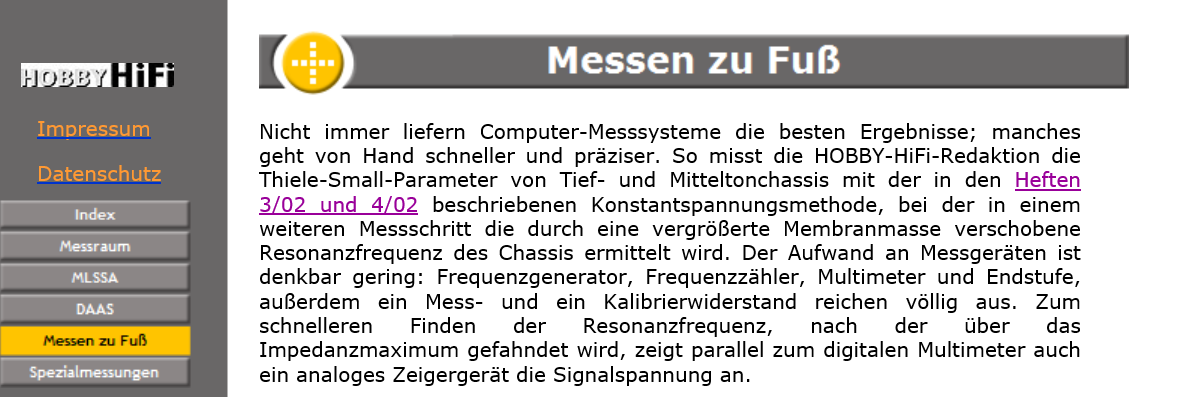

There is another and probably last resort to acquiring the lowest possible driver Fs. The German Hobby HiFi magazine states that not always is the elaborate computer measurement system the best way to measure specs, like TSP, so they do it manually with a signal generator, multimeter, amplifier, a measurement resistor, and a calibration resistor. They have explicitly said more than a couple of times when readers were wondering why their measurement appeared differently from the ones in magazine, and they said it was because of the way they measure, as described above (constant voltage method).
