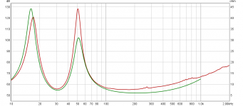

OK here is an M26WR-09-08 in 70L tuned to 32Hz Sim (using factory specs) and actual in box measurement. Note that I can't find the specs that I measured myself right now, which would have been what were used for the original box sim. I suspect that they are somewhere on my desktop which I don't have access to at the moment. Using those specs may be closer or further from the actual measured result.
This is simmed to match what was actually built. ie volume, port diameters and length put into the sim with factory T/S params.

i think the agreement is both good and poor, the resonances and tuning frequency is good but not the magnitudes. it looks like there is more series resistance in the measurement then in the simulation, and the actual box seems to be a tiny bit bigger then simulation, and there is a lot less damping material in the box (and the resonance at 275hz, is that the height of the box, ~63cm?)

I need to find the original measurements of the drivers that were averaged to design the ports for the enclosure. Then it would be more meaningful to tweak for best match.
The box itself is terrible. It is one that I was given in 1985, it is made out of chipboard and does not have any bracing. It originally had a 12" woofer but I made a new front baffle out of MDF when I got the Vifa M26WR09-08's. It was supposed to be a temporary solution till I could build a "proper" box, that was over 20 years ago 🙄

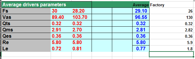

OK here is the sim versus actual with the T/S params that were measured and averaged from two drivers, in some ways closer in others less so. . Interestingly the QTS is identical to factory spec.
2nd attachment, blue is measured T/S and yellow is factory.
Third attachment shows the actual measured values, average of them and the factory specs.

Your DATS testing system is likely just fine. Don't get discouraged. You have discovered one of the dirty secrets of loudspeaker transducers - each individual one may have rather different specs from what the Manufacturer claims. Variation of up to 30% is not uncommon! Some drivers will vary more than others - it depends on how they are made, quality control by the MFG, etc.
Also, the driver you are measuring is a small fullranger (Fountek FR88EX). The emphasis and goal of the manufacturing is likely not to keep the near-resonance behavior within some tight tolerances.
You might have better luck putting these drivers in a closed box and using some other driver(s) below 150-250 Hz in a woofer plus fullrange configuration. Even a small woofer (5.25") will likely work much better down low than the fullranger. The closed box loading will be MUCH more forgiving of TS parameter differences, and since you will be operating only above 150Hz you are staying just above the resonance region, so what is going on there is less important.
And what you get also depends on how you take the measures. These are measurements from the same driver, with Fuzzmeasures, and with LMS (facvtory data thrown in for completeness).
There is not “1-set” of T/S parameters.

OK after I worked out I could use overlays in vituix cad to compare impedance curves it got a bunch easier. Attached are sims from vituixcad and unibox.
These are using the average params that I had originally used to design the box. none of the T/S params have been modified to get the sim to match.
The one known was the port diameter and length. I couldn't remember the box volume, I thought it was either 70 or 75L but it was not made by me, just used as a non-ideal enclosure for my new woofers (supposedly temporary)... I went for maximum extension, the remake will probably be a BB4 alignment.
The only things changed in the sim were the box volume, the box leakage and the box absorbtion. box volume increased to 78l leakage set to 11, absorbtion set to 100
Whilst still not a perfect match the below are much closer.
